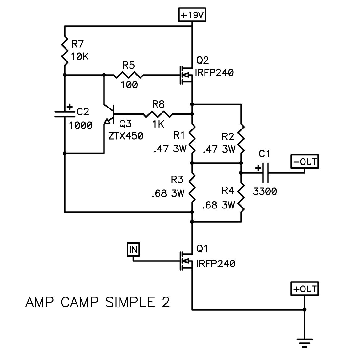

Is it ok to replace Q1 with IRFP9240 and run as source follower?
The other option is run more feedback in the final amp. I'd rather have less gain or no gain.
I'm lookin at this thing thinkin... If you change out Q1 with a Semisouth part... :D
Yes that is for certain.
Now that I have some high effiiciency speakers, I think I will be buying 10 of these PCB's and set them up with different components, operating points etc, just for fun and to see what the audible difference might be.
Reactions: 1 user
I wonder why the omission of the Rsource for Q1? Unusuall to not see a .47 ohm there?
Would increase available gain as well as output impedance. Using more linear parts like SiT or SiC, may be unnecessary. Looking at the Sit 1, I believe you will see that lack of Rs. Nelson also spoke of new cascode degeneration. This could perhaps give him the loadline cancellation using SiT devices without the need for Rs, sort of like F3 trick. Just guessing, though.
