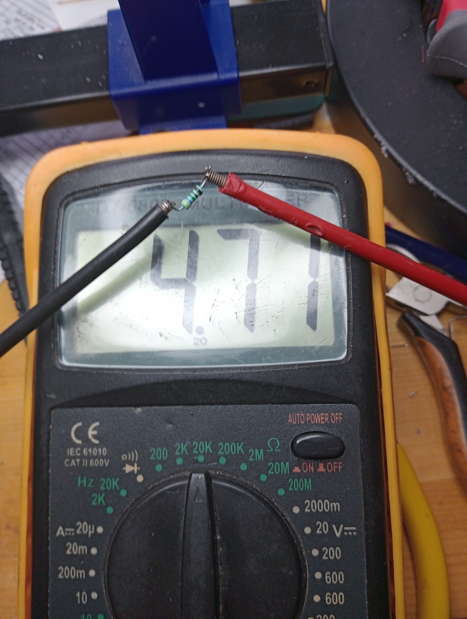

I haven’t seen wrong color code on resistor in my whole life. That one is color coded as 4.7 MΩ.
If green LED glows, then resistor value is OK.

The code may tell different but I do think it measures 4k7
I found the cause of the strange behaviour of my R21, a faulty multiturn potentiometer.... Now I have tested three plus and one minus R21 with a lab supply of 13,8 volt output. Regulation of output voltage is fine. Next step using two + versions for my F1. Thanks for the support and I will report back on the sound

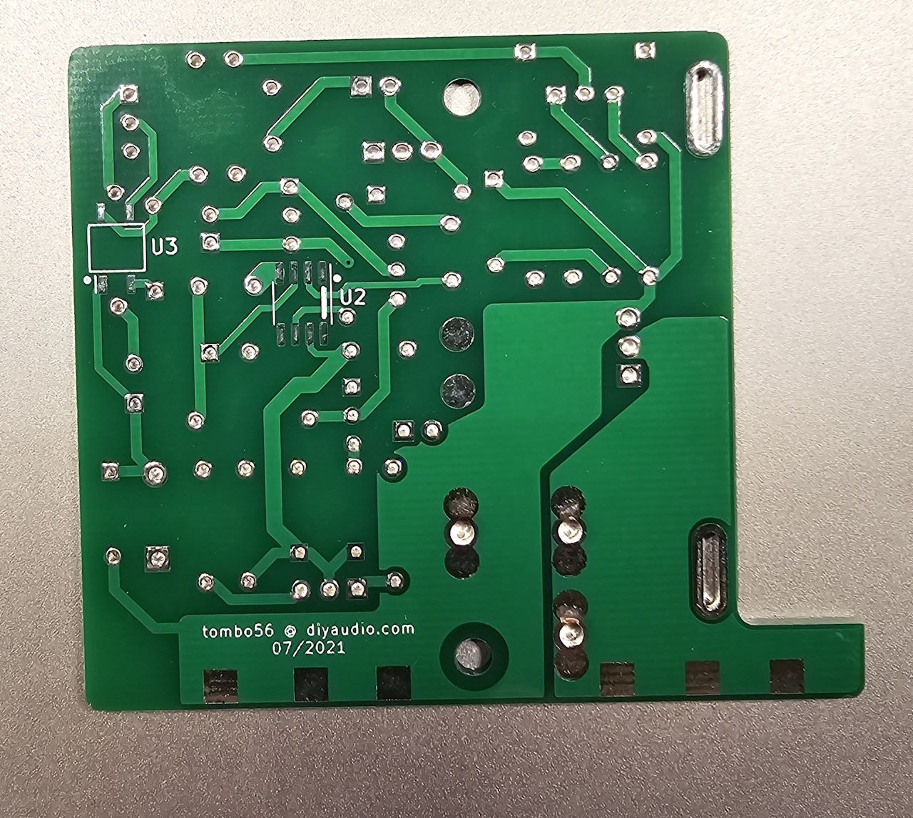

When I ordered the PCBs, I forgot to include the labeling on the bottom side of the PCBs:-( Therefore, I am not quite sure about the orientation of the OpAmp and the optocoupler on the positive regulator (the build guide shows only the bottom of the negative regulator).
My guess: Placing both PCBs side by side (a mirror plane in between), for the posivitve regulator the OPA828 is turned by 180° (bar on the right side), the optocoupler has its point still on the left bottom side. Correct? (And many thanks for providing the Gerber files!!)
