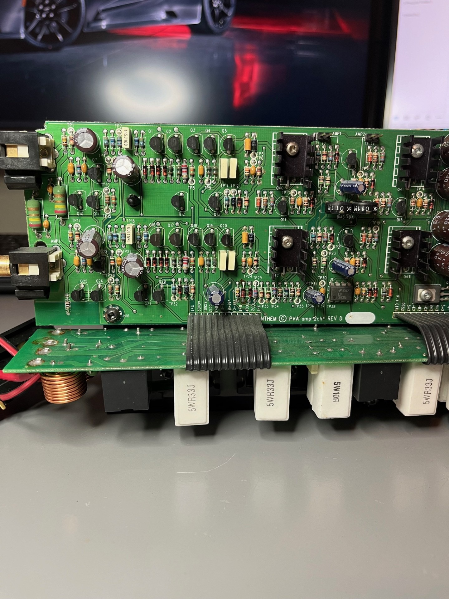

Anthem PVA-7 - Strange Oscillation
Joined 2013
https://share.icloud.com/photos/0a3eq9YUx9tV4iAmI4-ycVxqQ
https://share.icloud.com/photos/008E3C5JVOYPHO_hEb-1kAXDQ
Here are two videos of worst channel, reminder this is not the channel I replaced caps on but this was how it first behaved until I changed Caps.
Only difference is that the repaired channel issue was resolved with adding clear tape around the RCA to keep the plug sleeve from contacting the chassis, again only one channel has this issue as seen in the videos, other channel no amount of pushing, twisting causes protection.
Joined 2013

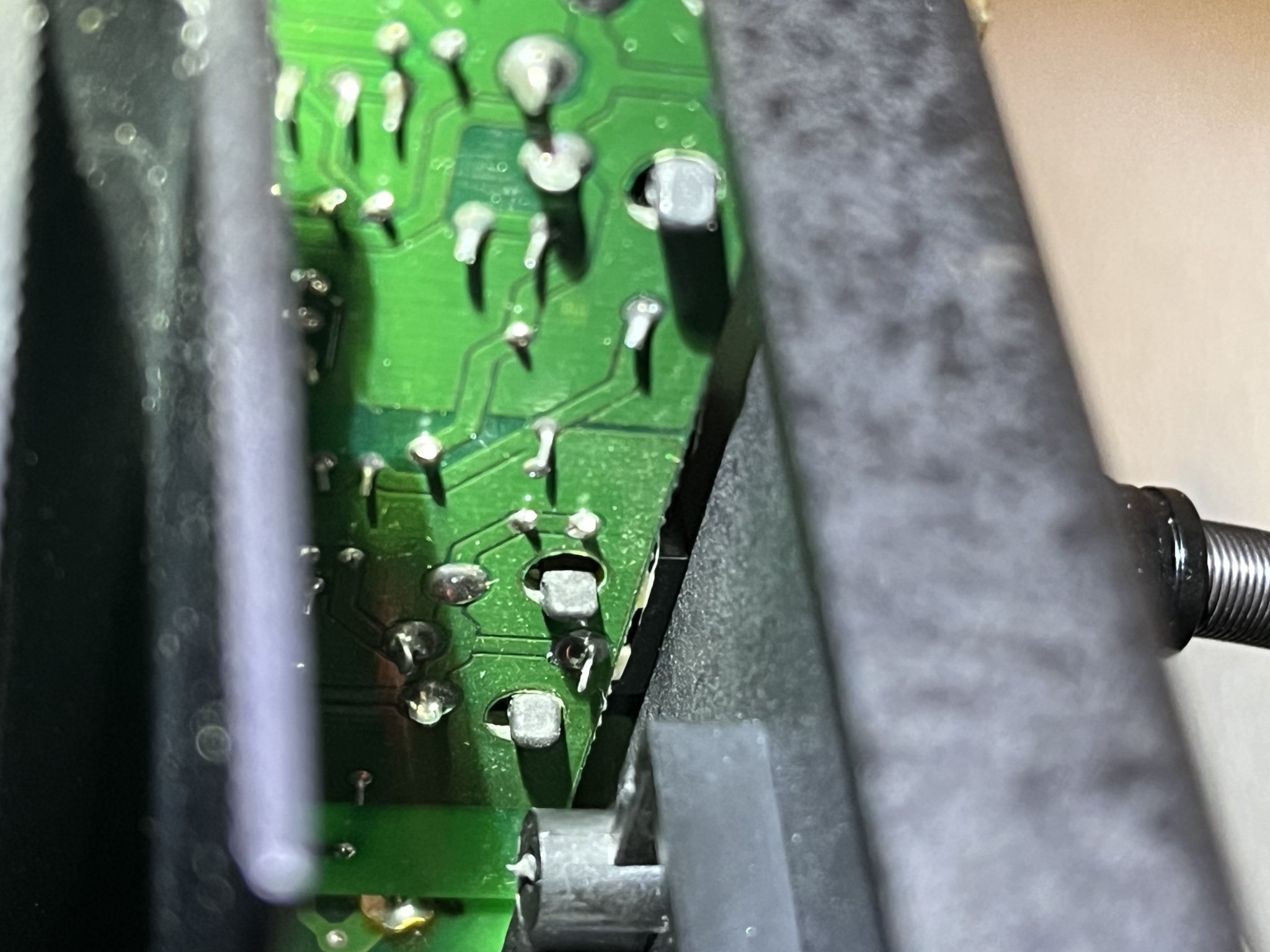

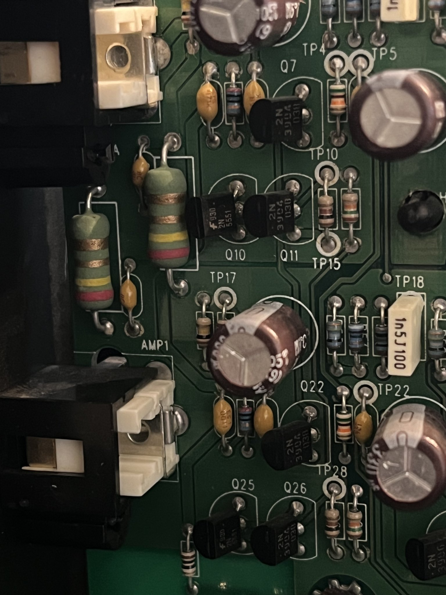

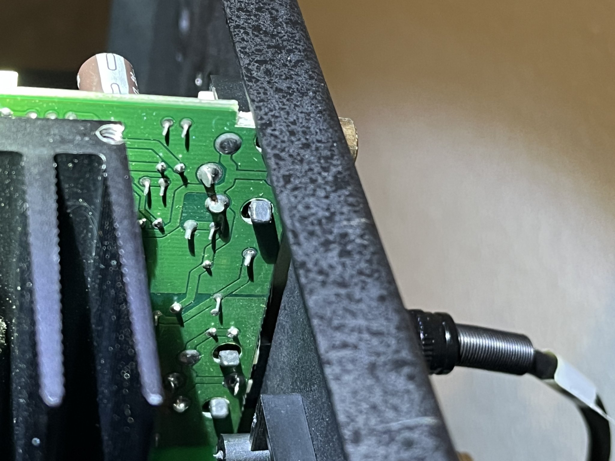

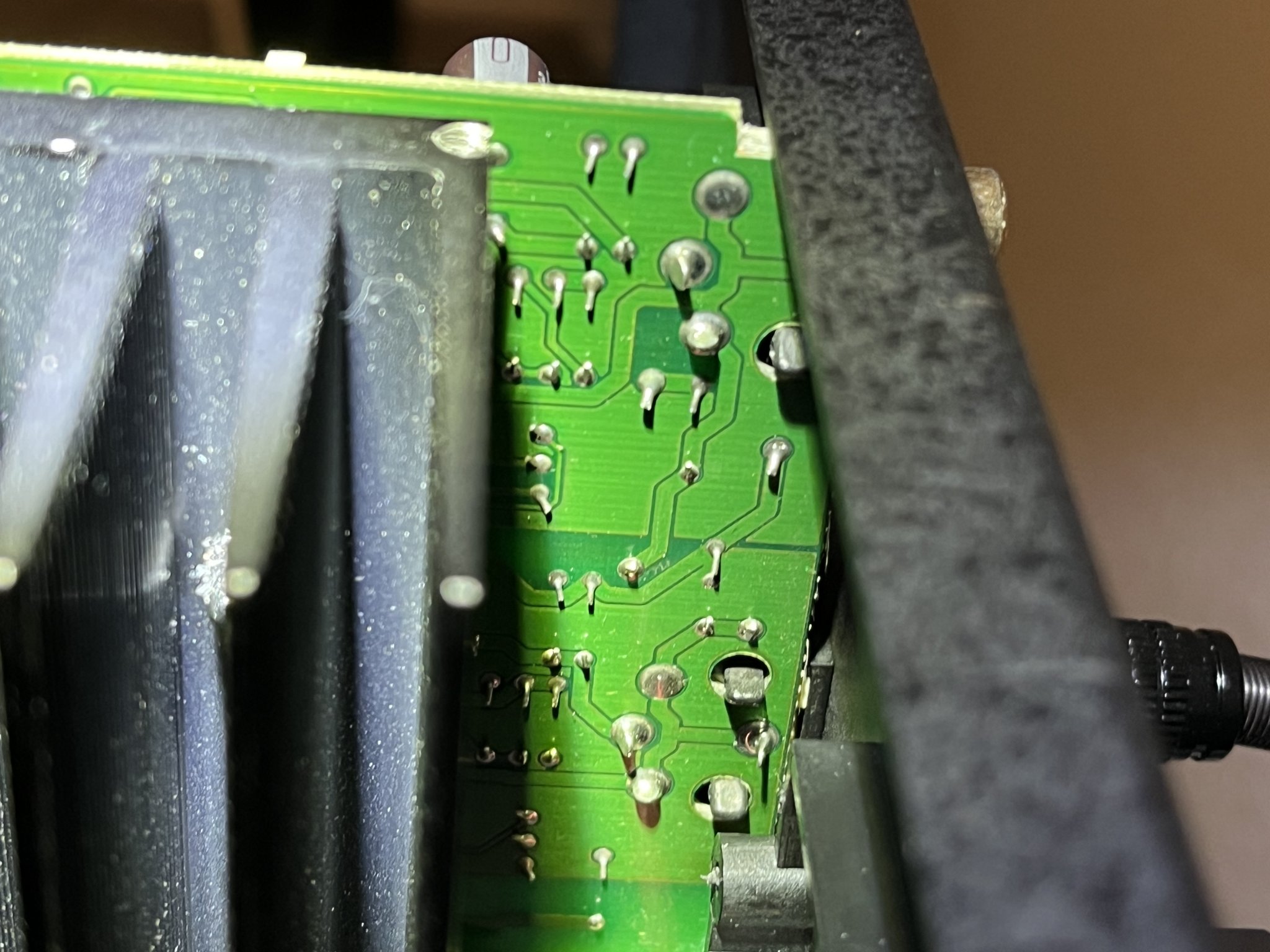

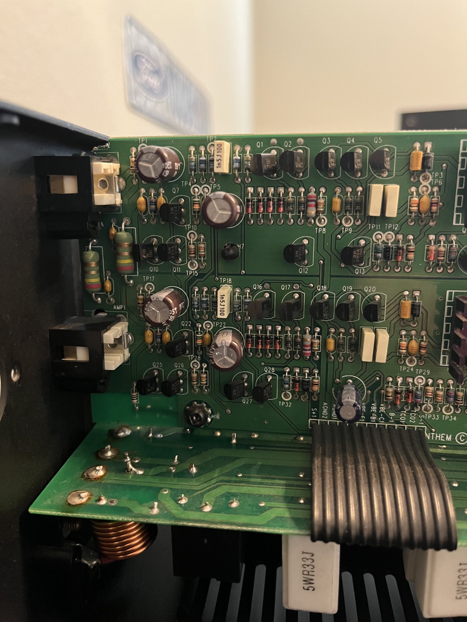

Best I could get since HS is in the way of back of board. Thanks for looking.
I tried to get hi-res, so let me know if you have issues viewing and I can downgrade the resolution.
Reminder: AMP 1 (bottom RCA) is the culprit on this amp board

Thanks for looking guys - I will pull out the board and go over as many joints as I can with the soldering iron and fresh solder (wouldn't that be great if that was the only problem??!!!). Sick kid yesterday, so I didn't get to do anything on the amp. Maybe today will be better - less work, more hobby!!!
Joined 2013
I touched up all the solder joints on the top of the board and as many I could get to on the bottom, especially the RCA connectors. On the board that couldn't have both RCAs connected at the same time or I could force into protection by manipulating the plug.
Interesting result - still goes into protection with both inputs are connected - however, now I am unable to force it into protection by pushing the RCA fully in, or manipulating the plug.
So, I'm hoping this means that
- touching up the soldering will fix the fully seating and manipulating of the PCA problem
- replacing the 4 lower value capacitors (C16, C38 and C42 all 35V 22uF) and C41 (63V 22uF) will fix both inputs connected issue
Going to touch up the soldering on the board I previously replaced all the caps on, and still has the fully seating and manipulating RCA issue. I may be optimistic but this seems like it is progressing, albeit slowly.
Joined 2013
My optimism has turned to despair... I replaced the 4 smaller caps (C16, C38 and C42 all 35V 22uF) and C41 (63V 22uF) on the channel I re-flowed solder on all joints. As part of the cap replacement I had to remove the board and was able to make sure all the joints were reheated and looked solid.
reinstalled and no change - still goes into protection as soon as you hook-up second pair of speakers.
Insult to injury... I reinstalled what was the working board (channel 6/7) and now it has the same symptoms. Fine with one pair of speakers (channel) playing, but as soon as second pair of speakers are connected, it goes into protection.
But, if I connected the bottom PCB speaker ground to chassis ground with a jumper (tried numerous place, but only works connected to the speaker ground for the lower RCA, amp #1), both channels play fine and listened to it this way for ~30 mins or more. No overheating heating, no sound issues.
I also tried to capture the protection behavior on my O-Scope, but it's too fast for the scope (or something, maybe me), because the signal is there and as soon as I connect the second RCA the scope trace/screen goes blank and doesn't come back until it come out of protection - then cycles until I unhook the RCA/speaker or turn off the amplifier. At no time during this cycling can I see/capture the sine wave again.
This seems to prove that it is losing ground somewhere (seems to point to lower amp channel), but I have checked continuity and resistance for all grounds - such as barrel of the RCA, the speaker grounds and the PSU ground (at both the PSU board and the plug from the PSU to the amp board) and I get continuity, around 0.4-ohms.
I was going to pull out the PSU board but there should not be a ground connection to the speaker ground here? I'll admit I'm getting frustrated and confused as to how there is an issue without any transistors, caps, resistors, diodes seemingly bad and all transistor voltages seemingly making sense.
I am at a loss of what to even try next? I guess I could try one of these older channels in the newer amp/PSU - nothing else connected and see if the symptoms go away, or follow the amp channel?

By the way, from the pictures you posted so far, the ground connection on the output stage PCB seems to be, taking the speaker negative wire soldering joint as reference,
1. amp 1 and amp 2 speaker negative wires are not tied together immediately where they get soldered on the PCB.
2. there are two ground traces, one thick, one thin, coming off each of the speaker negative wire solder joints. The thick ones would travel the length of the PCB and join each other at the power inlet connector.
3. the thin trace coming off the speaker negative wire solder joint would go to the flat cable, in turn, go on to the respective front end of the amp.

EDIT: added close up board pic - voltages are moving from RCAs, or left to right. Top RCA is AMP2, Bottom RCA is AMP1

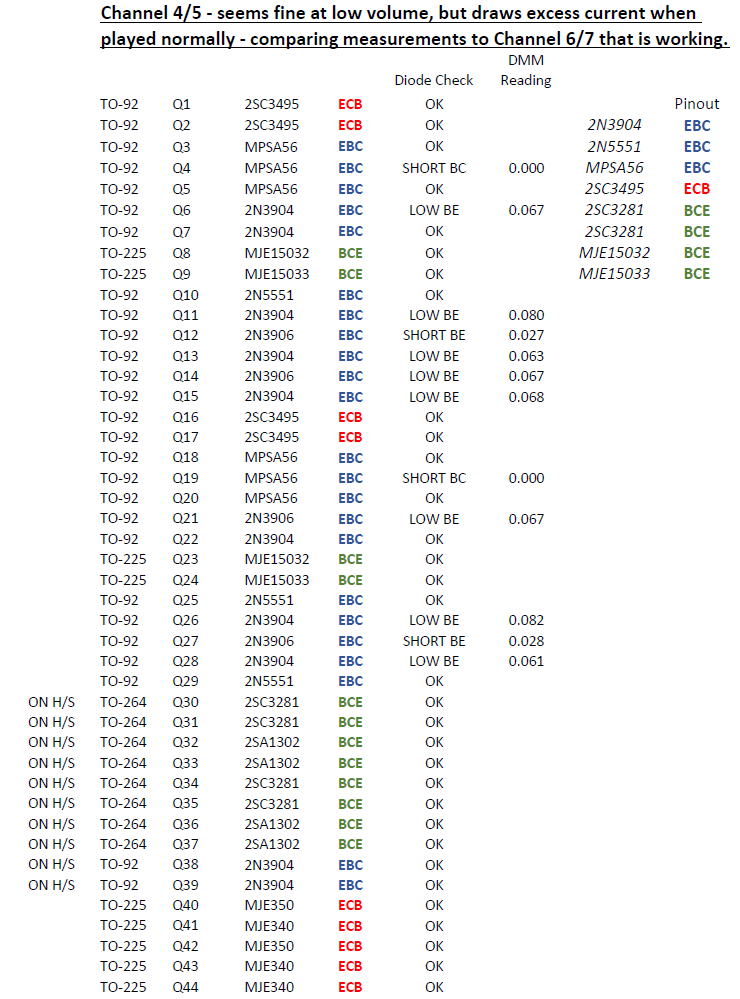

Question - with 6 high DC channels on previous amp --- any chance bad input transistors 2sc3495 could cause the DC to ramp up, when it doesn't on a Dim Bulb? I'm sure it's a single to-92 leaking when current goes above idle - just flying blind without a schematic.

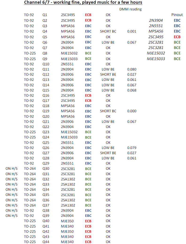

Attaching my DMM diode testing I did on Channels 4/5 and 6/7 - and I made notes of any weird readings, but again they both match, which at the time meant they were ok

Amp if Fixed!!! Playing music on all 7 channels.
Strangest repair I have had, possibly ever. After all the voltages and DMM testing of the transistors seemed to be good, but still going into protection with speakers connected (a load) I was getting frustrated and resorted to some guessing and shot-gun parts.
Best part is my first guess and set of parts repaired the amp. Looking back at my posts, couldn't figure out why it only happens with current, so I thought I'd start with the Input pair, thinking one may be bad and it's causing the amp to go out of balance and high DC. Pulled out the first (2) pair from channels 1/2 and guess what they both measured perfect on the DMM and the multi-tester, showing ~600mV Vf and ~1000 Hfe - right in line with the datasheet.
On a whim, had it apart so I might as well shot some parts at it - I put in (4) pairs of matched (with multi-tester, double-checked Hfe with BK Precision DMM) - and it powered up and played music first time!!! Had 8mV DC on one channel and 170mV on the other channel. That's fine, because at least it was playing and I could do some actual testing now. Proceeded to replaced the input pairs on all the other channels. Tested each channel individually and they are all working outside the case (which I couldn't get them to pass music without protection kicking in previously)
So success - except I still had 170mV of DC on channel 1/2 board - remember when I said these ribbon cables are the worst and most prone to failure on these amps, my opinion is proven again. Granted this is the board I have pulled out 4-5 times between cap replacement, resoldering and voltage testing, but nonetheless they should be flexible cables with connectors, not ridged ribbon cables.
Well apparently one single wire was loose on the AMP2 (top RCA channel) and in the process of finding it, 4 other wires broke - so actually good thing I had an issue to resolve, because it would have failed someday. But unsoldering, stripping and reinstalling those two ribbon cables takes at least 20-mins and very tedious delicate work to strip the wires without breaking the wire in the process, then you have to feed 11 and 12 wire ribbons into the output board and the input board carefully lining up the wires with the holes and then solder without any of them pulling out. Like I said - tons of fun!
Hoping this thread helps somebody repair their PVA-5 or 7, and maybe even their bigger brother MCA-5. I would think they are all a similar design, with different voltage parts and number of outputs.
