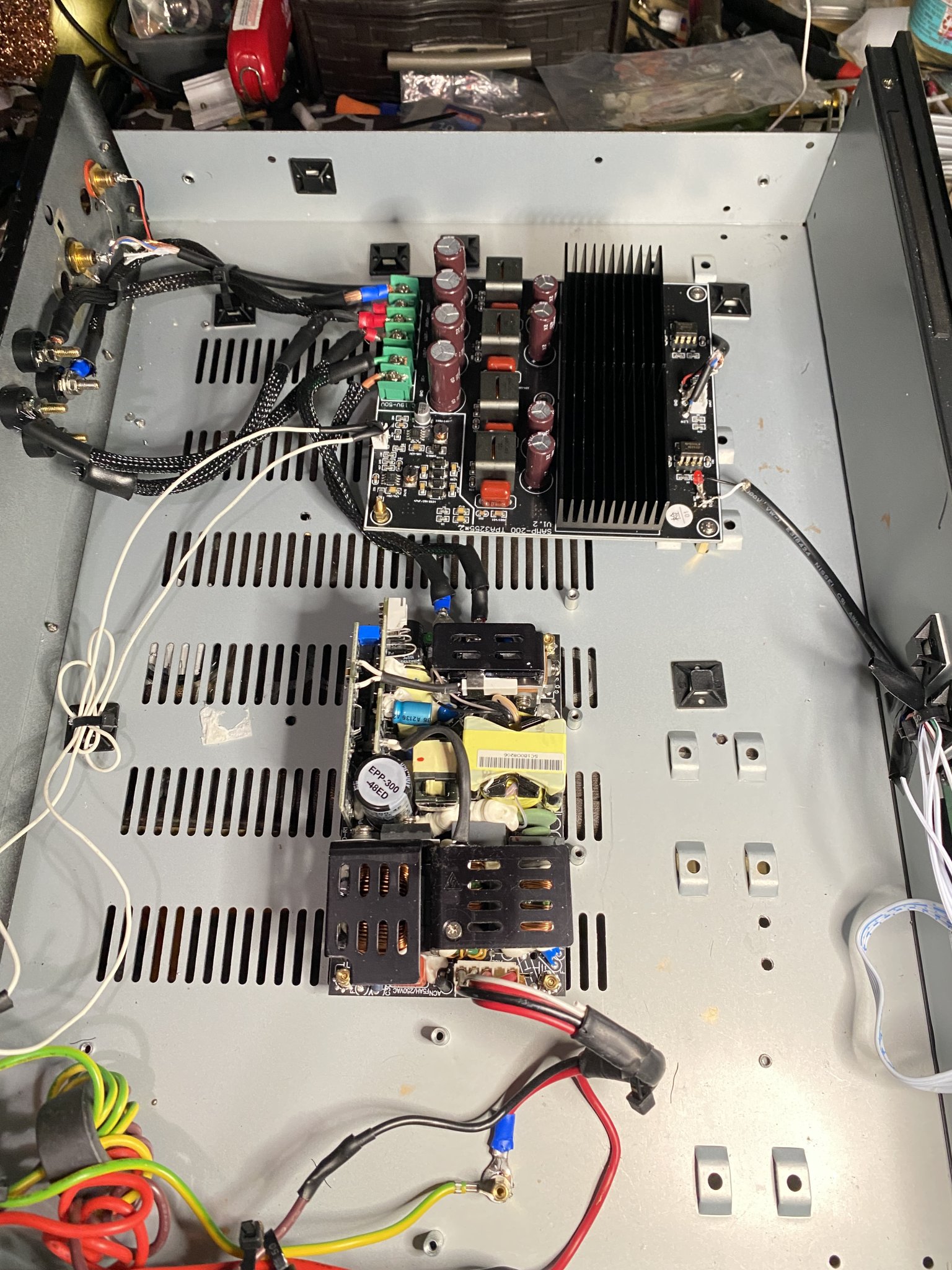

Anyone here use this TPA3255?

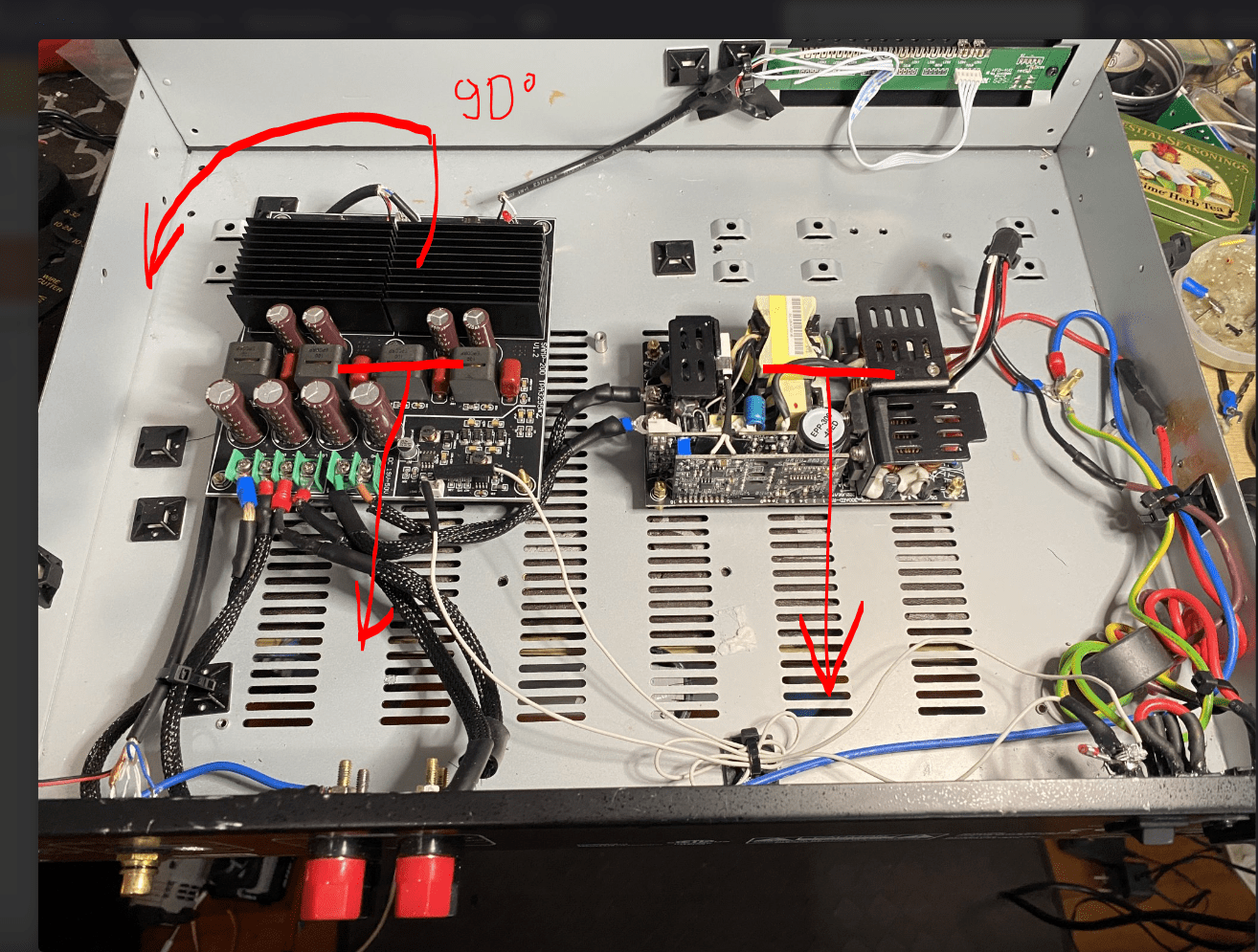

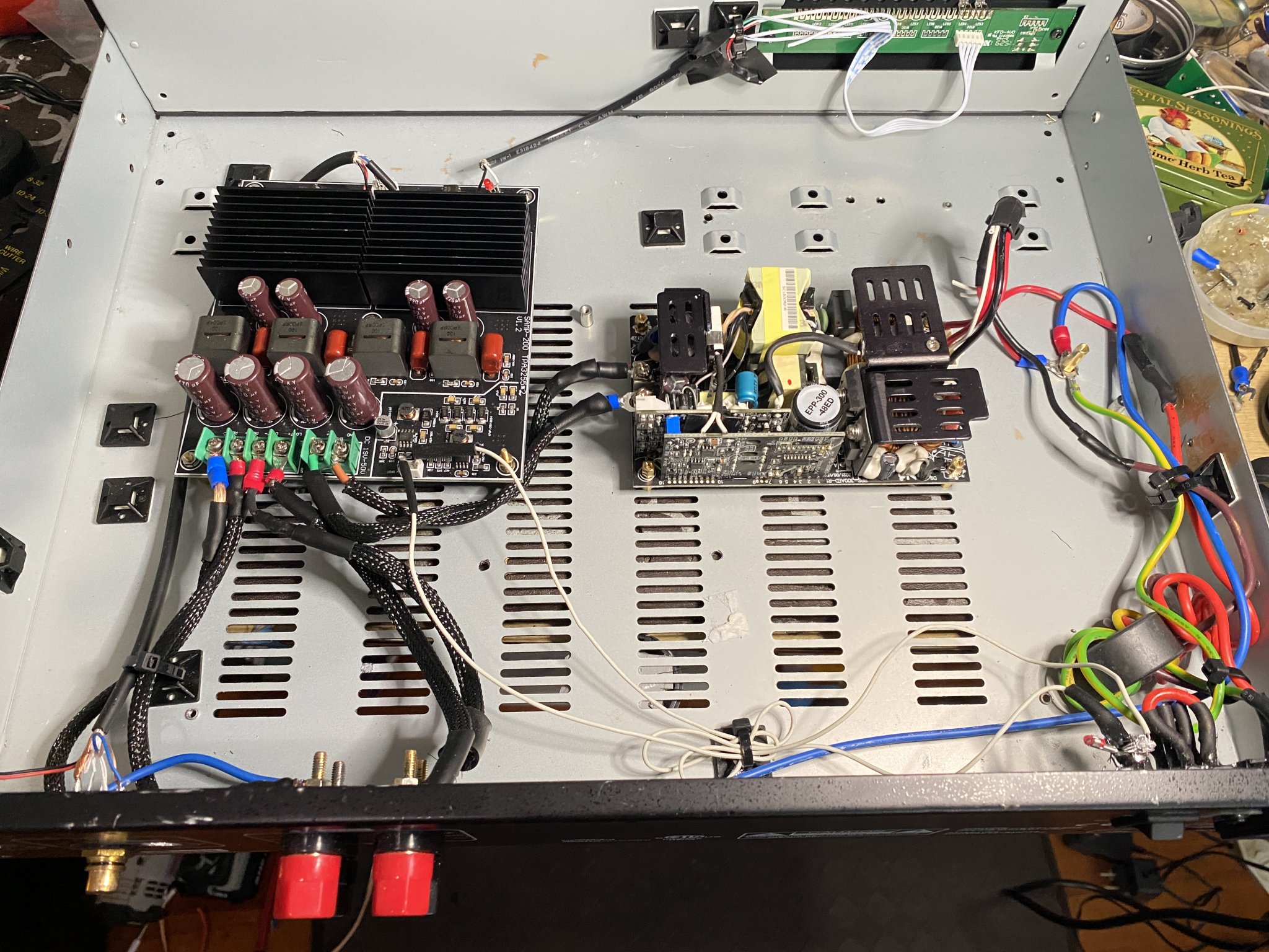

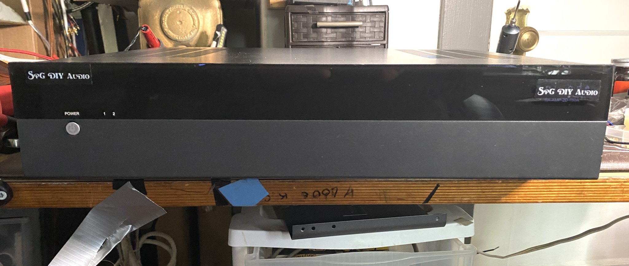

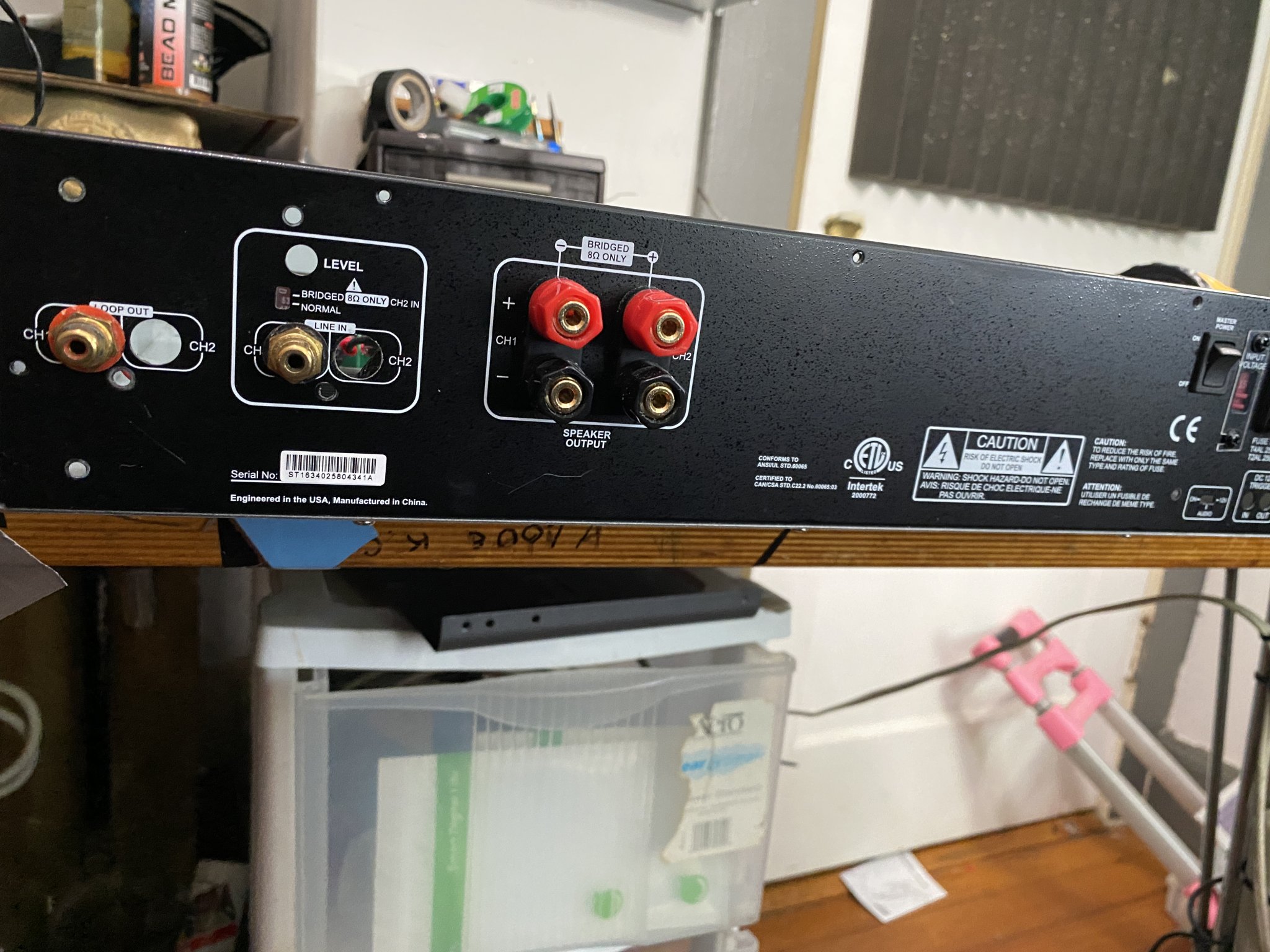

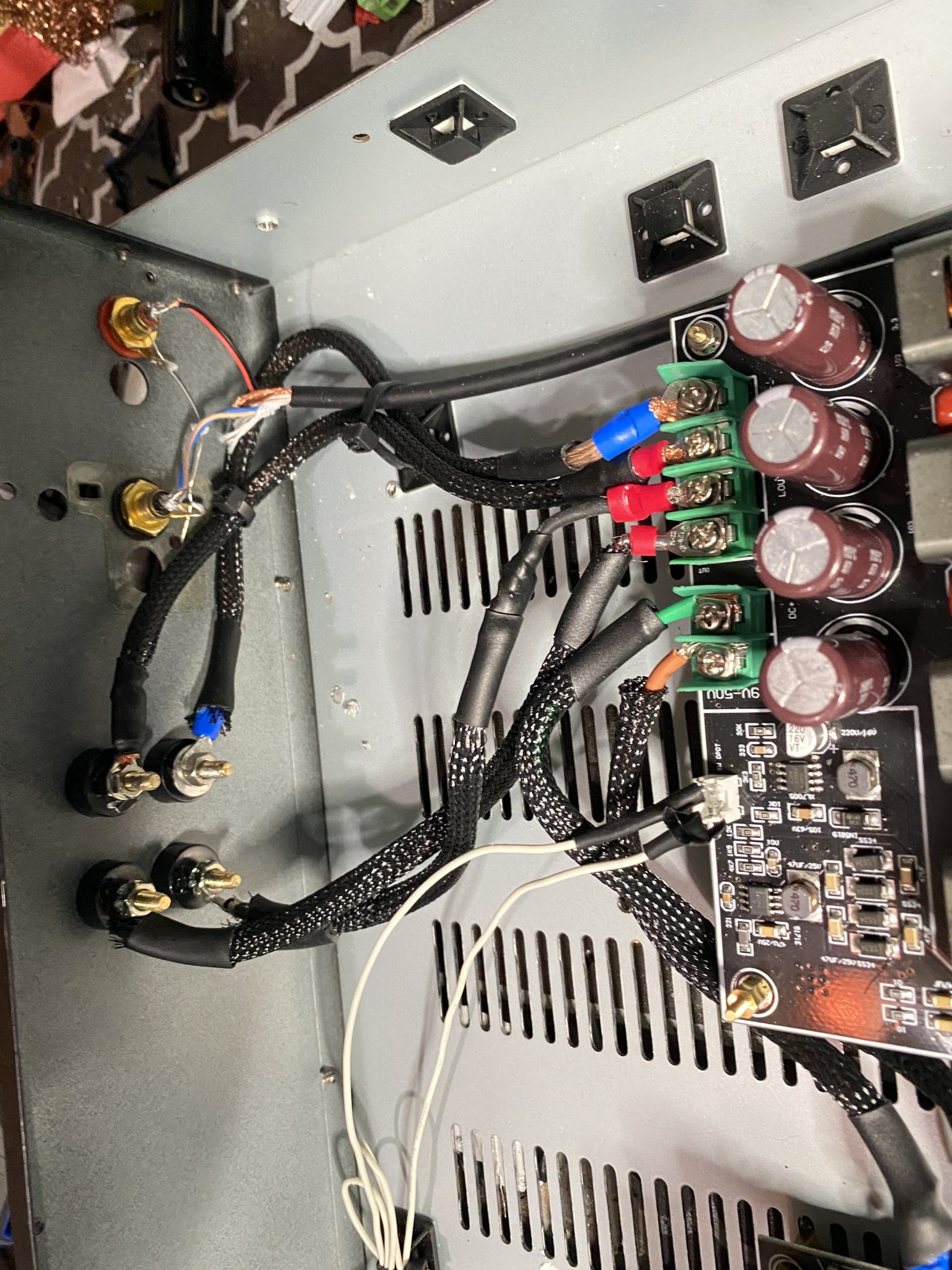

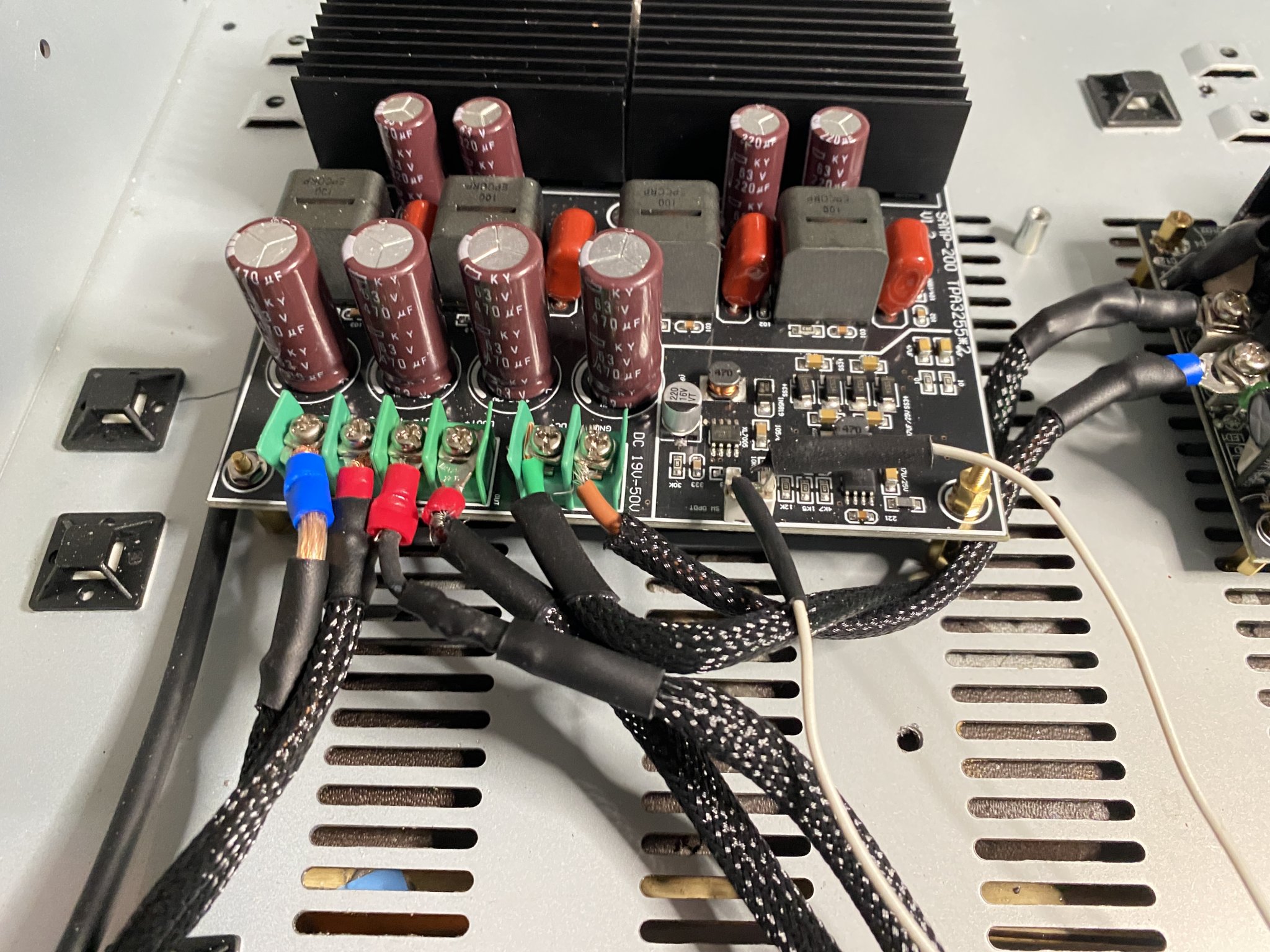

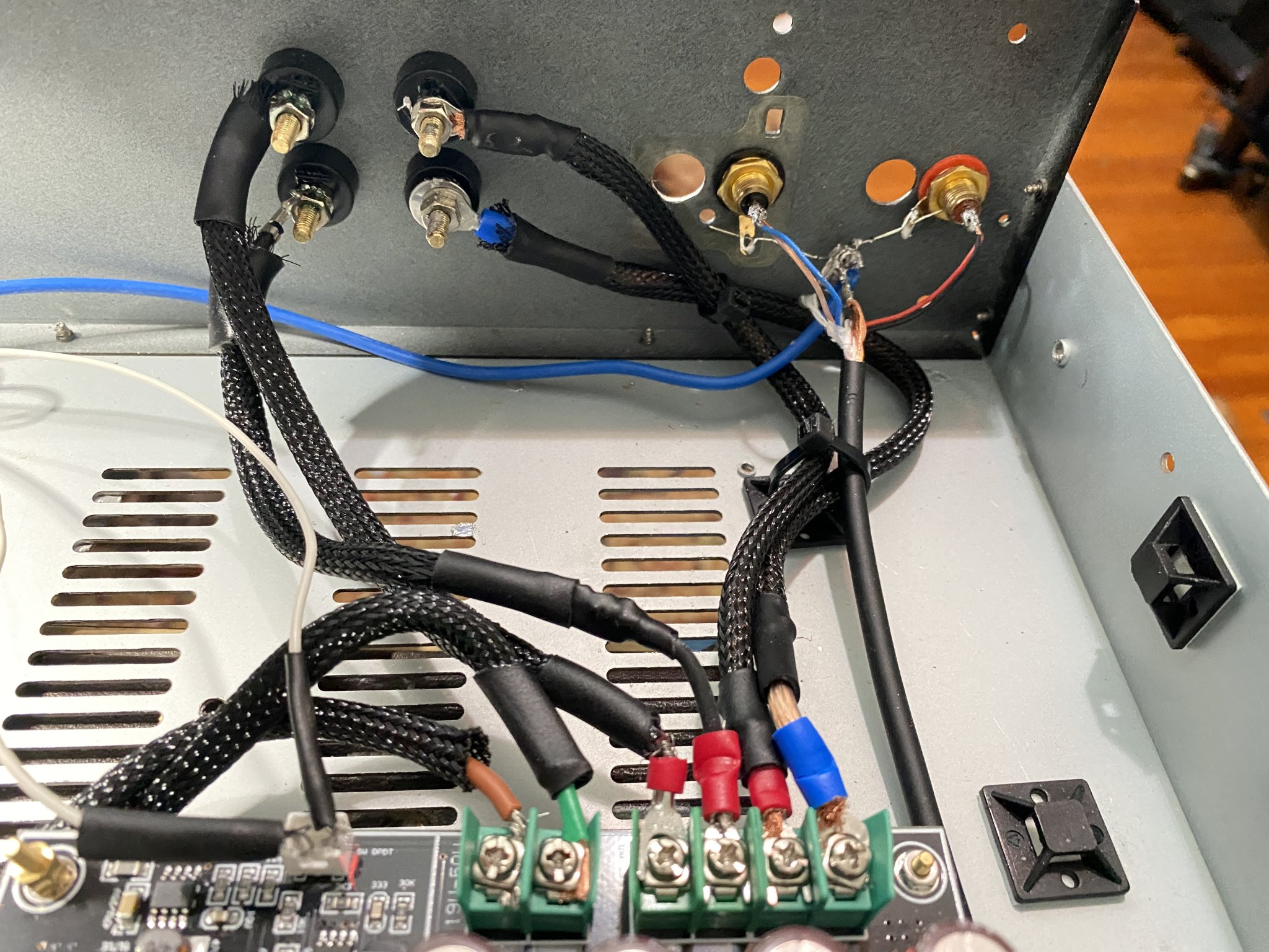

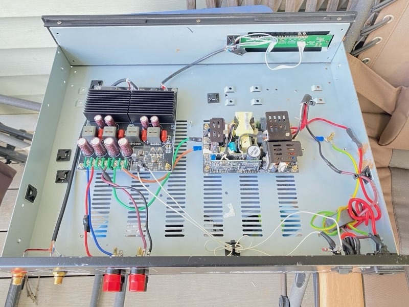

I started working on this. Ive installed the Board in a Power Amp chassis I bought that was like new. Im using a Meanwell EPP 300 48 power supply with it. Nice and compact specs are 48v at 6.25 amps. I actually have two of them. Is there anyways to use both of these with this board or is it even worth it. Specs on the board state 600 watts which I know is horse shizz. THe power Supply DC ouptuts are V+ and V- and the amp pcb looks for V+ and Grnd. WHats the difference as I have V- fmor PSU to the Grnd input on the AMp PCB and obviously V+ to positive. Any additinoal grounding need to be done? Its mounted on metal standoffs both supply and AMp. Power input (AC) is grounded to Chassis and Pin 1 of PSU also to chassis ground. AM I missing anything?
If you connect (-) from the PSU to the GND of the amplifier and (+) from the PSU to the (+) of the amplifier, you will get double the voltage, which can fry the amplifier.
Does that Mean Well PSU have dual DC outputs +/- and GND or just one pair of outputs?
It has a connection for a switch which I believe is also mute as there is no Pop noise etc. I have it wired to on off switch, noi thump etc. Sounds really good. Powerful.
