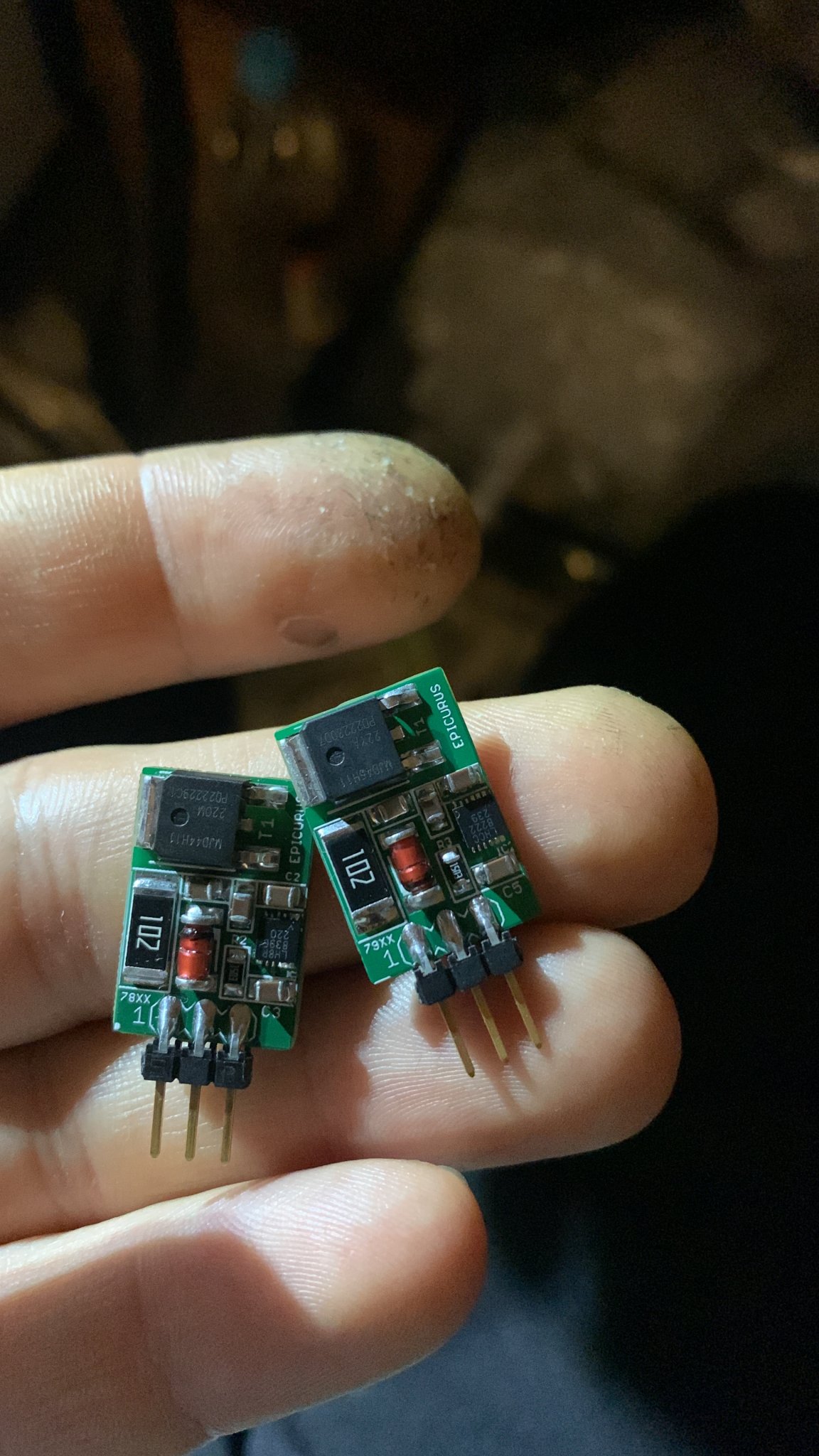

I use my 78xx and 79xx pin out v- and v+ regulator if i need to more low noise

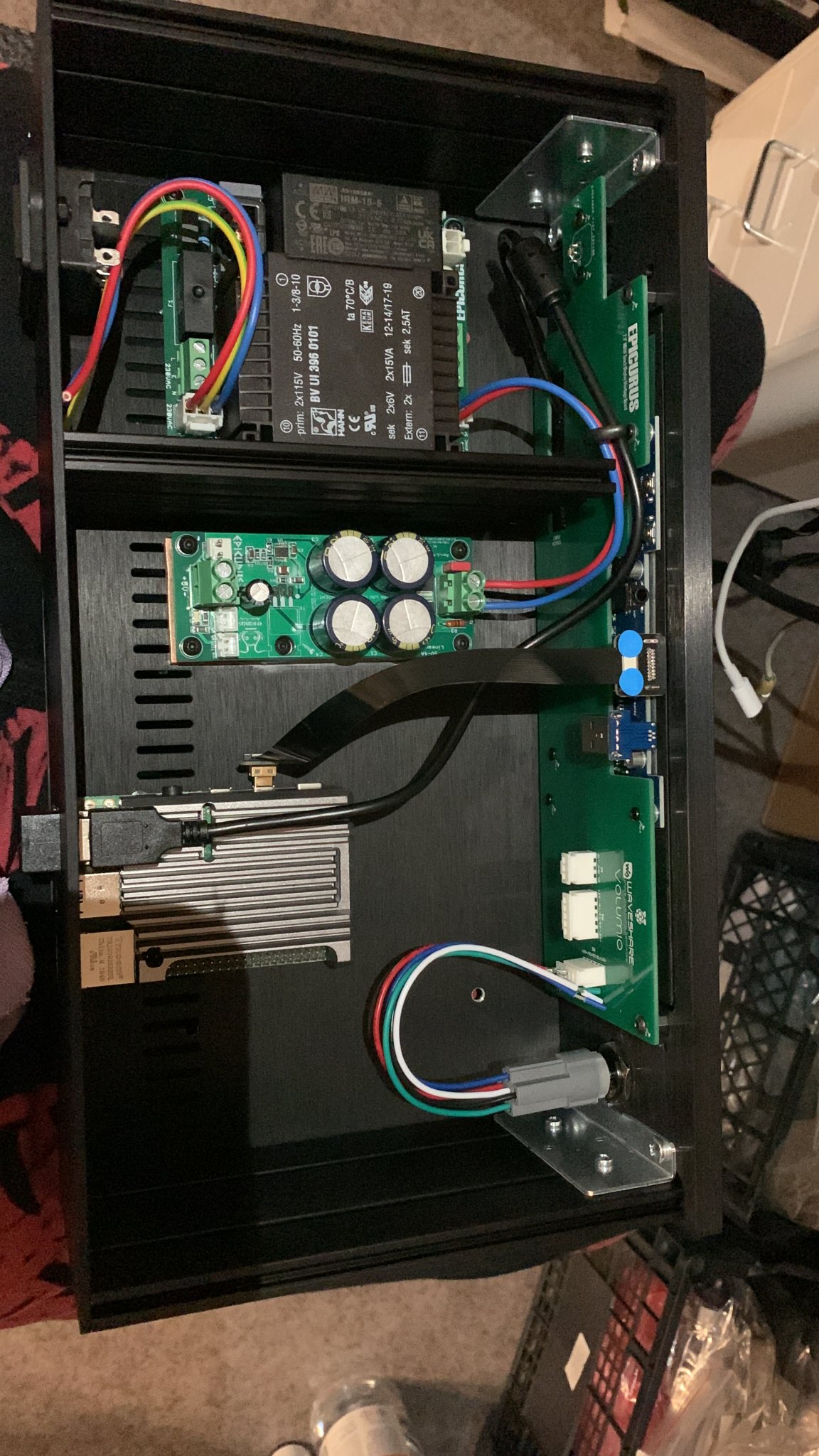

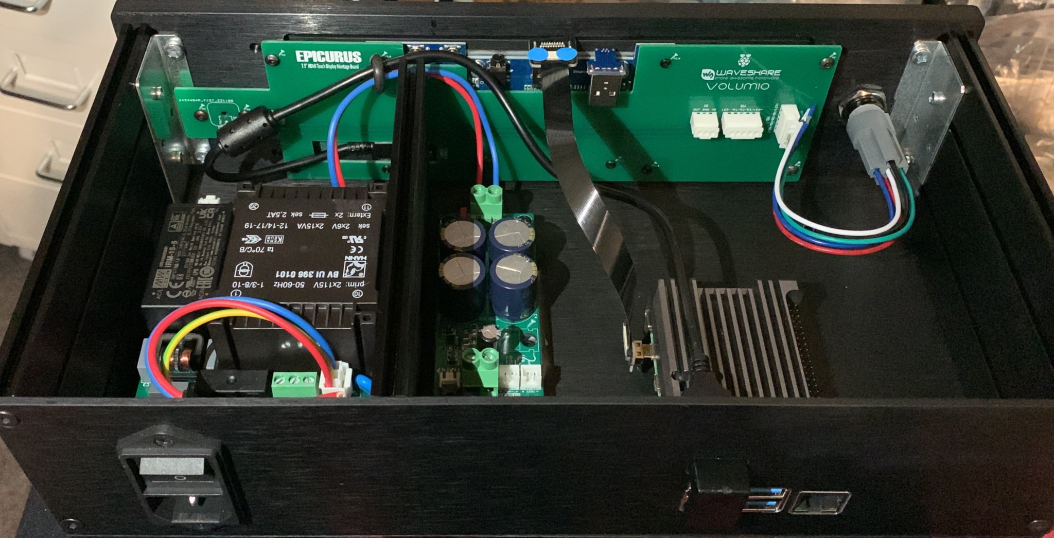

Oh very nice, thanks but I will make a PCB this is for a External Audio equipment, I need to put this PSU in a external box.
Great work and thanks for your proposition I really appreciate, are you Engineer ?

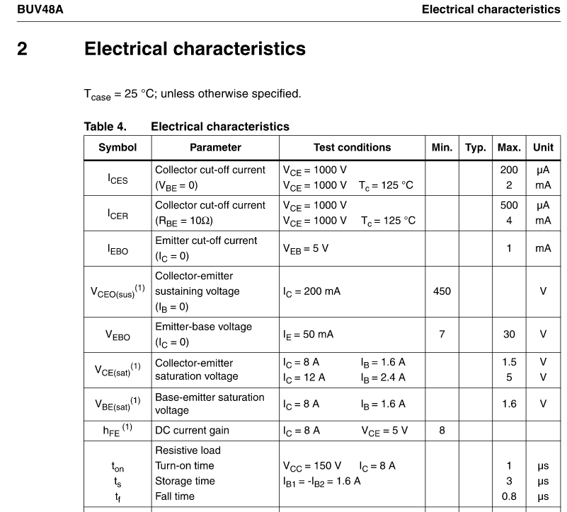

You can build lt3042 npn high current version with lt3045 and D44H11 but carefull about lt3045 pins. If you need to Continuous more than 5A always. you can try BUV48A but I not sure I havent tested it. input voltage must be 16.5-18v and you need to really big heatsink. Please create good ground plane for lt3045...
