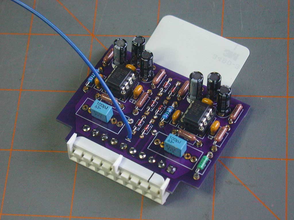

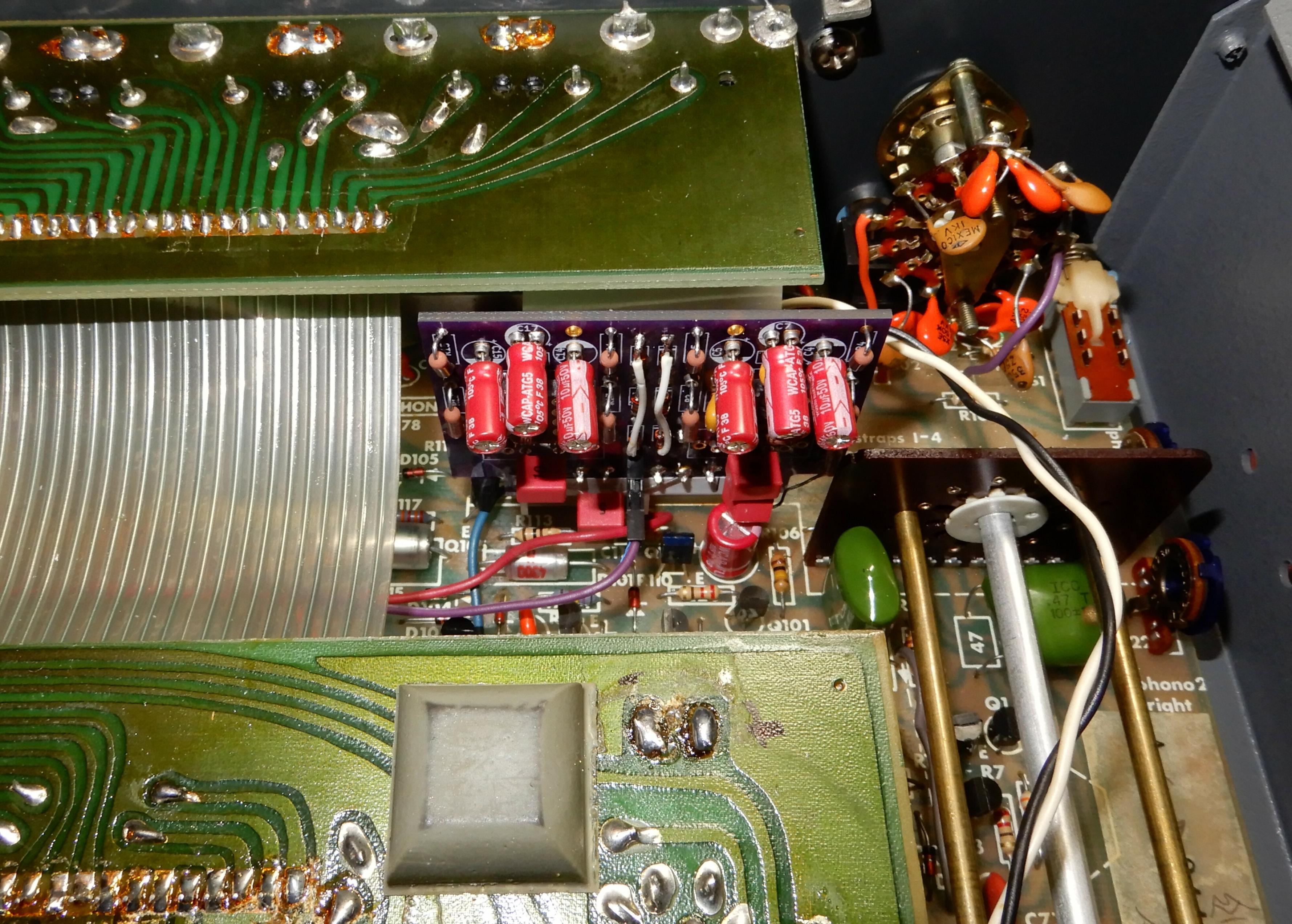

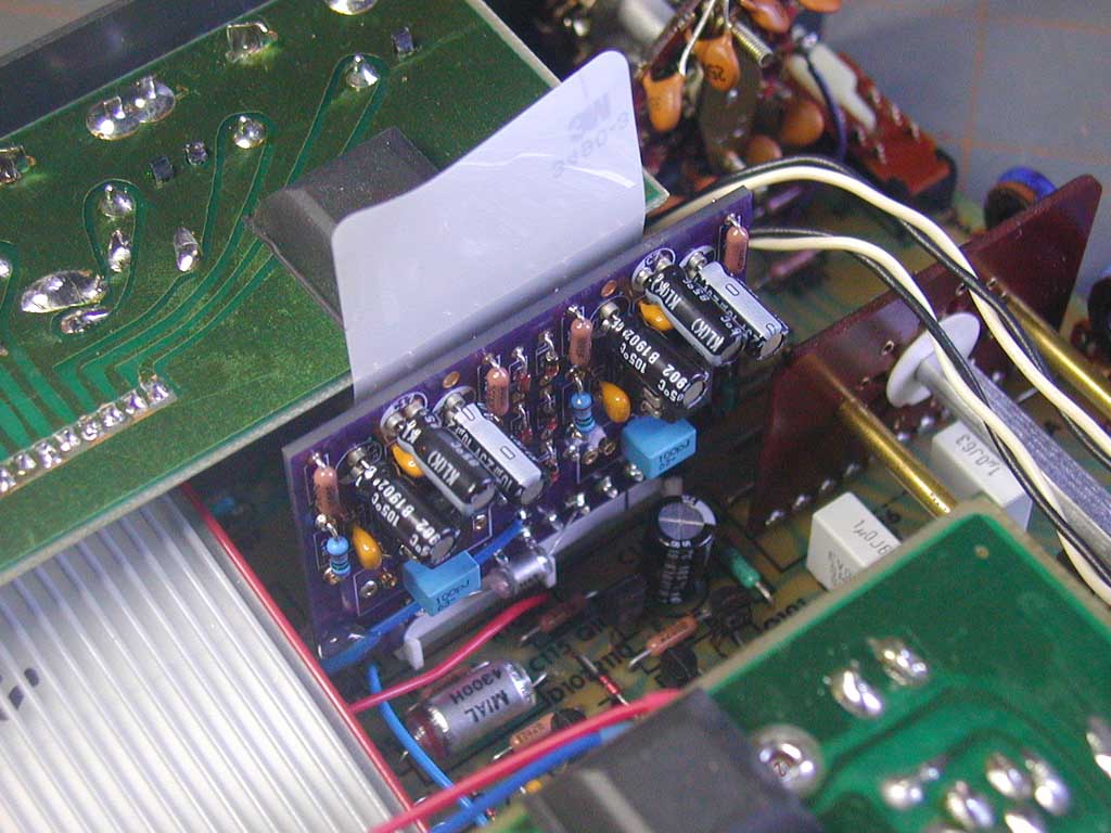

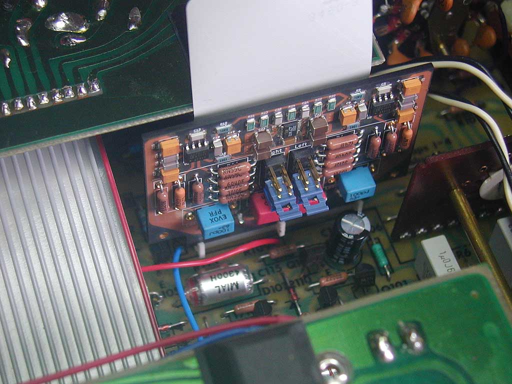

While rebuilding my Apt Holman, I kept looking at the empty MC expansion header, thinking it's a shame to let it go unused, and wondered if something could be done about it. With some careful measurement of the insides & close exam of the schematics, it seemed feasible, so I decided to try building a board for it.
Having never seen an actual factory MC card (real or photos), or schematic of one, or know anyone who has one in their Apt, I didn't know how they'd built or fitted it, so had to wing it somewhat.
The goal was to build something simple & small enough to fit within the Apt confines, using quality, proven components, with performance worthy of the Apt.
It's based on the AD797 opamp, as these have been used in other MC head-amps with good results and performance, and are easier than discrete transistors for non-EEs (like me) to work with.
With the sage advice of real-life engineers, the schematic and PCB layout were drawn, and the boards fabricated and populated. Made a couple of mistakes on the physical board layout, but not the circuit, so was able to work around them.

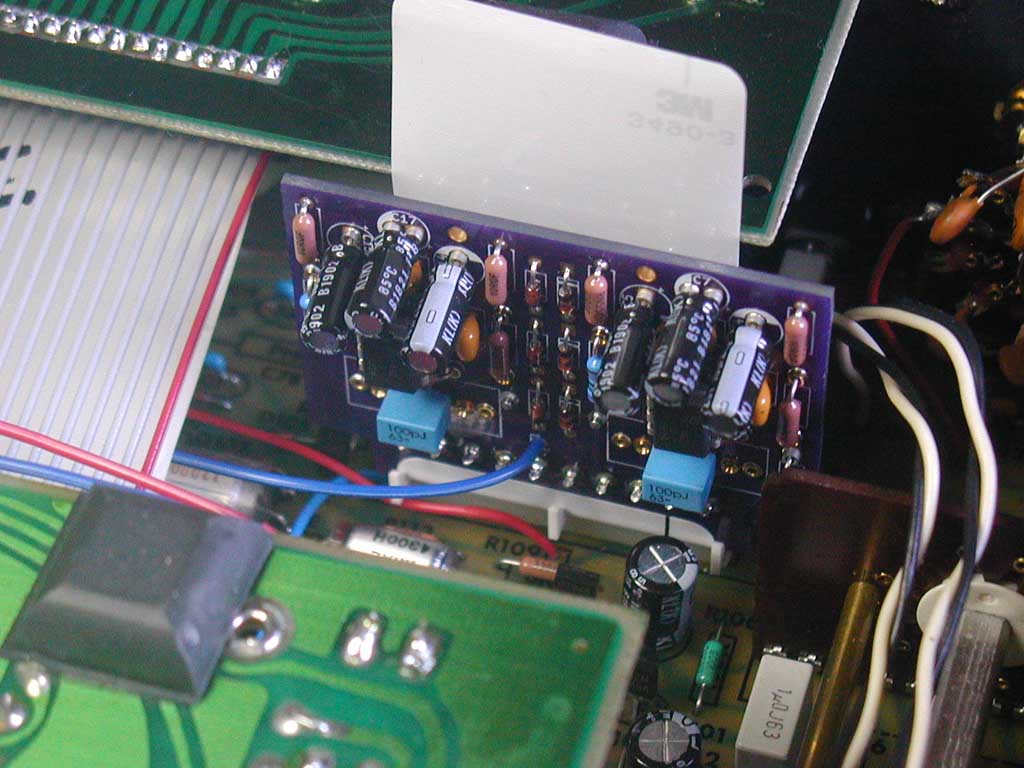

The Apt expansion header only includes +18v, so had to bring in -18v by a separate wire tapped into the main board. Kind of a kludge, not plug-n-play, but it works.
It fits good and sounds great, so the main goal was accomplished. Concept proven, I've started working on a newer design that won't need to tap into -18v (and w/out the mistakes!).

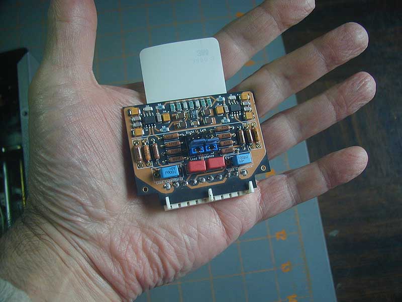

This is what I have in mind for the 2nd. version:
I can vouch for the design concept and execution by HalfApt! He was kind enough to provide a board for me to build, which I did using the same high-quality, close-tolerance parts, adjusting only for R and C loading of my cartridge. Because this was essentially a beta version, there were a couple of parts tacked into position, but the new board design will conserve on space and provide some additional flexibility for loading.
Thanks for being a willing beta-tester/guinea-pig! :D
Version-2 is built, tested, installed and working great!
This one has on-board low-noise split-supply adapter, so 100% plug-n-play. No more tapping into -18v from main board.
Load resistance jumper selectable. Gain resistors & load capacitor socketed, so easy to change at will (w/out de-soldering re-soldering) to accommodate any cartridge.
Sounds fantastic, slightly lower noise than first version.
It's a tiny thing, the SMT parts were challenging:
Beautiful work! Work of art with the SMD parts, very impressive.
Thank you! It did turn out better than I expected.
I had done very little SMD hand-soldering before, but I knew going in, with the complexity and close spacing on this board, that I couldn't do it by hand, so went to a more "pro" approach (that I wanted to learn anyway).
Used a stencil & solder paste, did the actual soldering via the "hot-plate" method on the kitchen cook stove! Was able to match the solder thermal profile to w/in 5%.
Most important, it works great, every bit as good as the first version, perhaps better, with less noise!
It's a keeper!

Not selling, sorry. Only 3 boards were made and they are all spoken for.
I'd be happy to provide board files if you want to have some made, and a parts BOM, but you'd have to build it yourself.
The surface mount parts are very challenging, I would not recommended if you're not comfortable soldering tiny parts (0.5mm pin-spacing).

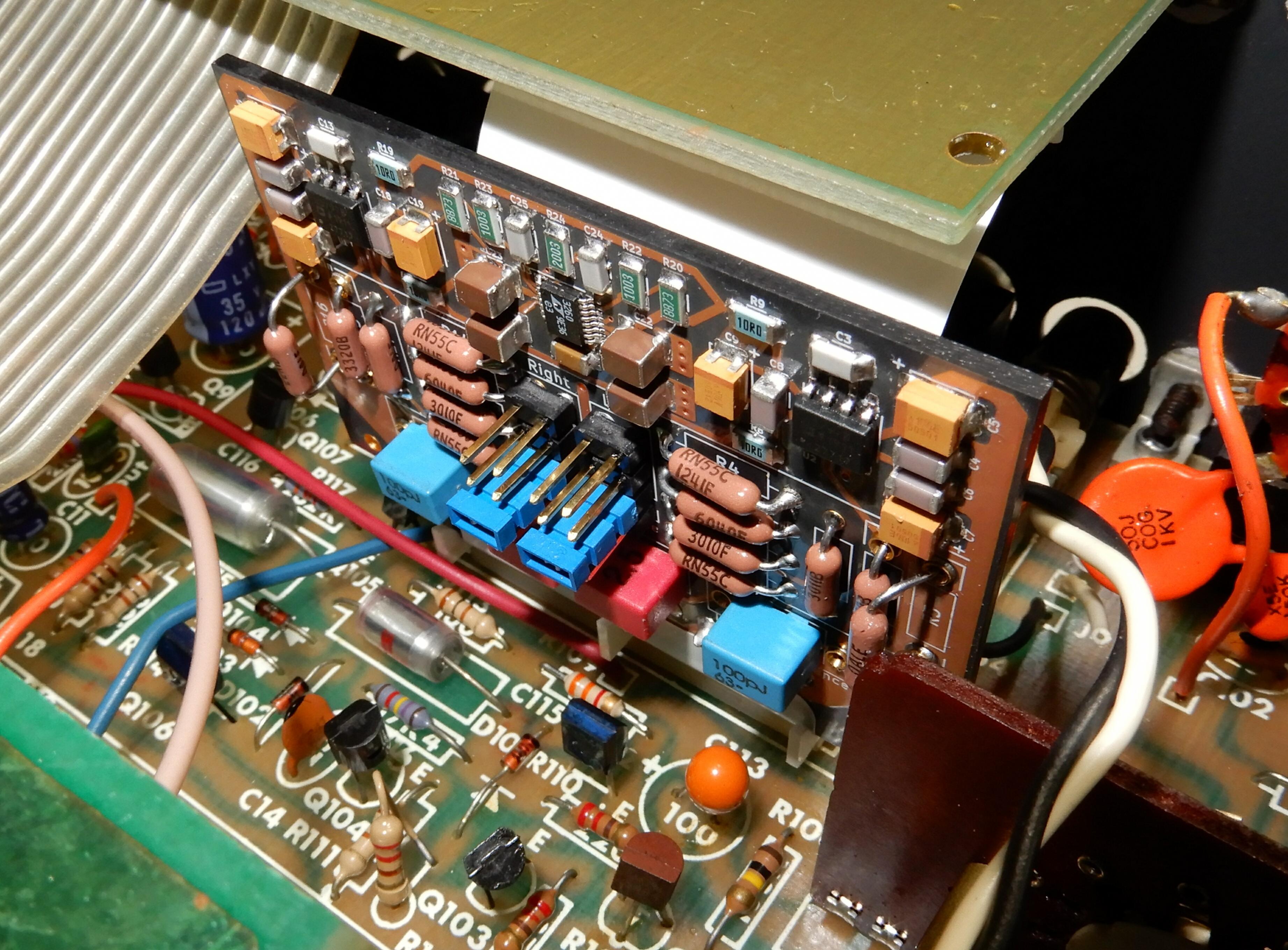

I'm the builder of the other 2 cards that Sean has created (one built, the other waiting for me to build up my confidence to do the next round of SMD placement and soldering), and I built one of his Version 1 boards. Version 2 is much more self-contained, very versatile, and excellent-sounding. However, the SMD construction does require careful planning and execution. I messed up my first attempt when I installed a resistor in the wrong location, and in testing fried a couple of $10 components. However, that experience has helped me develop a slightly different process that I'll use on my second board.
Sean's Version 1 was excellent, but his Version 2 design is really impressive. I have never owned the original Apt MC board, but I really prefer the advantage of more state of the art components and design and DIY nature of Sean's board. Here are a couple photos of my build.
