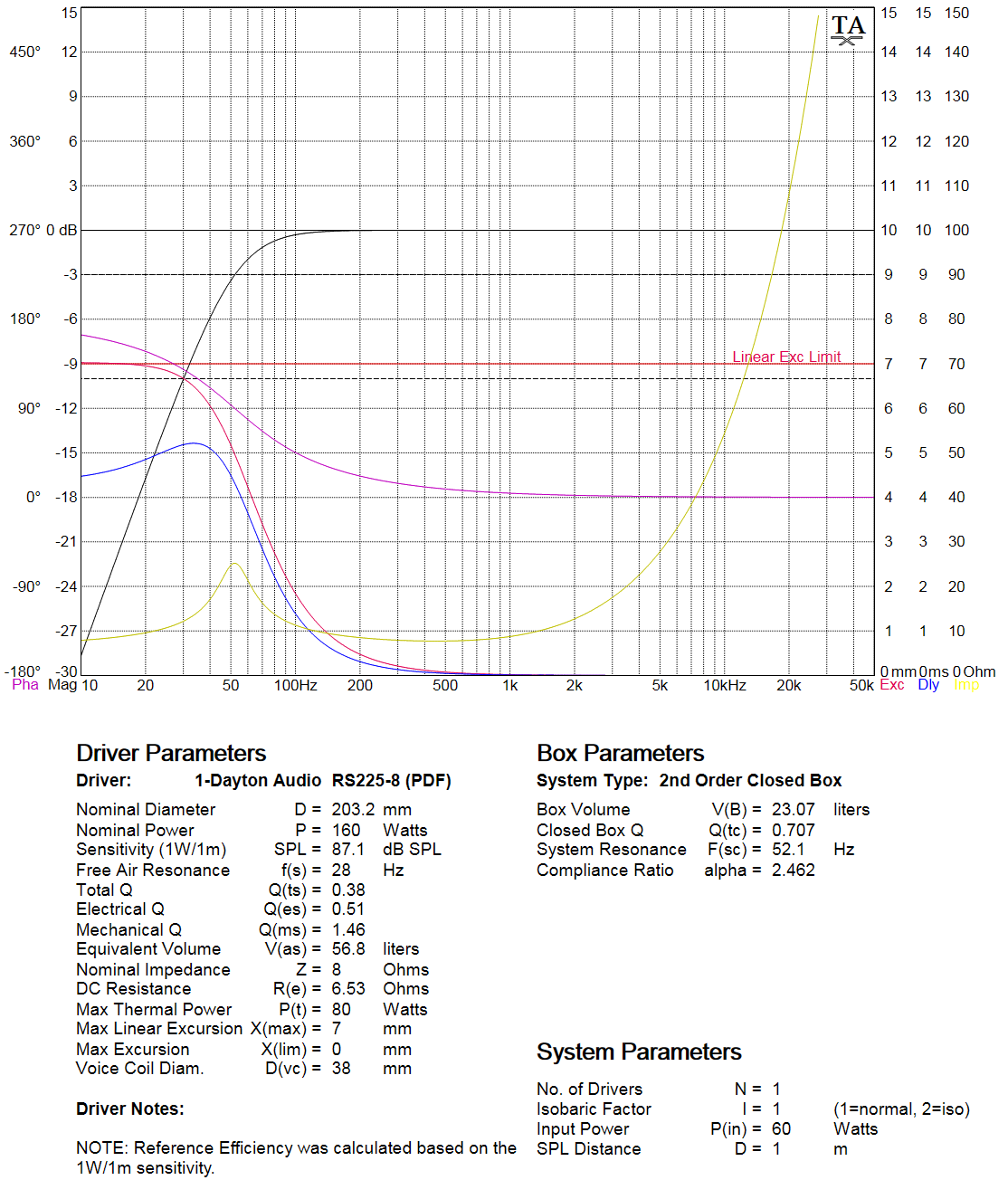

No, Sreten is right, Dayton RS225-8 has ideal TS parameters for a closed box. Simple math (presuming the published TS parameters are close to truth):
Let choose Qtc=2xQts=0.76 (with stuffing will be less than 0.7)
Then, volume of the box Vb=Vas/((Qtc/Qts)^2-1) = Vas/(4-1) = 2cuf/3=2/3 cuf
When you add volume occupied by the woofer and the midrange box, it will fit in your 1 cuf box.

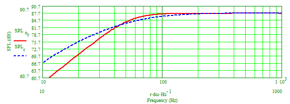

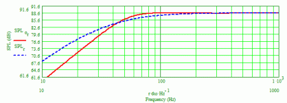

People won't want to help you if you are quick to dismiss their suggestion because it doesn't fit precisely into your 'optimal ballpark' of TS parameters :rolleyes: TS parameters and box modeling is a multi-dimensional problem anyway - by ignoring a driver because one or two parameters are outside the range that you consider 'ideal' you could be ignoring drivers that will still accomplish what you want. The RS225-8 fits the requirements in your opening post almost exactly.
I just did a quick model for the RS225-8 in a 0.93 ft3 sealed box and got an F3 of ~55 Hz with the box stuffed with poly fiber at 0.5 lb/ft3. If you made the box's gross volume be 1 ft3, then the net volume should be close to what I modeled. I used Martin King's sealed-box Mathcad-based software. I also used actual T/S measurements for this driver from a personal build of a couple years ago. The RS225 certainly seems to fit the OP's requirements. The SB Acoustics 8-inch, aluminum cone woofer, SB23NACS45-8, is similar to the RS225, but should provide a bit lower F3 in the same box I modeled. BTW, OP, I'm also a retired engineer (BSEE) and have designed and built a significant number of speakers.

Modeling graphs
To close the loop, I've attached modeling graphs for the RS225 and SB23NAC in the same sealed box that I described in Post #17. The first graph is for the RS woofer and the second the SB woofer, both showing the predicted bass response (red line) for an input of 2.83v/1m. F3 for the RS is ~54 Hz and for the SB is ~49 Hz, with the SB woofer a bit more sensitive. Both woofers modeled using actual T/S measurements as opposed to published values.
Paul
