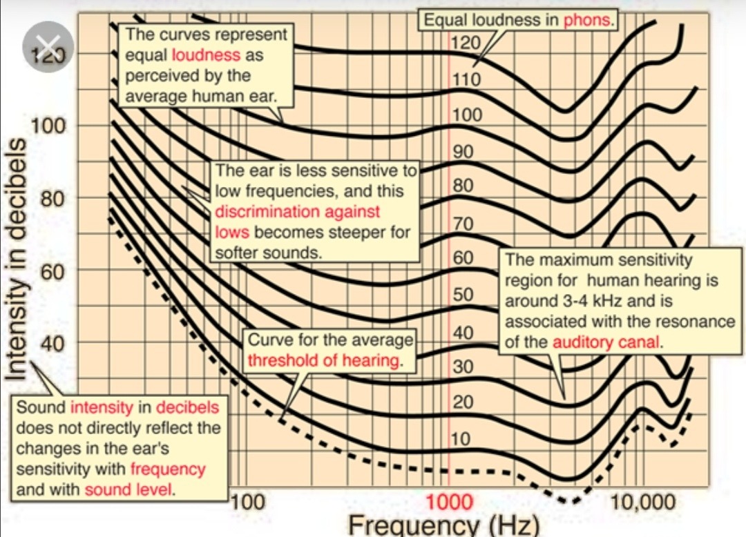

Bjorn told me that the crossover point at 1600Hz is a bad choice...
So my question: where is the best place to crossover? I know it always a compromise but maybe a better one?
In my direct experience, 230-300 Hz with an Axi2050 on a K-402 horn works well.
Using other 2" drivers, I recommend something around 500 ±100 Hz. I don't recommend crossing higher than 900 Hz-1 kHz--for some pretty important psychoacoustic reasons (starting on slide 17)--if clarity of presentation is important to you. Getting the throat apertures within 1/4 wavelength at the crossover frequency is pretty important for performance reasons, in my experience.
Perhaps you should consider stating your loudspeaker design requirements--rather than inserting apparent design solutions...which perhaps much less clearly imply the requirements assumptions that you're making.
I don't really buy that a crossover between x and y is a bad choice. I can cut up to 300db/oct, if needed, in FIR with time correction and you would never be able to guess the crossover point, specially at the listening position but also off axis to reasonable angle if I do my job well. This concept is probably a general idea that was developed using passive or low order crossover points.
The crossover point should be where one of the driver start to get low on SQ or dispersion doesn't match properly in my opinion. If this happen to 1600hz and it's done properly I don't see any problem.
Some of my horns/drivers can be crossed over from 1500hz to 5000hz and there next to no SQ difference because both can do a good job in this range. Having some latitude for the crossover point can be useful but not necessary if the selection is done properly.
