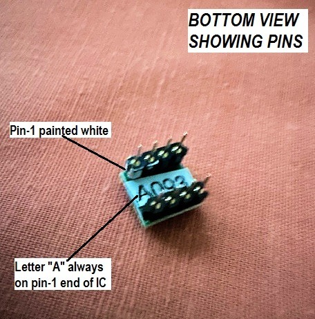

In Pearl 3 post #1,396 I offered to send out pairs of opamps, to perform blind listening tests in the Pearl 3 phonostage:
If anyone wants to listen to their Pearl 3 with "rolling opamps" in a single blind test, shoot me a PM.
I'll send you some dual opamps whose part numbers have been sanded off and painted over with different colored paint. You won't know which is which and I won't tell you the ones that are, or are not, in your batch. Maybe I'll send you four sets of identical dual-741's (perhaps RC4558 etc) in different colored paints, because I am a sadistic baxter. Maybe I'll send you some bleeding edge Telleurium-Gallium-Phosphide military grade opamps on SOIC-to-DIP carriers, mixed in with TL072 and LM358. Who knows. Maybe the best of the best of TI and Analog Devices and Cirrus Logic, all mixed together. If you're willing to possibly make a fool of yourself by "hearing" superior performance from 60 year old dual opamps, ... let's party.
You and I will split the cost of the parts and the adapters and the postage, until you post a message here containing your listening evaluations. Then I'll send you the other half of the money --- and your net cost (in money, not reputation) will be zero.
Do I have a protocol which guarantees there is no lying or changing-your-mind about what color is what opamp? Yes. And it is so obvious you should be ashamed of yourself if you even think to ask.
Let's party.
Then in Pearl 3 post #1,765 I showed three photos (attached below) of the anonymized opamps.
Next, in post #1,817 I presented the (encrypted) table of opamp_part_numbers and their corresponding serial_numbers on the sticky labels.
And now, today, in Pearl 3 post #2,732 , the first listening evaluations of the blind test opamp rolling experiment, have been posted. I am thrilled that duyAudio member @Lvandoorn created a panel of four different listeners: himself, spouse, audiophile friend #1, audiophile friend #2.

Watch this thread for further developments including a timeline of how and when the decryption key will be posted, allowing everyone to see which opamp part# corresponds to serial number A785, A093, etc. I'm having a medical procedure at the hospital tomorrow, so there may be a few days of delay...

Dual opamp "A539"with score 8.2 in the @Lvandoorn shootout, sounded the best to his listening panel. It was more involving and had more life feel, really excellent in speed and attack. A539's datasheet is dated February 1971. Like all of the seven anonymized opamps, it was housed in an 8-SOIC package mounted on a SOIC-to-DIP header. More info in a few days.
