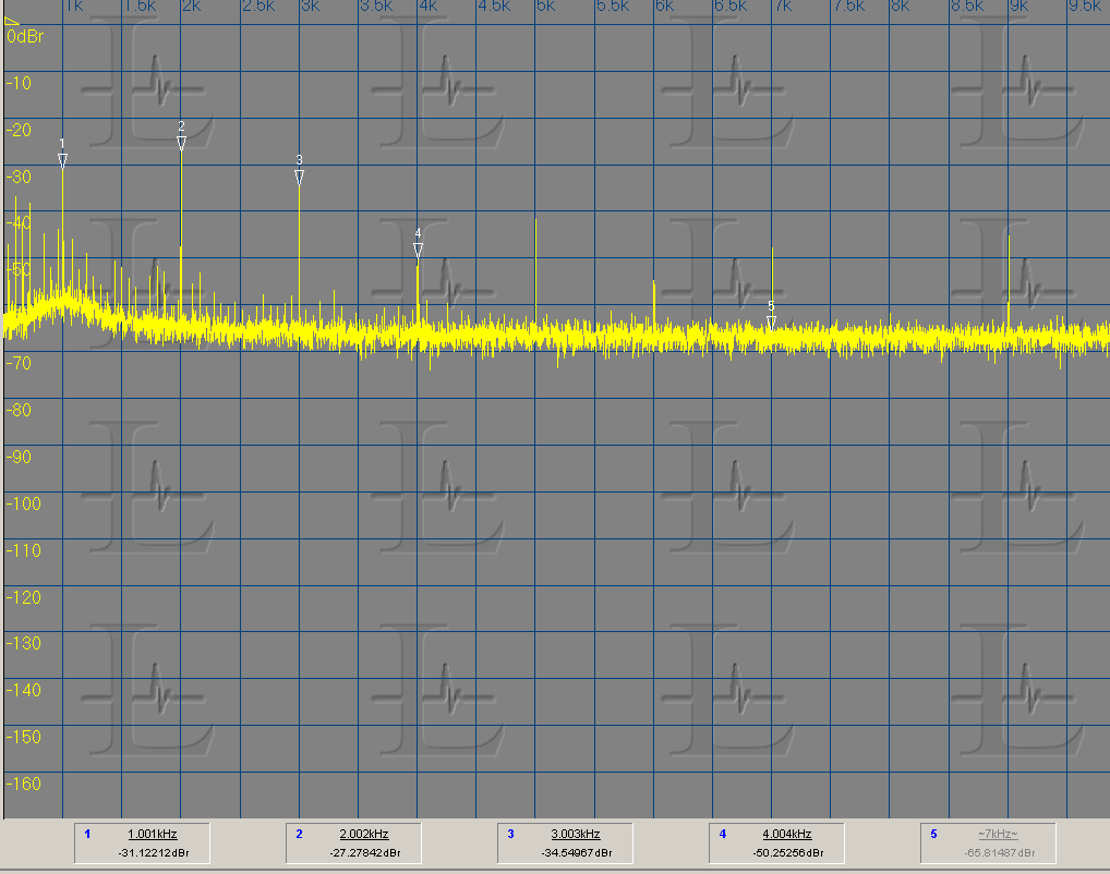

Below is the distortion residual at the output of the input board. Source is a modified KH4400 and the analyzer is the Shibasoku 725. The markers are on the distortion products. It also shows all the common mode noises in my setup. Most are post analyzer stuff. The levels are scaled property and can be read on the markers. The 2nd and 3rd harmonics are at the -125 dB level.
I can send you the modified board if you would like. I scaled all the resistors in the differential amp by .1 and got .1% resistors for the existing .1% parts. The 10K resistors on the input, R13 and R14 I replaced with light bulbs to get a much lower resistance and noise. in normal operation.

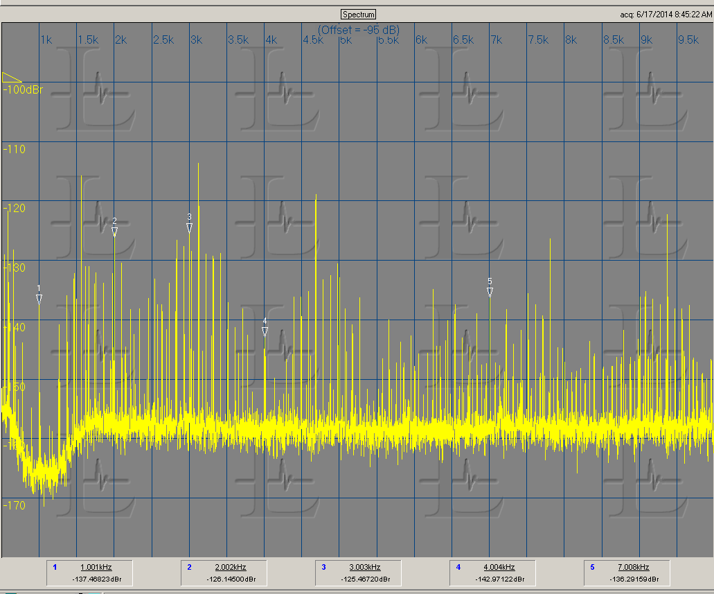

The second image is the monitor out under these conditions. It reports -104.4 dB under these conditions. This is where the scaling becomes an issue. The relative levels are easy but absolute levels are not.
