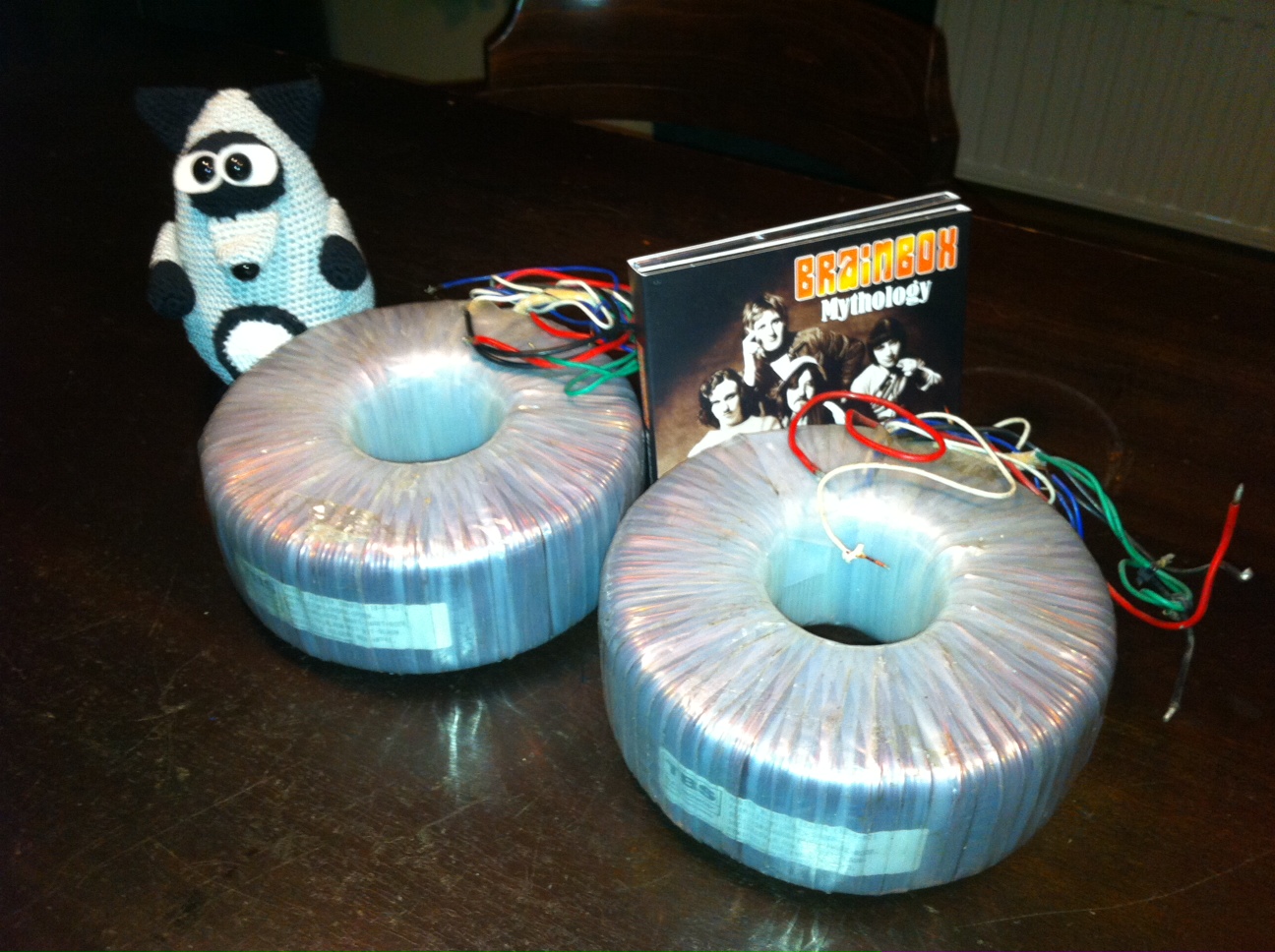

First parts I scored were some very cheap 1000VA 220VAC-2x50VAC transformers. Because we use 230VAC over here the secondary voltage will be a bit higher (about 52.3VAC). These are big and heavy...

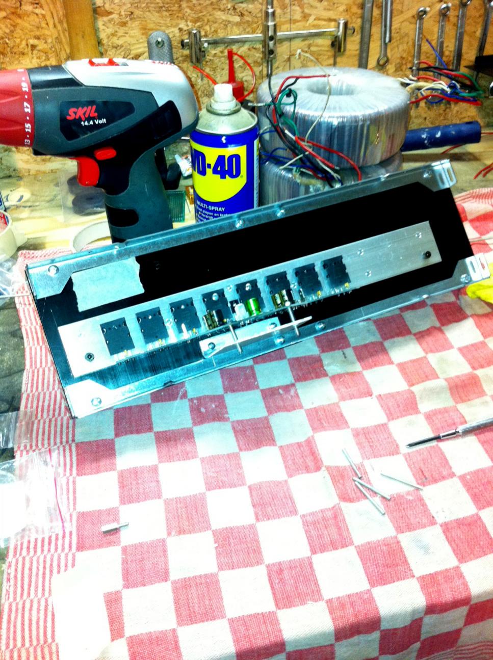

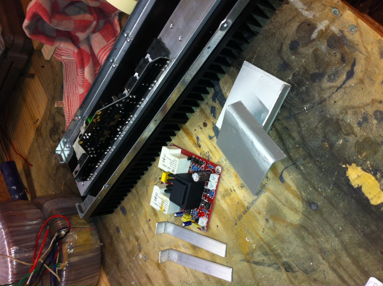

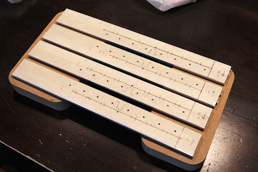

Making aluminium strips on which the NXV-500 will be mounted. I bought Modushop cabinets which have two heatsinks on each side. Strips make a thermal connection between the two sinks. Would have preferred a single heatsink on each side.

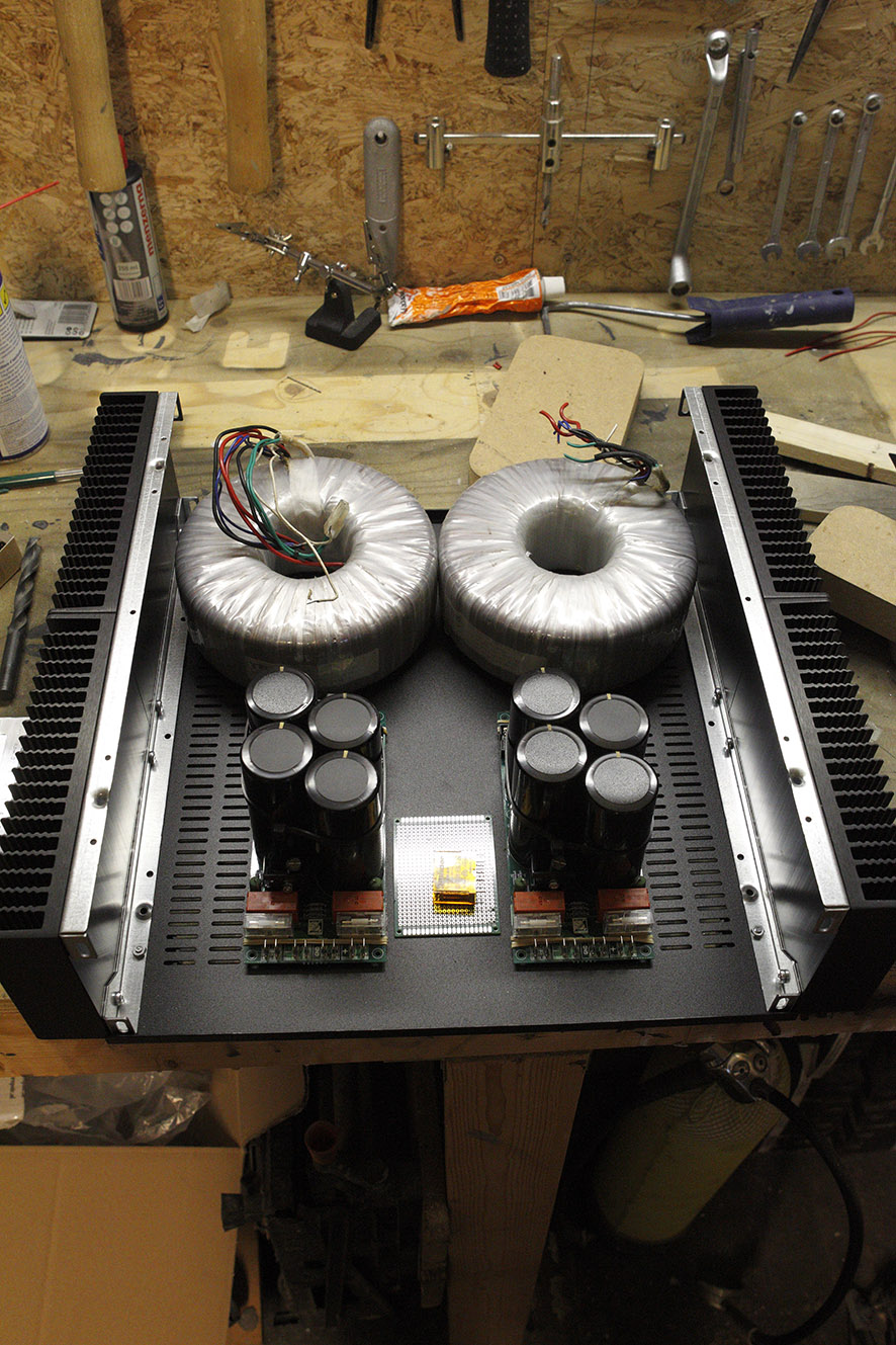

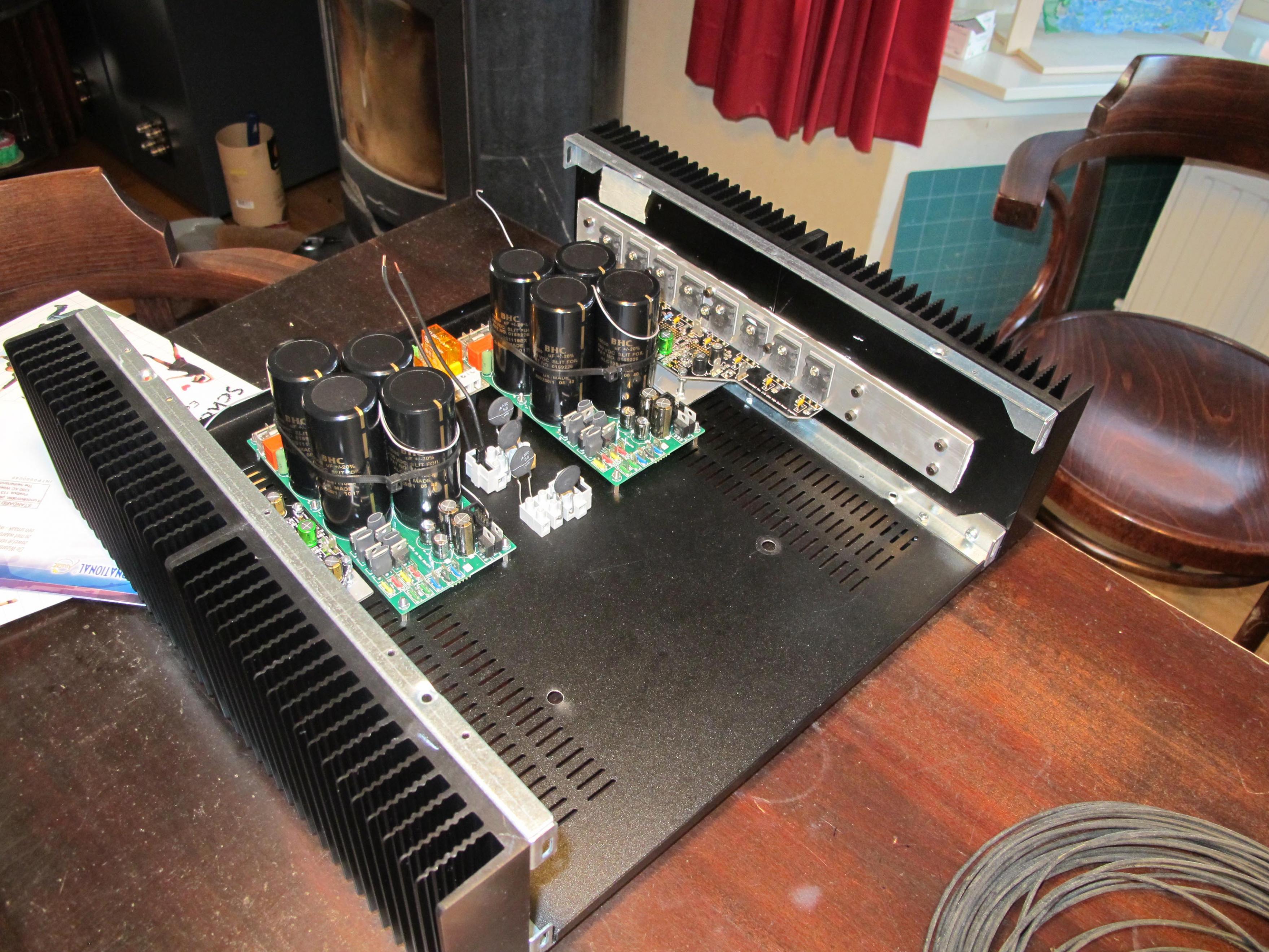

The power supplies from Hypex were on sale so I bought a set originally intended for a UCD700 because they have 100 caps on board. And DC protection. Board between the PS is a 230VAC relay for using a small switch on the frontpanel to turn the amp on/off (in combination wit some NTC's). But today I found a softstart from ebay on my doorstep which was sent to me by a friend :). Going to use these for turning the amp on/off.
In the mean time I finished the aluminium strips. Now I'm waiting for a big tube of thermal grease (is that what it's called?) to mount the strips to the heatsinks.
Looks like everything fits as planned...

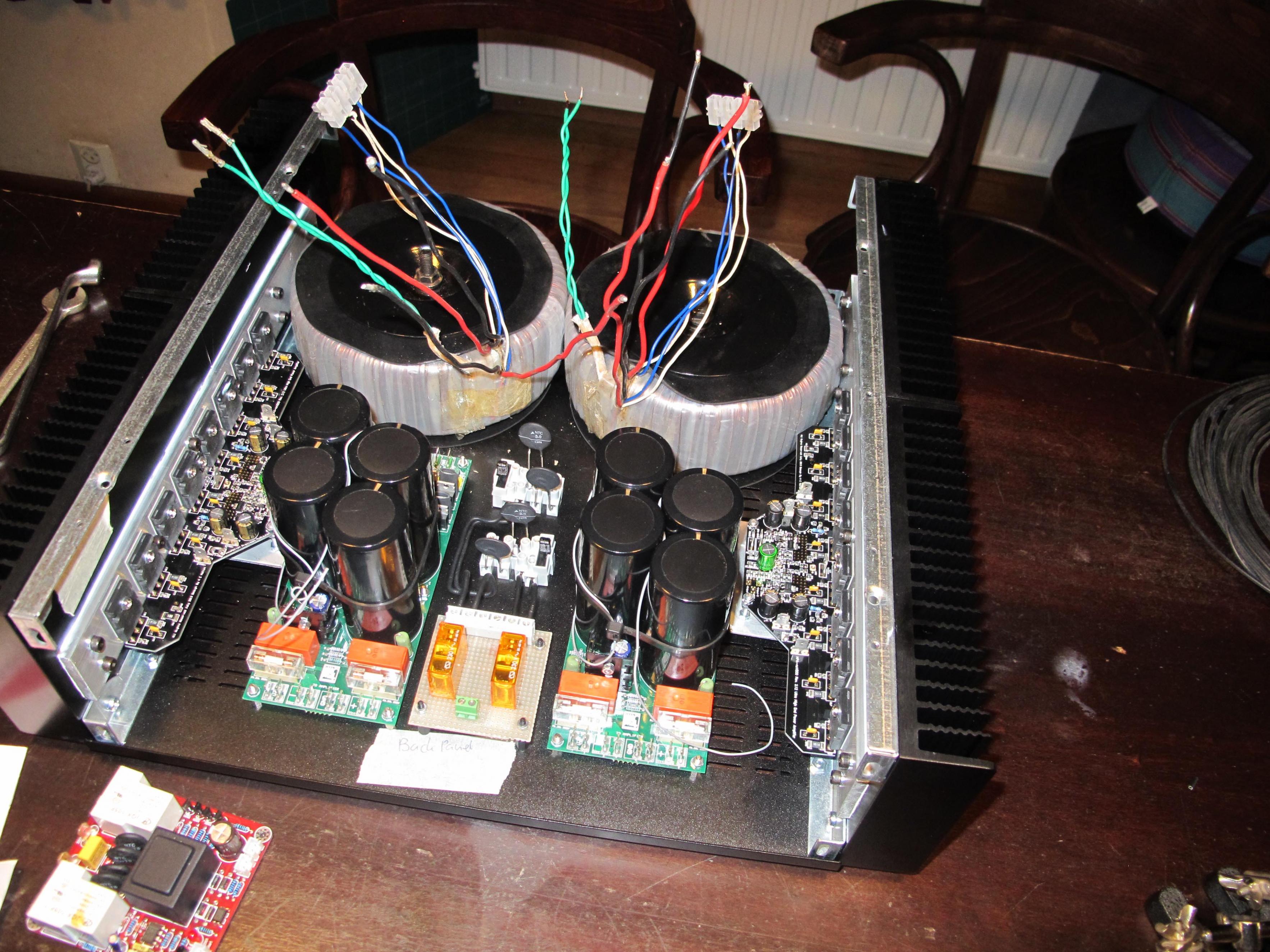

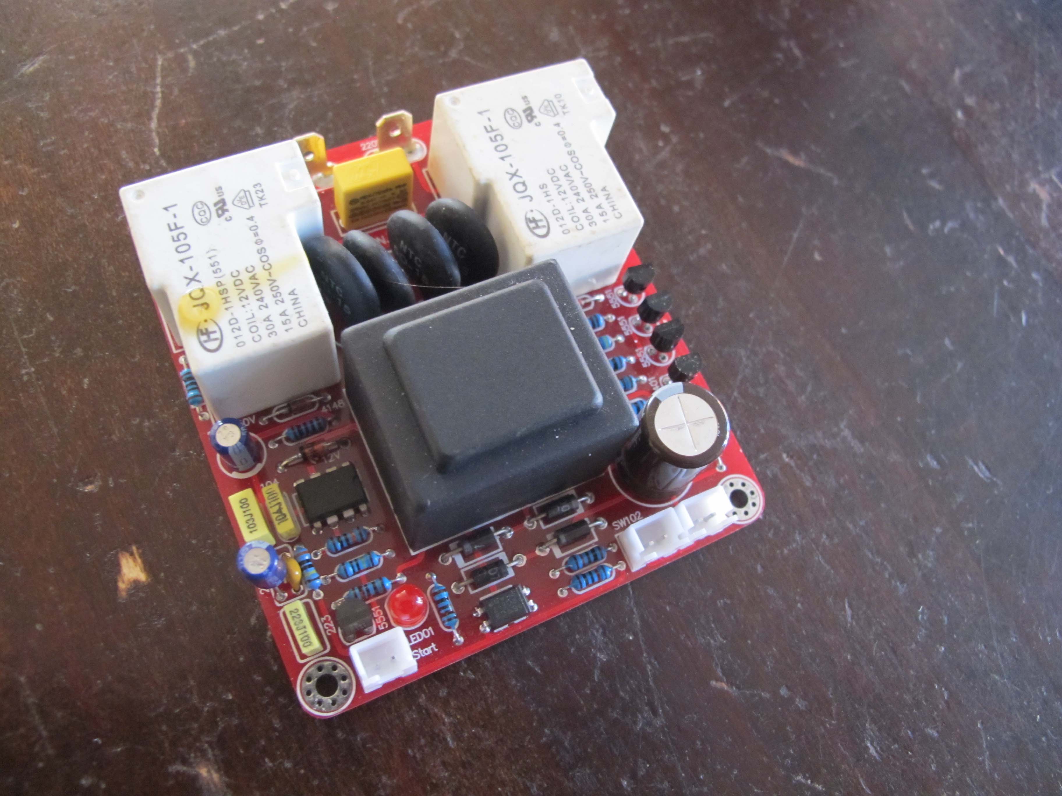

Found out that the Ebay softstarts do not really work as they should work. It switches on as planned but will only switch of after 10 or 20 seconds...
I now have a solution with a 230VAC relay and NTC's.

I didnt have any problems with Aussie amps soft starts, worked as it should from the start. Had a few problems with the speaker protectors, but thats all good now.
Look forwards to seeing the end product, enjoy.
Thanks Paul! The softstart I tried came from Ebay. It just does not function the way I want it to function. I switched to NTC as softstart and I'm using 230VAC relays so I can use a small on/off switch.
