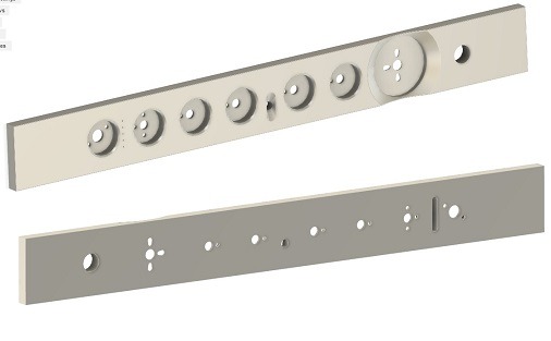

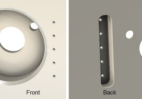

This regards the Slimline 1U, with the 10mm thickness front panel (450mm x 50mm).
My design has five 1.0mm diameter holes in the front panel. The holes are 2.0mm depth. On the back side, the rest of the depth is cut by a larger tool (to prevent breaking the small cutting tool). There is no other material removal required on the back side of the panel, everything else can all be cut from the front side.
I wanted to ask, does this appear like it should cut OK?
