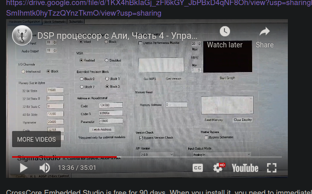

Could you post the software or provide a link to it? I'd like to try it out to determine its capabilities (different crossover types, etc.). It doesn't appear to support FIR filters from the pictures. I've used SigmaStudio (SS) on ADAU1701 DSPs, but it appears you have to buy an AD license to their CrossCore Embedded Studio add-on to use SS on the Sharc processors.
https://drive.google.com/file/d/1KX4hBkIaGj_zFl6kGY_JbPBxD4qNF8Oh/view?usp=sharinghttps://drive.google.com/file/d/1fxUe3G3VsK-SmIhmtk0hyTzzQYnzTkmO/view?usp=sharing
CrossCore Embedded Studio is free for 90 days. When you install it, you need to immediately launch it and register.
After 90 days, you can simply translate the date on your computer. :)
Reactions: 1 user

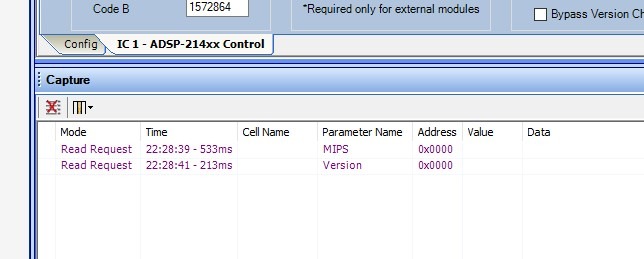

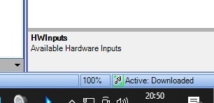

I have recently bought this 21489-
based board. It seems works fine with the proprietary software, but when I go to sigmastudio, even though all seems correct (USBi green, active downloaded ...) I always obtain 0 cells and 0 algorithms in the link project tab. I've flashed with MCU files provided by the seller in order to use SigmaStudio. No errors in the error/output tab.
Can anybody help me?
Thanking you in advance
Antonello

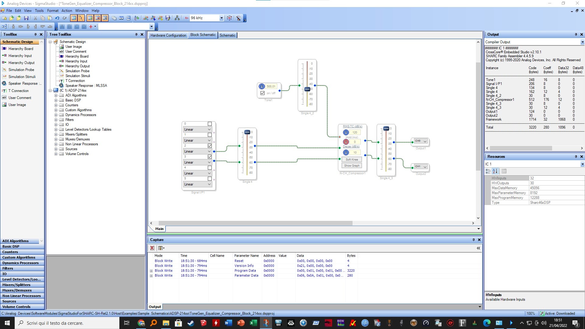

What program have you created in the SigmaStudio "Schematic" tab? That would be helpful to see. Your Workspace attachment says ther aren't any program cells or algorithms.
Dear ernperkins, I've tried many programs compiled by me as well as by others. From very simple to more complicated. An example is attached. I have changed the driver of USBi, changed PC, OS (7-10) processor (intel AMD), versions of Sigma Studio, CrossCore , sigmastudio for Sharc, toolbox, and the USB cable. Nothing, always the same 0 cells 0 algorithms. I feel that will be a little thing to solve the issue, but what?

If you have same board, you might want to watch video from this thread again
Setting in hardware configuration, looks like you have default values.
Those values are from 'official' sigmastudio project for this board, Slavakry explain in his video that other settings wont work

Ok, many many thanks for the suggestion. Changing the settings as indicated in the above-shown figure I can see how the bars of the level detectors dance. However, in the info table, I still see 0 cells and 0 algorithms. Is it important? Now I will try to download the program onto the chip for offline use. Many thanks again
Try running SigmaStudio project from vendor and see if that works for you
If I leave untouched the settings as indicated in Slavakry's video, the project attached in the seller's software pack works. Anyway, it still remains the 0 cells and 0 algorithms message in the info module.
Just a question: the setting indicated by Slavakry and the seller are detrimental to the performance of the board?
If level detectors respond then DSP should be functional in SigmaStudio, if I understand good those settings are for SPI Flash, where code is located etc. Not performance settings. If you have all the board and have audio output try adding filter in sigmastudio - low pass or whatever and see if that has effect.
