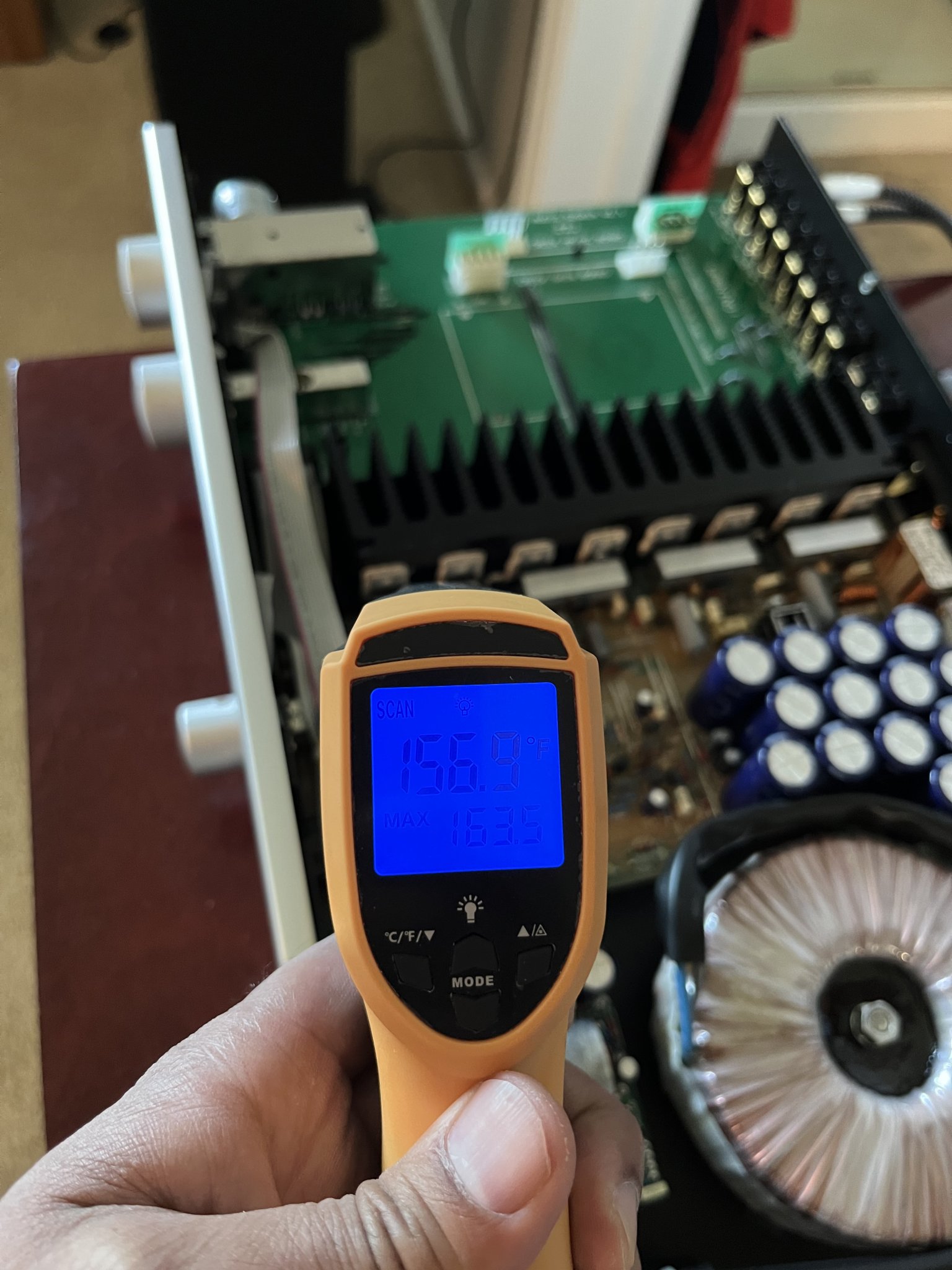

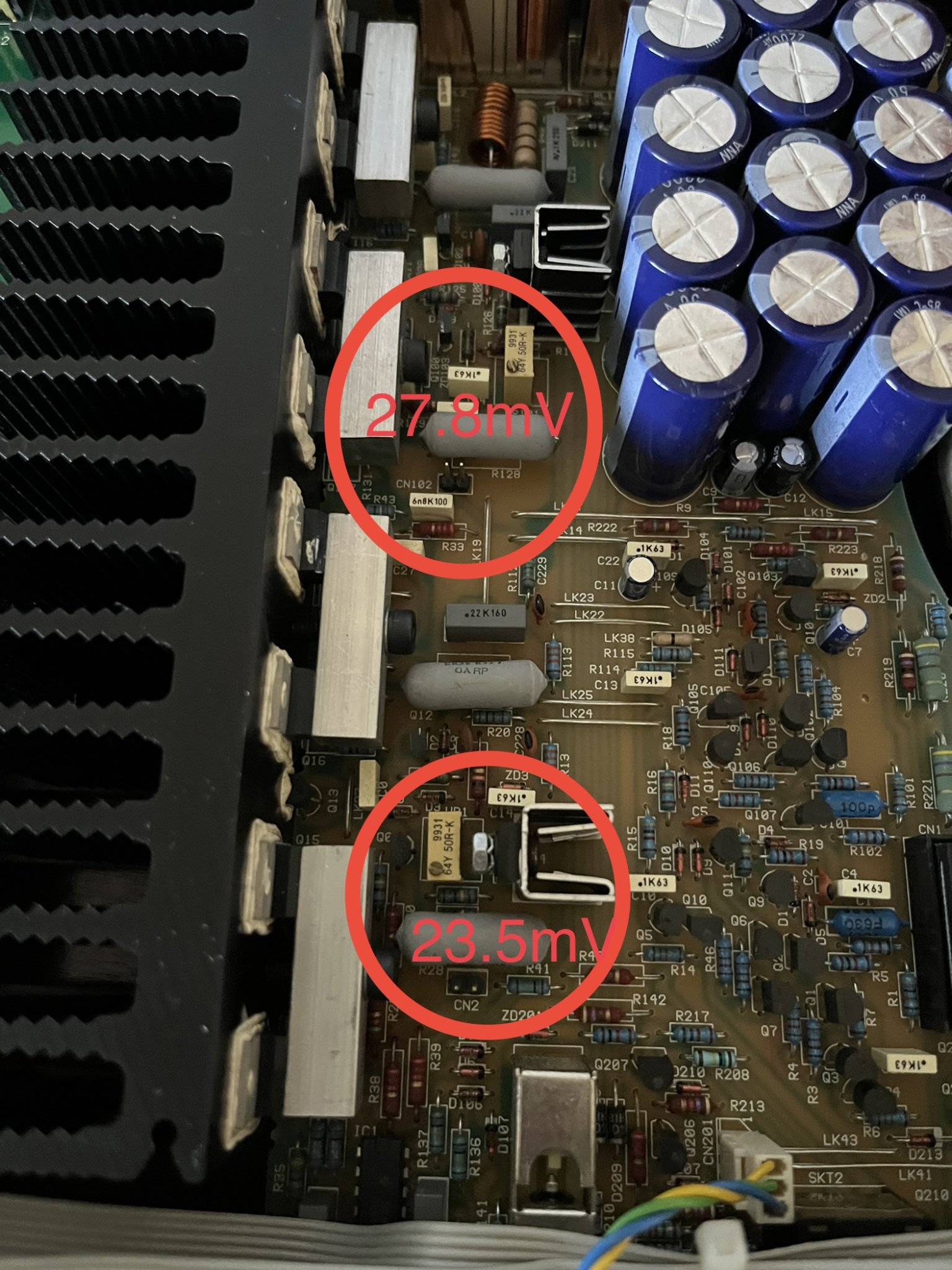

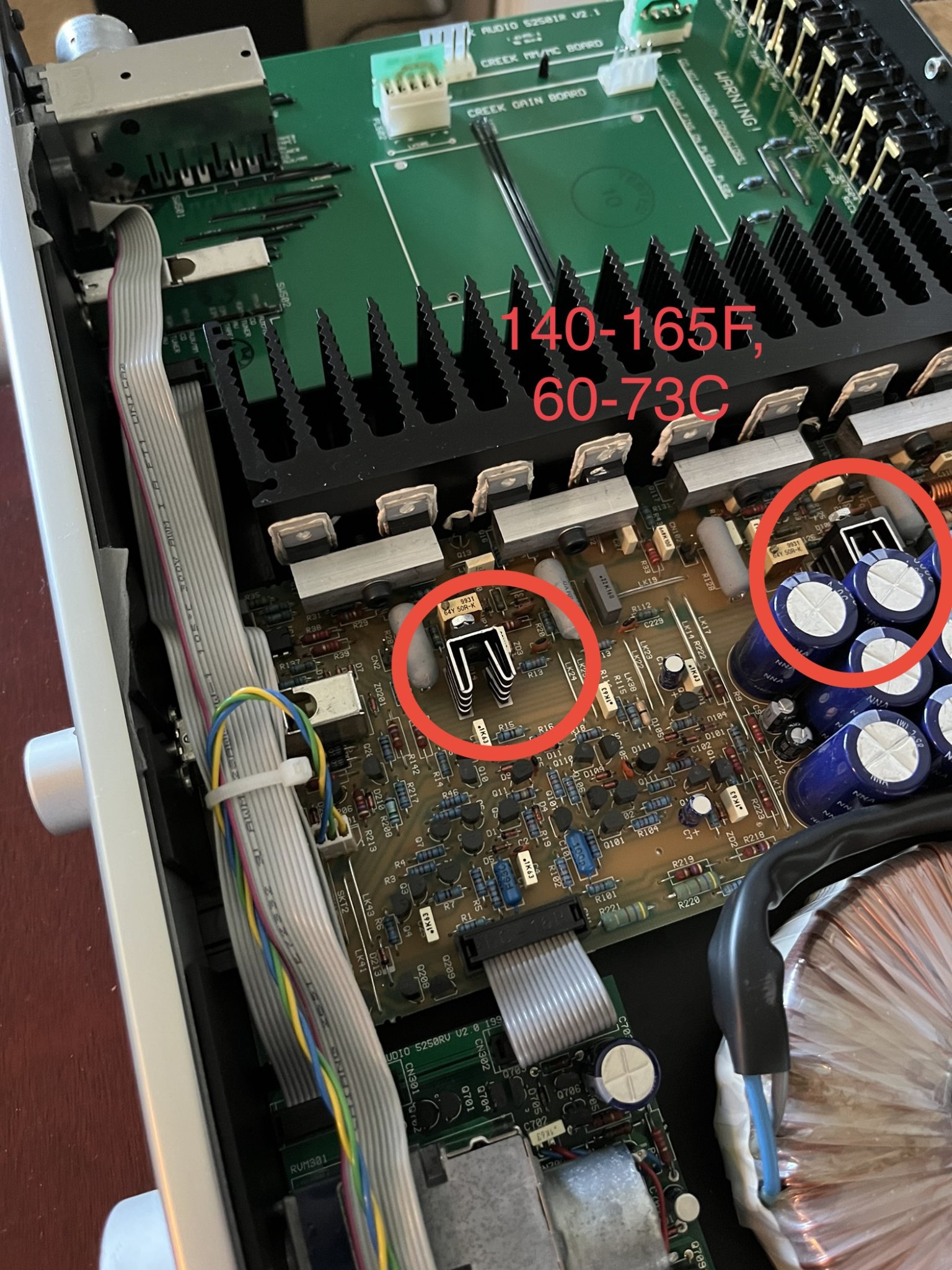

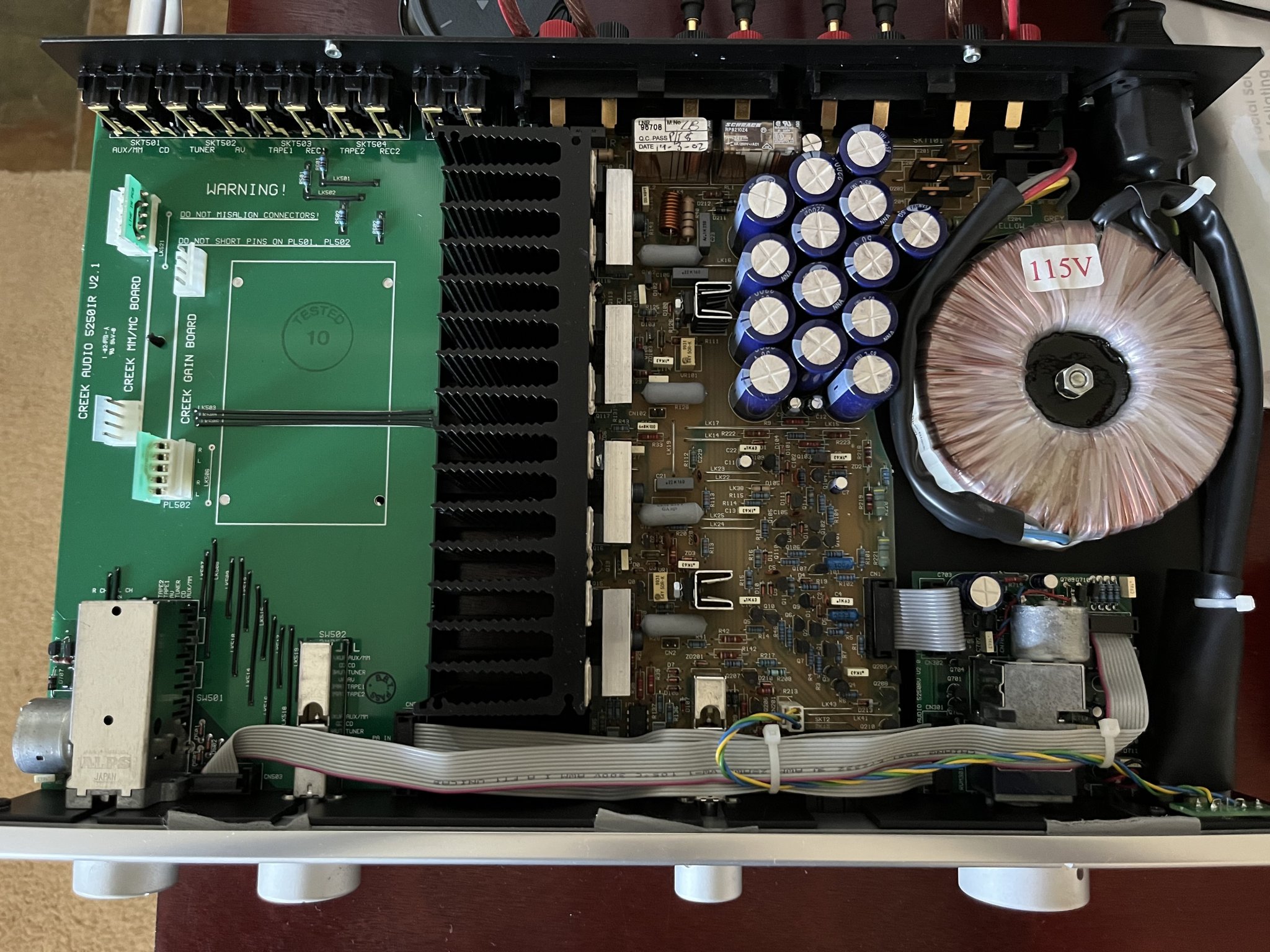

@frankin4 - I have an 02’ 5350se which shows a right channel drop out issue after about 30 min of listening. The channel distorts first and then drops out all together. A little investigating showed high temps at the output/driver transistors (140-165F+), and what I believe to be high idle current. Mine also sat for months, I pulled it out of storage a few weeks ago to use in a 2nd system, driving a pair of Vandersteen 2’s.
Few other notes: DC offset looks good (settles at 1-4mV), idle power draw from the wall is ~31W cold and 34.5W hot. My volume pot was scratchy, so I deoxed all the pots while I had it opened up.
Do you know what the idle current and associated mV value should be, and any guidance on the process to adjust idle current? I want to start there, but eventually, I’d like to do an overhaul of the entire unit, similar to what you did.

Those are exactly the symptoms I had with my amp. And those temps don't seem too crazy hot. I set the DC offset to 21.5mV on my amp, but I'm not sure this is correct. I would definitely not go any higher and I think you would be safe to set it in the 13-17mV range. I would test/replace VR-1, VR-101, Q0/100 and Q12/112 and maybe the MOSFETS as well.
To set DC offset at idle I would start by turning down VR-1/101 (counterclockwise) so you adjust from low to high, not the reverse. You want to avoid going too high because then your amp can become unstable and you start losing components in a hurry. But note that if there are other failing components you may not get a reliable reading at CN2/102. So it's best to replace those failing components first, then set voltages. Hopefully this makes sense.
Good info frankin4. I have my work cut out in terms of testing components and getting a good feel of what's good and what's not. I reached out to Creek and got a response from Mr. Creek himself. He confirmed that 21.5mV is the correct setting, and also provided schematics + other useful information. Anyone looking for further info on troubleshooting, feel free to PM me.
