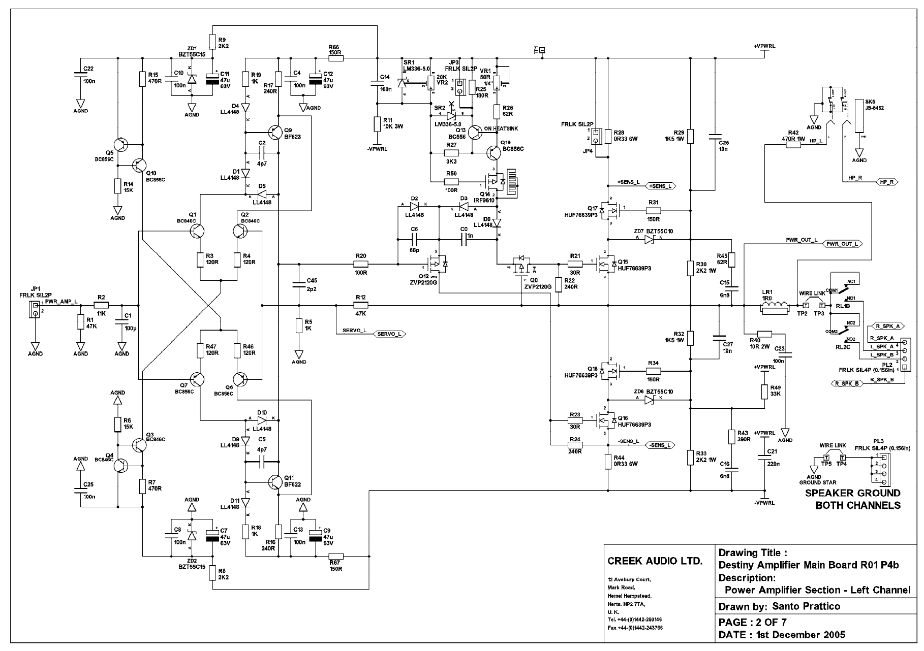

Hi All, I have rebuilt a Destiny Integrated with several new components. I've replaced the original HUF76639 MOSFETS with IRL2910 MOSFETS, which seem to be the best substitute. All seems to be working well. The idle voltage is stable around 21.5mV +/-.5mV every few minutes. I'm ecstatic it simply works after all the work I put into it. I've adjusted VR2 CW as little as possible for VR1 to adjust the idle voltage. I found that VR1 did take several turns before adjusting the idle voltage from .25 to 1 mV, and then rises exponentially WRT VR1. VR1 is around 30 ohms when idle voltage is at 21.5mV.
How important is fine tuning VR2? if I turn it CW this will increase the voltage across SR1 (LM336-5.0)(pins 4 and 8) passed 6 volts which is out of spec (4-6 volts) according to the data sheet. Right now SR1 (4-8) is at 5.93 volts. I am wondering if having adjusted VR2 out of factory settings will cause issues down the road with other components. Is adjusting VR2 important? If so, how should it be adjusted? Or are there other measurements I should make to verify the amp is working within design parameters? Any help is appreciated.

VR2 adjusts the current for the voltage references and bias current plus temperature compensation to a nominal 5V, otherwise it could be in the range 4-6V as you say. It's guessing, but I would assume the expected reference voltage would first be adjusted to 5.0V to reduce problems in the spread of component parameters likely in production. So Q13 must require a stable and accurate reference for sensing temperature of the output stage and hence applying correct bias current compensation.
Turns out I just found the 5350SE schematic. I think the rail voltages are different but the schematics in the area of VR1 and VR2 are identical with the Destiny. The 5350SE lists VR1 also at 21.5mV, and VR2 at 600mV +/- 10mV. Is it safe to assume VR2 the same on the Destiny - 600mV +/- 10mV? If I bring down VR2 so the voltage across SR1 is 5, then the idle voltage cannot be adjusted. I think I might be at a compromise perhaps because I'm using the IRL2910 instead of the HUF76639. Thanks for your help.

How different are the rail voltages? The Evolution 5350 MK2 is specified at +/- 40V with an output power of 120W/8R. There are original, 2nd editions, MK2 versions etc. of everything made by Creek so nothing is certain without all the service manuals. Even then, there may still be variations.
Evolution 5350 MK2 SE is rated 100W/8R so I would expect this to have a similar power supply but different transformer power rating since its 4R rating is 200W versus 160 for the Destiny. Otherwise, I would assume the settings to be the same unless someone comes up with exactly appropriate service details. for the model you have.
Joined 2010
54V rails sound about right for 100W RMS. The 40V shown on Creek's 5350 MK2 schematic must be in error. So Id set it up to the same recommended settings but with the protection of a dim bulb tester (DBT). Never power anything with new construction or suspected faults without it or something electronic that also immediately throttles the current when it exceeds the expected normal low level after switch-on.

Creek Audio responded to my email query and confirmed per design the voltage for VR2 (measured across JP3) is 600mV, even with the alternate MOSFET they’ve acknowledged is IRL2910.

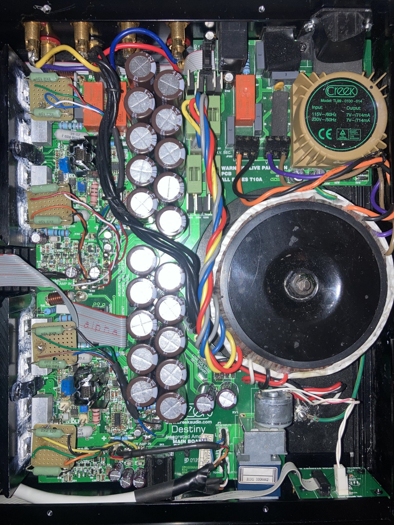

Congrats :) . I'm listening to my Destiny as I type. I still love how this amp sounds and hope to keep it for a decade or two longer with all the components I replaced. I am sure i replaced more than half of the amp. I installed Nichicon PWs for the 2200uF caps. And recently replaced the 6 wire input cabling with CAT8 24awg network cable which did improve channel separation but honestly can’t say I hear an improvement. Anyway, Glad to know there are more options for the output devices. I wonder how and if the lower RDS On value (~4mOhms) might changed the sound signature. Did you notice any change in the overall sound? I would have tried the IRL4030PFB if I knew about them a couple years ago when I replaced. I'm not sure if your amp has the same thermal issues caused by the 2k2 resistors in the Main Board as mine. If that's the case, one workaround is replacing the surface mount 2k2 power resistors- (R8(108), R9(109), R38(138), R39(139)) with through hole resistors. These 4 surface mount 2k2 resistors generate around 3 Watts in a rather small region and heat up nearby components to 60-70C+.
Best Regards,
Gregory
PS here's a photo of my amp with my modifications: Soldered most of the board to board connections after finding hum issues especially at JP1(101), 2k2 resistors moved above the board, replaced the LR Input to Volume cabling with CAT8, and bypassed preamp/amp switch.
