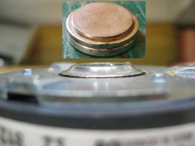

In case anyone wanted to know, because it doesn't seem to be in the spec sheet, I took apart a ND25TA tweeter. The magnetic gap is 2mm, the voice coil is either 1mm (top layer) or 1.3mm(bottom layer). Thus Xmax is 1mm or 0.7mm (p-p).
The VC uses 0.13mm wire. It is double layer with 10 windings on the bottom and 8 windings on top.

For a moment thought the Dayton ND25TA might use an upper (top) and lower (bottom) coil in a XBL² split gap motor like the Creative Sound Solutions LD25X, rather than the usual inner and outer layer.The magnetic gap is 2mm, the voice coil is either 1mm (top layer) or 1.3mm(bottom layer).
So ~1.5mm one way excursion would ND25TA's drive the coil completely out of the magnetic gap?
Any estimate of Xmech, where the coil former, surround, or diaphragm would contact some part of the magnetic structure?
I'd estimate >3 mm before the VC former hits the back. As for the suspension I'm really not sure.
I find the thinner magnet on top interesting. I don't think I've seen that in other small tweeters. Is it a bit like Purifi sticking a magnet on the pole piece? No copper here, though.
The thinner piece looks like a pole piece extension made of the same steel, rather than another magnet.I find the thinner magnet on top interesting. I don't think I've seen that in other small tweeters. Is it a bit like Purifi sticking a magnet on the pole piece?
The Vifa PL27TG-35 tweeter's pole piece also extends like the Dayton, though the Vifa uses a vent through the pole piece to increase the chamber volume, and is made as one piece, rather than two slugs glued together.
The Dayton tweeter pole piece extension would reduce it's chamber volume, and perhaps make the Bl(X) magnetic curve complement the Kms(X) compliance curve for better excursion symmetry, reducing distortion.
