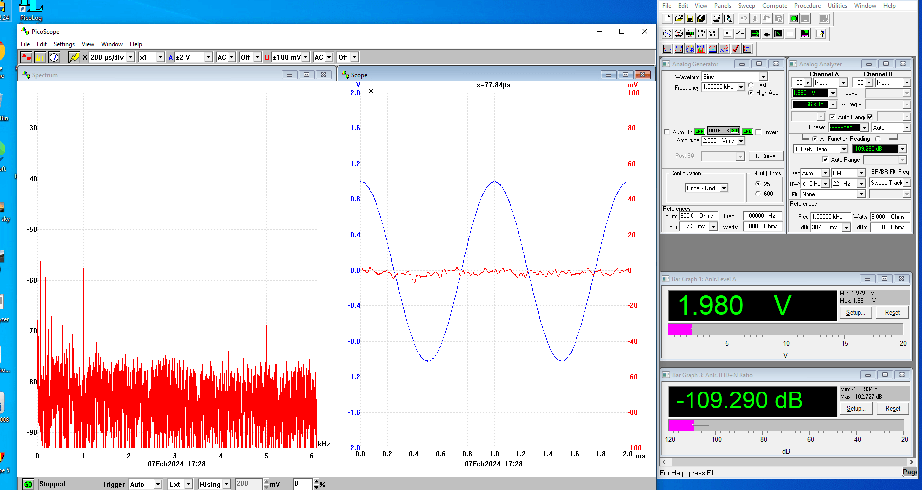

FWIW I have been using W10 mostly for years. I have it running on 25 year old hardware without issues. However several steps are important. First SSD's. They are so cheap today no reason not to. Second, a fresh install on older hardware and give the system several days to update etc in the background.
I have Win10 32 bit running on several systems now. 32 bit to support the AP system 1 interface (I know the USB works with 64 bit OS). The same system is working with a vintage Picoscope and the RTX6001.
I have found W10 to be the least troublesome actually.
