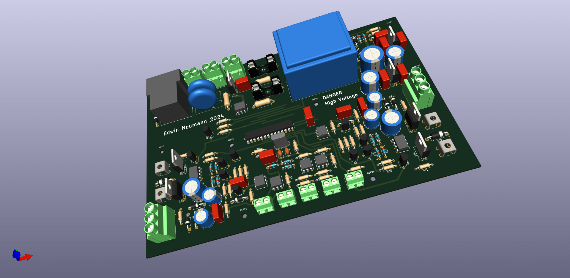

Some progress has been made regarding my design to upgrade the auxiliary circuits of my Wolverine power amplifier. The design has now progressed far enough to order a prototype PCB.
I used KiCad EDA for this. Appreciating the program more and more. Once the PCB design is done, a 3D render can be made without much extra effort, offering a visual check of the gerbers and chosen components.
The design provides for:
Two step soft turn on of the power transformer.
Speaker muting during on and off switching.
DC fault detection.
Solid state output relays with low RDS ON mosfets.
Low-voltage on/off push button power switch.
Activation by the preamplifier with a 12V signal.
Two additional optically coupled inputs for monitoring current or temperature.
Latching DC error state in eeprom over a power down condition, until manual reset.
Detection of mains power interruption.
Microprocessor control using Atmega328p.
Software configurable properties.
Completely optical linked to avoid disturbance of audio signal.
Reactions: 13 users

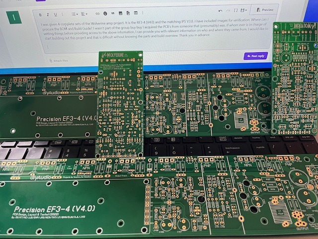

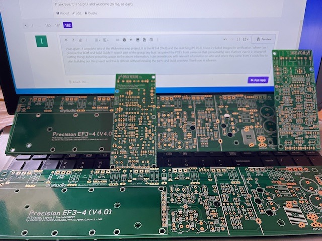

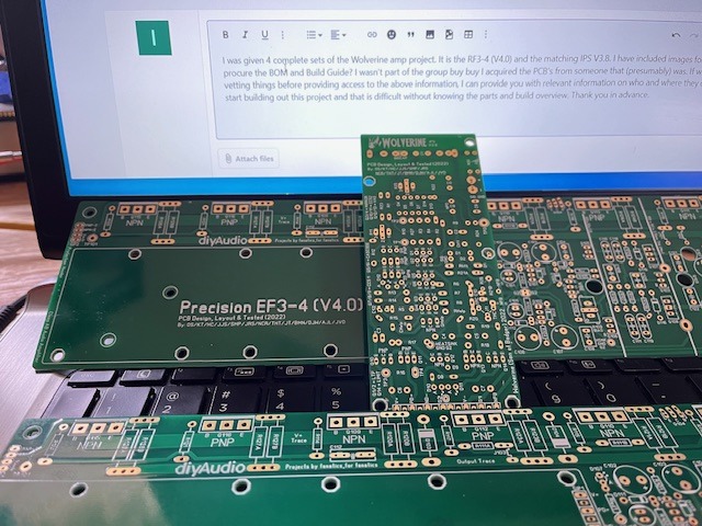

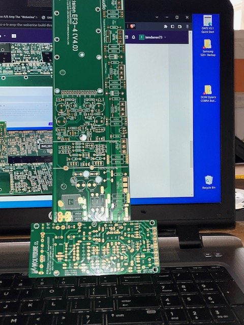

I was given 4 complete sets of the Wolverine amp project. It is the RF3-4 (V4.0) and the matching IPS V3.8. I have included images for verification. Where can I procure the BOM and Build Guide? I wasn't part of the group buy buy I acquired the PCB's from someone that (presumably) was. If whom ever is in charge of vetting things before providing access to the above information, I can provide you with relevant information on who and where they came from. I would like to start building out this project and that is difficult without knowing the parts and build overview. Thank you in advance.

will your project be made public?
Reactions: 2 users
For now it's not more then a design and I have not made any decision on it's future status. Should the project finish successfully, that's the best moment to decide. In what case I probable want to prevent monetization by other people.
Prototype PCB's are ordered today. Next up is sourcing parts, writing software, initial testing and building it in an amp for on the job testing. It wont finish on short term. I thank you for the enthusiast reactions.
Reactions: 1 users
I'd be available for a future verification build if you need someone later in the developement phase.
Reactions: 2 users
