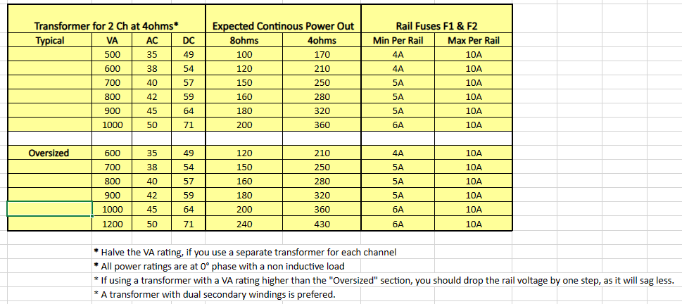

For the other members. I don't believe this information accurate. Please refer to the table in the first post as a guide for output power and rail voltage requirements. Once boards are ordered there's a specially designed SPL including dynamic range vs Rail voltage spreadsheet that @fireanimal and I put together, and, is available in the Dropbox folder that contains all the files for this project.It gets used between 10 and 1000 mW. Mostly below 0.1 watt.
stocktrader200 meant that lower rail voltages have more margin against thermal runaway.you have something to suggest the amp is unstable at higher voltage rails?
BTW, I measure 100mW peaks with 83dB/W speakers at my normal listening level.

3. 71VDC rails with 500VA per channel should give you 200W/8 ohm , 360W/4 ohm. From the BOM, which you get when ordering the PCBs. You would order 50V AC transformer - but note you need to work out whether you need a centre tapped output 50-0-50V or separate outputs 50V x2.
I think the starting "rule of thumb" is 10,000uf per 100W into 8R, so 200w=20,000uf per rail per side is what I used, total 80,000uf. You could probably get away with 20,000uf per channel for a total of 40,000uf and not notice.

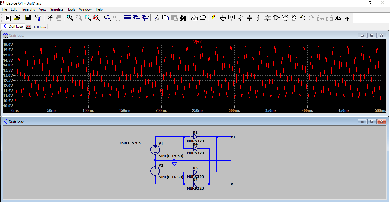

What is the advantage to have dual secondaries + dual bridge rectifiers VS center tap (or dual secondaries) +single bridge rectifier?
My Wolverine has 2X42V in secondaries 400-500VA each trafo 24.000 uf/80V per rail dual rectifiers about... 57-59VDC plays very well ...and after one year i check the bias again ......rock steady rich to 45mv and stabilize at 40-41mv ... and the dc offset 0.0063 and 0.0036mv.....

thanks for the feedback @mainframe99, of course I forgot to mention that I want to go for the EF3-4. I think the toroidy transformers have 2x50V (dual secondaries) so I would need to decide if single or dual bridge. Ive searched for the difference and ended in a thread on here that was exactly about the topic but still couldnt give me an answer lol. So Im joining @asuslover with the question dual rectifiers vs single rectifier? (taken that you can choose with a dual secondary transformer)
