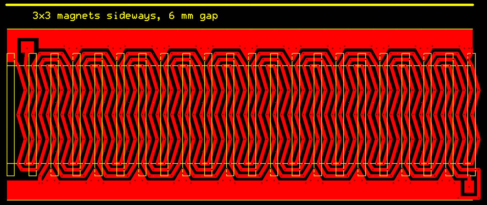

My new requirements are:
Basically I want the perfect purpose build planar driver for my new dipole CBT which will look very similar to the old one but with a planar as the main driver instead of full range 2.5"cone drivers. I'll still use cone drivers for 80-400 hz but I'm planning to hide them behind the planar in the spine of the speaker.
I will at least initially use 12 micron mylar & 30 micron aluminum foil. I will cut the foil on a silhouette cameo 4. I think I will need ~ 1 mm clearance between traces of the coil but I'll have to test that when I get parts & the machine. But since others here on the forum has done this already I'm not that worried and it will probably work just fine.
I also have plans to Corrugate the membrane lengtwise like this to stiffen side-to-side resonances. And then mount it top and bottom while floating (with foam) at the sides to reduce resonance frequency.
There are lots of small desicions I need to but for now the next open question is:
The 3 lengthwise setups are pretty normal. Just a question of how big the gap between the magnets can be without it impacting performance. My gut says that of course the 7 magnet setup will measure better in the treble but how much better and would it be significant? Having only 3 rows of larger magnets would probably be much easier to build. Since I wont have a metal front plate I'd have to get creative making a strong enough frame that I can print. But should be solvable although I might need to add more frame around the magnets to help support them.
The magnet-sideways mounted setup is kinda weird but would have some distinct advantages: It would be easier for me to manifacture on my 3d printer while at the same time having less support since I can rely on the magnets themselves for mechanical support. It would also probably measure extremely smooth in the vertical axis since it is extremely uniform thus should have an effective minimal CTC.
It does have some glaring disadvantages though: I'd have to come with some way to ensure that all the magnets and the coils are in alignment which isn't a trivial problem to fix. I'd also have to get creative when corrugating the membrane since all the corrugations would need to be uniform along the whole length. Also, it would be slightly less efficient due to the coil twisting more. It would, however, be fun to try to overcome the engineering challenges and build it anyway
First is waiting for materials but then plan to build and test prototypes. My plan is to build 20 cm tall prototypes since the main thing I want to test is how the different setups perform in the horizontal axis + how easy they are to manifacture and how mechanically stable they are. Or basically how much extra support do I have to add to make it not fall apart, less is better.
The design which measures good enough while also being easy enough to manifacture will be the winner

How should I setup my magnets?
I'm tossing around ideas for 4 configurations. Since I like tinkering I might just build all 4 and then measure them and see which one I like the best.The 3 lengthwise setups are pretty normal. Just a question of how big the gap between the magnets can be without it impacting performance. My gut says that of course the 7 magnet setup will measure better in the treble but how much better and would it be significant? Having only 3 rows of larger magnets would probably be much easier to build. Since I wont have a metal front plate I'd have to get creative making a strong enough frame that I can print. But should be solvable although I might need to add more frame around the magnets to help support them.
Next step

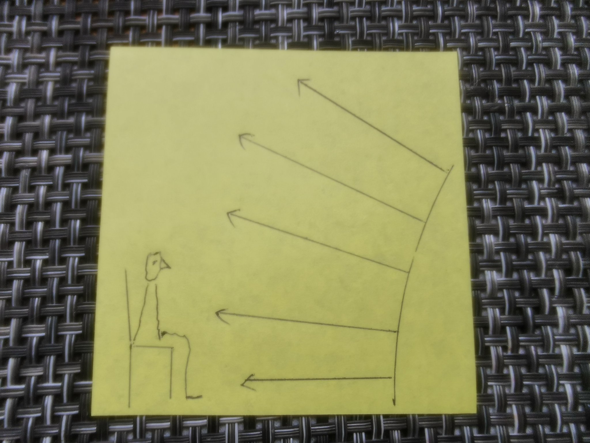

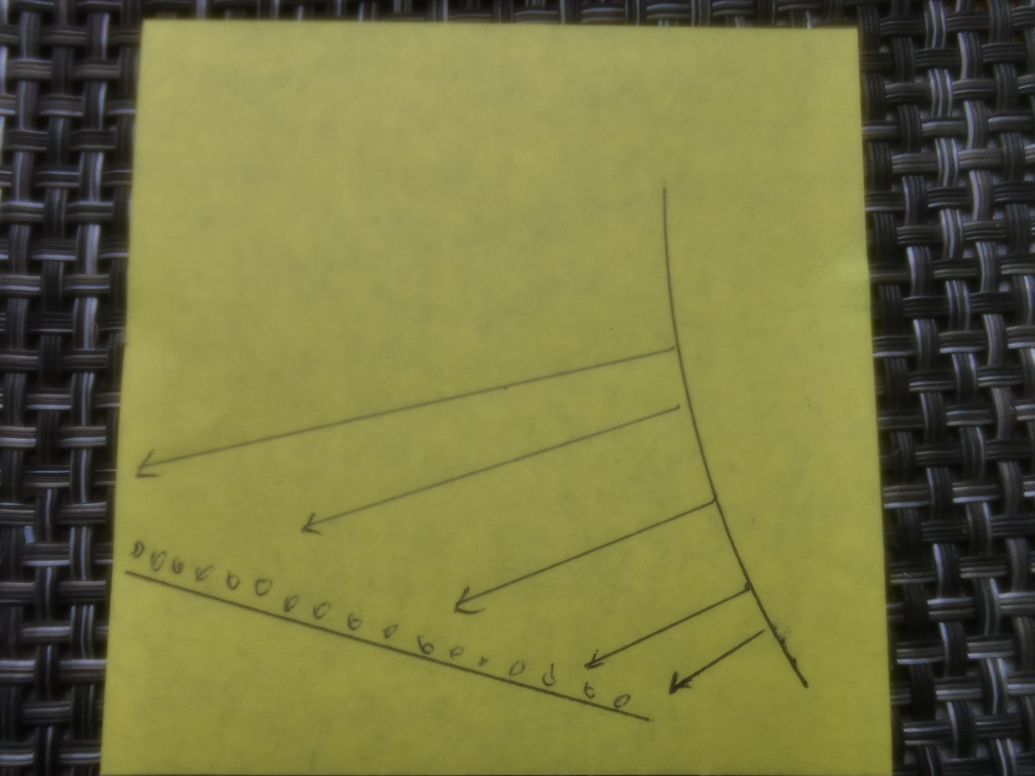

The point is that this type of arrays are used in professional sound engineering, where the task is to bring sound to the front and back rows of listeners in large halls.
But in domestic use the sound from the upper part of the curved driver will go past the listener to the ceiling, this in turn will cause cutoff and interference mush, that is, will be brightly colored.
The top of the array is shaded. The end result is that the vertical dispersion is reduced and controlled.The point is that this type of arrays are used in professional sound engineering, where the task is to bring sound to the front and back rows of listeners in large halls.
In practice it measures like a floor to ceiling array regardless of ceiling height. I also think the physically curved design looks really nice and not as bulky as if it was straight and taller.

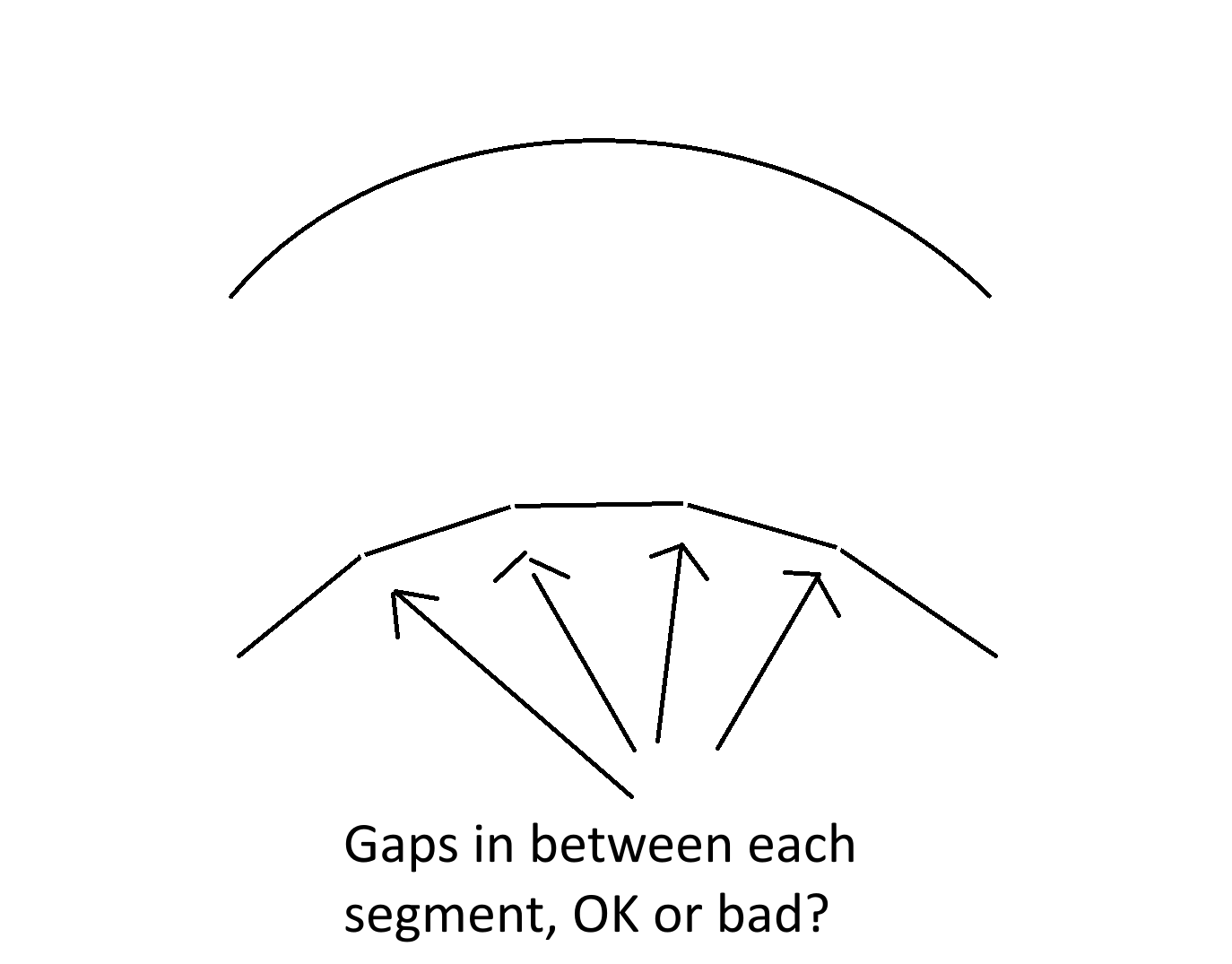

Will the curve be continous or segmented into individual drivers?
Are you doing any FEMM analysis?
Both, kinda.
I want to build a single continously curved driver, with a single membrane but to make manifacturing easier I plan to build the frames into 8 segments @ 20 cm each. I think that will work since the membrane won't be tensioned like the usual planars. I will have a more robust plywood frame which will hold all the segments and keep them in place.

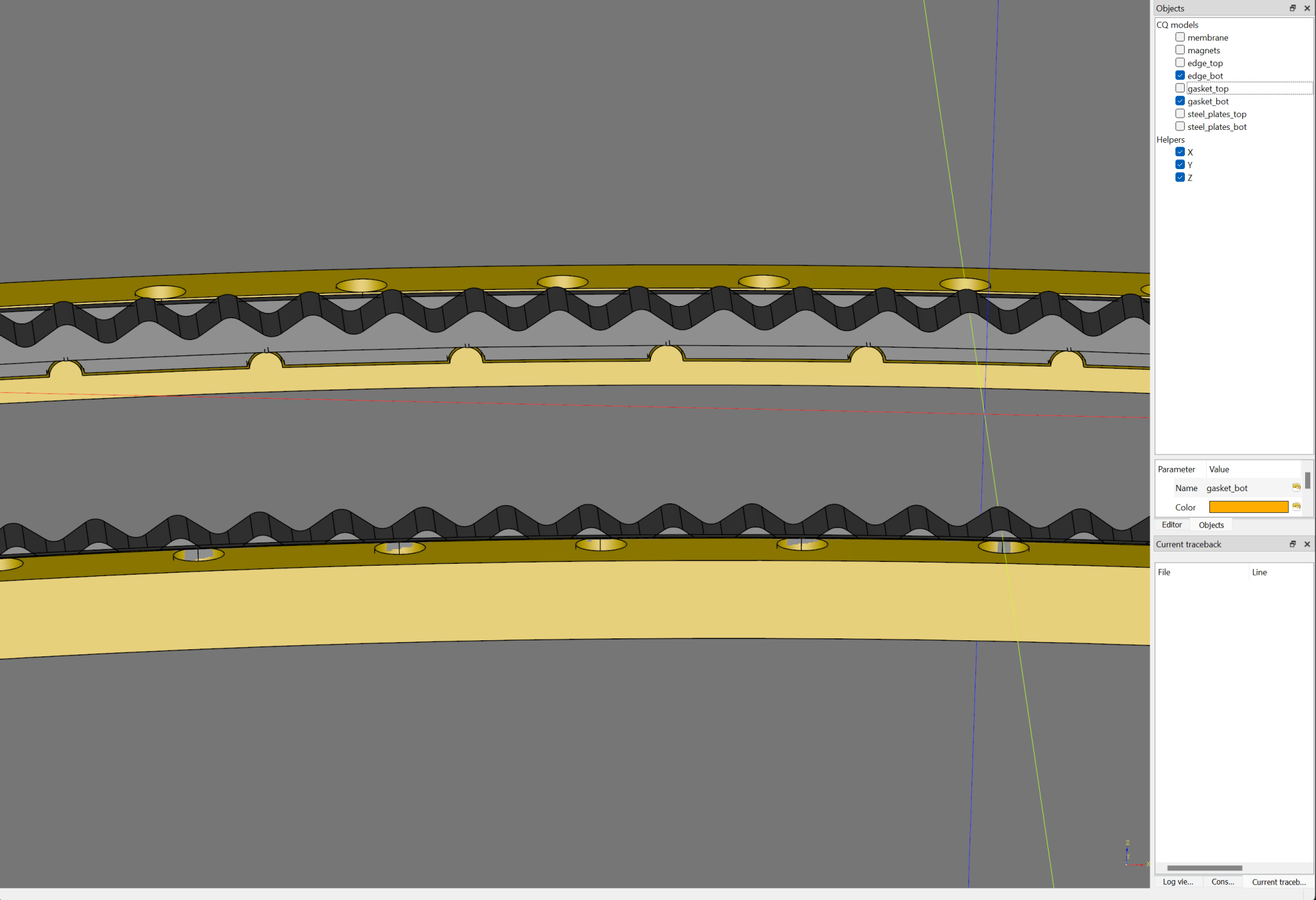

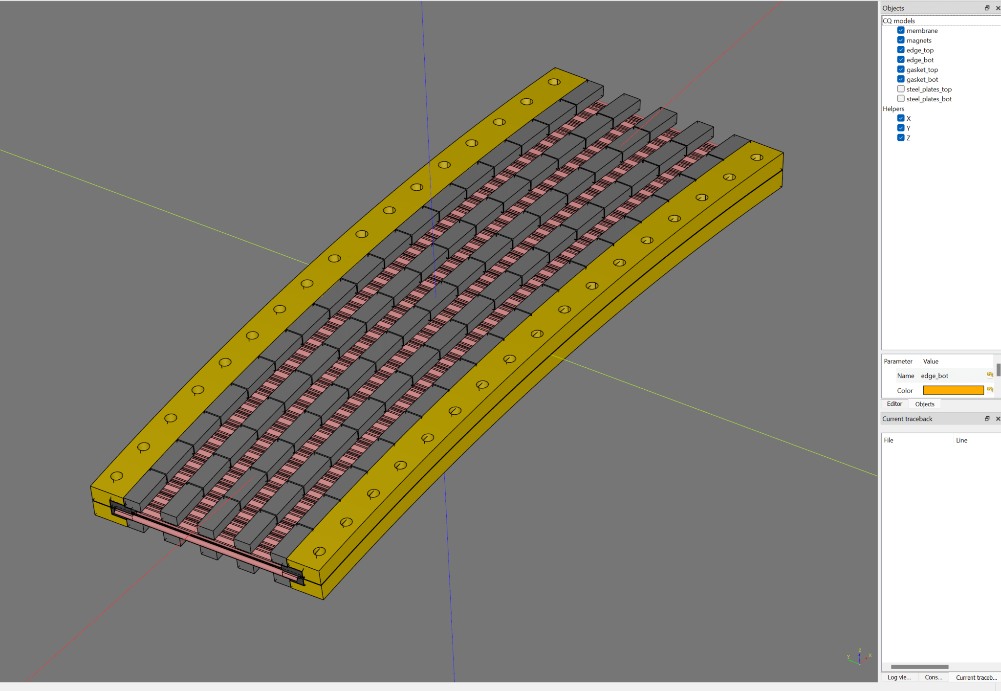

This is the latest idea if I go with sideways mounted magnets:
The wavyness in the lines would ensure that sideways line of the membrane is unsupported without any aluminium traces on it. And in theory, if I can focus the corrugations in the gap as I mused earlier then this design should get away with the magnets being closer than a normal lengthwise magnet setup. So we gain some efficiency but we loose 25% to all the extra loops so in the end the straight will probably be more efficient.
If I go with straight magnets then I can always use perforated steel plates but they obstruct too much for my liking and would be annoying to work with. So I threw together a rough sketch 200x70x1.2mm part which assumes 5 rows of 50x3x3 magnets + some screw holes.
Then sent it to some online laser cut services to see if it would be cheap enough to use. And it would, if I cut 50 of those parts which would be enough for both speakers it would cost €220 including shipping from https://fractory.com/sv/laserskarning/ The previous manifacturer I checked at (https://cotter.se/) is extremely expensive for steel, a single (1!) part would with shipping would cost more than that...
Although that is with 50x of a single part, I'd need 20x the outer part and 20x the inner part since the outer part will be just slightly longer since the radius will be bigger.
But with laser cut parts then they will be consistent enough that it should be simple to print extra helper parts like press moulds to ensure they all have the appropriate curve and jigs to ensure all the magnets are glued in the correct place for all the segments. Also, if I go with normally aligned magnets like in the metal cut part then I'll probably see if I can buy shorter magnets, say 30x3x3 mm magnets make them fit in the curve with less height error in the middle.

How will the corrugation be oriented with the sideways oriented magnets, along with the magnets or peripendicular to the magnets?
Don't you mean supported?The wavyness in the lines would ensure that sideways line of the membrane is unsupported without any aluminium traces on it.
In that case, corrugated along the sideways mounted magnets. And yes you are correct.

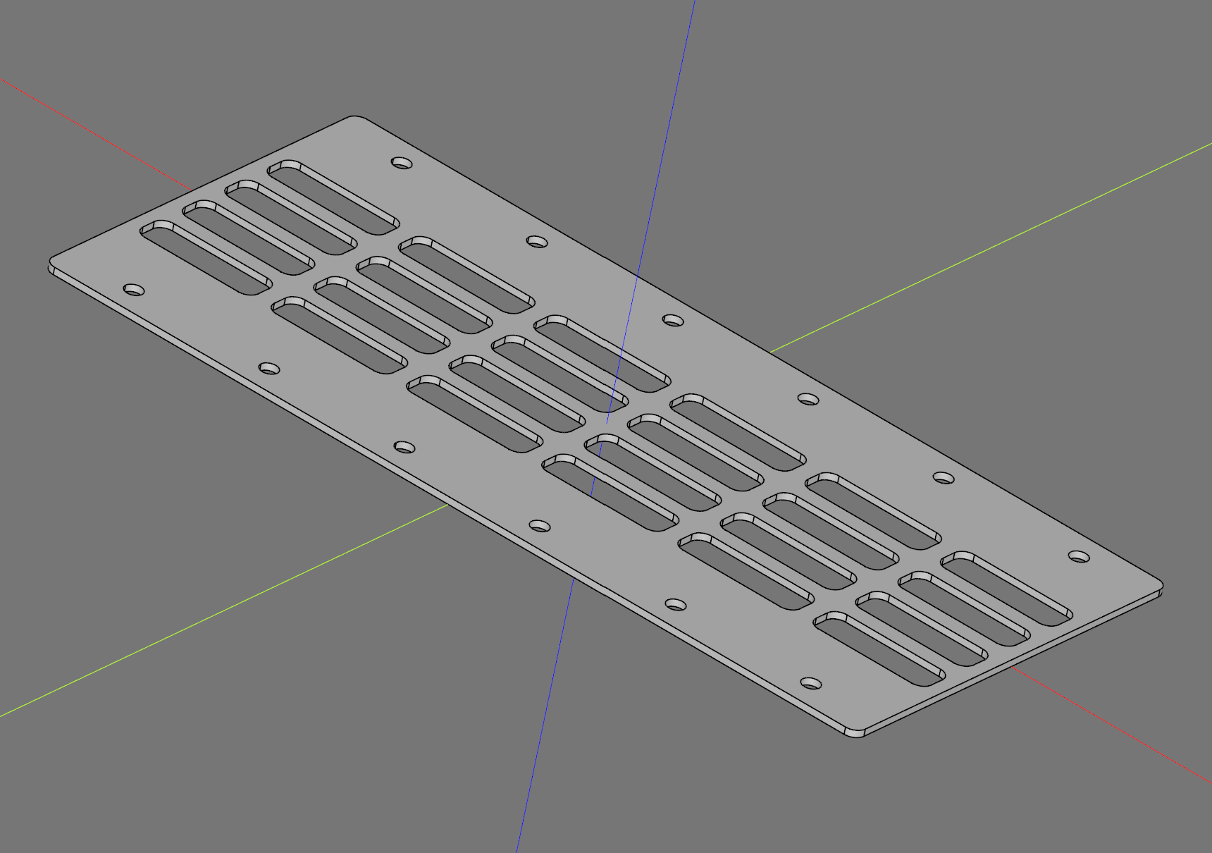

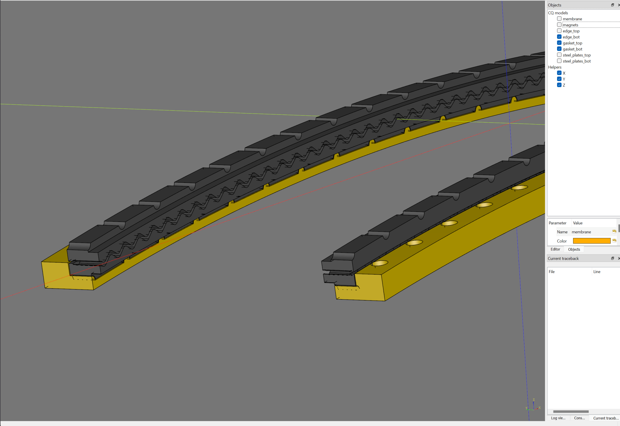

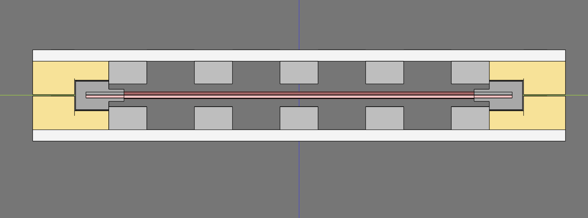

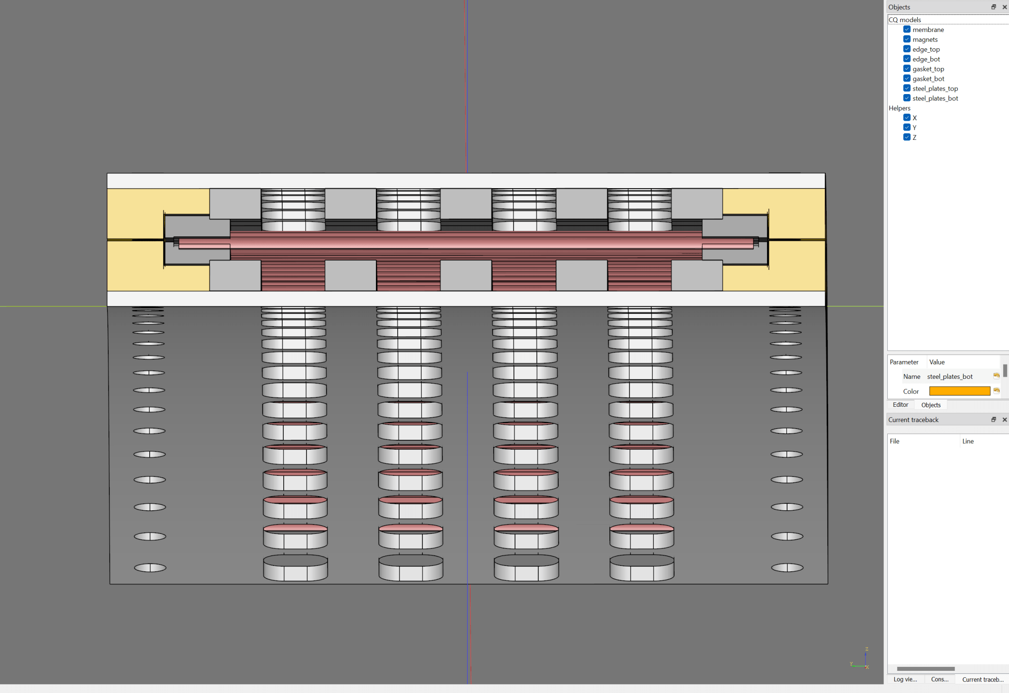

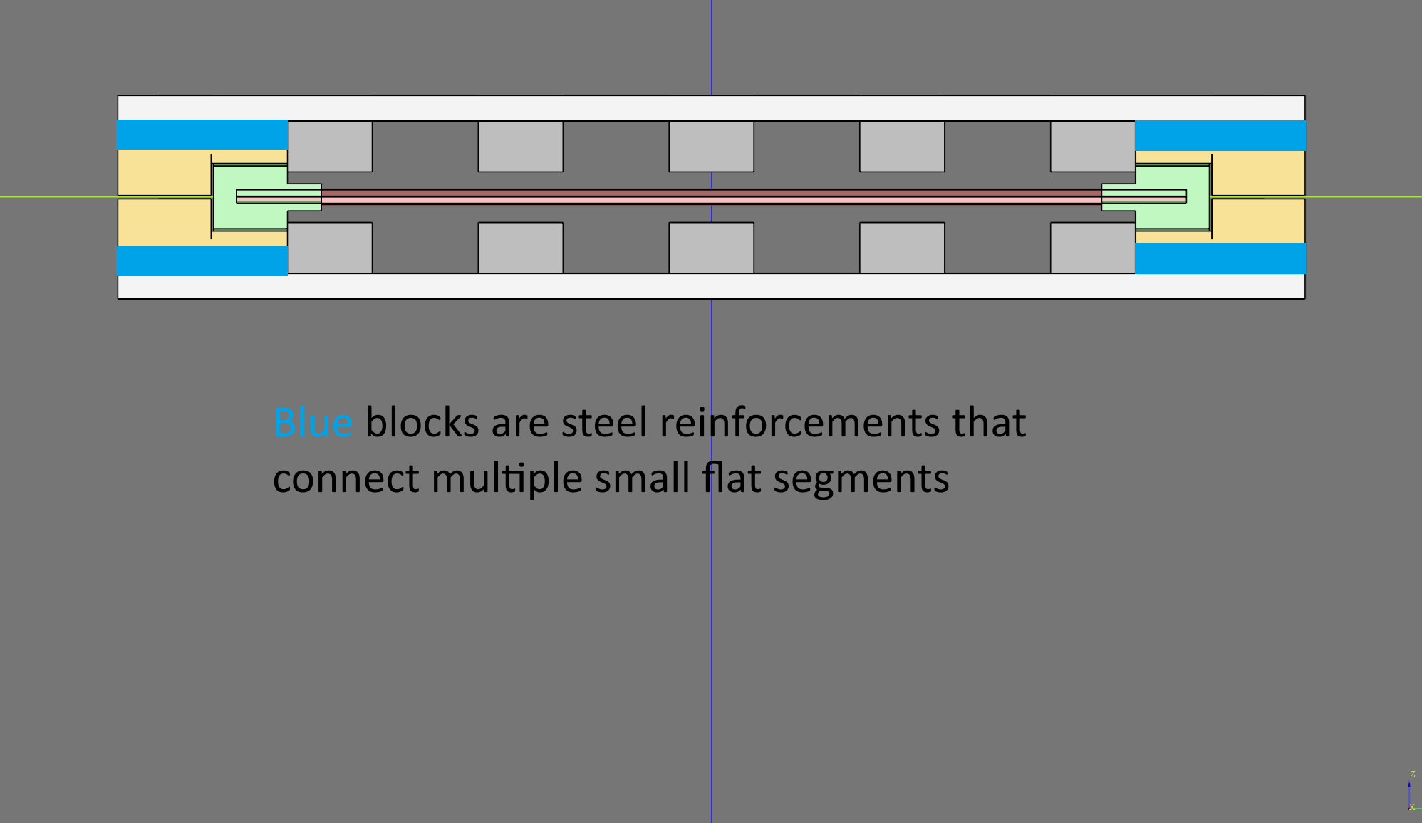

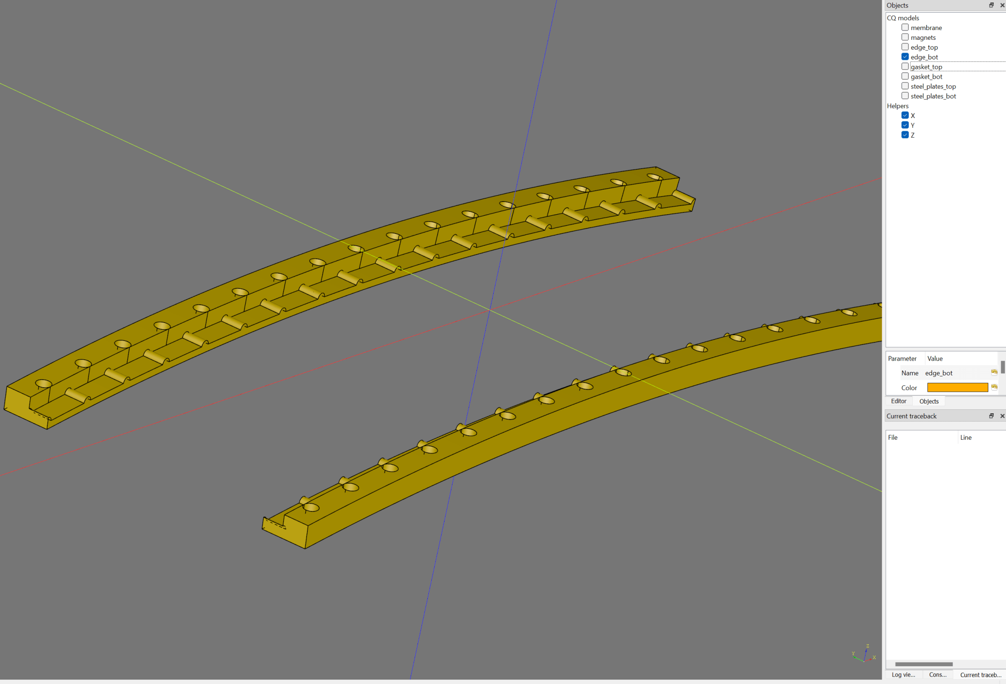

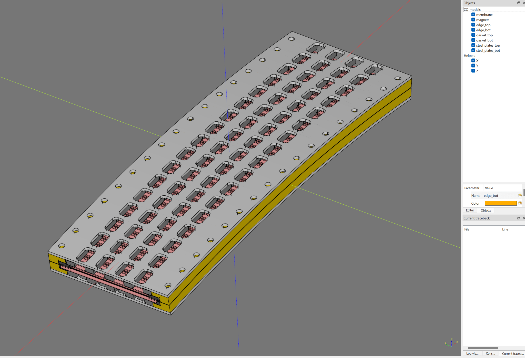

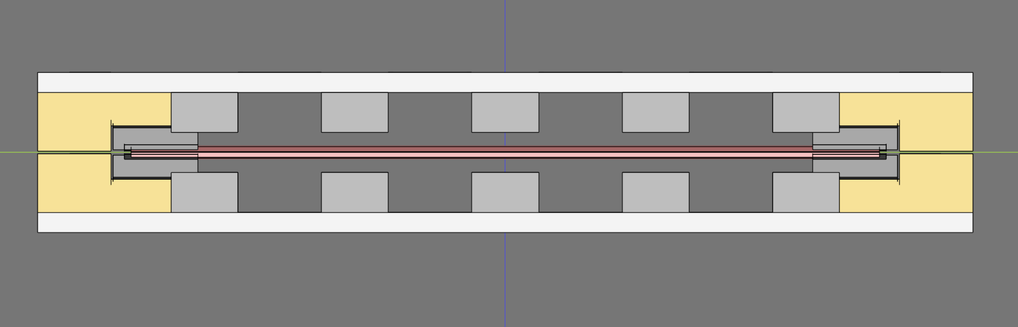

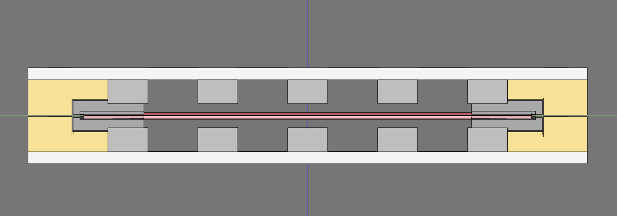

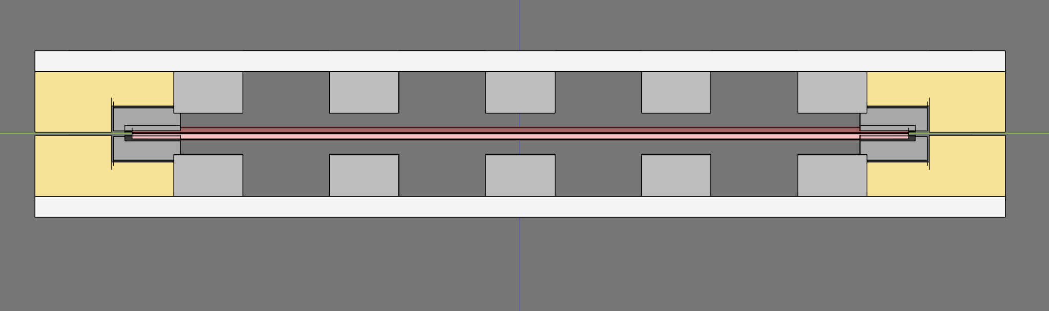

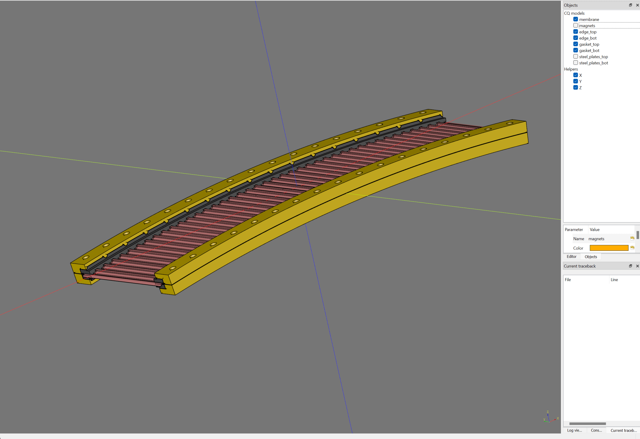

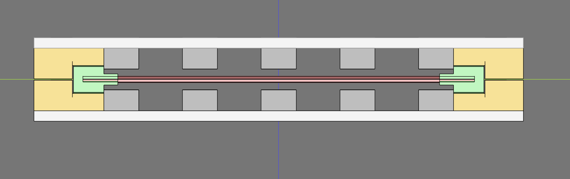

Drawings!
Currently assuming I use 12x5x3 mm magnets, 17 lengthwise. Driver is 7 cm wide and has a 75 cm radius. The yellow parts will be printed in PETG (or PETG-CF) on my printer, the gaskets will be printed in porous Varioshore TPU in 65A shore firmness. The top and bottom plates will be 1.5 mm steel laser cut. Not yet modeled is that I plan to glue a thin non woven fleece fabric on top of the magnets to reduse resonances. The round thingys on the 3d printed parts and the gaskets are just to keep them in alignment without glue. The only glue I'm planning for is for the magnets on the steel plates.
Note that the driver is open on the top and bottom. The idea is to connect 8x of these on top of each other with a common membrane. I'll probably print small specialized bottom and top parts where I attach the membrane.
Open questions. If I can't reason myself to the answers I think I'll have to try out the different options.

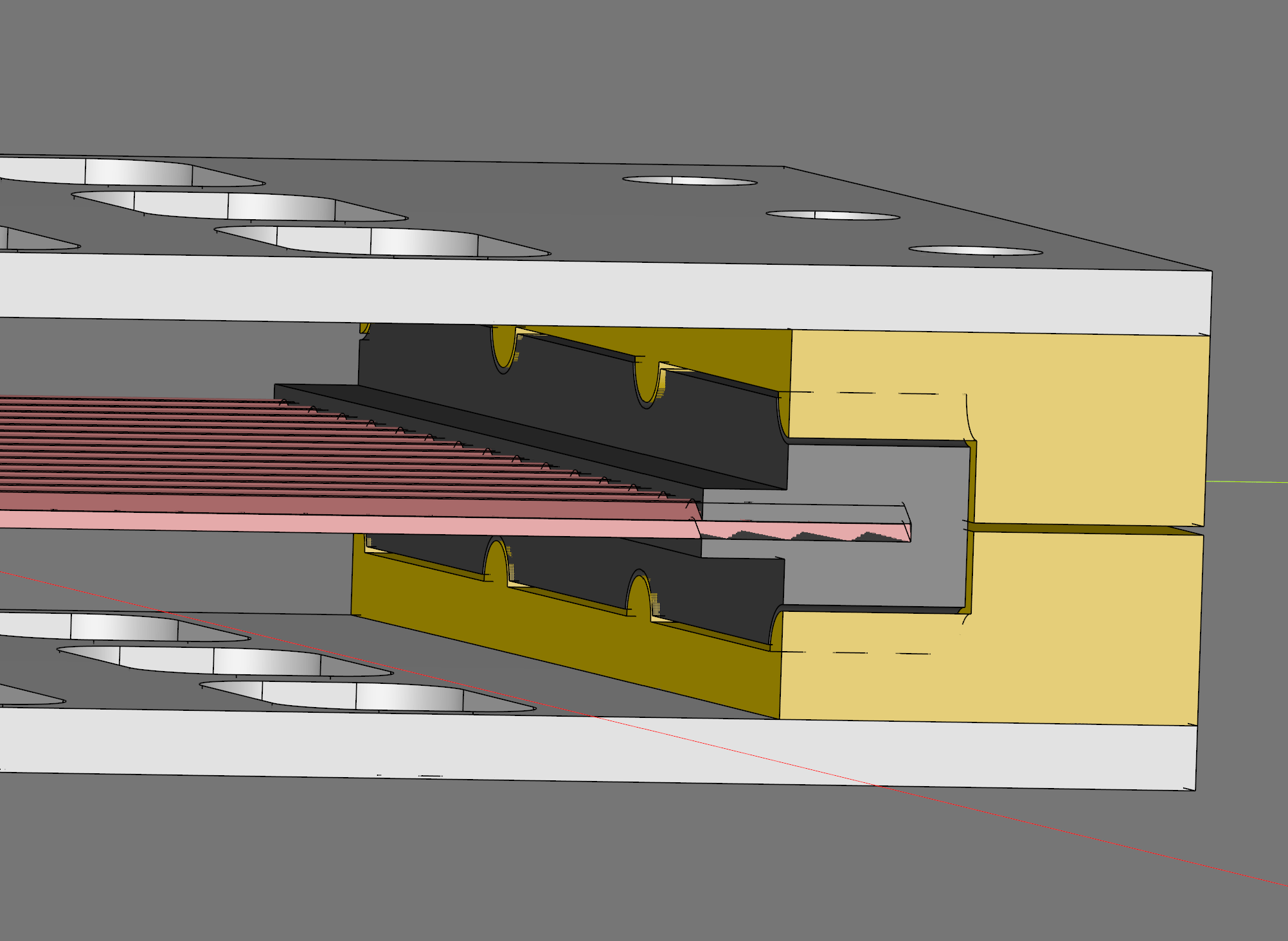

- Should the corrugations really be that deep? Also, I think I'll need to make my corrugator myself since I need to have the corrugations match the gaskets.
- How much distance should I have from the top of the membrane to the magnets?
- How tight should the gaskets be against the membrane? Maybe they should be pretty loose and just roughly hold it in alignment?
- Should I print the gaskets solid? The material should be pretty porous but I could print with infill to make even softer or skeletonize it to let the membrane move easier.
- Is the small area where the membrane connects to the gasket enough to support it or should it be longer?
- Is 1.5 mm steel appropriate for the top and bottom, should I go with thicker like 2 mm?
- Are 5x3 mm magnets appropriate? I have 4x3 mm magnets ordered too which I can also try. I guess I also have 3x3 but those are longer so will not keep the curve as well as the smaller so I might try them in a flat setup.
- Should I have magnets on both sides? This should be easy to test since I can just measure the driver again without mounting the front plate & front magnets.

Here's some thoughts.
1. I'm thinking +/- 0.5 mm is enough, that is 1 mm in total. But you can corrugate it "deeper" and then stretch the membran to the right depth.
And why don't you design the gasket's corrugation after the corrugation of the membrane has been decided?
2. I think you need to do some FEMM analysis of that.
3. How long will the gasket/dampening zone be? Perhaps the membrane can be a fairly tight at the end and then there's a section of looser and looser dampening (foam).
4. If you'll print it with the same filament, you can have it firmer at the end and then looser and looser towards the active part of the membrane.
5. I don't think so. But you might want a longer dampening zone.
6. Will the steel plate come curved from the manufacturer? How does the magnets attach to the curved surface? I don't know if it should be 1.5 mm or 2.0 mm, you'll have to test how much the bulge is in the middle.
7. I think you need to do some FEMM analysis of that.
8. Upside of a push/pull configuration is that you'll get a more even magnetic field density over the excursion of the membrane. Downside is a more complicated motor to assemble and that you have to consider the Helmholtz' resonators. Here's a calculator.
1. I will. The whole drawing is parametrized so my next step is to start actually corrugating some example membranes and see what shape it actually gets and then correct the drawing.
2. Sounds reasonable. I tried to plot in https://www.femm.info/wiki/HomePage but the UI wasn't the most intuitive so for that time I gave up after a few tries. I might have to try again or to just print parts for multiple configurations and see in practice. If I want to test magnet distance I might tweak the curve such that the driver is flat because then I can adjust the distance without having to redo the sheet metal parts with the magnets.
3. I wonder that too . When I have a prototype I might as well print all 3 combinations and then measure them all. Might also be worth trying to print the gasket in one piece on each side without cutting it in the middle. Might also be worth narrowing down the gasket under the magnets to let it move more.
4. True, but would make it more complicated to print. Probably easier to play around with more or less infill and more or less supported to achieve that.

If the gray part is the gasket I guess that you don't have any dampening zone, just a little less gasket towards the active parts of the membrane.
How do you get the membrane into the gasket?
So the magnets's surfaces will barely touch the bent metall?
10 kHz, that's about what I got as well for my contraption.
the dark gray part is the gasket, which is light green in this image.If the gray part is the gasket I guess that you don't have any dampening zone, just a little less gasket towards the active parts of the membrane.
And how I insert the membrane in the gasket: If I do a split gasket then I guess half is placed on the bottom of the driver, then the membrane and then the top and sandwich it together with the screws on the side. It I print them in one piece then I guess I'll slide the membrane into the gaskets first and then place the gasket + membrane combo into the rest of the driver and then sandwich it together.
In the current plans then no, they will not. Is that a problem?
If the magnets don't have contact with the iron, which will be more or less the case, the magnetic field density will be much lower (about 33 %) and also more uneven.
Interesting! Does that mean that the glue is usually just on the sides of the magnets then for maximum performance?
I guess I could do a stepped curve in a single sheet of steel but that sounds really complicated. The manifacturer might be able to do it but the tolerances would have to be amazing so probably expensive . The simplest way to solve that issue is probably to remove the curve on the steel plates and make them flat. But also split it into many parts where each part might be say 12-50 mm long. Would it be a problem if the small steel segments are not directly connected to each other?
Then get the curve through the middle parts which is 3d printed. That might be a big weak though so it is probably a good idea if I can cram some steel reinforcements in the yellow 3d printed parts that are curved but cover the whole arc of each ~ 20 cm long driver segment. Or since it is already split I might as well have these steel reinforcements cover the whole 160 cm tall driver.
