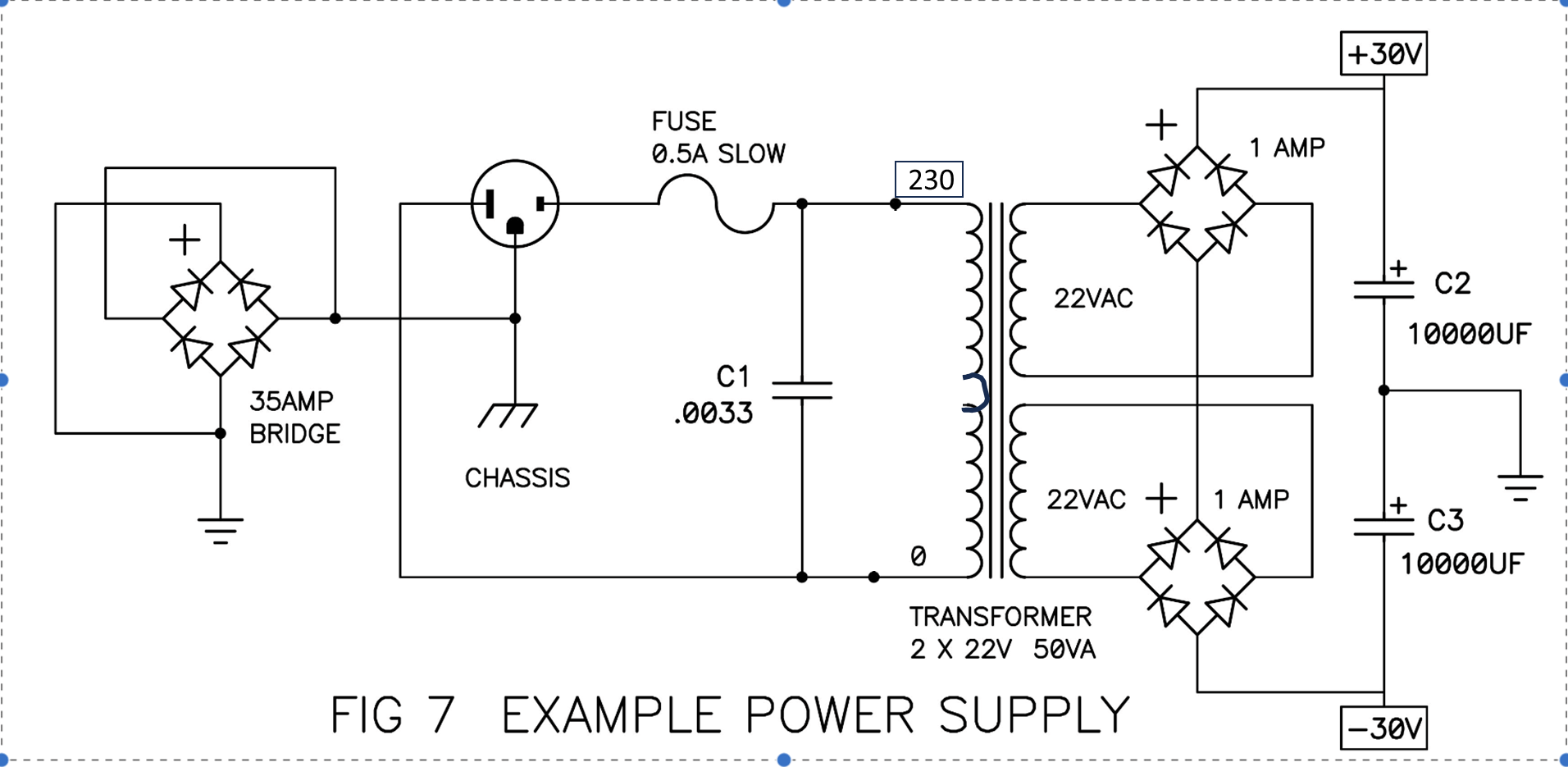

Hello,
I'm not professional and need your collaboration. I started a build PassDIY Pearl 2. Could you help me and give me info on which elements need to change for power supply Pearl 2 in EU - 230 V/50 Hz in Poland? I want to order a solenoid transformer from Toroidy.pl.
Many thanks and Greetings,
Peter

Hello,
Many thanks for the answers. Could you tell me which elements of Power Supply Circuit Board v3 in BOM file xls need to change for power supply Pearl 2 and 230 V? Can I buy everything and will be correct to pearl2 or need to change for example diodes, capacitors or resistors for high voltage (+/-30V)?
https://diyaudiostore.com/collections/power-supplies-accessories/products/universal-psu
In the first thread, 6L6 wrote:
"This specific build will be suitable for any of the Pass/Firstwatt amps that use a +/-25V supply. If you need a higher voltage make sure you use capacitors of a suitable voltage rating for your project." - so I doubt because Peral2 need a +/-30V supply.
Thanks for your help.
Possible, but not such a good idea. The parts, specifically capacitors all have to be changed to find values that are at least 10% greater than the maximum supply voltage. In your case, at least 350 to 400V. This supply is really made for lower voltages and higher currents.
Why not consider alternatives that are suitable for preamps tube supplies? I think DIYA here has a dedicated thread for tube related posts. Also, search out Peter Millet's website/page, he has some great power supply boards and I think available now on eBay. Also do a search for Tent Labs.
By your question you don't have a lot of experience with power supplies. Please - take all caution. High voltage supplies can be lethal if the current travels a path through your heart. Too many have discovered this the needless way. Read and understand before building and putting the AC on! Best of luck.
