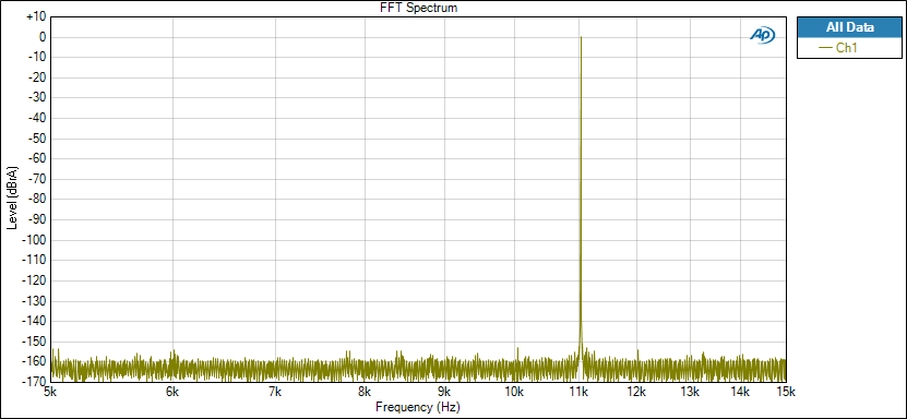

1. Besides the top notch specs, the e20 uses an asynchronous USB interface which means it acts as the master and pulls data from the computer when it needs it. All playback happens from the e20’s internal memory so jitter from the computer, not being a real time system, is eliminated.
Here is a 1024 point FFT spectrum averaged four times of 11.025KHz signal at 44.1KHz sampling rate designed to expose the smallest periodic jitter appearing as symmetric sidebands. The only sideband is at -152dBFS:

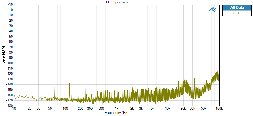

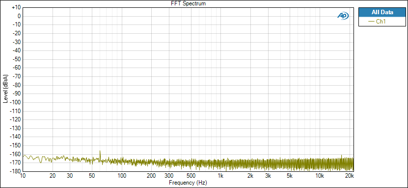

2. The USB is galvanically isolated from the audio path, and there is virtually no noise from the power line. In fact it is measured at less than -145dB (60Hz noise + harmonics). The galvanic isolation improves the noise level by 30dB!!
Noise floor with galvanic isolation
Noise floor without galvanic isolation
![e20u-FFT-Noise-USB-Isolated.gif](https://www.exasound.com/portals/0/Images/e20-Measurements/e20u-FFT-Noise-USB-Isolated.gif)
![e20u-FFT-Noise-USB-Not-Isolated.gif](https://www.exasound.com/portals/0/Images/e20-Measurements/e20u-FFT-Noise-USB-Not-Isolated.gif)
