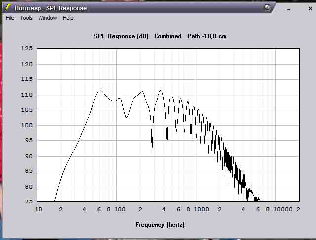

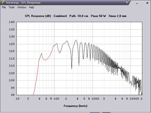

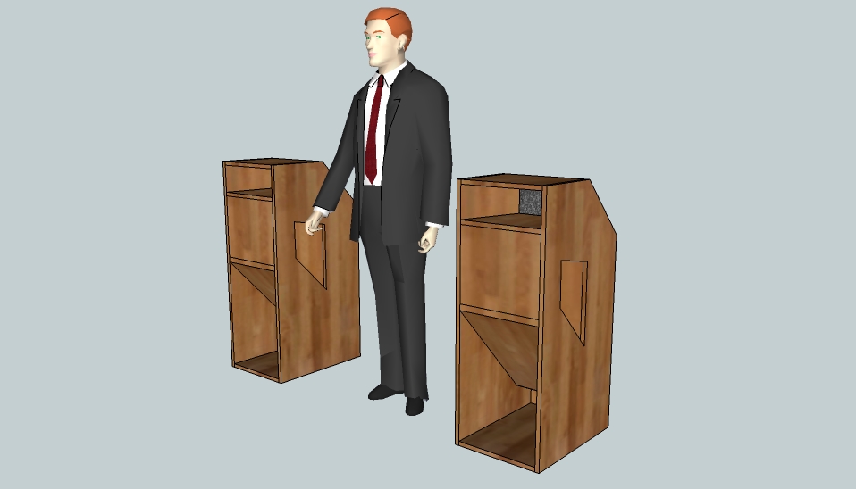

Betsy k compound horn
Here's a nice compound horn design I worked up. They're pretty big but the sound would be big too. I have included the hornresp model so you can see the performance you could expect. As you can see they are pretty flat down to 50Hz and have useful response down to 40Hz. They exceed 115db at Xmax and if like you said the do okay at over 2X Xmax then they should hit 123db down to 45Hz if you put them in the corners(that figure is for one speaker!) If anyone is interested in plans let me know. Or I could build them if anyone is interested as well. :D
