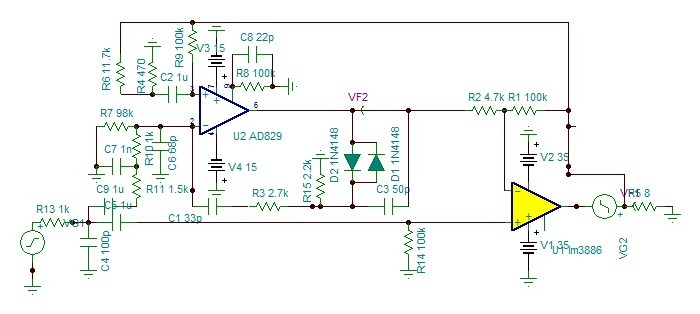

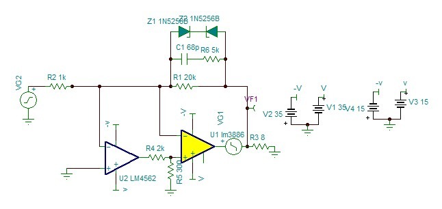

This circuit is a natural variant of subtracting error correction but included in the feedback. Instead of subtracting the error, it divides it by NFB.
https://www.diyaudio.com/community/threads/subtracting-error-correction.408153/post-7578125
An error correcting amp feedback only the error found by the difference of the input and the weighted output. The advantage over the composite type, the power chip receives directly the input signal without extra layer and the opamp functions at very low levels which doesn't require super low distortion opamp.
I should rather say wide band error amp instead of opamp because it must amplify the error without integrating it. The difference the error amp sees, is the same what the power amp sees, as the power chips are integrators in open loop, if the error amp also integrates the same input, it will become back an image of the output signal. To keep at high gain all the audio band, it needs 2 pole compensation for stability.
This type of amps have two independent stability character, the error feedback loop and the error correction frequency. If higher frequencies than the power chip are asked to get corrected, the chip amp will decrease its phase margin, this why the error amp receives the input via a low pass filter.

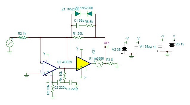

I use the AD829 wide band opamp which can have its gain bandwith adjusted. This amp doesn't need servo as the error receives the DC component of the output without attenuation. The slight offset can be adjusted by the opamp offset adjust, not implemented on the model, so I adjusted by R7.
The LM3886 has OLG@20khz of 50db. With 26db CLG, only 24db NFB is left. With this error corrector 80-100db is possible.

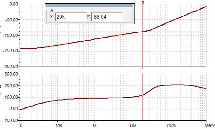

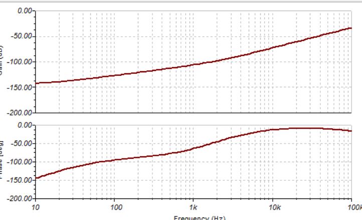

I reduced the input impedances to get the noise halved. The total error correction of the circuit, power chip +opamp @20khz is 88db vs 56db for the subtractor and 24db for 3886 stand alone all for the gain of 26db.
Notice the phase of the error, it remains about 90°all the audio band in first order integration by the power chip.

As the power chip needs to receive directly the input, in current mode, will be in the negative input, the required topology is that of Modulus86 you find it bellow without values.
"Not to infringe the copyright".
The opamp need to be replaced with CFA type , as AD844 for example.
The problem is how to feed the same input current to both amps. An answer is to use a current mirror that feeds the copy to the power and the undistorted to the error.

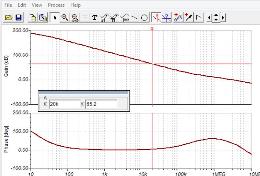

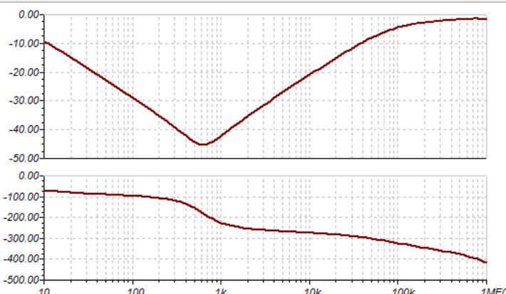

This is the OLG of LM3886.
It has 50db@20khz and 3db shy to 80db@1khz. ST micro. Chips have 80db@1khz.
As these chips require over 26db CLG for stability, then the curve goes downward to reach at 24db@20khz.

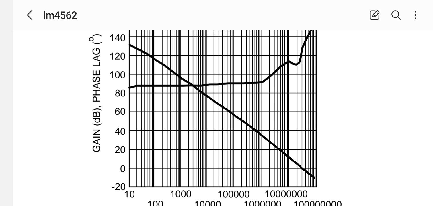

Bellow is the OLG of LM4562 audio dedicated opamp. It has 90db@1khz and over 70db@20khz. This type of opamps are compensated for unity gain CLG. They are perfect unity gain audio high to low impedance buffers to be used as mixers, Sallen-Key filters etc.
This is the required LG that the power chip needs to get, with 26db gain,it needs 96db@20khz of OLG. In other words it needs 46db extra gain from a wide band amplifier.

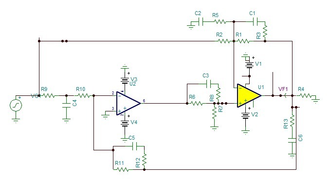

@ihan whispered me a different type of error corrector of Modulus type but far faaar simpler. It is D. Yewen composite published in electronics and wireless world Feb.87.
https://blog.easychipamp.com/
I made a quick essay to find that it is possible to get very easily 74db@20khz NFB.
It can be animated by current input that I need to know what is your max peak level to dimension the I/V transconductance.

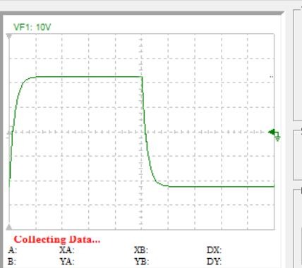

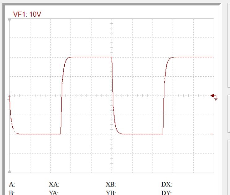

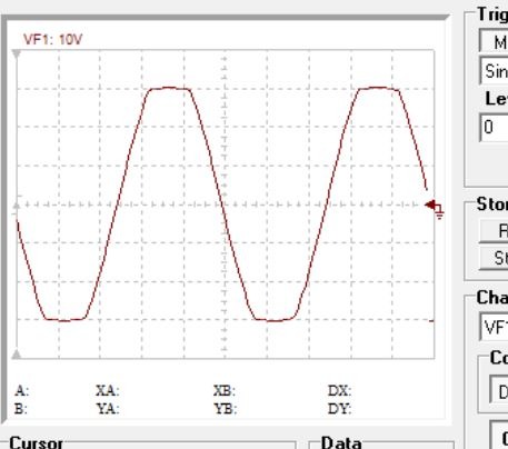

Remark the phase of the error. Mine is -90° in audio band because wideband error + integrator, Modulus is -180° because integrator+integrator. This is miraculous 0°. IF I rotate my generator, I get +180.

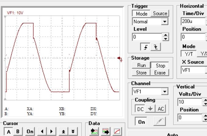

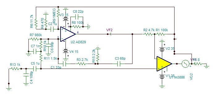

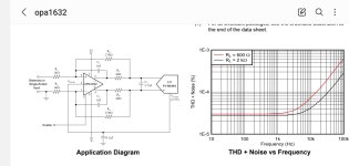

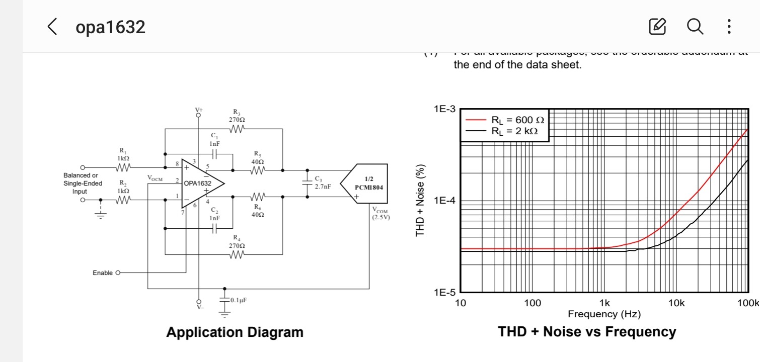

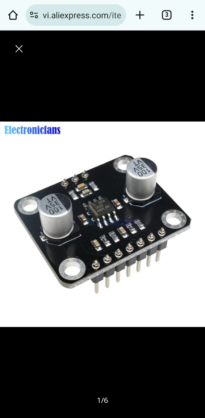

The distortion of this amp is that of the input buffer. To make it best is to use differential in/out ultra low distortion amp the opa1632. Ali sells it all mounted on a board for $2.
This gives the possibility of differential input and also to have this amp bridged.

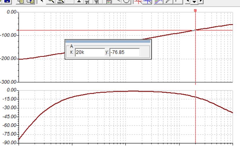

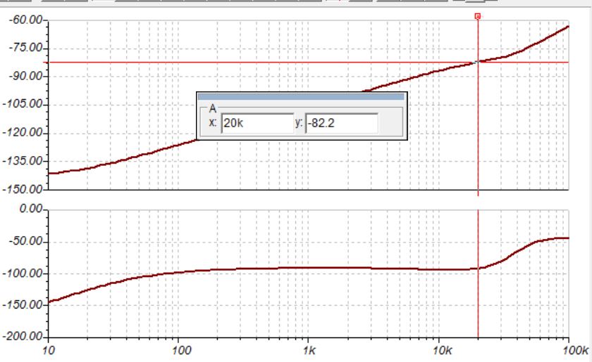

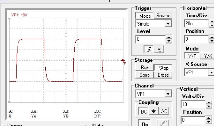

By using AD829 in 2 pole, I have -82db@20khz and -90° phase shift all the audio band.
