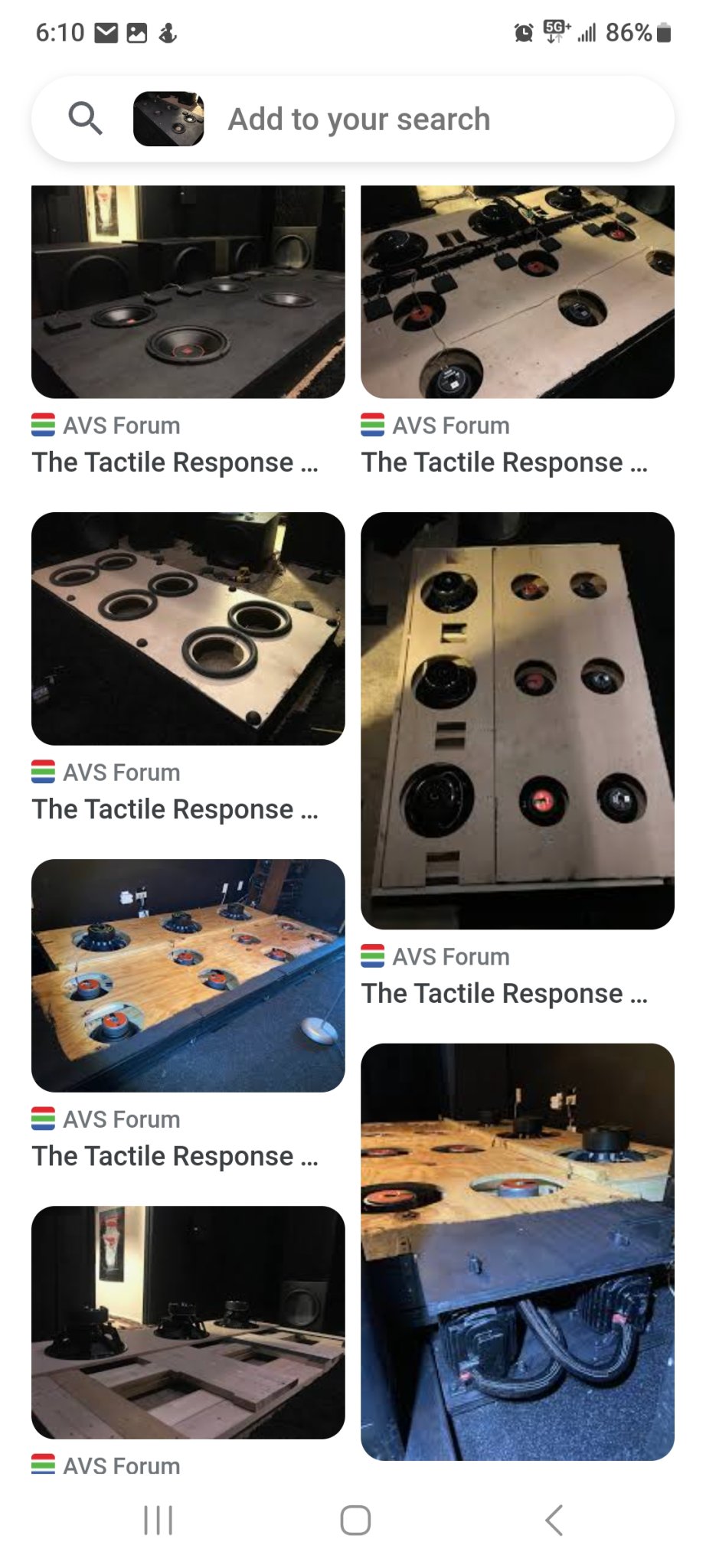

$29 JBL 12's are used for tactile response on avsforum.com.
Hence the link in post #8.
These pics are the bottom of sofas/couches.

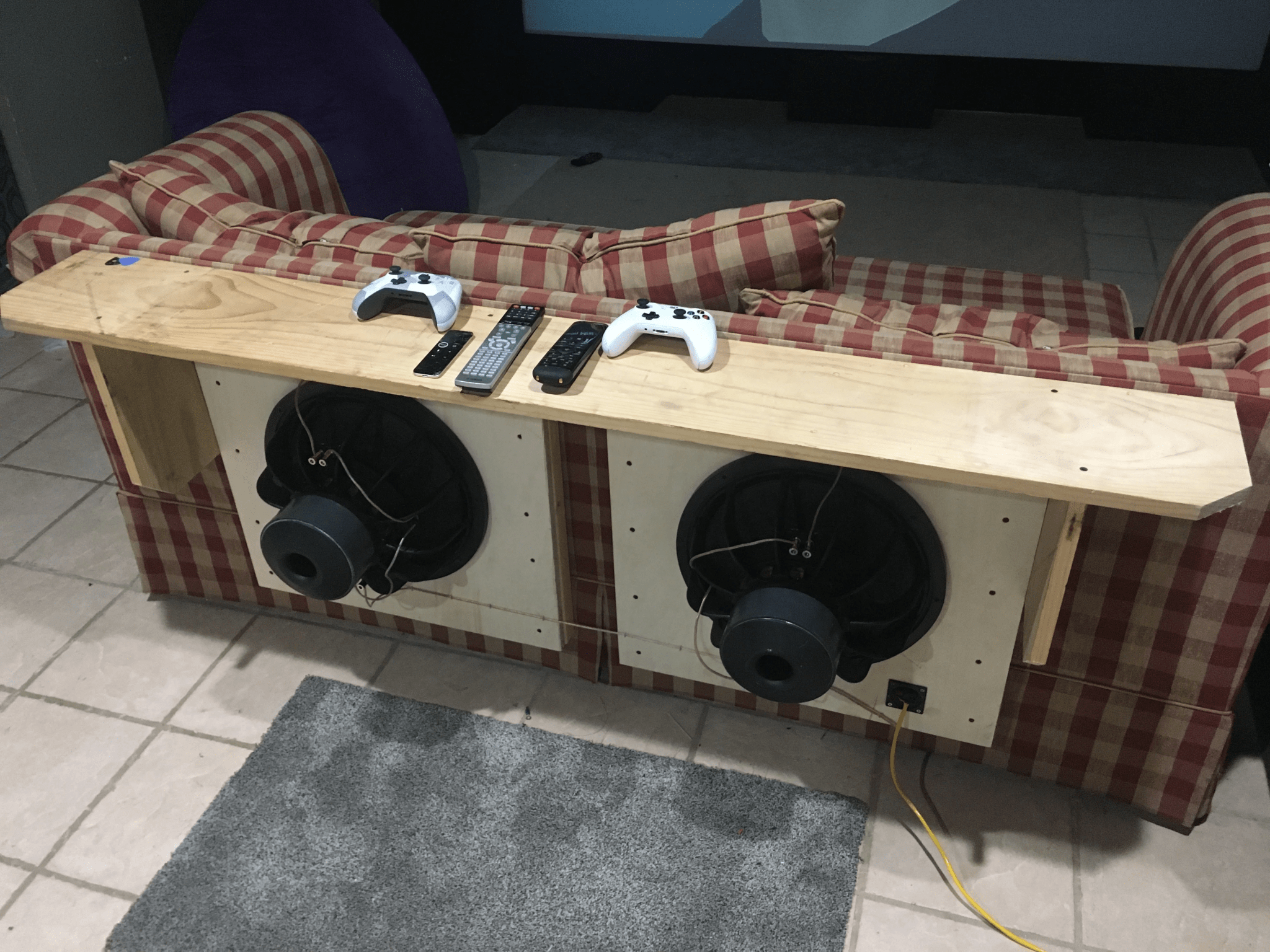

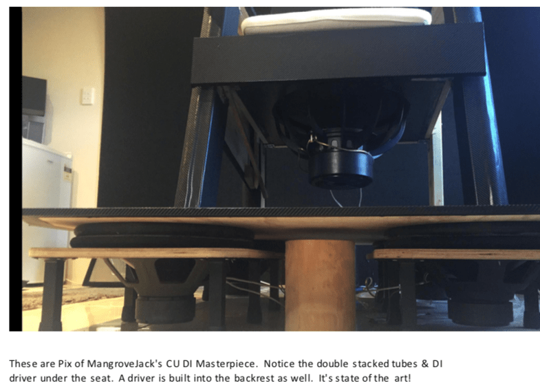

The HoverEzE (HeZe) as using inner tubes and cheap car subwoofers is the most cost-effective DIY bass shaker.
The pneumatic float is key to it's efficiency and effectiveness- more "shake" per watt with very little moving mass,
exceeding the output of the weighted solenoid-type devices originally popularized by ButtKicker.

This guide explains it in detail:
https://gitlab.com/HeZeGuide/HeZeGuide/-/tree/main
i have 2 12"sub abble to down 35hz, which bass shaker do you advise ?
Since the HeZe leaves the back side of the woofers as open baffles, depending on your listening level, you might use your existing 12" and be able to dispense with anything else between the HeZe and the 8" drivers.

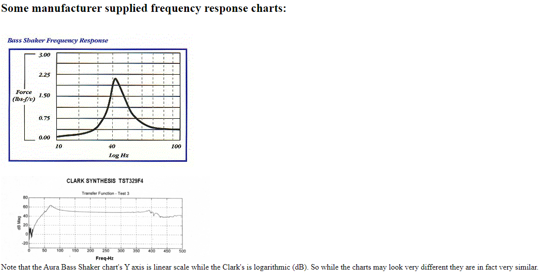

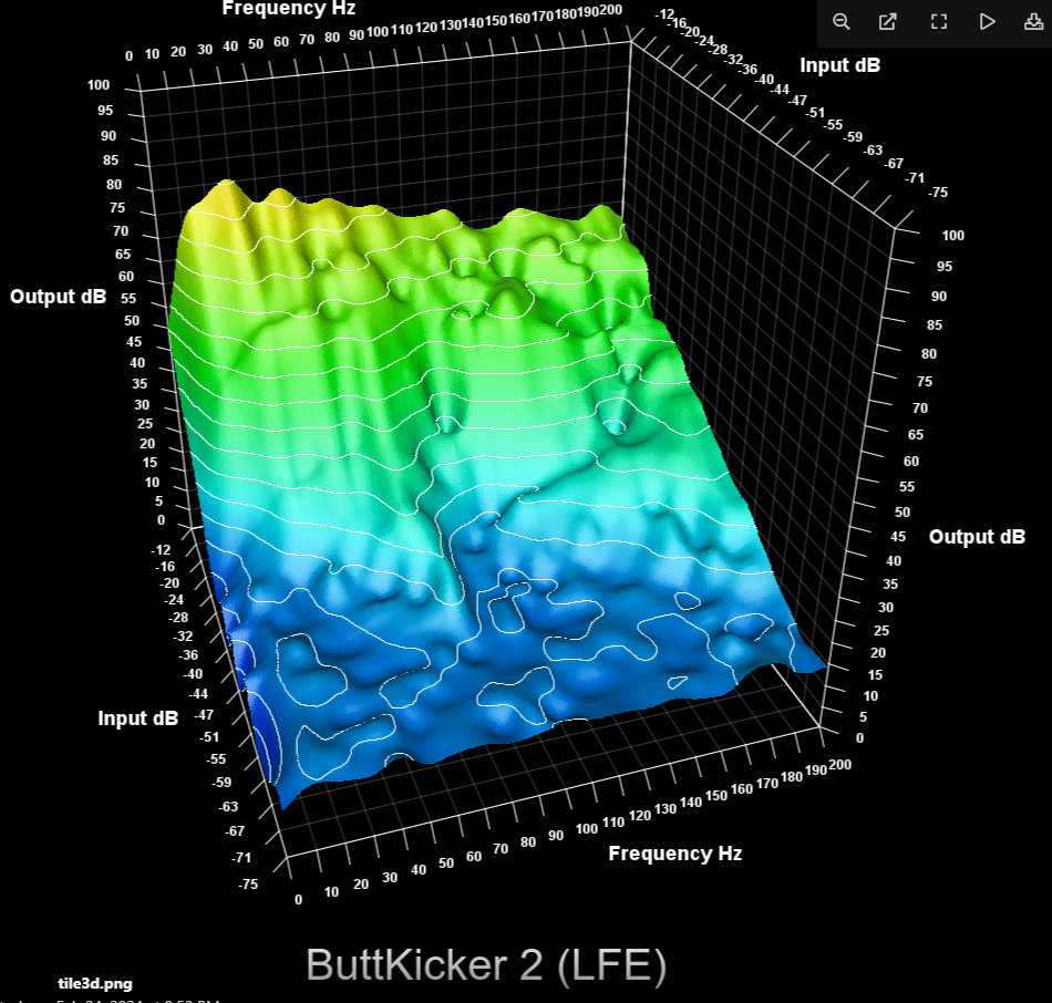

It's worth noting that typical bass shakers have a resonance peak and roll-off, so getting very low frequencies is likely to take more of them to compensate for that - similar to trying to use a regular speaker below resonance.
This page is older, but has a couple response curves toward the bottom and resonance frequencies for multiple units.
http://www.baudline.com/erik/bass/tactile_report.html
For a non-audio project, I've been using some exciters down very low (like 0.5-10 Hz). Their power handling is much lower at very low frequencies, so if you are using them below their rated range watch out for that as well.
