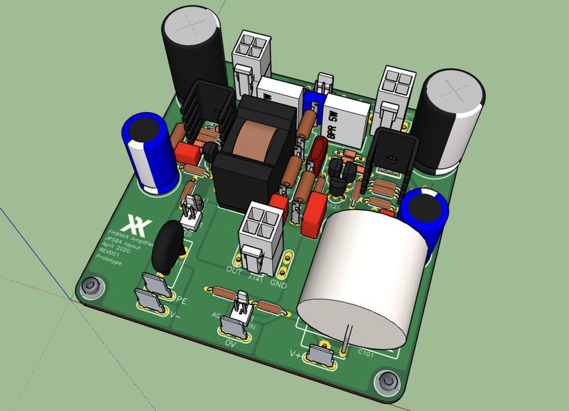

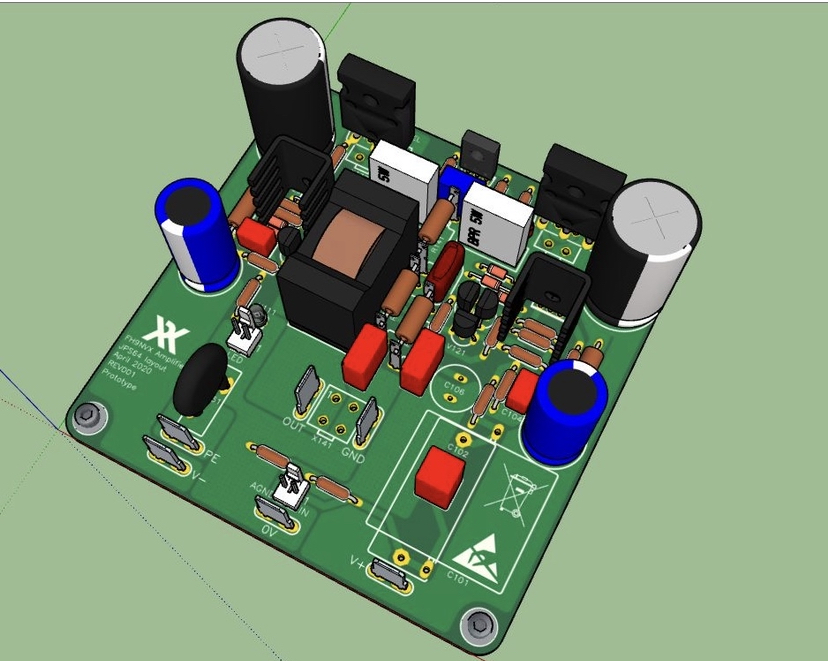

To help you visualize the amp (With some premium components):
attachment.php
No boutique cap and on-board traditional MOSFET mounting. Can be underhung from PCB as well:
attachment.php

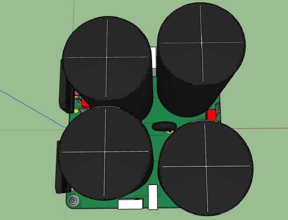

Founder of XSA-Labs
Joined 2012
Would anyone be interested in a simple CRC PSU board to go with this amp? I know many examples are on eBay, other GB's, etc. so not sure how much interest. It would be designed by JPS64 so you know the layout will be done with low impedance traces and attention paid to keeping the system low noise.
attachment.php
For the output Thiele network inductor, I am specifying a premade 27A 15uH shielded flat copper wire inductor from Coilcraft. Yes, I know, it is $7 but saves you from winding your own from magnet wire (which you are still free to do). It also looks way cool. I use similar inductors on the output filter of my TPA3255 and I think they are part of the reason why my amp measures half the distortion of the TI reference amp which uses toroidal inductors.
Reactions: 1 user
Hello x,
Not sure if putting a big antenna of a cap and long signal traces near V+ is good idea...
Supply rails go all around the PCB , I would try to keep them as close as possible to the big current components.
here is another version of a compact CRC made by me in the APEX thread.
100W Ultimate Fidelity Amplifier
my 2c.
regards
prasi

Hi Prasi,
Thanks for your comment - noted. Your CRC layout looks very nice too.
X

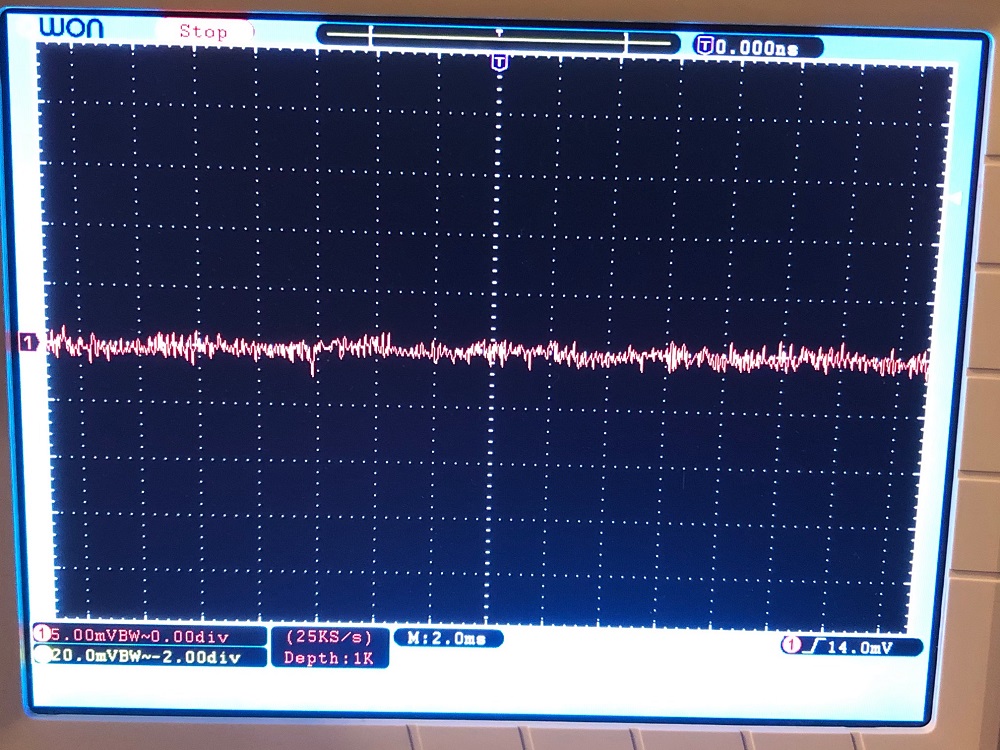

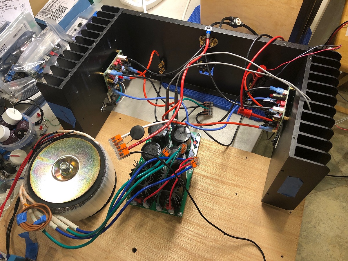

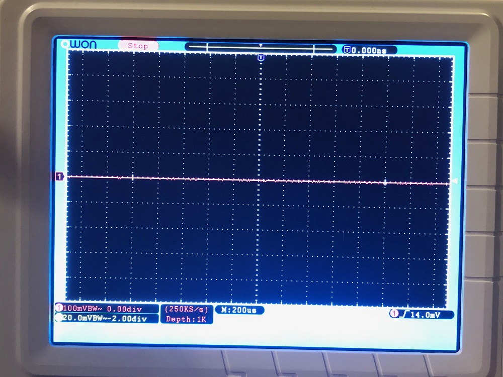

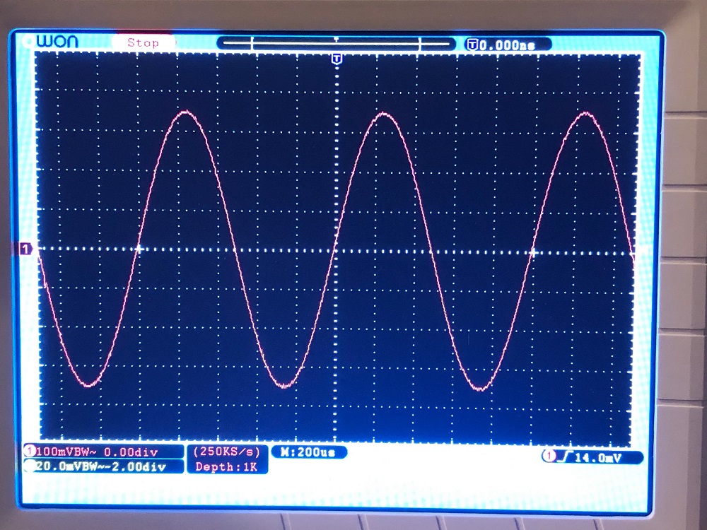

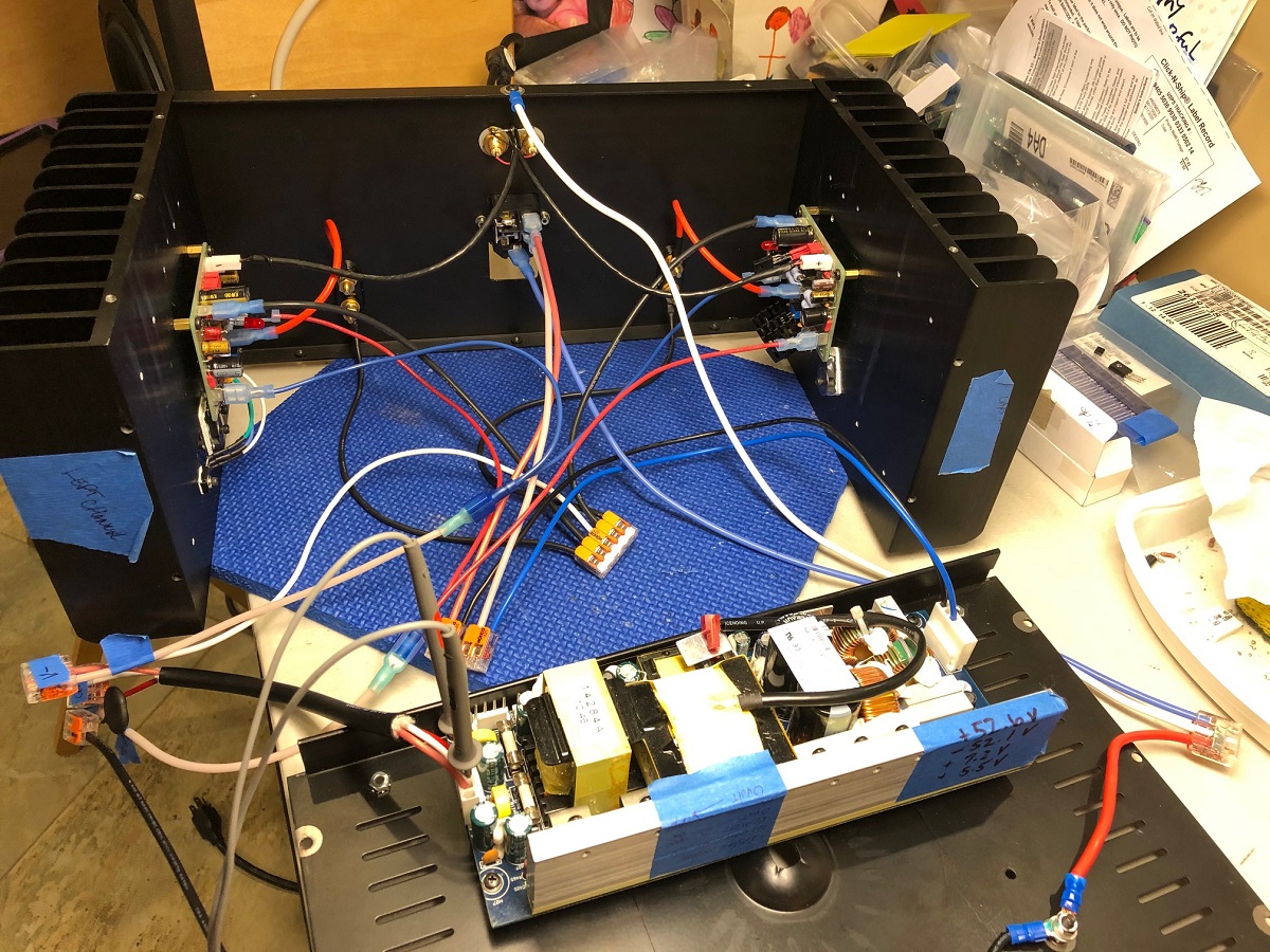

Some updates on pre-prototype testing by Vunce using old Sonal K PCBs with KSC3503 for LTP CCS and revised resistor settings on LTP. Test were performed using a 38v linear trafo and CRC PSU show that amp has clean low noise background, does not have oscillations, hiss or hum. Also, use of KSC3503 and revised setpoints reduced the high temp condition of previous BC546 used on the CCS. JPS64 has also come up with a totally revised layout with shorter traces for the power rails, and optional solder bridges that can be used to locate the power inpouts on either the left, right, or both edges of the PCB. A new Wurth 1.5uH inductor is now specified (or one can make one with magenet wire wrapped on a 12mm dia mandrel).
Here is an O-scope shot showing the amp output with a small signal sinewave input to check for signal response cleanliness:
attachment.php
Here is sinewave generator turned off showing the clean low noise background at 100mV scale:
attachment.php
Zooming into 5mV scale still looks really clean. No hiss, no hum, no oscillations:

Here was the test rig using a 38v trafo and a CRC PSU (Prasi 4x22,000uF):
attachment.php
An Abletec +/-52V SMPS was also tested and the output was totally hiss and hum free. Measured 0.4mV rms on Fluke 101:
attachment.php

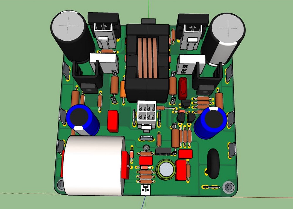

Here is the totally revised layout of the FH9HVX by JPS64:
attachment.php
I really like the new layout! Looks way cool. Super flexible with options for power connectors on either or both edges. Nice symmetry and super cool looking 1.5uH ouput inductor rated for 95A! Yes, overkill but you have to have a cool part in here somewhere to make it special. :)
A big thanks to Vunce for doing the pathfinder studies with the pre-prototype board and a big thanks to JPS64 for working his magic with the layouts.
I can't wait to build this little amp! :D
