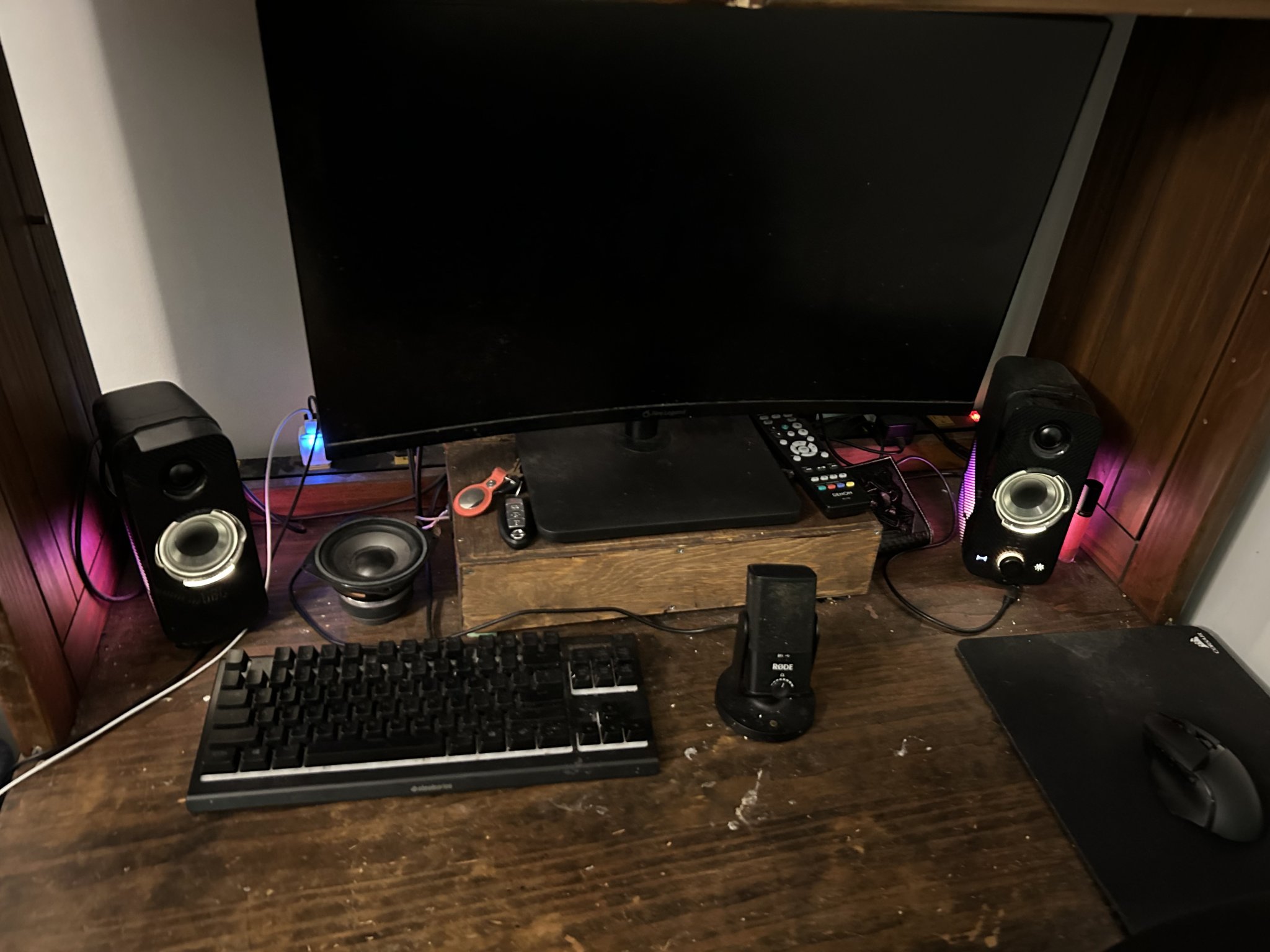

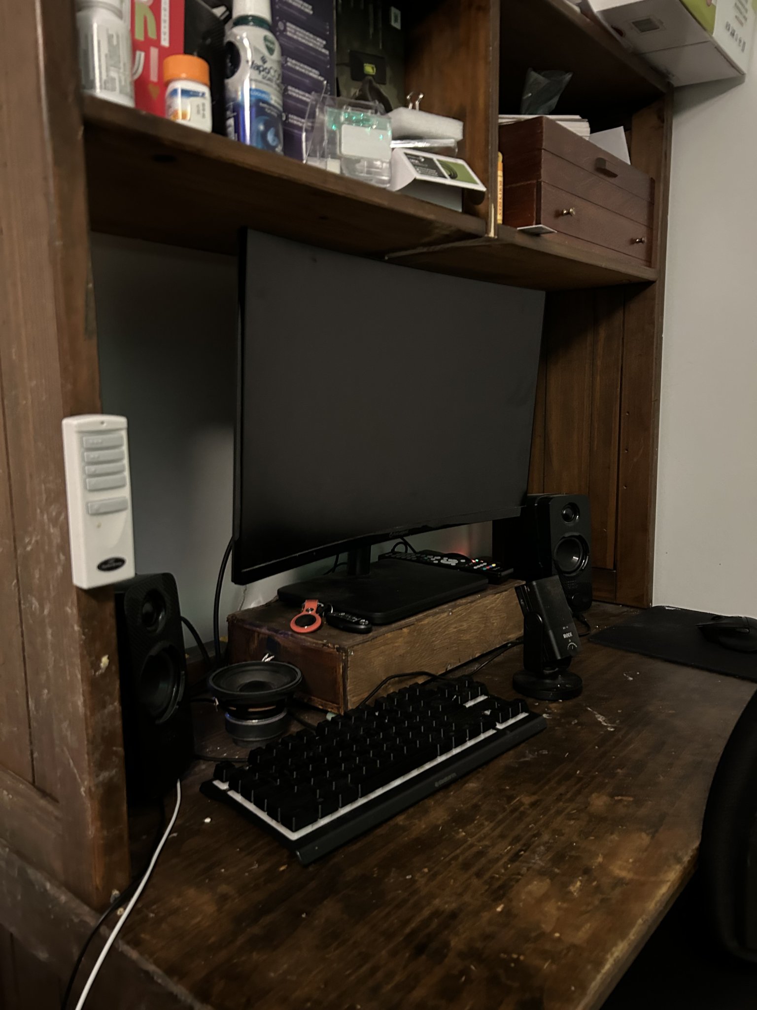

I like that idea but I’d only go down firing for a computer stand subwoofer and this sub seems too big for that. I built one before that sounded pretty good but was very low to the desk and it affected the sound too much. I do have a lot of space behind the monitor tho and I’m sure if I wall mounted it, it would sound good. If not then maybe a small sealed sub would work behind it like a Pioneer TS-A2000LD2 in its recommended sealed enclosure or something more efficient and ported or with prs. I’ll have pics of my old monitor stand sub and the space behind the screen where I can at max fit a 24x12x4 inch enclosure.

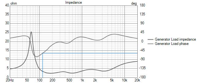

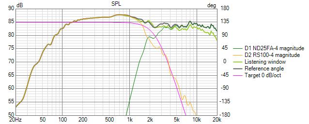

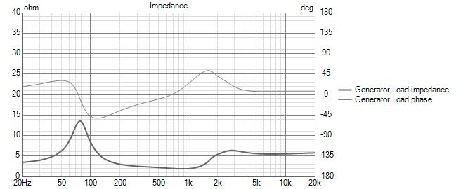

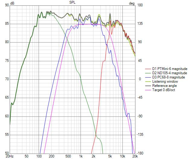

Yes, I used used VitiuxCAD to simulate your design. I made a 3 way using the Dayton woofer and tweeter. I picked the Dayton PC68-8 as a mid range. The XO to build a 3 way will cost substantially more than the drivers you are picking. Honestly you should find a tweeter you can cross lower and build a 2 way.

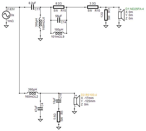

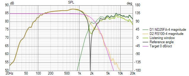

Here it is, please remember that this simulation won't necessarily match what you will build. Using factory data that was measured on an IEC baffle won't match what your enclosure will generate. This is just a proof that you chosen drivers might work. I'm crossing around 2khz, most likely to low, but for low SPL use it might be OK.

Using factory FRDs and ZMAs doesn't take into account box effects, edge diffraction, and the like. Based on this, inaccurate simulation results are obtained. The only thing worth doing is measuring the individual drivers in the actual box, then simulating, then tweaking until it sounds right. If you don't have measuring equipment, take some proven design.

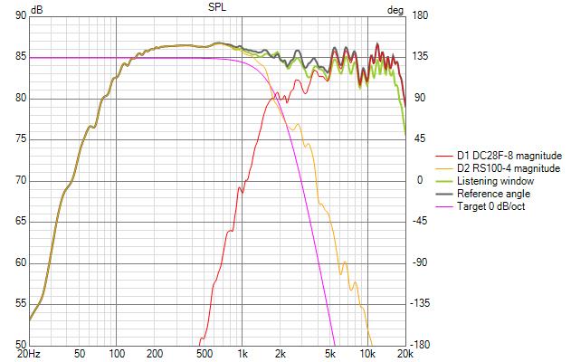

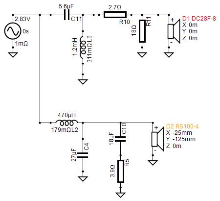

First, I agree completely @NIXIE62 about the need to measure with the drivers in the enclosure. Next, don't worry about revisions, download VituixCad and add drivers in the drivers tab and import the FRD and ZMA files that can be downloaded from the Parts Express site for Dayton drivers. Then go to the crossover tab and build the XO's you see in my posts, then have fun. Next the ND25FA-4 has a nasty resonance peak the shows as a 4db peak at about 1.6khz which required the parallel notch filter in the tweeter circuit. The cost of these 3 components will cost more than the price difference between the ND25FA-4 and the DC28F-8. On top of that it will be a huge challenge fitting 12 components into you cabinet vs. 8 with the better tweeter.

The schematic in post #1 and diagram in post #19 are the final versions. He had something different originally in #1 but deleted it and replaced it with the updated version.
