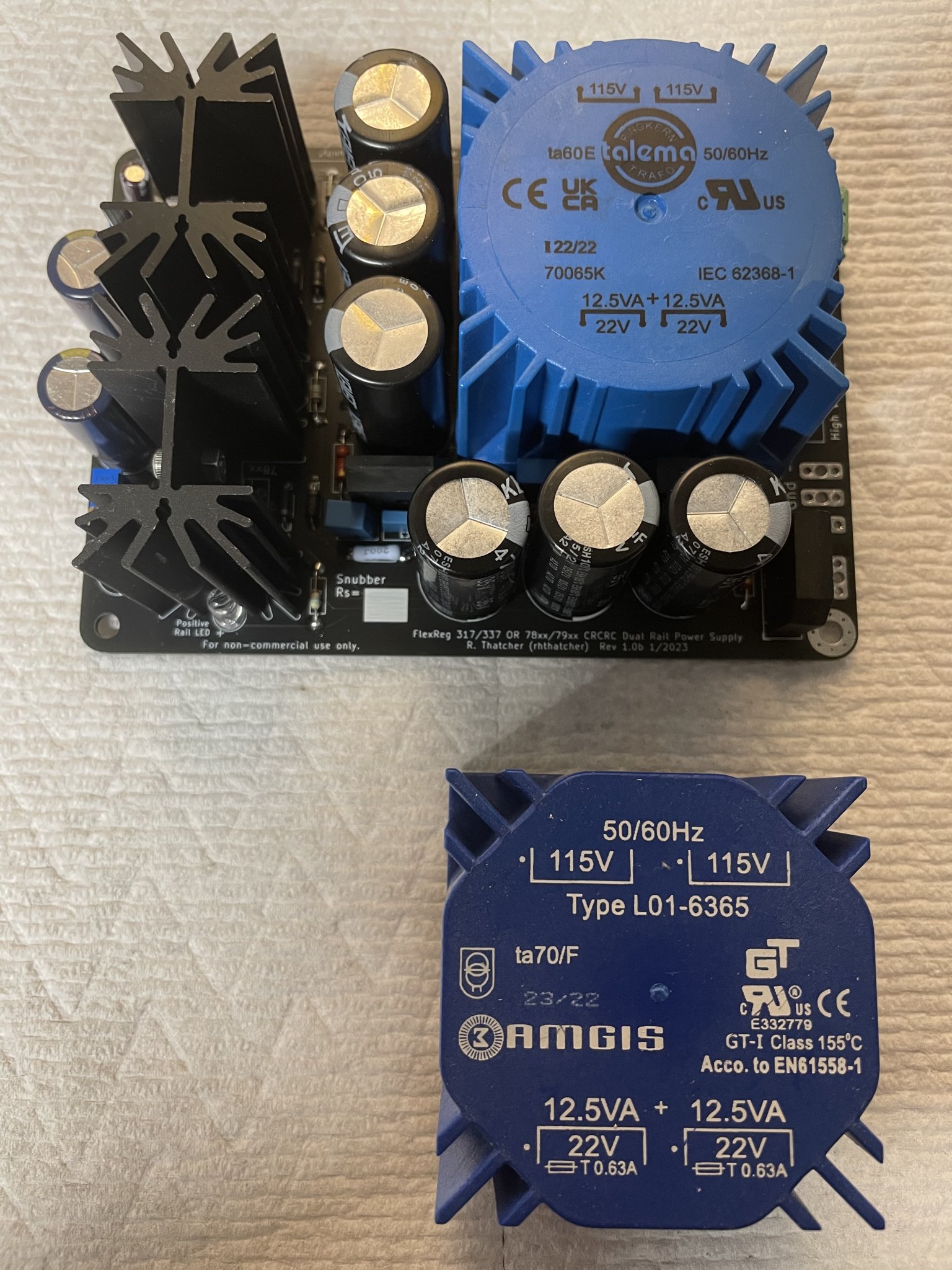

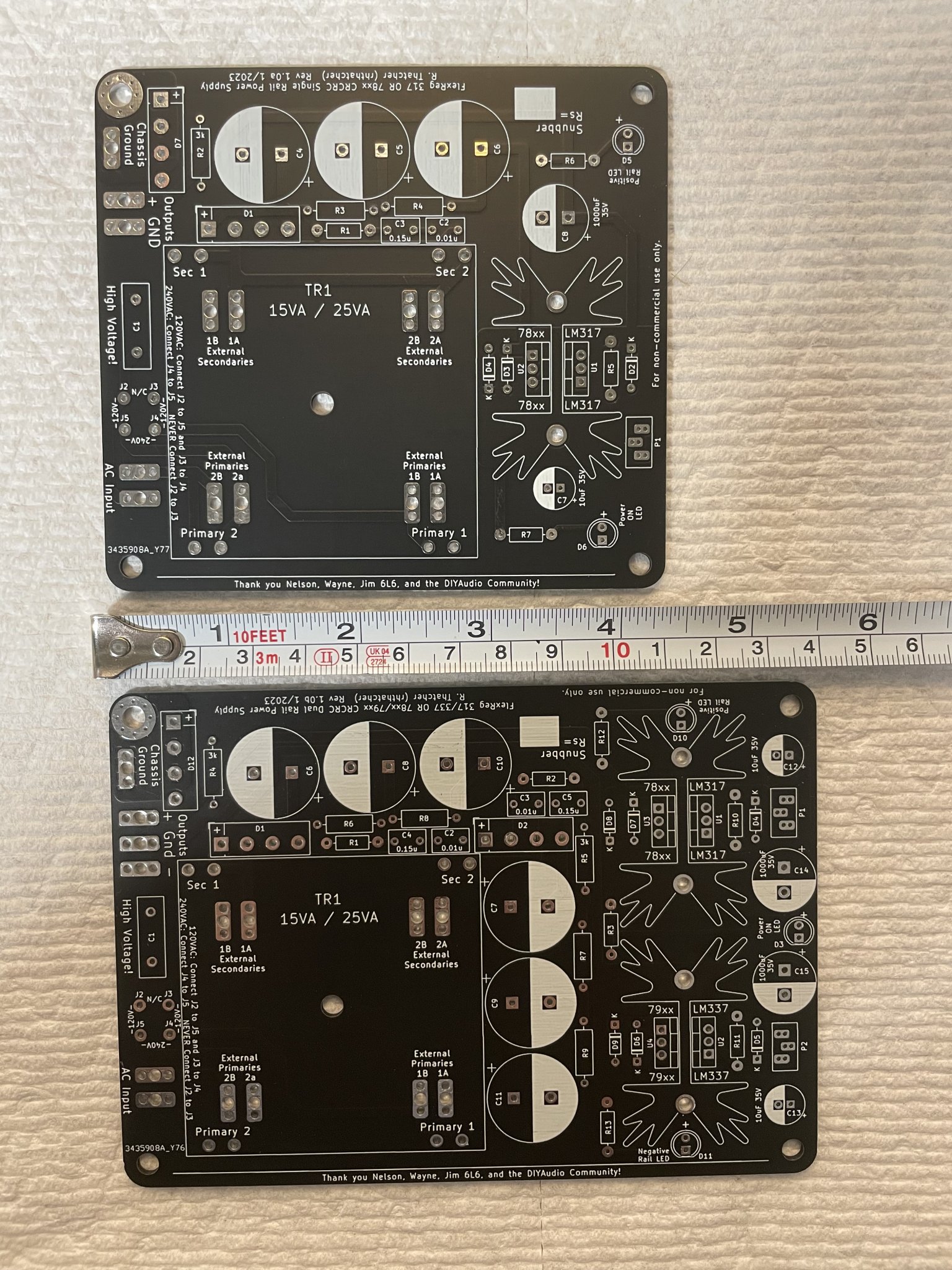

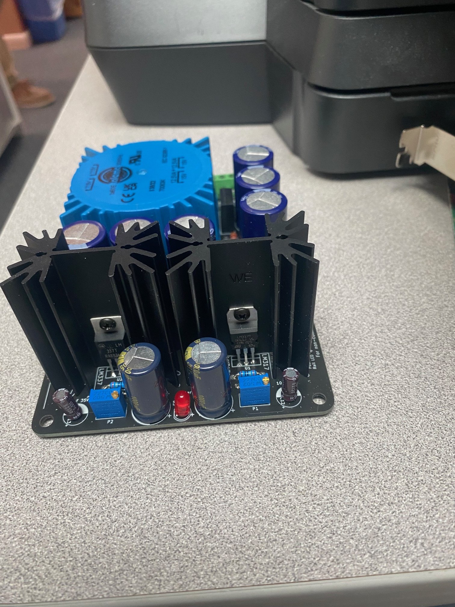

The idea for this PCB is to provide a flexible dual-rail general-purpose regulated power supply for low-power audio projects (e.g. preamps, crossovers, etc.). The design goals for the board and power supply included:
  • Compact with PCB mount transformer & optional connections for an external transformer
  • 15 or 25VA Transformer Options
  • Dual Rail Regulated DC power supply (Positive & Negative)
  • Flexibility for using standard 78xx/79xx family of fixed regulators OR 317/337 adjustable regulators
  • Able to fit in an off-the-shelf Hammond chassis OR into the 10x10 grid of a Modushop / DIYAudio chassis
  • CRCRC pre-filtering before regulators
  • Include ground break rectifier on the PCB
  • Include A/C cap on the PCB
  • Flexibility for 120/240 mains
  • Optional items for users to populate or not:
  • LEDs on PCB (for rail voltage indication and front panel indicator) – optional to populate
  • Snubber circuitry
Thank you to Jim “6L6” for the inspiration, brainstorming, and encouragement on this project!
The first one I built is in a headphone amp using a 15VA transformer and 7812/7912 regulators. I have also built a variable 317/337 version for a BA3 preamp project.

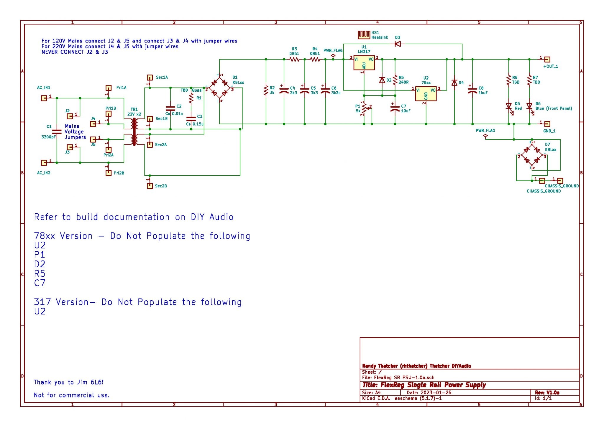

  • FlexReg Regulated Single Rail Schematic-1.0a.pdf

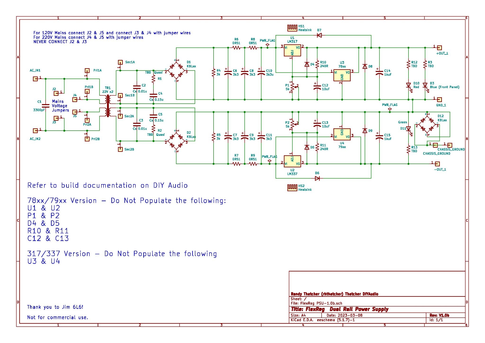

  • FlexReg Regulated Dual Rail Schematic-1.0b.pdf

As a long-time service technician, and having custom-built many electronics, I fail to understand why the LM317 regulator needs yet another(fixed) regulator after it to provide a normal regulated DC voltage.
It looks to me like they'd fight each other input-to-output.
Explain, because the diagrams and text are utterly confusing.
Randy;

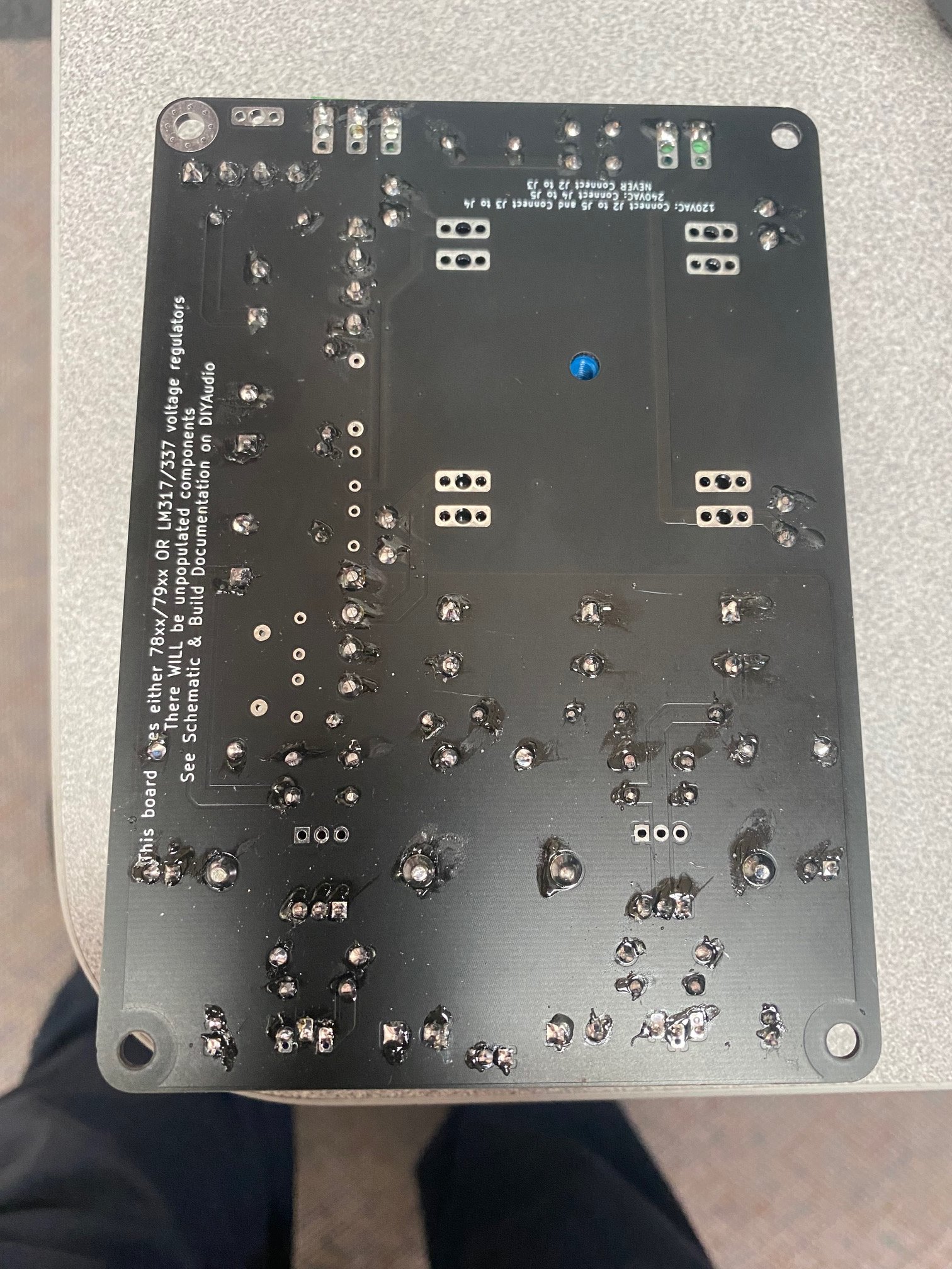

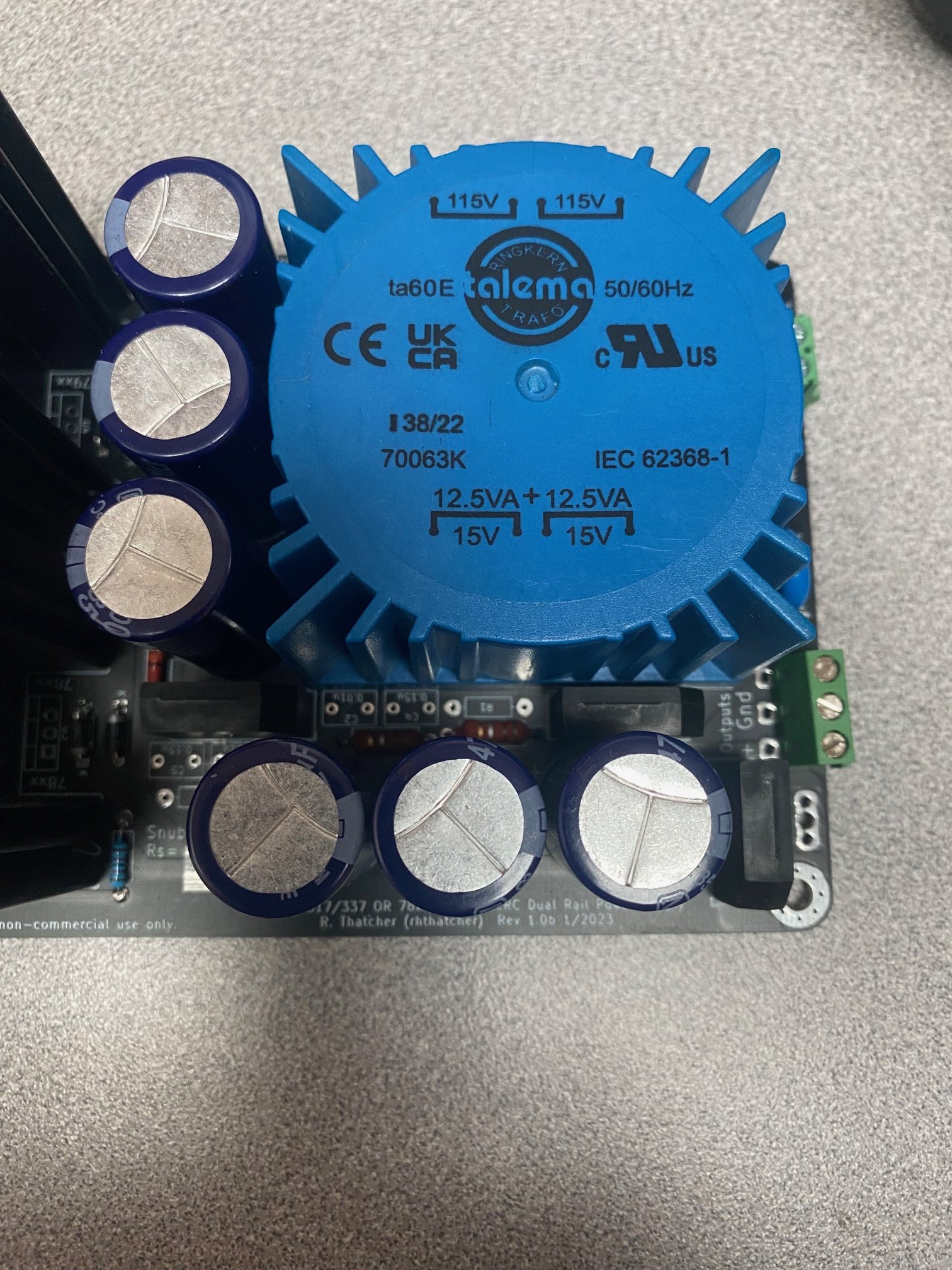

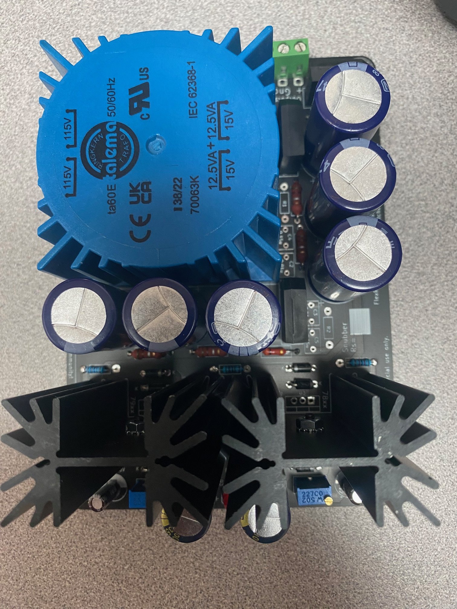

I got the board on Friday. Board looks good very clean layout. Saturday i was leaving at 7:30am to go see my oldest son, wife and grand daughter and go to cocoa beach air show and got up at 6:00am. So I started on power supply. Went together easy and had it working before I left. Only issue was R6-19 resistors on sheet was R6-9 .51 ohm. Very nice build and works as expected. Will send some photo's later. The one I am using now does not have transformer on board and I like yours much better.
Bob
