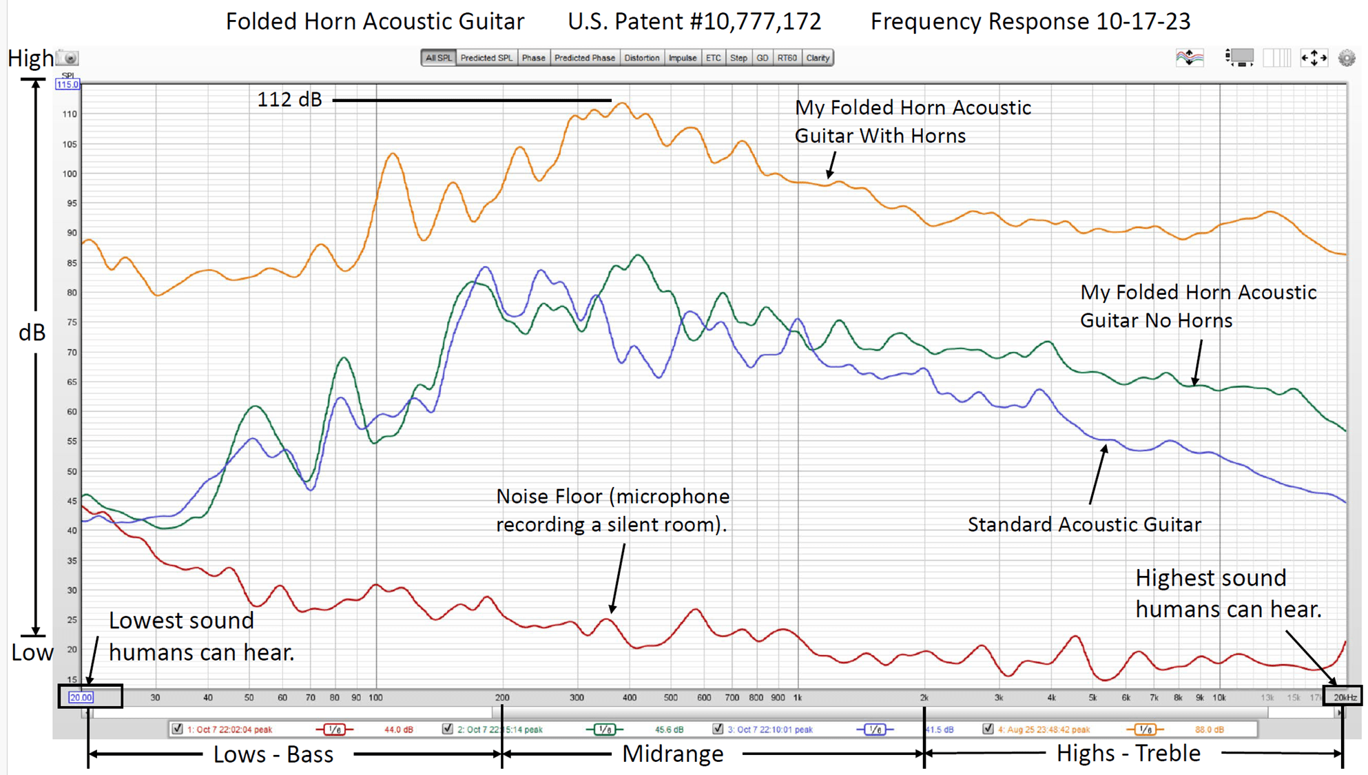

I am surprised that the 82 Hz is not stronger in your data, it is very strong in many of my REW recordings. You mention, and I can see, the second harmonic at 164 Hz. I know it sounds good, but would like your opinion of how effective this second harmonic is, thoughts?
The with and without horns clearly boosting the low mids is great in my opinion, I really love low mids on a guitar, sweet spot, thoughts?

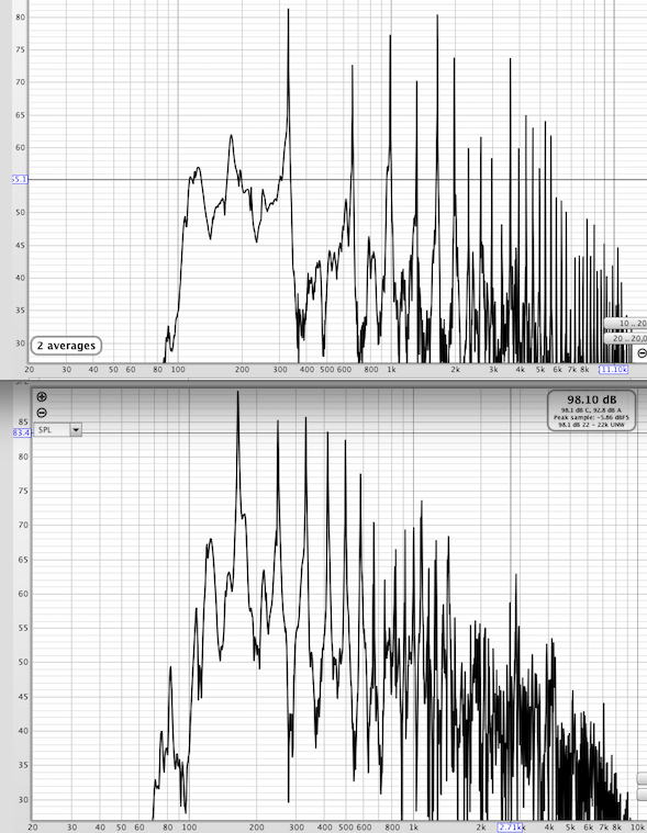

For most string instruments in the lower registers the second and higher harmonics are louder than the fundamental. In the upper notes the fundamental will be as loud or louder than the harmonics.
Here is an open low E bottom string (lower chart), high E top string on an acoustic:
Up to around the ~48th harmonic is louder than the E82Hz fundamental, while the E330Hz harmonics are all a lower level than the fundamental.
The ratio of the harmonics to the fundamental determine how "bright" or "dark" an instrument is perceived.
The effect of the fundamental being as loud as the second harmonic in the low registers tends to sound "muddy".

Art - I assumed that the fundamental was stronger than the harmonic in all cases, seems logical, but an assumption, which is often wrong. OK got it, I will buy that, and especially interesting that they are stronger in the lower register only, I wonder why? :unsure:
Your assumption does not seem logical to me, but I've been looking at RTAs of instruments for 45 years ;)
The second harmonic is louder because the acoustic instrument is not large enough to resonate the low frequencies as loud as the upper frequencies. If you built an acoustic guitar with a double bass sized body, it may have a fundamental as strong as the second harmonic.
Lower (thicker) strings have more mass, which tends to reduce upper harmonic level compared to thinner string

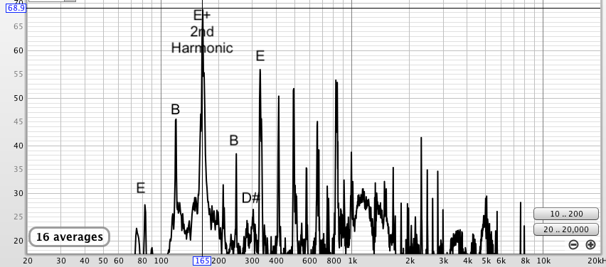

Looks like it may have been an "E" chord:
Could hear the amp clipping distortion initially, then it settles down to a less objectionable level.
As usual for the FHAG horn response, not much below 124 Hz or above 800Hz.
The horn's rolled off upper response also filters out the speaker's upper harmonic distortion.

Art - E chord indeed, look at that strong 2nd harmonic, really great data. My data also falls off below 124 Hz and above 800 Hz for sure, but not as aggressively as your data, not sure why. Plus a standard acoustic guitar also does this, almost as aggressive as your data, but not quite. My FHAG with horns on is much flatter comparatively, so encouraging. I am highly interesting in this comparison, plus I can hear the guitar sounding great, not missing any low end and not missing any sparkle up high, compared to what I am used to hearing from an acoustic guitar.
Since I am obviously measuring the guitar itself, and you are measuring a recording of the guitar, do you think this has any affect, or no? Thanks! Joe
Joe,
Great data?
Really?
Can't tell from the screen shot in post 995 or listening to your latest feedback performance the contribution of the 82.4Hz low E second harmonic compared to the fundamental E164.8Hz on the second fret of the D string, or the contribution of speaker (and amp) harmonic distortion compared to the guitar's acoustic output in the harmonic sequence seen.
Easy to hear and see that ~165Hz is honking more than twice as loud as anything else(y)

Art - yeah great data, I didn't say great sound. This is an E chord banged out at too high of volume, and with too much tone control increase, just to get this long sustained chord that is very close to feeding backing, but just not quite there. I don't expect it to sound good, unless you want a raunchy sound for a song ending maybe. It looks like a more extreme example of strong around 164 Hz and much weaker up at about 8,000 Hz earlier data.
I would expect 164 Hz to be strong, as it is the second harmonic as you note, plus you can see the three lower strings really vibrating strongly (not sure if you can see that in the video), and especially the 3 string (D when open, but fretted in an E chord is an E note at 164 Hz frequency). It is vibrating more than any other string. Again, at frequencies I like, and in my opinion give the acoustic guitar a rich warm sound. I really really like to hear those lower three strings be more dominant than the higher three strings (especially the dreaded tinny high E string). I really want these frequencies to be dominant. Of course I also want the harmonics, and they fall off very fast in your data, but nowhere near as fast in my data, still not sure why the difference. Thanks! Joe

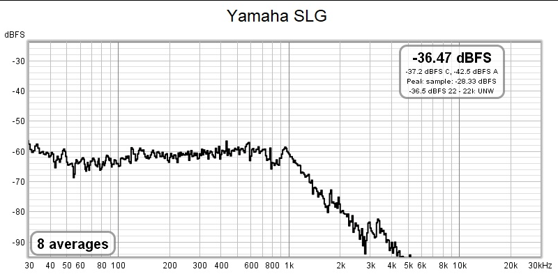

I think I posted before, here's what our friends at Yamaha think is a good pickup preamp response for a nylon, "silent" guitar. They roll off at 1kHz -
When I take it to the open mic, I usually get compliments on how it sounds. No one says where's the sparkle, or why is your guitar so dull sounding. This is Pink Noise mechanically driven into the bridge pickup.

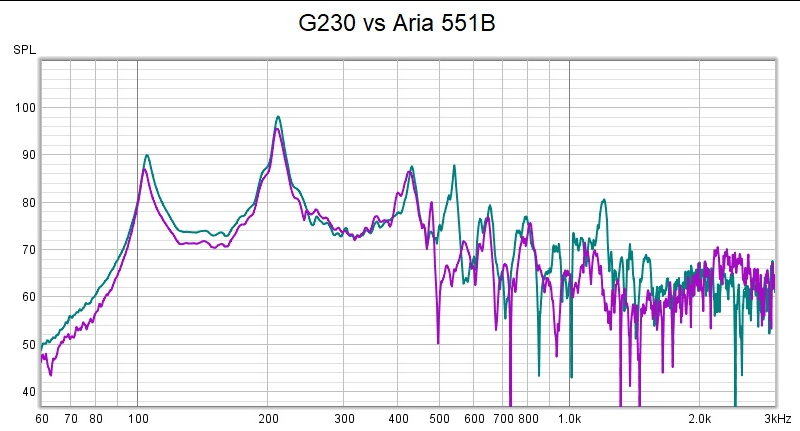

If I take the same "Sound mechanically driven into the bridge" and put that into an acoustic, measure the sound radiated from the body, something like this gets filtered through - I think it's a sweep this time...
Note how two different guitars actually track until ~500, where one peaks, the other troughs, then they track again for a couple more peaks, then one peaks at ~9XX, while the other troughs.
So one way is the Yamaha flat to 1k, roll off, put that straight through a commercial guitar amp, sounds good. Another way is Yamaha flat to 1k roll off, put that through a filter set with 7 or so peaks, say at 110, 220, 440, 5XX, 6XX, 8XX, 9XX - and then it should sound acoustic guitar-ish.
Question; does the FH part implement a filter set anything like the above? One would think any physical length sound has to travel down to get out and radiate is going to have an f0, a double, a quad, etc. I would propose if the tuning differs from the above, it can still sound like a guitar, just not so much like a Yamaha G230 or Aria 551B. Nothing wrong with a deeper tone, as long as the "guitar-ish" overall character is there.
