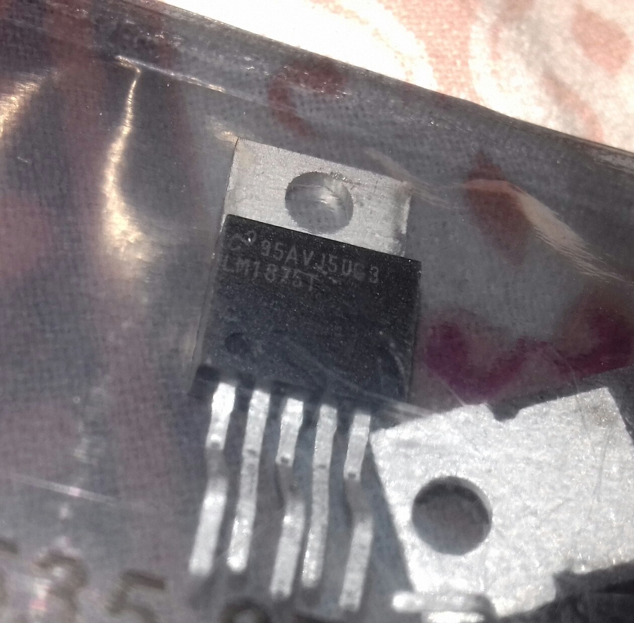

Found a couple of "LM1875T"
Hey people,
I found these "LM1875T" ( I assume the common, not so bad sounding, fakes as everywhere). I just forgot I have them, as I changed to LM3886 just because of the higher output power. I remember them as really good sounding chips, and it would be a pity to not put them to use.
I thought, maybe I could try two of them for my tweeters, which are powered by LM3886's atm. It's all fully active, so the different output power can be aligned easily.

(hmm, it says uploaded 100%, but the pics just won't show up)
Try to post some pics.I don’t know why you are assuming they are fakes .
these chips are available from ti.com
They sound really good, could be the original chip. They take +/- 28.5V, this is ok, too. Sadly all internal protection circuits, like AC & DC short circuit to ground prot. are missing. You have to be very careful with these Chips. If you make "Boohh!" the chip makes "bang!".
I made many audio amplifiers using fake audio ICs like Lm1875, tda2030/50 etc. They all sounds very good; of course at a certain level. You can't expect 30 watts of power from a fake lm1875. That is the difference. A fake chip can't compete the reliability of a genuine product.
Edit- Since two yrs one of my friend is using fake tda2050 stereo with +/-25vDC power supply & 4ohm load. 2×18v 180VA transformer! o_O
Next try with some pics.
