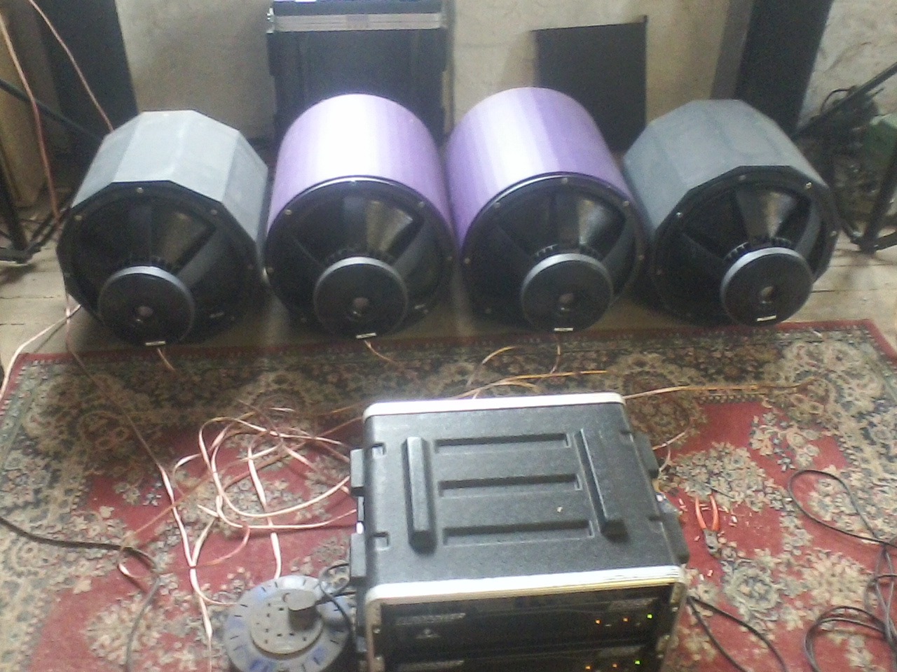

Thought I'd share this project I've been working on.
Background: As part of my PA system, I've been running some 15" ported subwoofers for a while. Beyma 15P1200Nd, compact boxes tuned to 40Hz. They've generally been good to me, but there are some problems in the construction (drivers hitting the grilles, stuff like that - mostly my own fault) that meant I was never 100% happy with them.
Drivers have moved on since those Beymas - more Xmax, more power handling. As an example, I happened to have accumulated 3x Faital 18XL1800 drivers, which feature an Xmax of about 20mm, and long-term thermal power handling of 1600W. Short-term, they'll take in excess of 3KW.
I have a good relationship with a local theatre director, and he'd hired me for a show called Into The Woods, which features (among other things) a giant. When I suggested that I build some subwoofers capable of strong very-low-frequency output for the giant's footsteps to be felt as well as heard, he was enthusiastic about the idea.
After some messing around with Hornresp, playing with cabinets of varying sizes and complexity, I decided on sealed boxes for these drivers. The reasoning is this: at 40Hz, they'll keep up with the previous ported subwoofers, which were usually loud enough. If I need these new subwoofers to go louder, I can raise the low-frequency cutoff, gain efficiency, and put out more SPL. Similarly, if there's plenty of Rig For The Gig, I can throw more power at them and get more LF extension. The cabinets would also be very compact, which is a Good Thing in the live sound world.
Side-note: it may be of interest to see what sort of performance an off-the-shelf product gives. Here's one: https://products.electrovoice.com/binary/EKX-18S_F01U308106.PDF
The venue in question is small (100 seats), so I decided to push for maximum LF extension:
I set off with a 12dB/octave lowpass filter at 18Hz (the red curve), which gave me a response that's pretty flat across the subwoofer range. Then, I decided to increase the fun-factor, and made it 18dB/octave (green). Afterwards, I increased the subwoofer level accordingly, so that the crossover to the main speakers (approx 70Hz) lined up well.
Power and processing was done by the rack of Powersoft T-series amps:
With the T602 bridged into two of the subwoofers, and the first two channels of the T604 bridged into the third subwoofer. Result: around 3KW per driver - enough to make use of the driver's generous Xmax for short-term peaks.
The giant's footsteps were played by timpani, as part of the show's pre-recorded music. Running that section through an RTA, the timpani had strong content down to 30Hz. While that's pretty useful (and would've been fine, I'm sure), these subwoofers can go lower, and I wanted to make use of that. Within the mixing desk, I took a digital split of the music input, applied a low-pass filter at about 80Hz, put it through an octave down, and mixed that into the subwoofer feed. The results were a lot of fun - even the lighting engineer was impressed.
This venue hadn't ever been subjected to a PA system like this, so all sorts of interesting rattles were apparent. By far the most distracting was a light fixture, so that one was removed entirely. With that gone, the quieter and more distant rattles contributed to the "there's something big coming this way" effect, so we decided to stop chasing perfection and have some food instead.
I found time to play a few bits of music (without the octave down), and the high output combined with serious LF extension was an excellent experience. Violence by Andy Stott was a good demo.

Nice report the subs are very compact. I get max SPL (one sub/1m):
20Hz: 107dB
30Hz: 114dB
40Hz: 119dB
using the sensitivity (95dB/1w) and rated power handling (3200W) I get max SPL I get 130dB/1m. In the sealed boxes this is achivable at a minimum frequency of 70Hz before it becomes excursion limited. The subs are very small though!
I have run sealed subs at high duty cycle for PA before (also with lots of low end EQ). Over a few hours the box itself gets quite hot and eventually I lost a driver due to adhesive failure in magnets so i would recommend venting them. The vent can be tuned below the pass band of the speaker using a long narrow diameter pipe pair which will effectivly exchange the air in the box.

IIRC, I've got it so they can exceed Xmax by a few mm when hit with 3KW. These drivers don't produce any nasty sounds (apart from the motor exchanging a LOT of air) until around 50mm p/p, so there's a little bit of wiggle room there.
I have plans to connect the pole vent to the outside world via a short tunnel. Should keep things nice and cool, albeit at the expense of wind noises at the back.

Yep, a bigger sealed box would mean less power needed to reach Xmax. However, for portable PA use, I had to balance power input vs size. The amplifiers I'm using are very efficient, and have enough output to ensure the driver's maximum potential is reached in these compact cabinets.

Chris,
I have two thoughts for you.
1: Regarding possibly making the enclosure larger. I assume you already know that there's a "sweet spot" for sealed subs, where the QTC is considered ideal. I've also read on some forums that a larger box will be less punchy. (though I can't personally confirm that.) When I was considering going larger than my current 3 cubic ft sealed boxes, the numbers in Winsd didn't improve much, so I decided that the small gain in output wasn't worth a sonic tradeoff. That might be different with those Faital drivers, but probably not.
IMO, cost aside, it's better to keep them small and use more of them. (Then you also get less distortion.)
But you went even smaller than this, correct? I can't imagine why. 3 cubic feet is pretty common for getting QTC of 1.0 with an 18", and that's still incredibly portable. You obviously know what you're doing, and that is a different driver, but I'd be very surprised if 70L is ideal, sonically.
If it is, I'd love to know, and also your thoughts on this.
2: Regarding a separate EQ setting for the tympani FX: Bag End's processor has a clever circuit that limits only the very low end (I assume below 40 Hz) when it exceeds a certain level. The threshold is user-adjustable. This of course lets you keep the HPF really low, all the time.
If your mixer has the capability, you could do the same thing with a frequency-dependent (or side-chain, or multi-band) compressor. I retired my Bag End processor a while back, as I now use the EAW version of a Drive Rack and put the same LF compensation into that.. Since I use a DAW as my mixer, I'm able to run a multi-band compressor plugin on my 2-mix, and it works even better than the analog version in the old Bag End electronics. Can that QSC load VST plugins?
Also, you probably already know this, but those Powersoft amps probably have some kind of " intelligent" limiting. That will add extra protection for the drivers, though of course is not the same as frequency-specific limiting.
It might be fun to try using a subharmonic generator on the entire mix. Very carefully, of course!
Either that, or wire every seat in the venue with a mechanical thumper. :)
CableAddict,
There are many differing opinions on "ideal". Some like Qtc = 0.5, others Qtc = 0.7. My version is to size the cabinet where Xmax (or slightly above Xmax, if the drivers overload gracefully) is achieved at the expected maximum power input. ie, for these I was aiming for a little over Xmax (I chose about 25mm IIRC (rated Xmax = 20mm), since they're just about starting to sound bad at 50mm p/p) with 3KW input.
I don't know or care what Qtc came out as. I've minimised box size while making full use of the mechanical output of these drivers, which is perfect for portable PA systems.
An excursion limiter is on my to-do list. Unfortunately, the Powersoft amps can't do it. The mixing desk might be able to with some EQ/limiting on a subgroup etc, but it doesn't have a multiband comp. I could route through a DAW, I suppose.
So far, though, I've done it manually and that's been fine. I EQ the subs to be flat down to 20Hz, and then set a HPF if the sub amp is hitting the limiters frequently. Smaller shows are often left flat down to 20Hz. Medium-sized indoor or smallish outdoor shows might be 30Hz, and the louder ones (outdoor rave at an army base, for example) was 45Hz.
