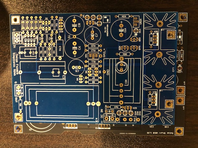

new boards are 152mmx107mm for one channel. But PS part is v-scored an can be removed. The prior board was discussed as two channels. I can try to measure side by side later for those interested in using same space.
Here is the old vs new board for sizing.
The old board measures at 140mm x 95mm

So, Have I got this correct? I use the 1.3S for that voltage range but I can use my existing 1.3 for the lower voltage range. And, only one needed cause it has both channels. But, if I want to I can just use a raw power supply? Why would I want to do that since the UBib1.3 has such great reviews?
I signed up. Hopefully if it doesn't make sense Tea will message me. Thank you both for this.
Don
Joined 2006
Glad you mentioned this.
This is incorrect, so it's worth pointing out. There is no build guide yet, so the original FSP serves as a precedent.
The raw supply is occasionally in a separate box, but is effectively a pre-filter and ground end point in one. Do AC/DC here.
The 1.3S. has no AC/DC. It adds two zeners here to keep the voltage up.
We did the earlier protos with standard UBIB. The problem is that a little voltage drop at warm up with the UBIB standard made setting the testpoint on the phono board not difficult, but time consuming. So this was altered to allow the voltage to remain pretty rock solid, and not drift from turn on to many hours. Plus, it's built onto the board, but can be broken off as well.
diyAudio Chief Moderator
Joined 2002
The 1.3S (S for special) is the Ubib shunt reg section of the phono for working steadier at the phono's rail voltage range. DC input only and outputs from 28V up to 38V only. Has a couple of opposite going Zeners for stabilizing drift and augmented local filtering. To help easier TP setting of the phono. Because the 2SK369s input stage when in LMC or MC setting has the tendency to drift along the same way with the regular Ubib 1.3.
The regular Ubib 1.3 outputs from 5V-40V. But its optimized for drift in the 5-25V lower output range. For the vast majority of general applications. Most of them don't care for small thermal drift anyway. It could take a Zener mod but its bulkier also as it has rectification bridge and Quasimodo network which go along with a transformer and we don't want a transformer's hum field in the phono box. We put the Raw PSU board and the transformer(s) in another box.
In other words we could use a classic Ubib but I developed a most right Ubib tweaked for this very job. Comes as standard attached to the phono PCB along a score line. No worries.
It can either stay attached or break away to be arranged otherwise somewhere near in the box. Say phono channels in the middle and 1.3s sections along the side panels if someone has a narrow box.
