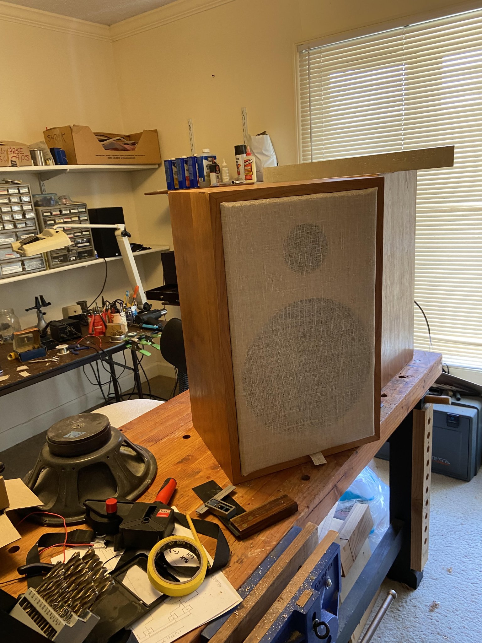

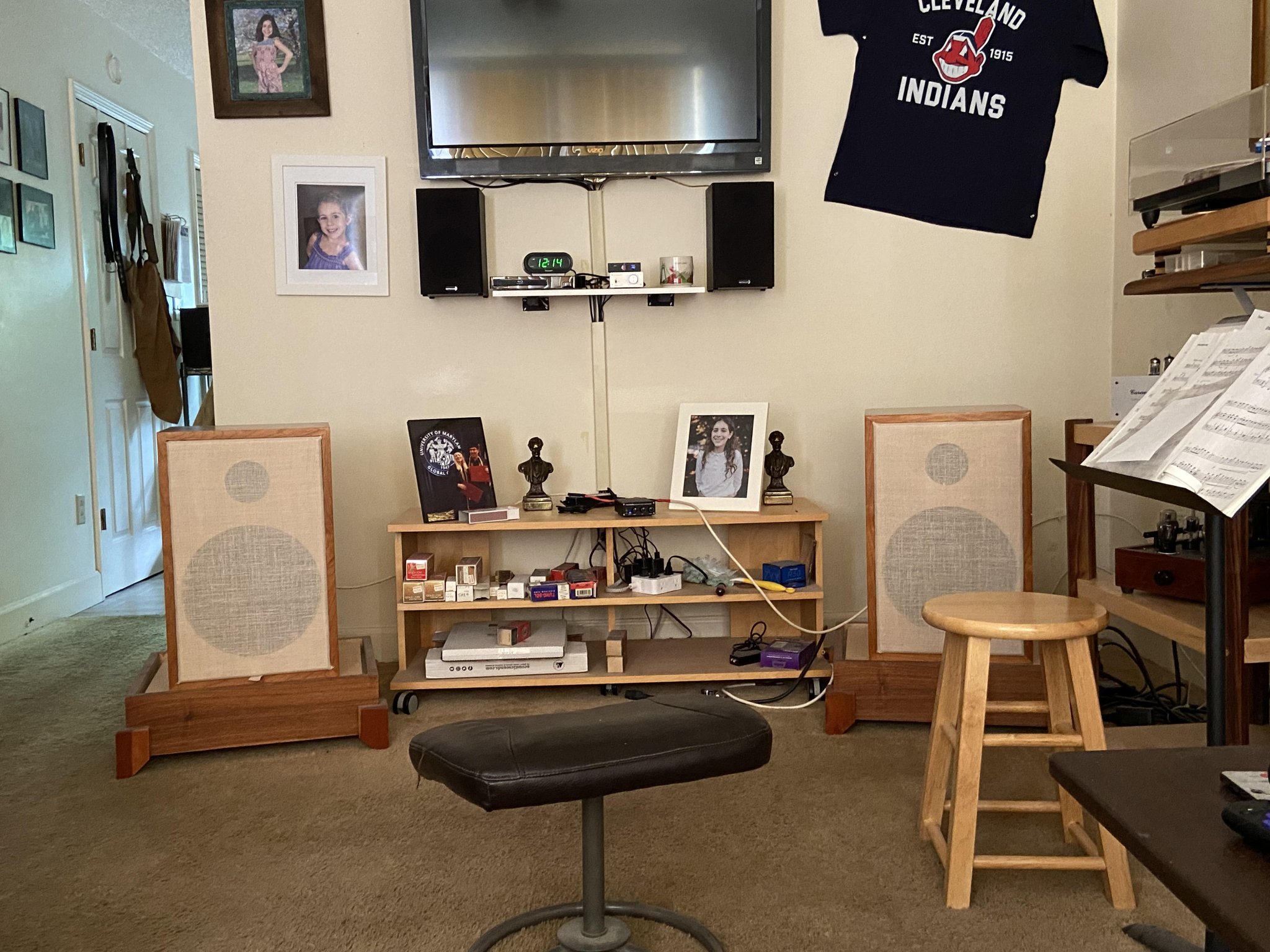

The final few furlongs are always the hardest but I got one speaker done and bumped downstairs on the 2 wheeler. Hooked it up to my cheapo Bluetooth rig and, playing off my phone, it sounds darn good. I knew the SB-29 tweeter was quite efficient but the channel balance when paired with the very efficient 4 Pi Pro had voices pretty much in the middle. The big Utah must be in the low to mid-90s.

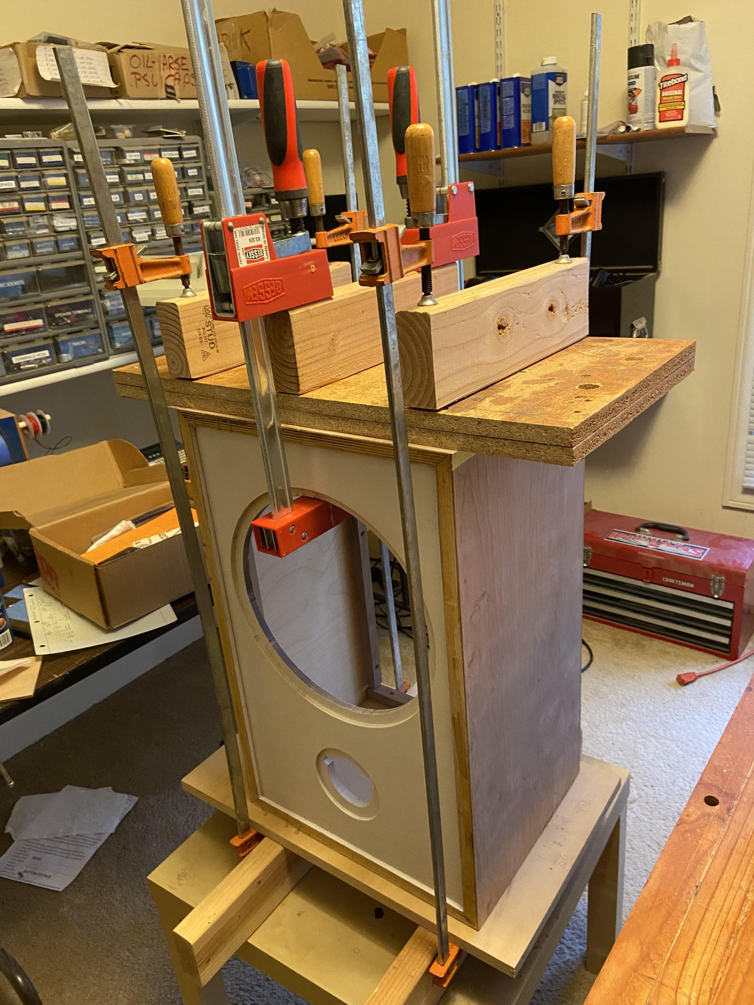

Tomorrow I'll close up the other box, wrangle it downstairs (Baltic Birch is HEAVY) and have a real listen.
