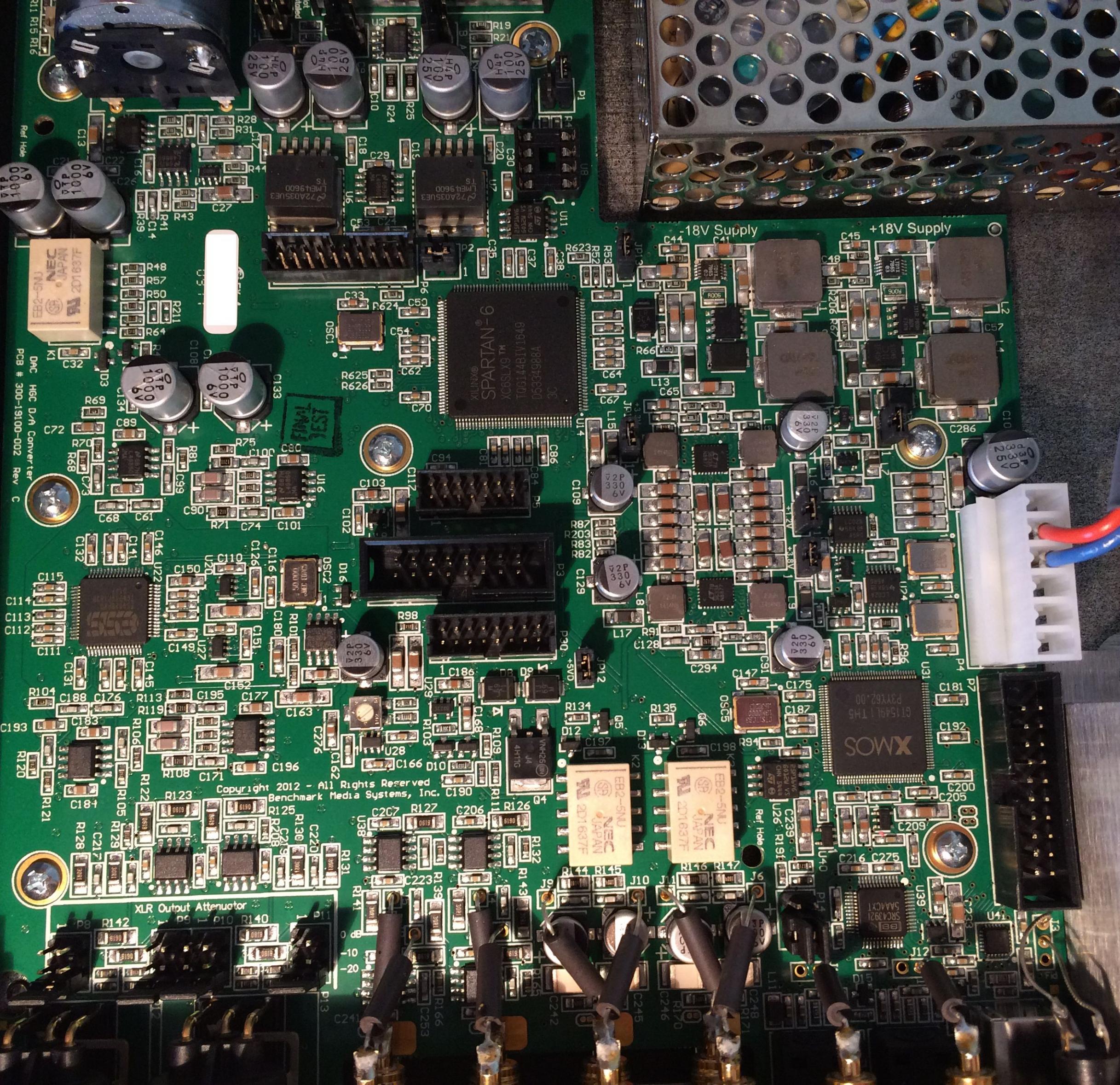

The SMPS can be seen in the upper right corner in the pic attached below.
DAC-3 is on the Stereophile A+ recommended equipment list. It sounds better than Katana ever could, as it uses external interpolation filtering and also some techniques to keep jitter very low while maintaining the benefits of ASRC. Just goes to show there are other ways to do such things, and although DAC-3 is not cheap, it is the least expensive on the Stereophile A+ list.

Thanks for the interior pix of the DAC3. My unprofessional assessment is that they have implemented a more extensive than typical power filtering regime with a number of inductors in addition to the LDOs and MLCC. Allo does similar, but generally has less real-estate available, so less-extensive. I'm sure what Benchmark did there is a key element of the SQ of the DAC. And the internal pix of the Mytek Brooklyn seen in the 6Moons Audio review (here: http://www.6moons.com/audioreviews2/mytek4/4_big.jpg), seem to show less extensive filtering than the Benchmark unit. It was one of the DACs that was improved by using an external linear supply. Draw what conclusions one may from that.
Still, finding a good set of SMPSs for the Katana may be a lift with the current offerings. That's why I'm watching the Nirvana closely. BUT as Allo has indicated, getting the quality they want from a unit able of a 5V/3A output has been challenging. That's why I have latched onto Allo's suggestion that adding a +-15V supply as part of the base 'getting the best quality' configuration, along adding an isolator which requires a third 5V supply for the RPi. This all lowers the current requirements for the 2 supplies powering the DAC / isolator and the Microprocessor board and broaden the good choices out there.
Back to the DAC3, I do like that Benchmark implemented their own filter regime. While the current generation of ESS DAC chips have significantly improved filters than the previous generations, they still are limited by the DAC chip real-estate AND the need to push specs as far as they reasonably can. Many suggest that much of the sonic signature of the Ayre DACs is also due to their proprietary filtering. AND companies like Chord are deeply wedded to their digital filtering techniques. Hopefully Allo can move that direction with a future incarnation of the Kali and/or Katana.

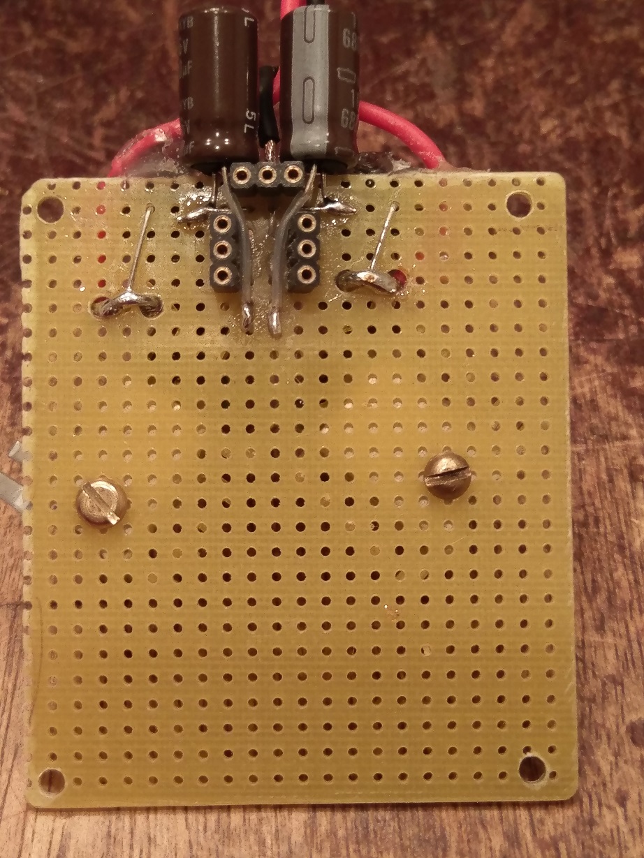

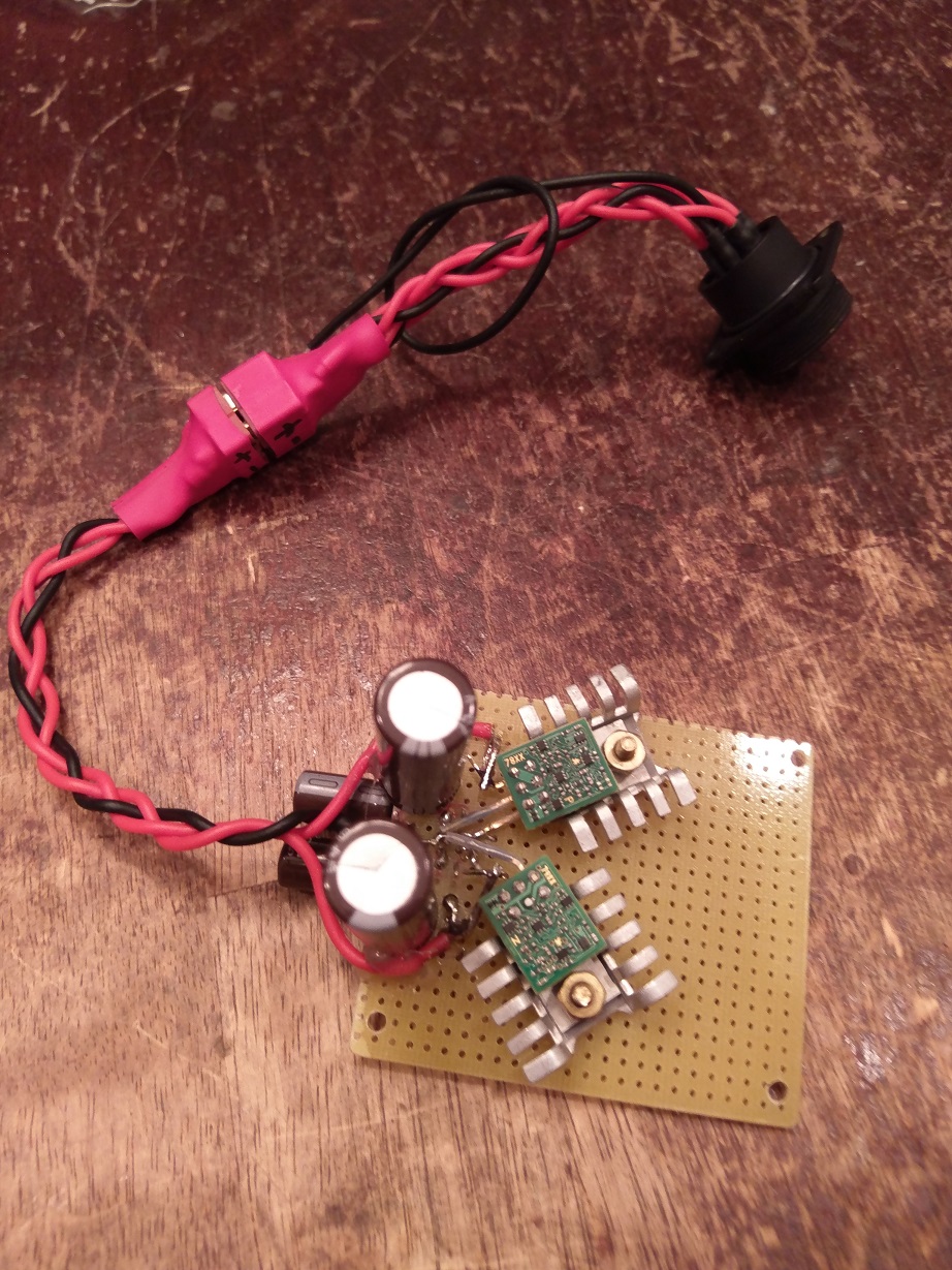

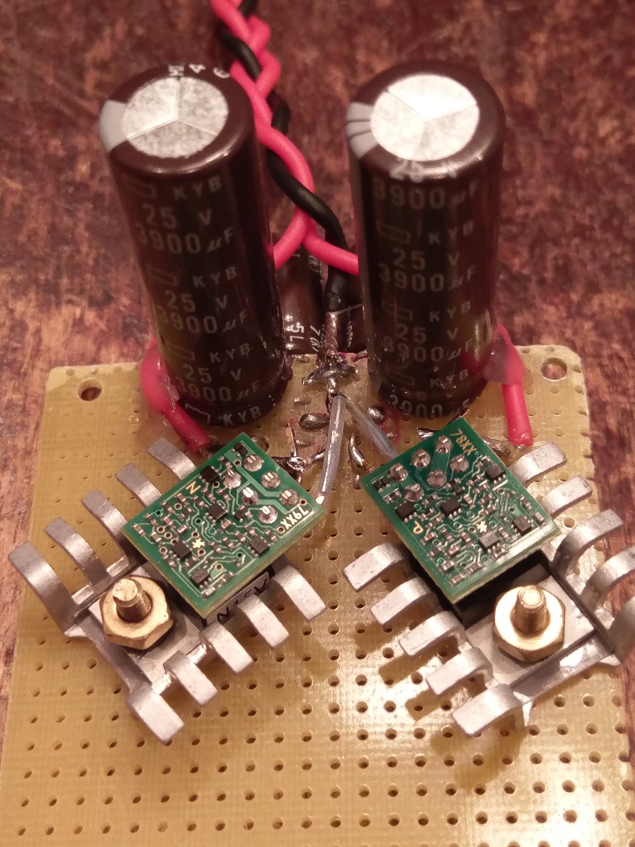

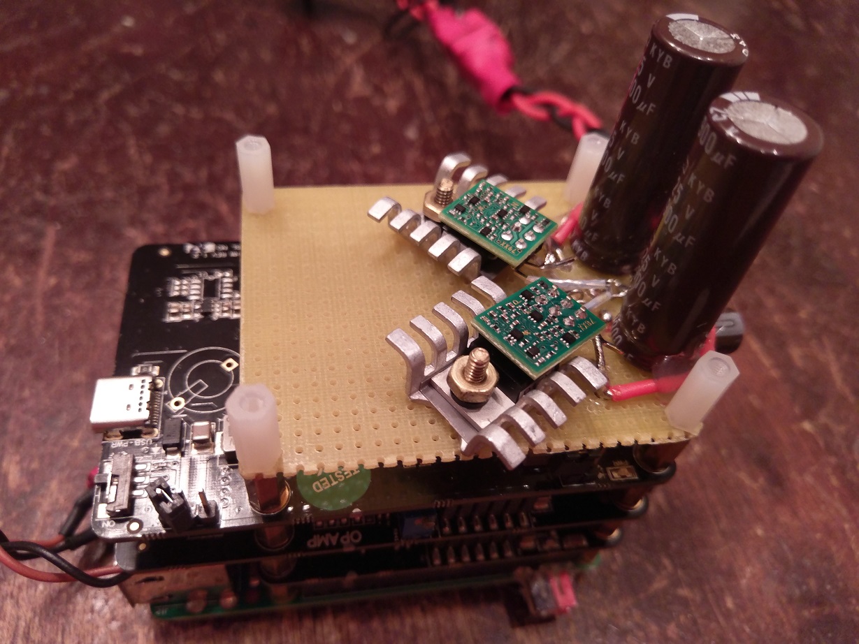

To keep the conversation going, here's some details of the Katana end of my +-15V supply that anyone with moderate DIY experience can to use to duplicate (or better!). ALSO, be kind, this was a 1-evening Q&D build... it is not pretty nor was it intended to be!
1. To compliment the Sparkos Opamps used in the output stage, I used +-15V Sparkos regulators (that have served me well in other builds/mods).
2. To keep the paths short, I cut a piece of perf-board to match the RPi DAC HAT outline and built the reg point-to-point on top.
3. To minimize the contacts, I fed the outputs directly into the +-15V input on the Opamp board via a pair of 3-position sockets (with only one contact used on each). I used another 3-position socket to engage the ground connection. I used those sockets to match the pins on the Opamps stage board and make it easy to mate correctly.
4. Raw DC was +-23V from the supply I described earlier in this thread. That's higher than needed. With a good stiff supply feeding the Sparkos +-18V should suffice, +-19V gives a bit of margin.
5. I used a pair of 3900uF/25V United ChemiCon KYB series caps as local filter caps on the inputs. A pair of 680uF/16V KYB are on the outputs.
6. I added small-ish heatsinks. Even with the current draw and the overly-high input voltage, they don't feel over-hot. I'll measure at some point.
7. It's all connected to the raw +-23V DC supply via 18G wire. The output of the raw DC terminates in a 7-pin Hirose connector (7-pin so that I can someday go to dual-mono raw DC supplies). There's also a pair of 2-pin high-current Deans Connectors (from the model airplane/model car world) to allow me to try different output regulator setups. Better to have just 1 connector, but those Hirose are expensive (and EOL now, so harder to get).
I've been prodding Allo to consider producing a generic +-15V regulator stage printed circuit board that would mount on top of the Katana stack the same as mine and have pads to support 7815/7915 pinout regulators (Sparkos or others). It would be cool if they could configure it for LM317/LM337 and LT1963/LT3015 regs, but that would likely lead to wiring mistakes and burnt regulators and/or Katanas. Better to do 2-3 different board versions... might be a good community project here for a group buy? I don't have board design chops, but I bet some reading this do.
Alternative higher-end regulators to consider are Belleson and the new Dexa discrete regulators. I have used both of these before in other projects with similar good results. But input and output filter cap requirements may be different... read and follow the datasheets.
AND of course, Salas might be some of the best you can use here, but they won't fit on top of the Katana as these series regulators do.
Other alternatives?
Greg in Mississippi
