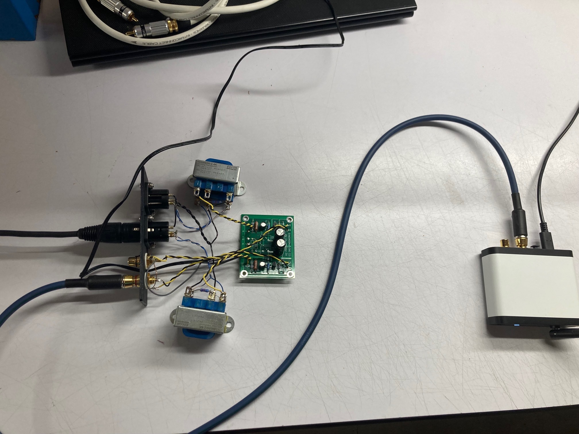

I've had in mind for a while now to make a line transformer based "unbal" to be able to drive some of my Pass amps that can take balanced inputs from single-ended sources. A while back I flailed around trying to make my 1:8 turns ratio Electra-Print PVA-2n's transformers generate balanced output, but they lack center taps, and so I gave up due to weird phase shifting issues I'd see on the output, depending on where the volume control was placed. I'd used a pair of Edcor 1:2 turns ratio 1/2 watt WSM 600R:2400R line matching trafos in various things, but came out convinced they needed a current buffer of some kind to drive them properly. Enter Papa's H2 V2. A simple source follower JFET buffer, cheap & available, maybe it would work to drive the Edcors?

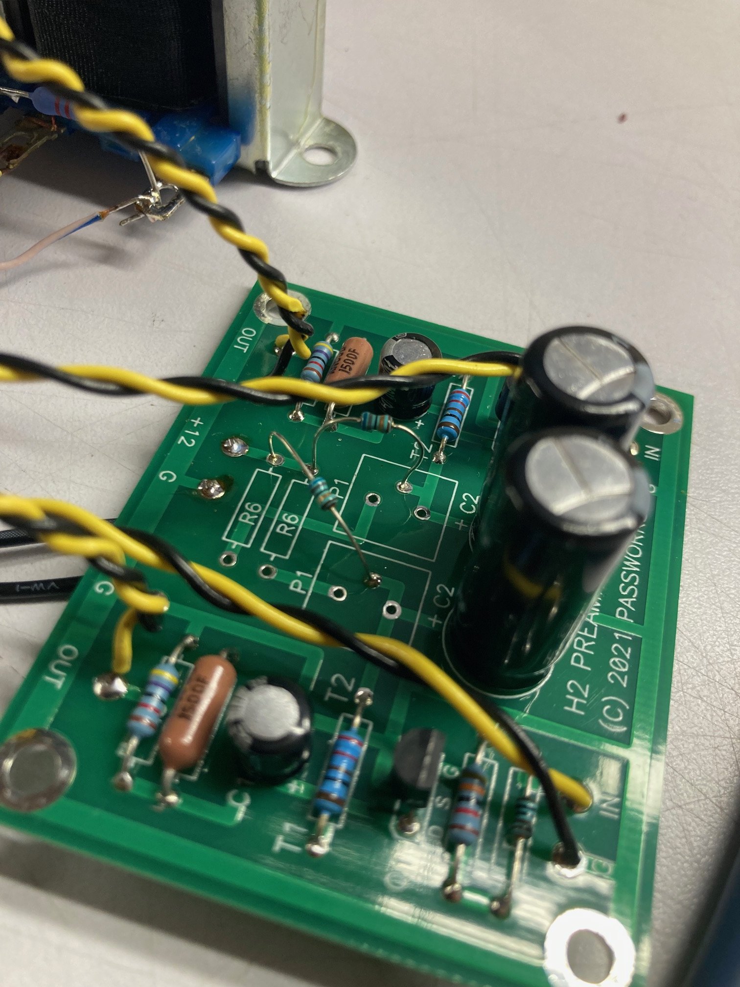

So I bought one and built it up with scavenged & junk box parts, to include a switching wall wart rated at 12V that seems to want to deliver over 13V. I didn't have the right pots or even 33R resistors to properly set the JFET bias, so I hacked an operating point with some 68R resistors I had. At 11.4V at T2 it's about a volt higher than the sweet spot of 10.57V written on the diyaudiostore envelope, so less 2nd order harmonics most likely. Fine.

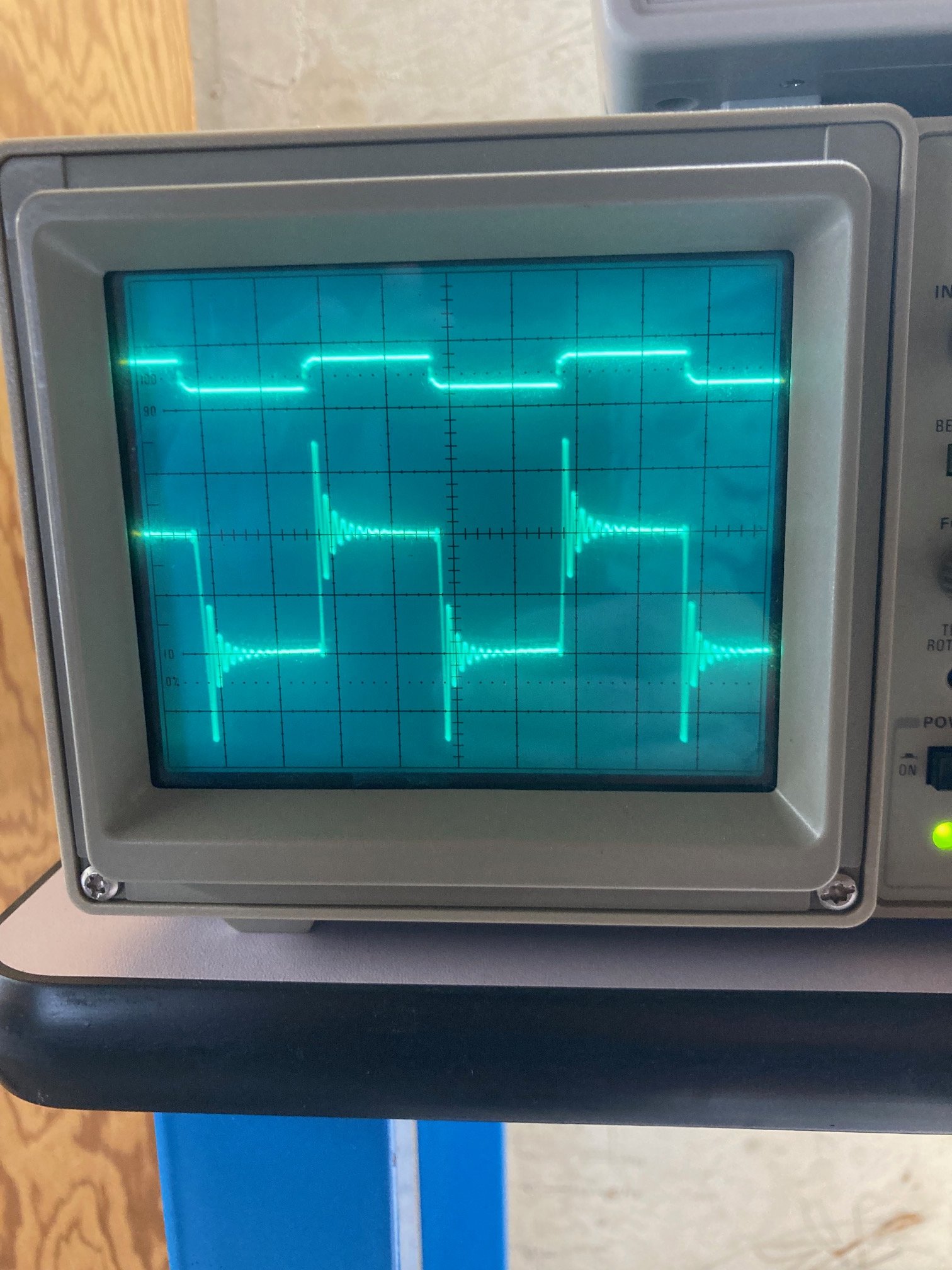

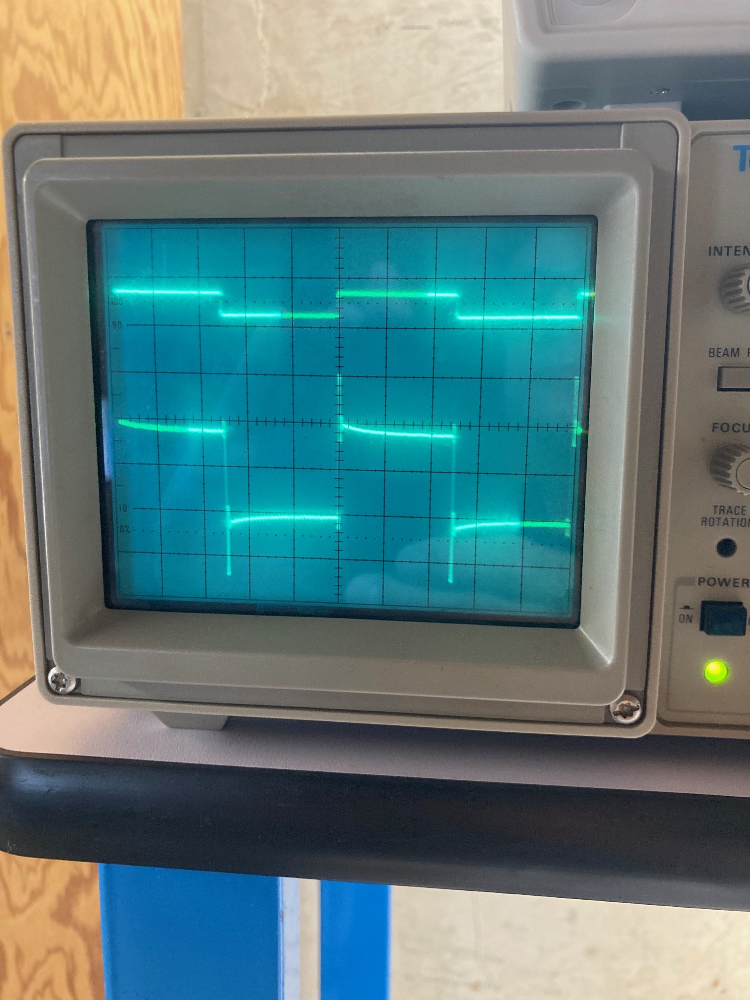

Anyway I wired it & the Edcors up on the bench & hooked it up to a signal source and scope. At about 1.3V p-p and higher on the input, the negative half of a sine wave starts to get rounded, with some interesting ringing in the smushed trough showing up at 1.7V p-p input and above (sorry, no pictures). With a square wave there is tons of ringing at nearly any frequency. A 220pf cap in series with a pot on the Edcors secondary helped a little, by twiddling with it I landed on a value of about 4k7 which snubbed some of the ringing. I wired it in permanently as an RC snubber across the secondaries.

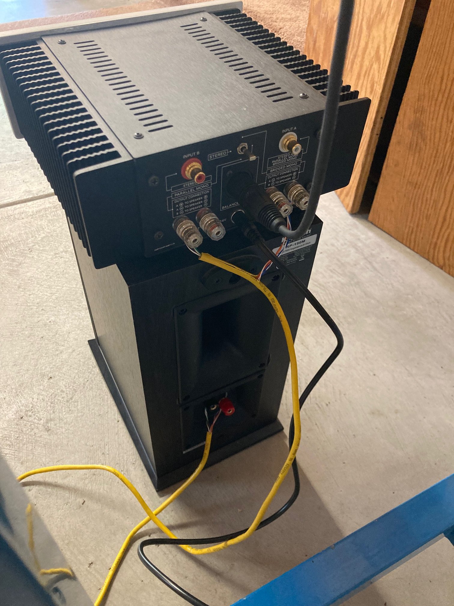

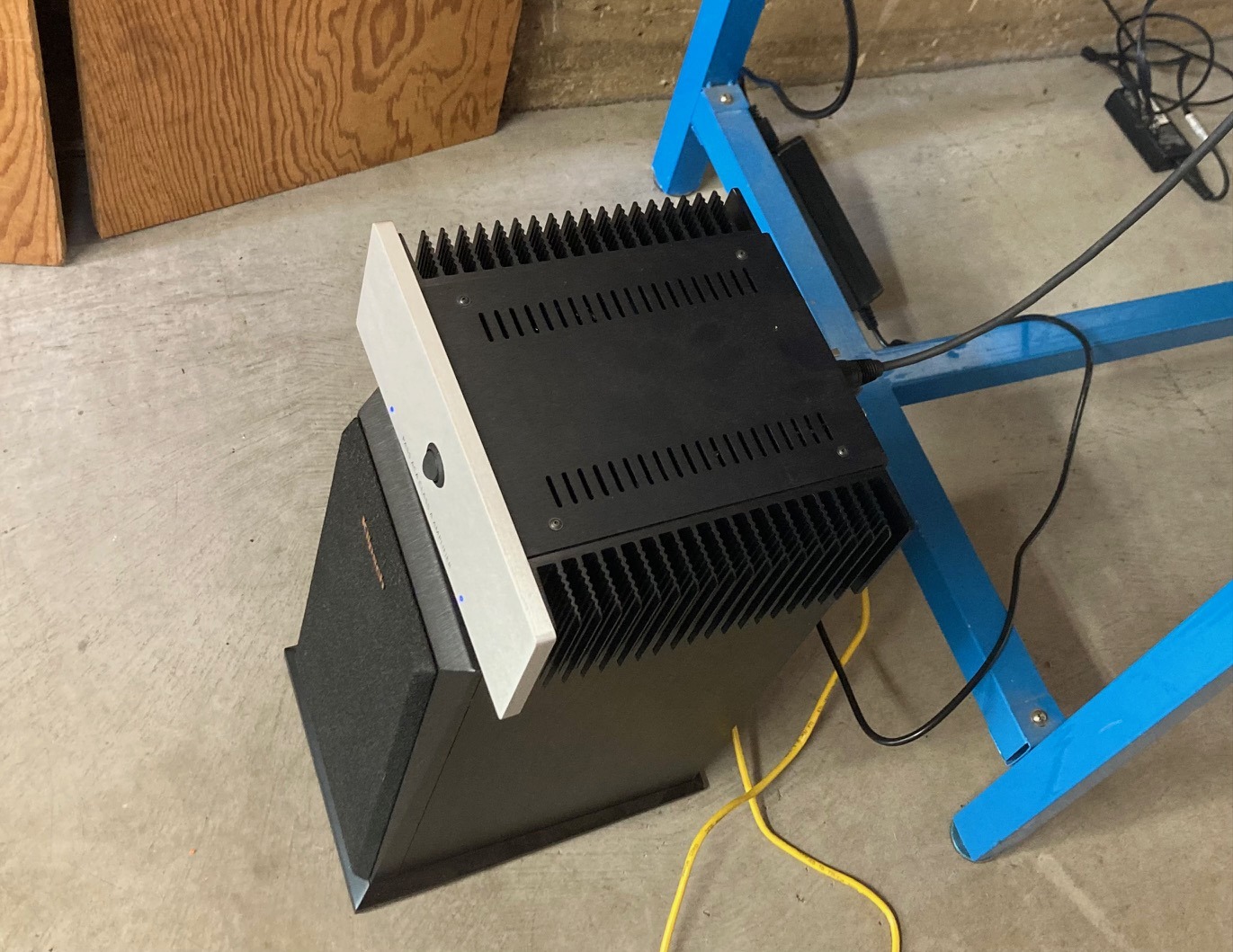

Listening to a single channel in bridged mono on an ACA driving a Klipsch bookshelf and the thing sounds pretty amazing. A lot of the harshness I associate with some of my AirPlay digital sources was reduced, and the bass was stupid good. There's trafo hum but as this unit isn't in a grounded case yet, I'm hopeful that can be mitigated somewhat. I need to put this in a case!

maybe Papa's H2 V2 would work to drive the Edcors 2:1?
I think this needs a buffer or source follower (an extra stage) to get a low output impedance - the output impedance from the drain is simply too high. Driving the transformers in other circuits is mostly done with a 2SK170/2SJ74 buffers or similar.
And then - Afterwards realign your Zobel.
-a combo of a BJT and jFET, is also viable here to get a low impedance. I expect any electrolytic >>10µF will work on the output.

Thanks both for the feedback. I wasn't aware that a common source topology would have a too-high output impedance to drive a transformer. Also I didn't mention, but after a while the square wave output at the transformer secondary would start to curve down after the ringing pulse and not really follow the square wave pattern anymore- not sure what this was but it's as if the core wasn't responding to the input pulses so I suspect DC was leaking in and saturating the core. Perhaps too small a coupling cap.
