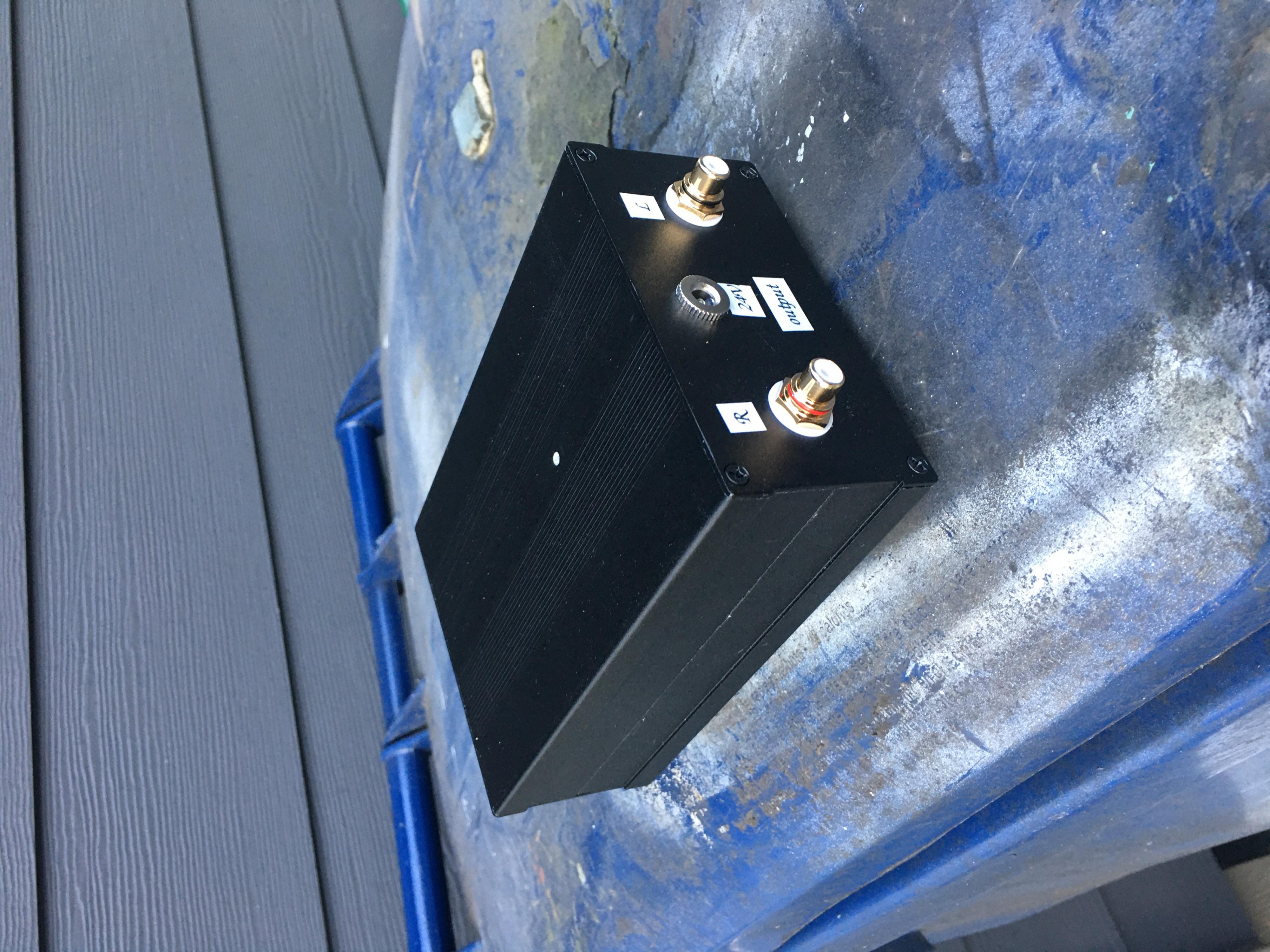

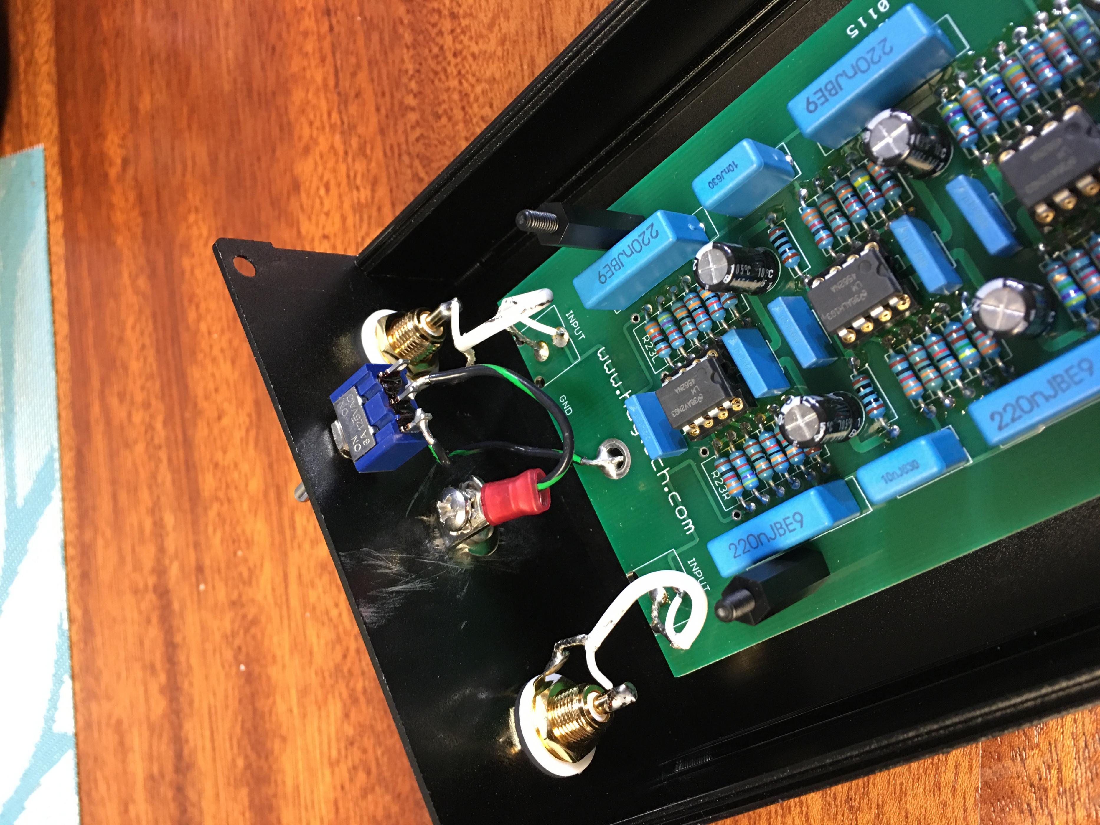

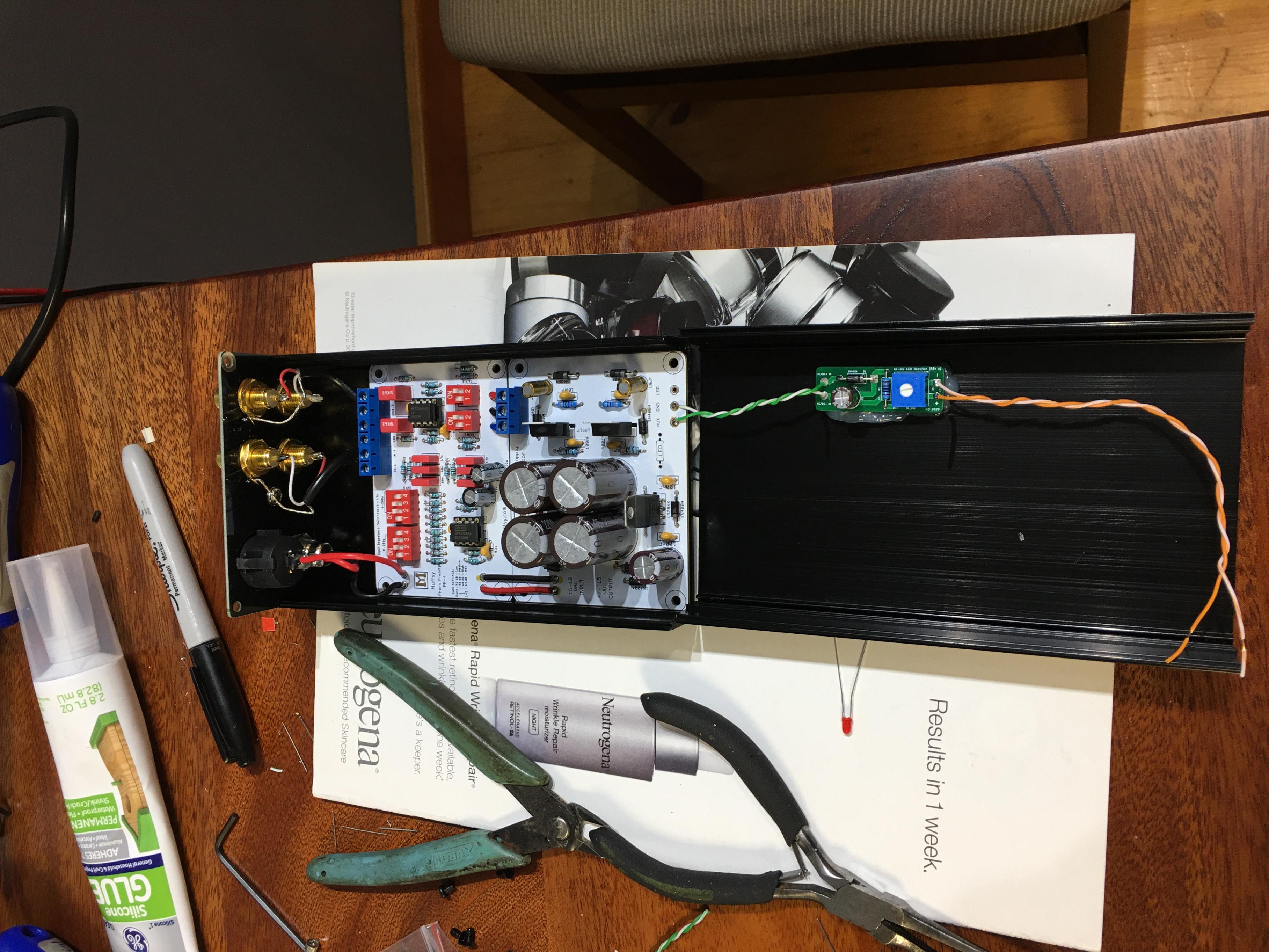

Finished. Put ground stud on case. Attached turntable ground wire. Absolutely perfect. The Hag board is isolated from the case as are all rca’s. Now testing different power supplies!!
PS...the tiny hole in top is to view the led.

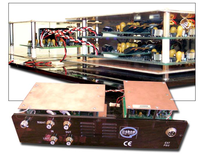

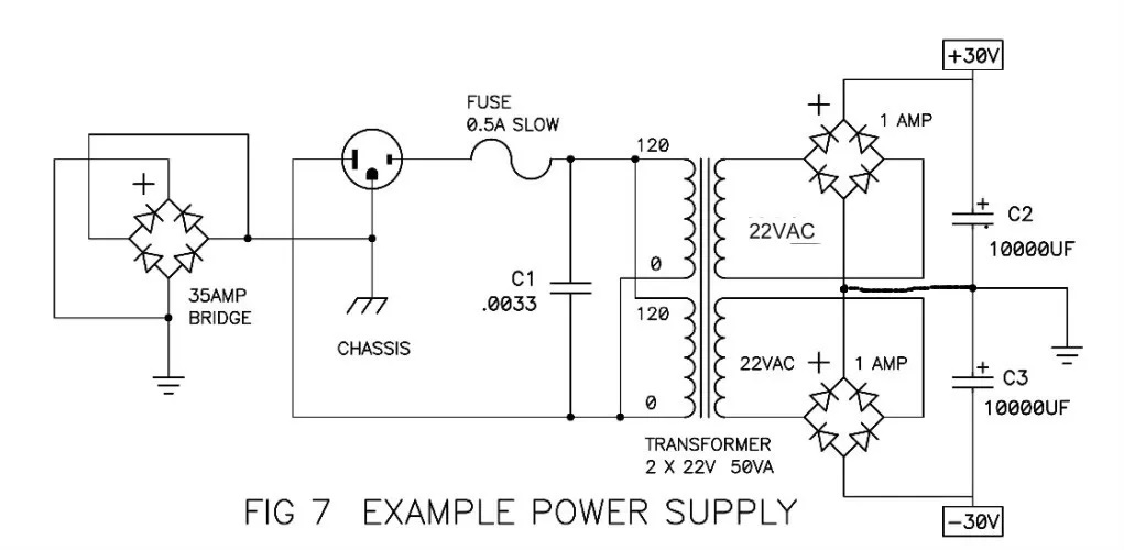

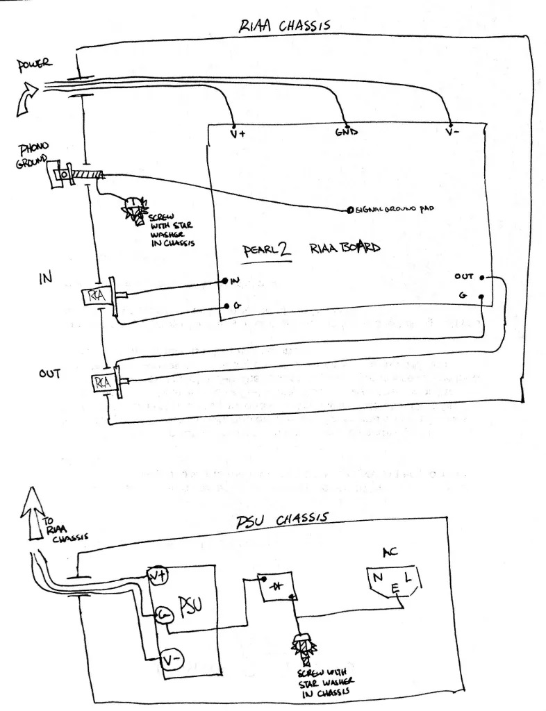

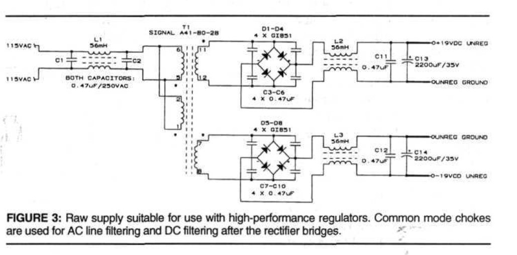

On achieving shielding within an acrylic case: Tom Evans produced reportedly quiet phono stages (The Groove) using copper plate sandwiches inside a plastic case. He employed separate power supplies but it's unclear how his grounding was wired. The Pearl 2 has a bridge that isolates earth and signal/power grounds but seems to connect the signal chassis to the signal ground... which seems counterintuitive to me.

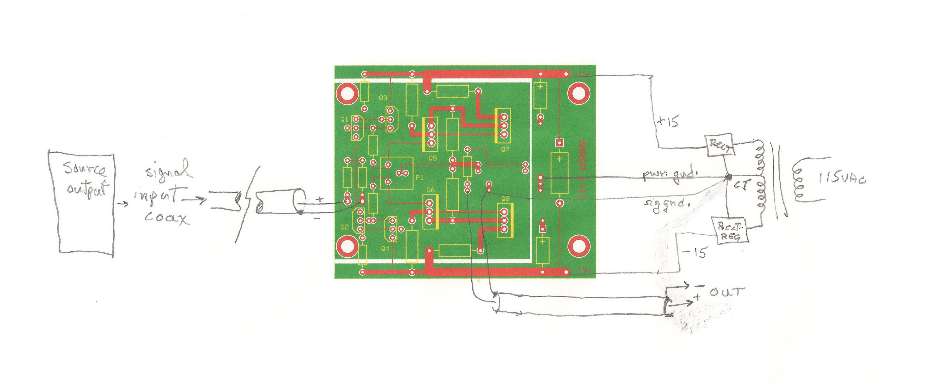

I'm struggling with a slightly different aspect of grounding in phono and line stages. I'm trying to square advice to use separate transformer secondaries, bridges and caps for each pole-channel (4 in all) -- per the Jung-Didden-Galo PSU and regulation -- and keeping signal grounds and power grounds c/w PC ground planes, separate -- as suggested by Richard Marsh.
Marsh recommended connecting the two together at the transformer centre tapped secondary (which J-D-G don't have) So... where to connect these power grounds? I guess both signal and power grounds would be run separately to a star ground at an isolated ground post between the input jacks. I don't know if that actually works. For safety I presume that this could be wired back through the umbilical and connected to a bridge per the Pearl.
Thoughts?
