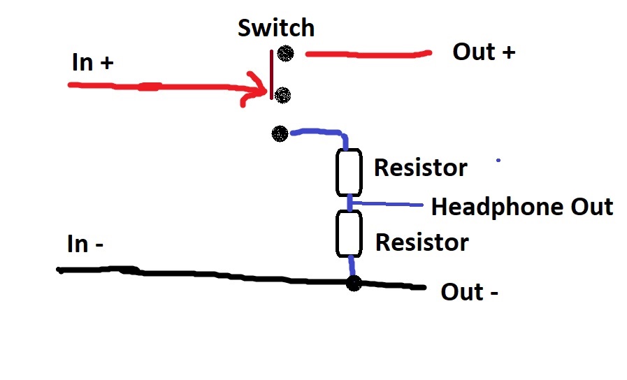

To make one you need a simple box to put it in. These can be a simple or fancy as you choose. Component suppliers have all these parts.
You need the box to be large enough to hold 4 sets of speaker sockets. Speaker in and speaker out for each channel.
You need a headphone socket.
You need a DPDT (double pole double throw) switch to switch the speaker signal.
You need two or four resistors to make the attenuator. These can be soldered direct to the headphone socket.
Electrically the circuit is simple. The negative speaker lead just loops through. The switch in the upper position links the speaker feed through unchanged. In the lower position it connects to the attenuator.
The switch (and this applies to ready built as well) must be able to handle the 100 watts output of the Quad. So a decent switch.
The resistors are chosen to suit your headphones, they cost next to nothing and its easy to work out the values. A simpler version just uses the upper resistor alone and not the two.
The main system volume controls the headphone volume, just as it does with speakers.

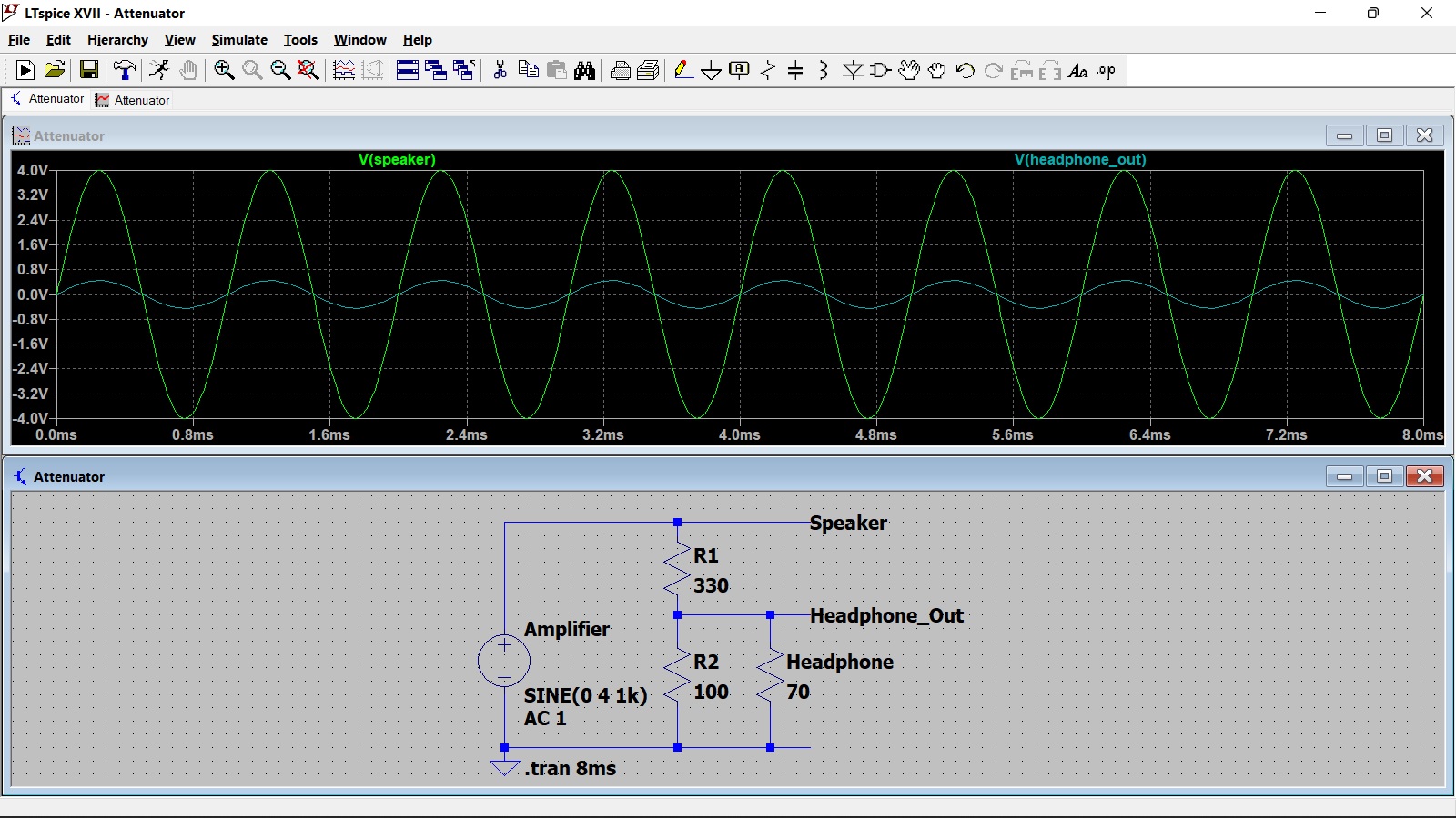

This shows what would typically happen. The amplifier is delivering 1 watt into 8 ohms (that is a typical fairly loud listening level via speakers). A level of 4 volts peak (8 volts peak to peak) corresponds to 1w/8ohm
The headphone voltage and speaker voltage are shown. By altering the resistor value/s you can get whatever level 'feels' right meaning the headphone gives a similar subjective level to the speaker without altering the volume control.
