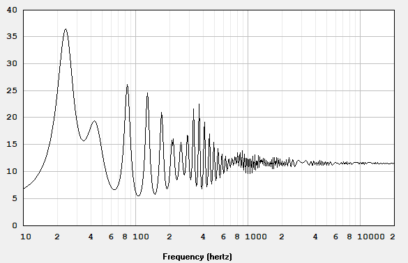

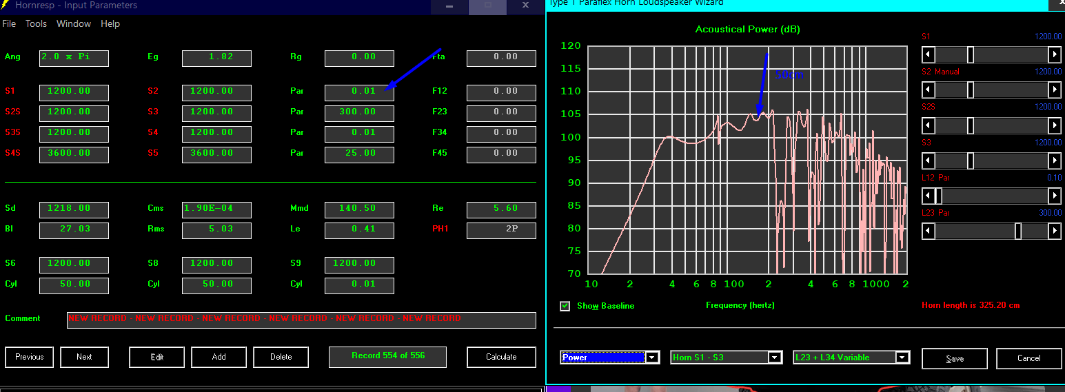

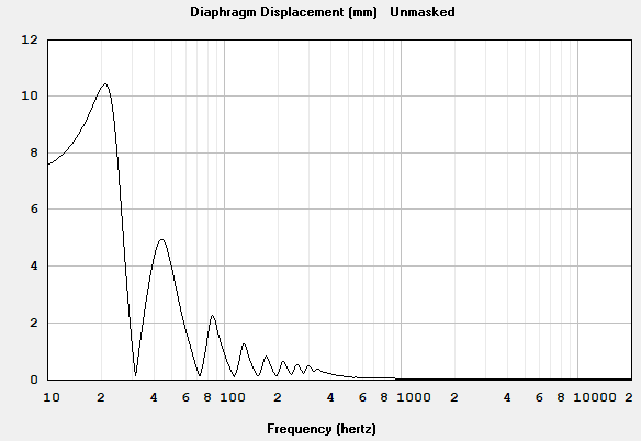

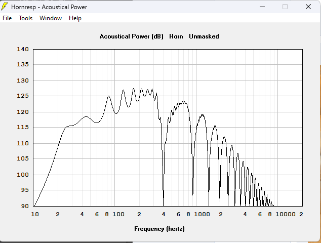

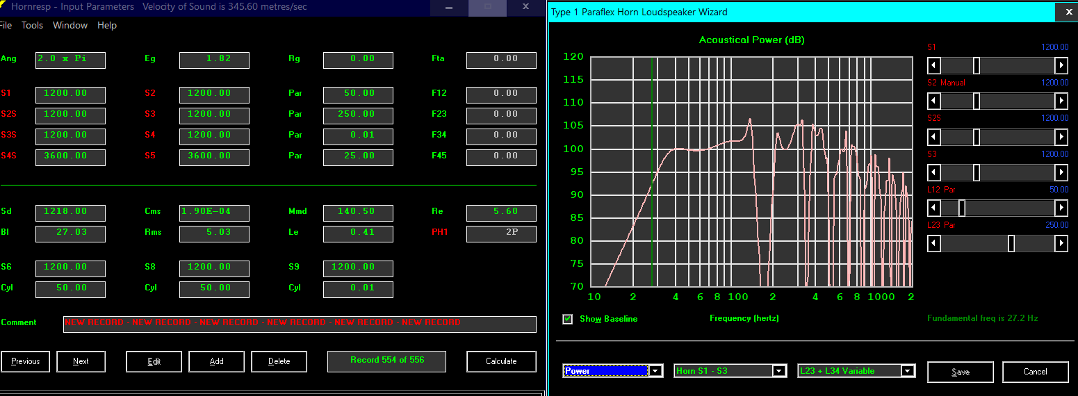

If I remove the 50 cm driver offset position on the low tuned resonator it fills in the out of phase section…. But this is more just a math exercise than a cabinet that could be accurately built at this point?
Reactions: 1 user

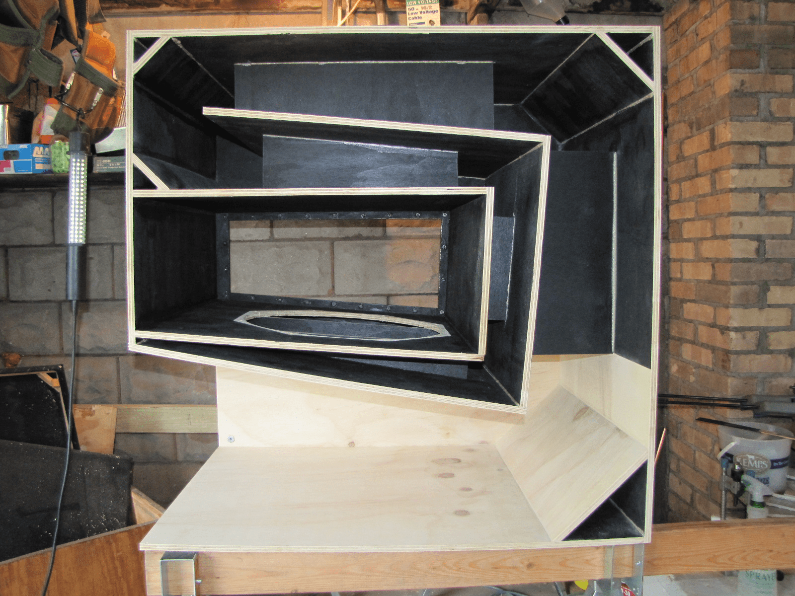

Just for the record, there was a reason why cabinets like this used to be a thing, but are now essentially obsolete. That reason is amplifier power. A horn is efficient for power, but inefficient in total volume.
I can understand it as a science experiement or a passion project. Or maybe you want to achieve THX reference level with a tube amp? But it is sooo big! I mean, you could divide that cabinet into like four 18" subwoofers!
The physics of how a horn works are fascinating, but, well, you've been warned! :ROFLMAO:

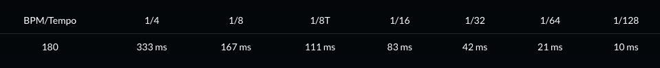

So the spiky frequency response and ringing of the FLH is OK, but a delay equivalent to a 1/128th note at 180BPM is...not for you ;)
Lol I never said that FR was good, but I know for certain, unlike some, a 10ms is 100% intolerable, on my mouse nor my audio monitoring system, and for the skeptics, its always been detectable by myself, without a doubt, and I recently tried a 10ms on subwoofer, to remind myself of what it sounds like, and it was a big nope 👎 I can't expect everyone to be able to match the level of ear training that I've had on timing as a drummer with 20+ years of experience. I hate saying that cause it sounds like bragging but how else do you explain it?

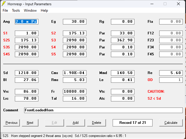

Your HF FLH ( High Frequency Front Loaded Horn) has ~2ms time of flight delay, to align with a LF FLH with a 10ms time of flight would require delaying the HF by ~8ms.
If not time aligned, the frequency response may suffer depending on the constructive and destructive phase relationship between the two. The Haas (precedence) effect also tends to make the leading wavefront seem to sound louder, requiring more LF SPL to be perceived as loud, adding to LF room reverberation "mud". Simple and cheap to correct the problem with DSP.
