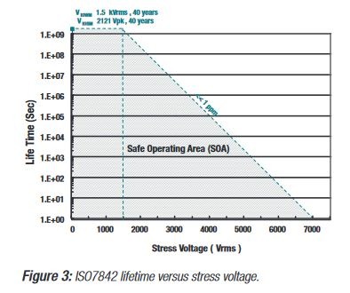

there is one parameter that you can control: time. turn off the device when you are not listening, and accept the turn on delay.
the same is true for silicon design, where the gate oxide suffers voltage induced stress and degradation. for reliable circuits like implantable electronics, only apply a high voltage for the time needed.
That's not going to help enough if the data from Avago Application Note 1074 are to be applied. Assuming that 4 kV DC is equivalent to 3.2 kV AC (as they specify an endurance voltage of 1 kV DC or 800 V AC), their best insulated optocouplers will survive for about half an hour cumulative. I think Jan wants to listen to his direct-drive amplifier for electrostatic loudspeakers for more than half an hour before changing optocouplers.

AX tech editor
Joined 2002
Yes, that ISO7842 seems the champion, but it's a digital isolator, I need an analog one.
Good paper though, thanks Matti.
