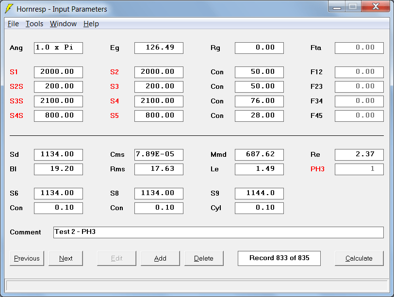

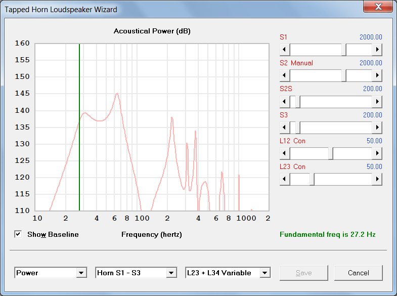

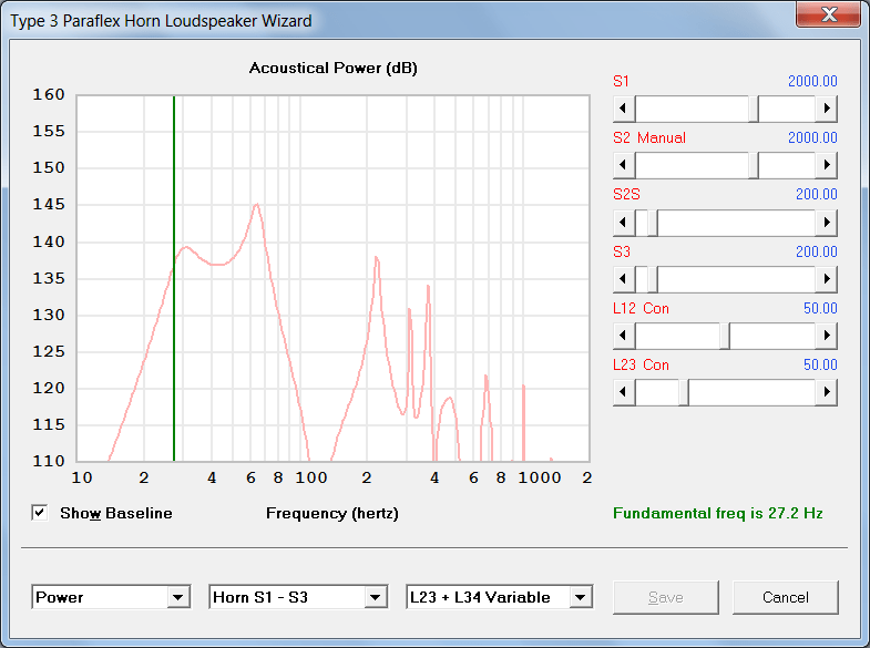

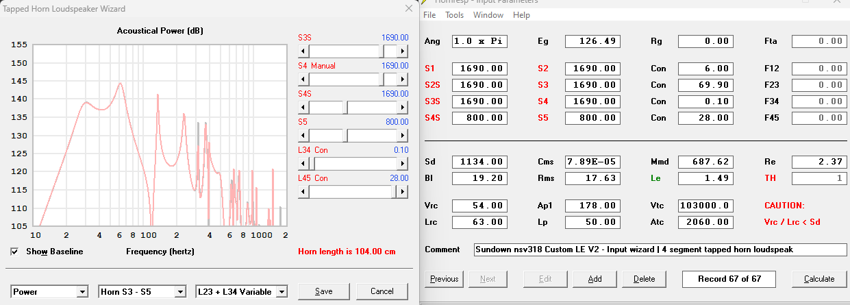

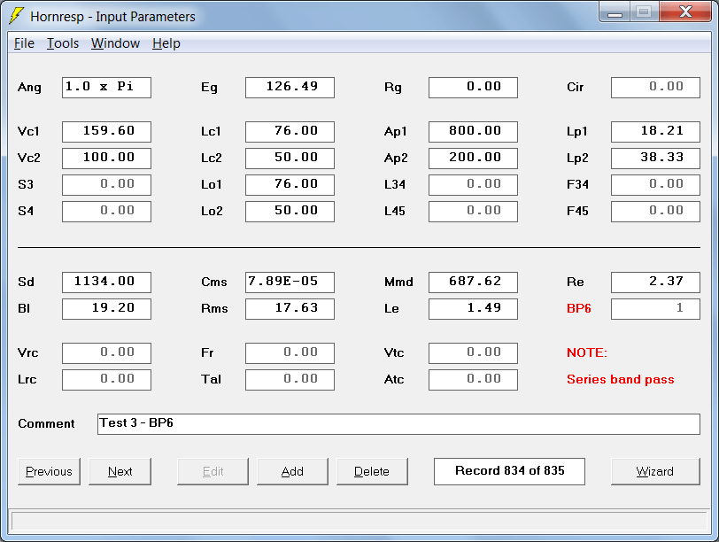

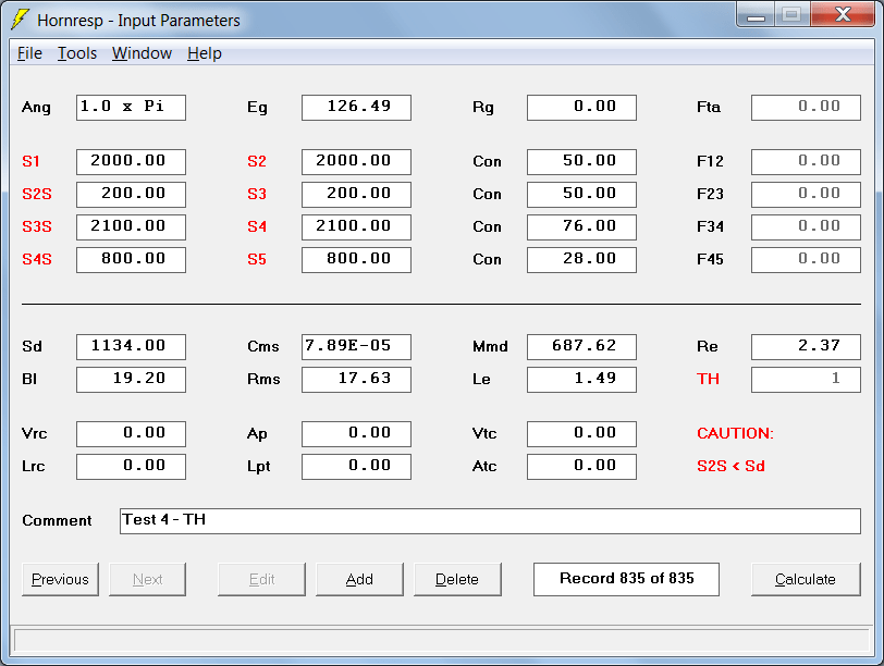

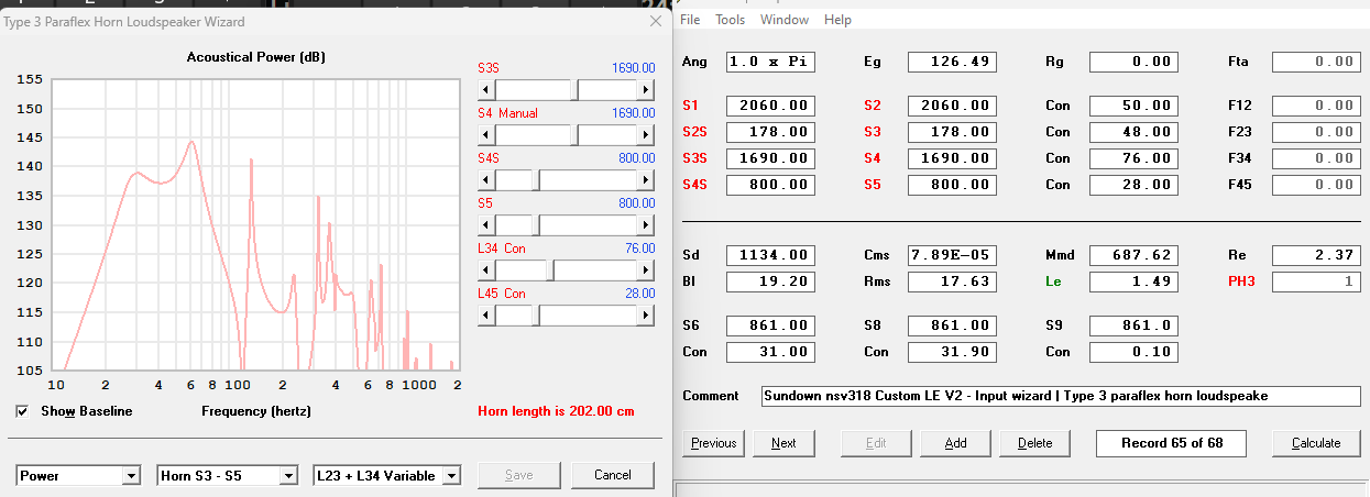

Ok so I made BP6, TH and PH3 as close as I could without decimals.
BP6:

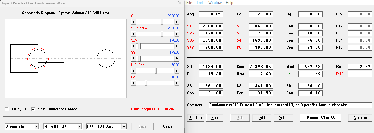

PH3:

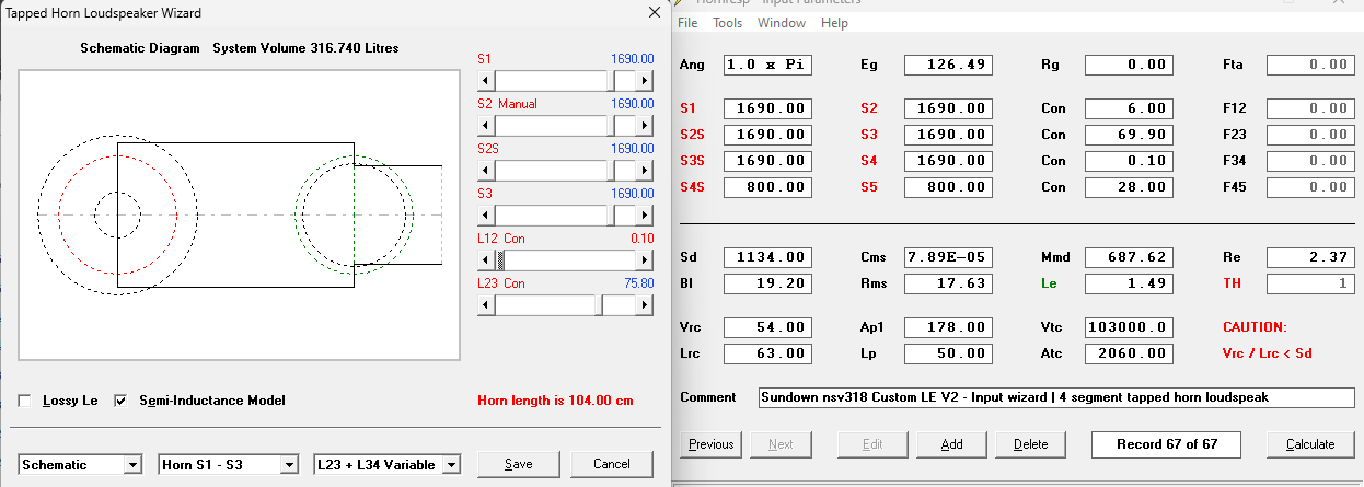

TH with a rear chamber as the stub and throat adapter and port as the rear chamber:
So TH and PH3 look pretty similar and both have a tuning around 26/58, but BP6 still has a lower tune of about 24/51Hz, and all of them are 316l +-0.5l.
So it must be the stub between the cone and front chamber that raises the tuning because it is simulated in both TH and PH3, but not BP6.

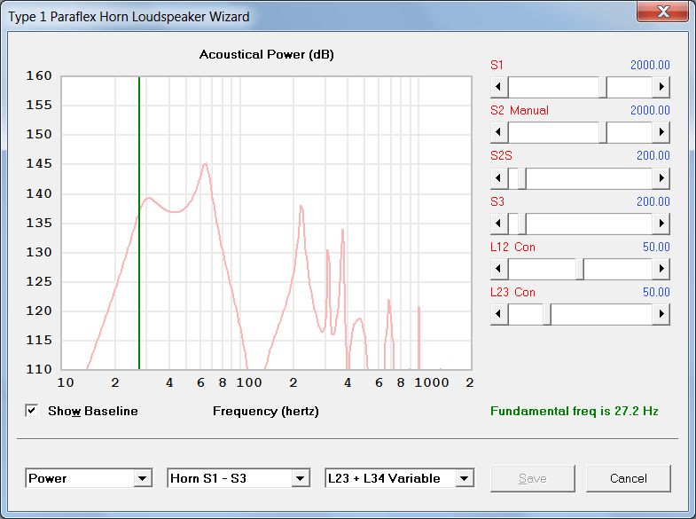

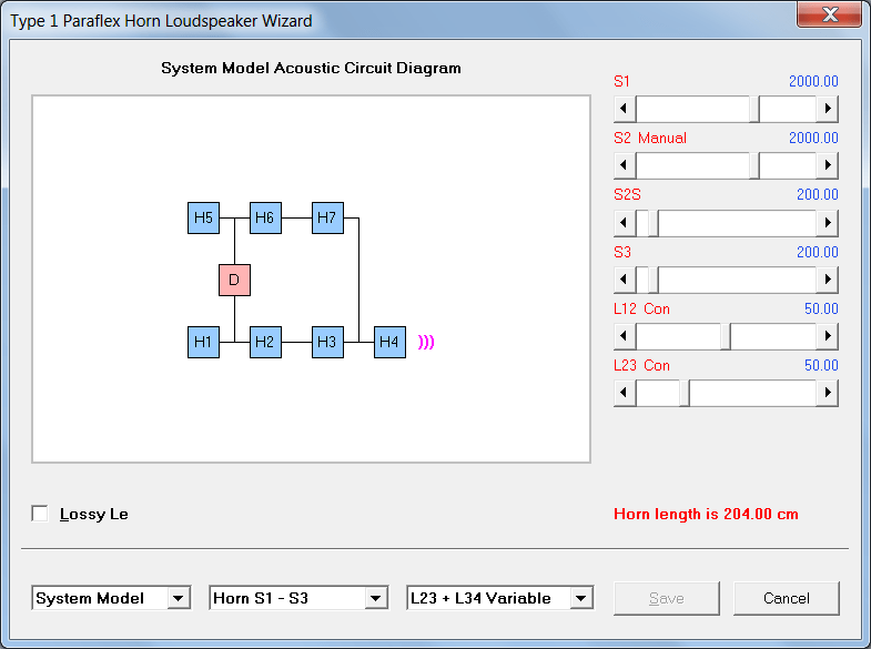

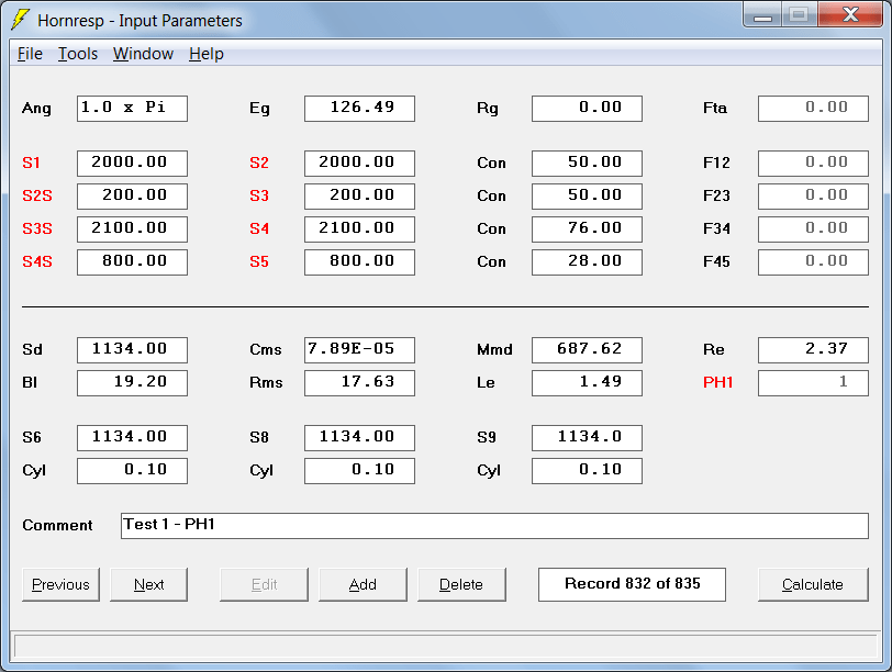

The attached PH1, PH3, BP6S and TH designs all have the same 27.2 Hz fundamental frequency. I will leave it to you to work out why :).
(The port tube lengths in the BP6S design have been shortened to take into account the automatically-added end corrections).

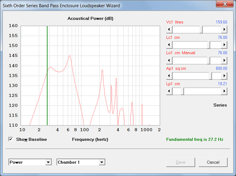

I'm on my phone, do the 4 enclosures have the same total volume with the shorten port tubes?
The horns had the same total volumes and the BP6s had about 10l less, because the ports were shorter to account for end correction, which is not accounted for in the total volume, I presume.
In post #14,617, PAR segments were used for the PH1 model and CON segments were used for the PH3 model.
I see, I've been playing around with a bunch of things and done some misclicks, but it shouldn't matter as the sections are straight.
System volumes are:
PH1 = 292.339 litres
PH3 = 292.339 litres
BP6S = 281.834 litres
TH = 292.000 litres
Using the TH (H1 + H2 + H3 + H4) volume as the baseline reference:
PH1 = TH + H5 + H6 + H7
PH3 = TH + H5 + H6 + H7
BP6S = TH - Ap1 x Lp1EC - Ap2 x Lp2EC
TH = TH
Where:
TH = 292 litres
H5 = Sd (1134 cm^2) x 0.10 cm = 0.113 litres
H6 = Sd (1134 cm^2) x 0.10 cm = 0.113 litres
H7 = Sd (1134 cm^2) x 0.10 cm = 0.113 litres
Ap1 = 800 cm^2
Lp1EC (end correction) = 9.79 cm
Ap2 = 200 cm^2
Lp2EC (end correction) = 11.67 cm
Therefore:
PH1 = 292 + 0.113 + 0.113 + 0.113 = 292.339 litres
PH3 = 292 + 0.113 + 0.113 + 0.113 = 292.339 litres
BP6S = 292 - (800 x 9.79) / 1000 - (200 x 11.67) / 1000
BP6S = 292 - 7.832 - 2.334 = 281.834 litres
TH = 292.000 litres
You physically build a PAR enclosure even though the models have ZERO FLARE segments.
Because cylindrical elements are being used in the simulations it doesn't matter what flare types are specified for the segments.
If the built loudspeaker does not have cylindrical segments then the predictions may not be particularly accurate.
Reactions: 1 user

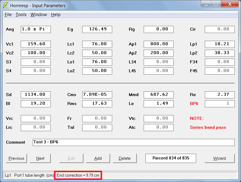

What sort of end corrections are being applied and how would they look like IRL?
Moving the mouse pointer over the BP6S loudspeaker Lp1 or Lp2 input field shows the applicable port tube end correction length in the status bar panel at the bottom of the window. Google 'end corrections' if you want to know more.
Are there no end corrections in the horn models or?
Hornresp assumes that segments are used for horn elements, not for port tube acoustic masses that require end corrections.
End corrections are only applied when port tube elements are used specifically.

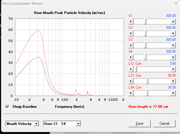

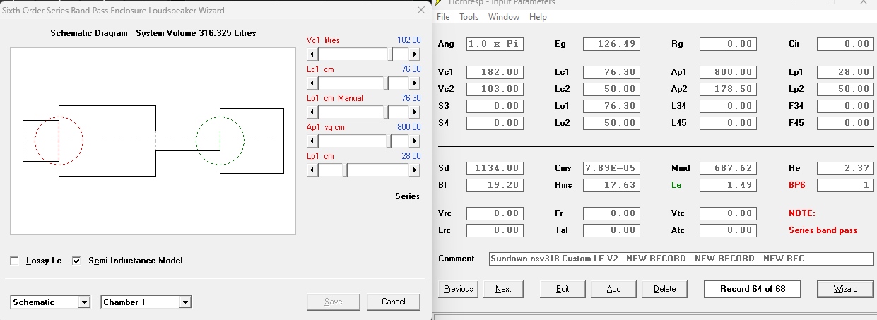

If I took only the rear chamber and port from the BP6 enclosure and model it as a horn, just as a reference.
Then model a better port with a continuous flare to decrease vent velocity, but use the simulation graphs to keep impedance and thus tuning the same.
Could I just expect to use this port in the BP6 enclosure and achieve the same tuning and response as before, just with lower port compression?

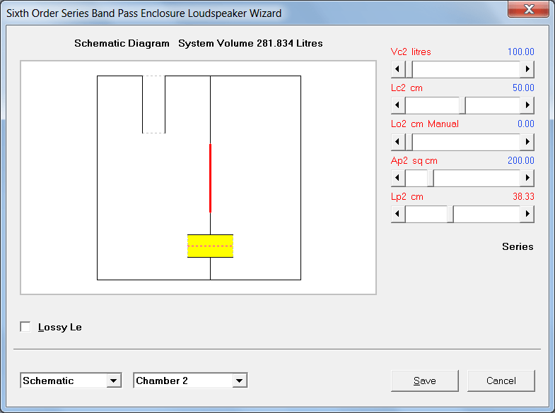

Here is an equivalent sized straight vent:
But doesn't end correction of a port depend on how it is terminated?
E.g. if it's free floating, flush with one or more walls and even if it's flared?
Hornresp models the port tube as a cylinder, open at both ends. Each end can be flanged or unflanged.
Flanged end correction = 8 / (3 * Pi) * Rp
Unflanged end correction = 0.1952 * Pi * Rp
Where Rp = port tube radius

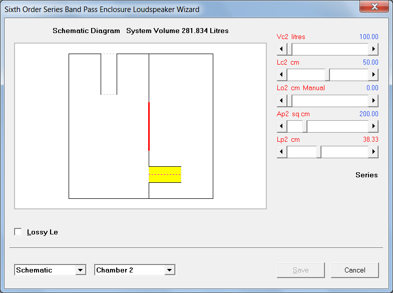

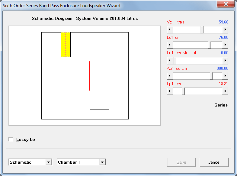

In the BP6S example used previously:
Ap1 = 800 cm^2
Ap2 = 200 cm^2
The Ap1/Lp1 port tube is shown highlighted in yellow in Attachment 1. One end is flanged and the other is unflanged. Because the radiation impedance is known at the flanged end, no correction is required at that point.
The correction at the internal unflanged end is:
0.1952 * Pi * (800 / Pi) ^ 0.5 = 9.79 cm
Total end correction for the Ap1/Lp1 port tube is 9.79 cm

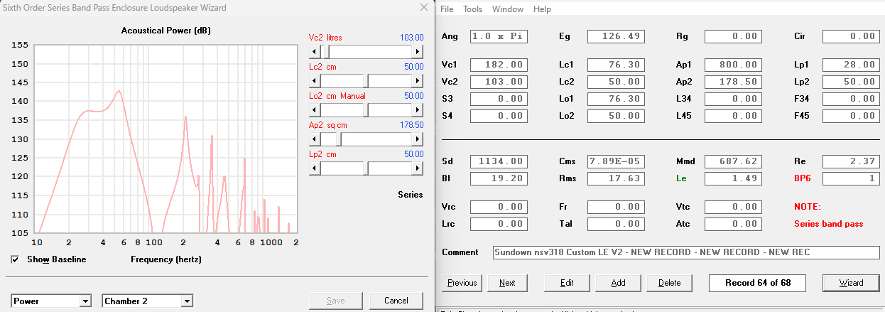

The Ap2/Lp2 port tube is shown highlighted in yellow in Attachment 2. One end is flanged and the other is unflanged.
The correction at the flanged end is:
8 / (3 * Pi) * (200 / Pi) ^ 0.5 = 6.773 cm
The correction at the unflanged end is:
0.1952 * Pi * (200 / Pi) ^ 0.5 = 4.893 cm
Total end correction for the Ap2/Lp2 port tube is 6.773 + 4.893 = 11.67 cm
By double-clicking on the Lp2 slider label in the loudspeaker wizard the internal port tube Ap2/Lp2 can be changed from the default flanged/unflanged to unflanged/unflanged as shown in Attachment 3. The end corrections are adjusted accordingly.
