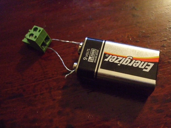

For those interested in evaluating noise of the miniDSP, I suggest to run it temporarily on a 12 volt battery. This will give you a feel for the output noise it will exhibit with a good quality power supply.
Dave.
it sounds great on a 9V battery!

Wow, you guys are good! I spent an entire day swapping each and every power supply in the house until I finally figured out that I can try a battery.
Dave, I swear, I thought about hooking up a battery a minute before I looked at your post. Lol. I rigged up a 9V battery and that solved the bass distortion beautifully. I am happy to say that it sounds great with the battery. I hope the linear power supply delivers a similar performance.
It turns out that I was in fact overdriving the miniDSP input with the ODAC! I got around that by lowering the software volume in Windows.
I knew about overdriving it digitally because I have some experience with DSP. I usually lower the input level by the amount of the largest EQ peak and a few dB padding. This one is easy to verify audibly.

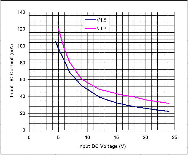

Hi all
Current drawn by 2x4 MiniDSP differs depending on the voltage of the external PSU (see attachment)
There is also an issue with noise generated by the internal buck converter, see here
