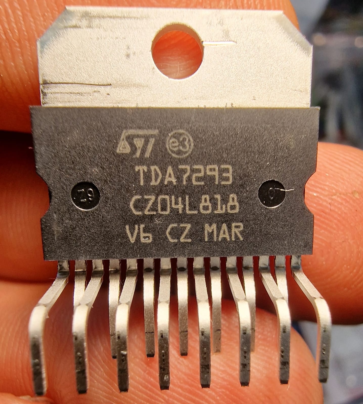

How to spot fake TDA7293

I have discovered a way to check for fakes in circuit provided you have a parallel configuration . Since the TDA 7294 cannot be used in parallel on such boards the second chip would be idle .Put the amp to work without a heatsink and a 100 ohm resistor at the output. The chips are protected from overheating so if you slowly rise the volume both will get equally warm/hot if they truly are genuine and work in parallel . If they are fake one will be idle and might get a bit warm but the working one will be a lot warmer /hot. when both are working in parallel they both generate heat so should be any very nearly the same temperature So burning your fingers on one or both is a reliable indication wether fakes or not since olny the real thing can work in parallel .

Hi thank you ICforensics for the valuable information to test the 7293 a simple method to find out if the component is a counterfeit is to erase the print with acetone remover many TDAs for sale on ebay are marked as original go to Specifications of the object on ebay's page and you will see that for the brand it is stipulated unbranded it is valid for most components as these are oem laserprint

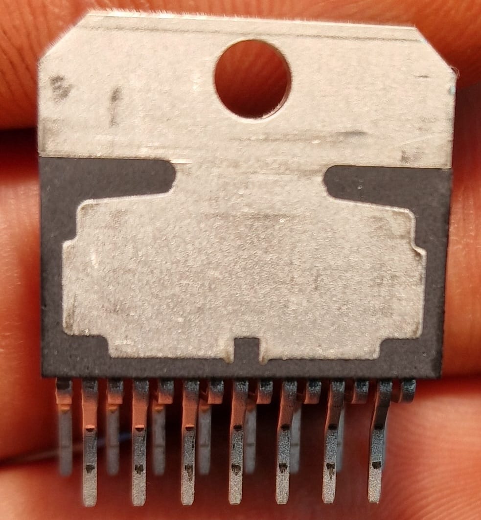

Having to looked at various different chips in the past year trying to spot fakes. I think there's also signature striations on fake chips if you look with a magnifying glass. Maybe from whatever process of sanding off the original markings.

I have Photos of genuine IC TDA7293 i get it from this store long time ago since 2019, perhaps is possible order again. ask the saler. https://vi.aliexpress.com/item/4000404845359.html
Thank you.
