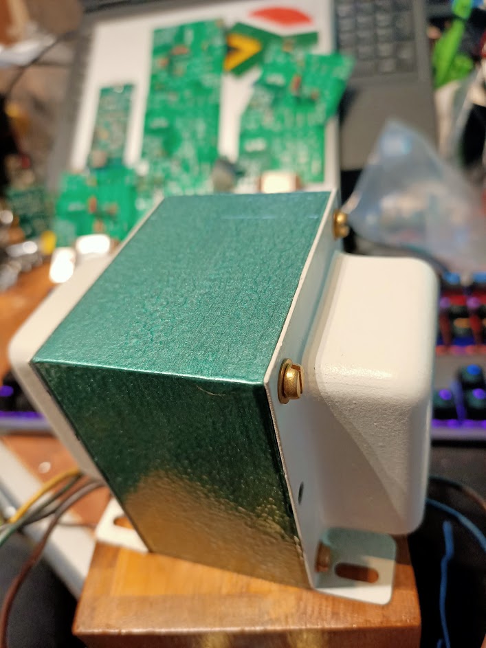

My output transformer is going to be a One Electron UBT-1.

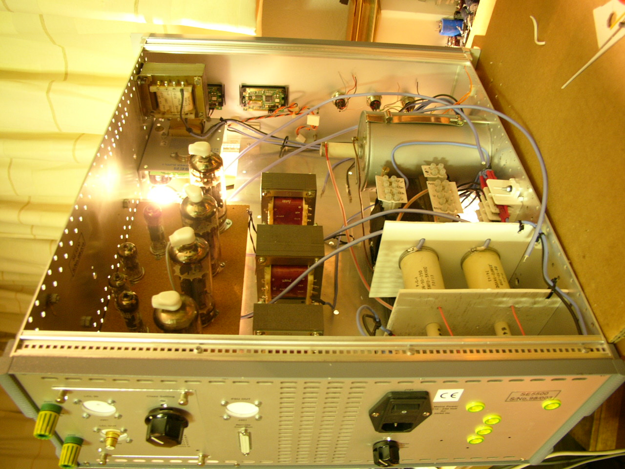

The past years I've been collecting various sweep tubes, planning PP g2 drive using the interstage transformers I used in a PP EL36/38 experimental setup many years ago.
Then I learned about powerdrive.
Then came the crazy drive threads.
And now UNSET and its offspring.
All this reading and pondering didn't fill my room with music, so I'm finishing up a more traditional g1 driven PP PL519, fixed g2, CFB 100W monster to blow away the cobwebs for now :D
The downsides of g2 drive are the high drive requirements and high output impedance, so you need quite some gain, voltage headroom and NFB.
Crazy/dual g1-g2 drive reduces the drive requirements and when properly scaled is exceptionally linear.
I still want to try that out. Driven by some form of power drive.
Bas,

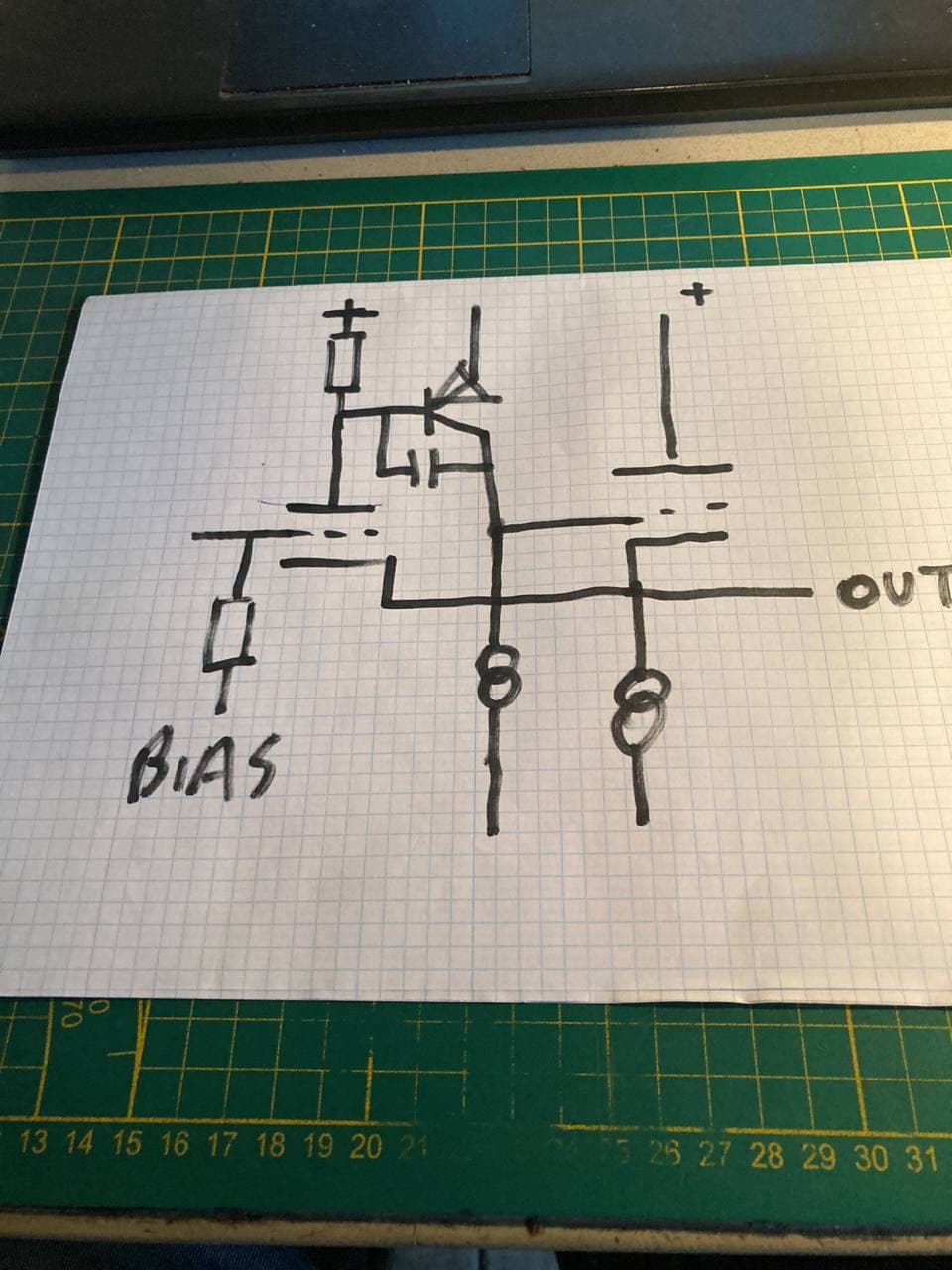

I've built the EAR 859 and the updated version--the 869.
In both I used a source follower based on Gary Pimm's self biased CCS.
With the 859 I built the sbccs into a 9pin socket so that I could easily swap between the pcc88 and the sfsbccs.
Everyone who heard both preferred the source follower version.

It would be helpful if you could provide a schematic of your amp. I’m with Depanatoru - don’t understand what you mean by the words you wrote earlier about 8 watts. Is this the amp output power?

If i would share my design it would be off topic as it is not using the enhaced mode anyway.
But it is common knowledge that pentodes have some advantages over triodes as cathode follower.
Please read Alan Kimmel's article about his Mu Follower.
Quote: While I'm talking about cathode followers, I believe pentode CFs deserve serious consideration. A pentode CF has several advantages over triode CFs, including lower input capacitance, larger voltage swing, lower output impedance. and lower attenuation. I think pentodes are better suited for CF service than for any other use.
