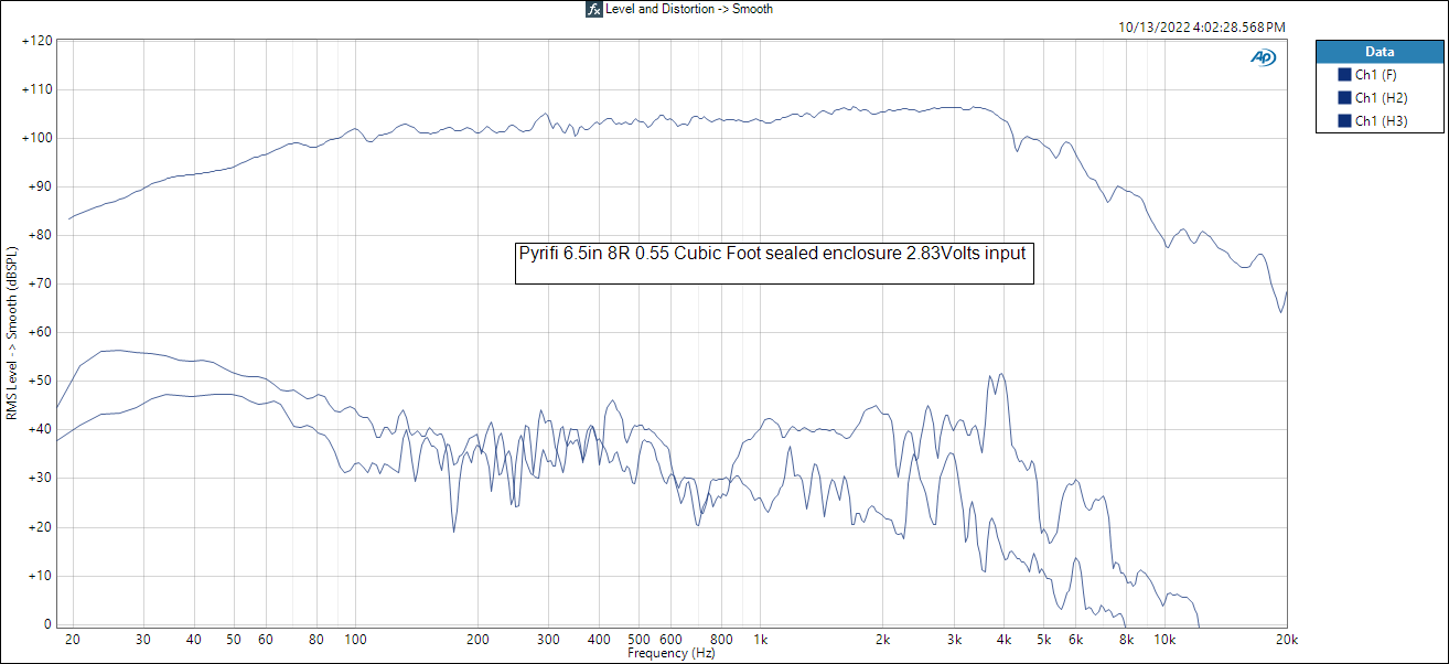

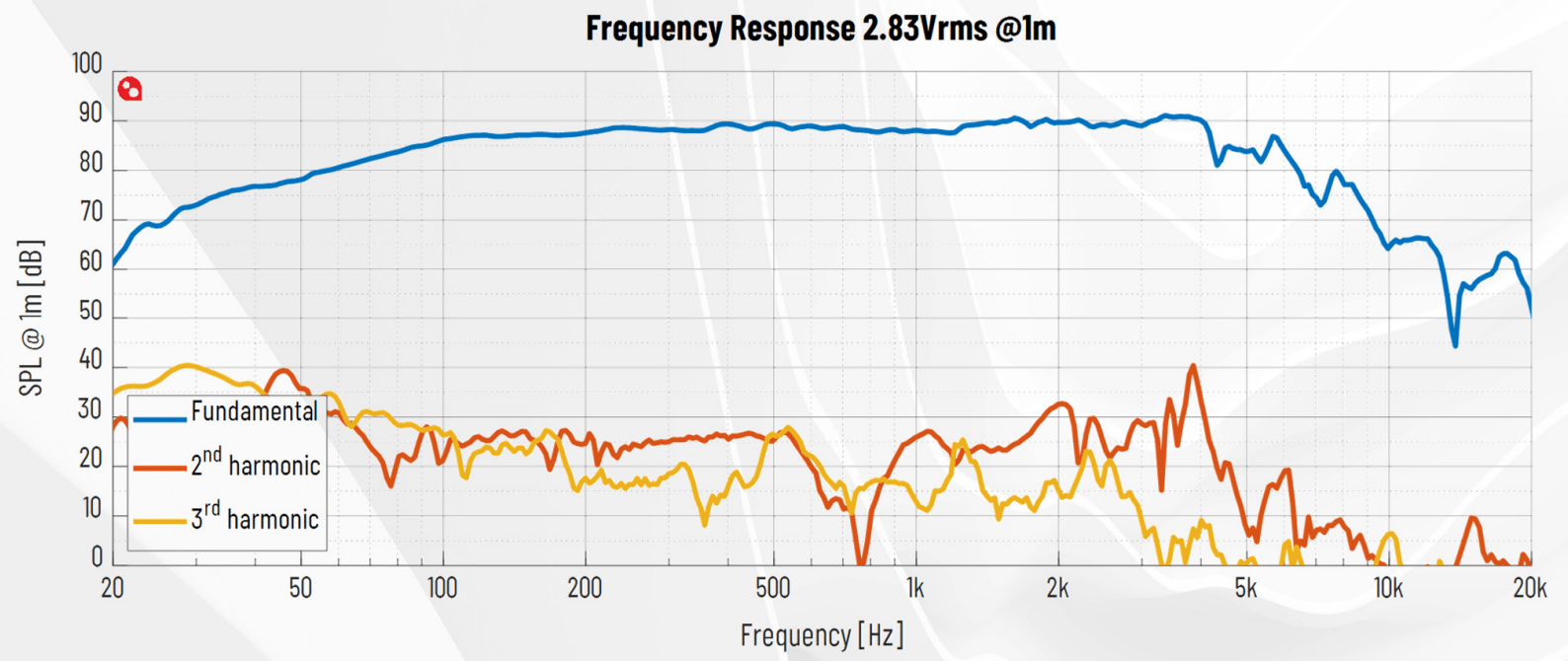

To start I chose to look at a 6.5” midwoofer, the PTT6.5W04 the first driver released from Purifi's catalogue. As a 2021 release, there may be a few in the field, so it can serve as a kind of reference for a recently released and available driver.
Here's the frequency response, along with H2 and H3, from Purifi's datasheet
Comment: Being a 4 ohm driver, the SPL is between 87-91dB through much of the range. As usual, because the driver is not mounted in an enclosure (standard procedure for manufacturers) there's a roll off below 100Hz. In practice, the bass response is determined by the T/S parameters and the enclosure design.

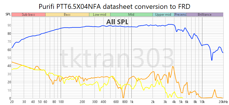

In the first instance, we trace these curves with an auto tracing program, and export into a measurement viewer, so we can work directly with the numbers:
In the original datasheet, the 2nd and 3rd harmonics are obscured by the Text Box in the lower left, and the 3rd harmonic (H3) falls below 0dB at 6KHz. Hence, the harmonic data is accurate only between ~60Hz and ~6KHz.

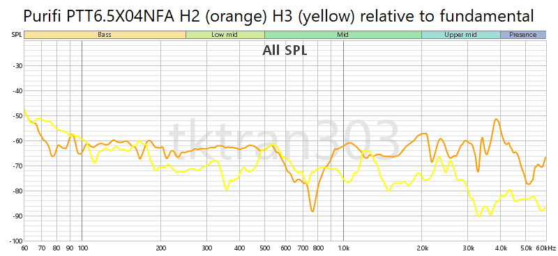

I use software to calculate H2 and H3 in relative terms, compared to the fundamental:
Comment: It appears that H2 ~-60dB between 100Hz and 3 KHz and H3 ~-70dB between 200Hz and 3KHz
There are numerous 3rd parties who have reviewed/taken measurements of this driver. Some have been more successful in measuring H2 and H3 eg. Erin's Audio Corner and HifiCompass

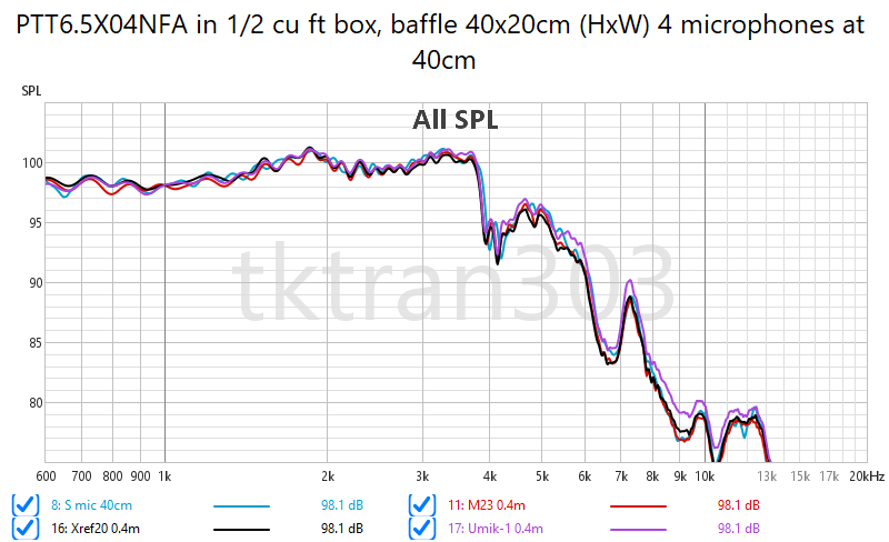

The graph below shows the readings from 4 microphones:
MiniDSP Umik-1 (2013 model)
Sonarworks Xref20 (2015 model)
Earthworks M23 (2024 model)
Sennheiser MD42 (?model year- purchased second hand)
Comment: All microphones show similar responses up to about 5KHz, with larger differences starting to show up above, notably Umik-1.

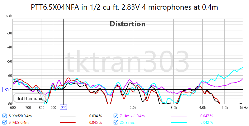

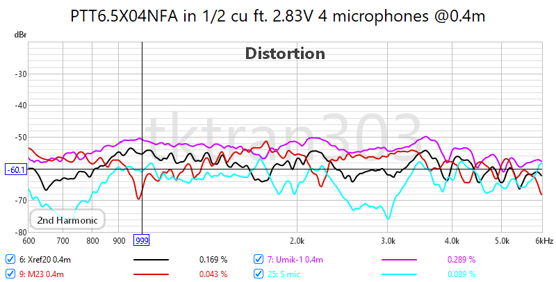

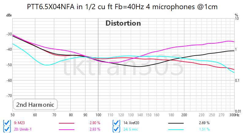

Here is the 2nd harmonic measurement, for each microphone.
Comment: There are differences of up to 10dB between microphones in measurement of the 2nd harmonic when observing 98-101dB

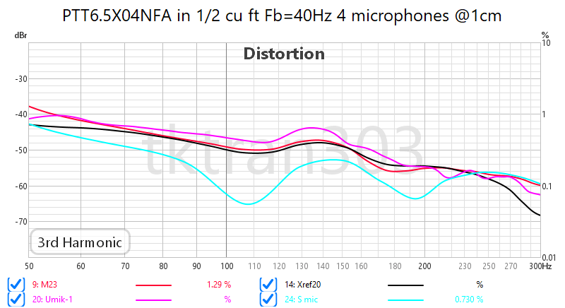

The third harmonic for 4 microphones:
Comment: There are minimal differences between the microphones in measurement of the 3rd harmonic when observing 98-101 dB

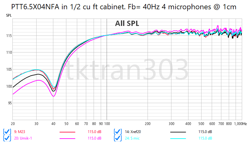

Now we take measurements taken with the microphones in the near field (1cm) to look at low frequency response:
Comment: There is a difference of up to 10dB between the microphones in measurement of the 2nd harmonic when observing 110-116 dB (50Hz to 300Hz)
Comment: There is a difference of up to 6dB in between the microphones in measurement of the 3rd harmonic when observing 110-116dB (between 50Hz and 200Hz)

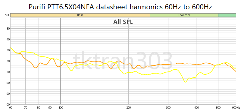

For a comparison to Purifi's datasheet, I split the graph into 2 parts- the near field for a look at the bass to lower mids…

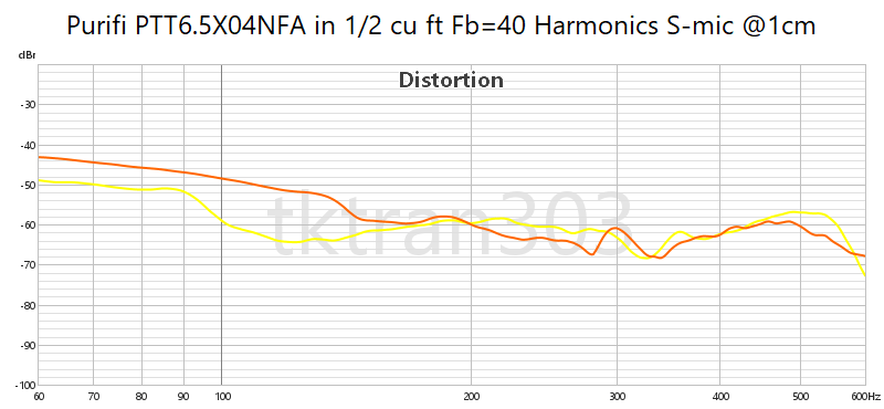

Here is the measured indoors at a mic distance of 1cm with Sennheiser dynamic mic MD42 (“S-mic”)
COMMENT: Measurements indoor with mic distance of 1cm give good correlation above 150Hz. Below 150Hz the effects of the enclosure of 1/2 cu ft, there is a difference compared to the infinite baffle measurement by Purifi. It's unclear whether this difference can be reconciled.

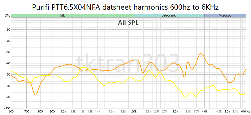

Now the second part of Purifi's datasheet for 600Hz to 6KHz…

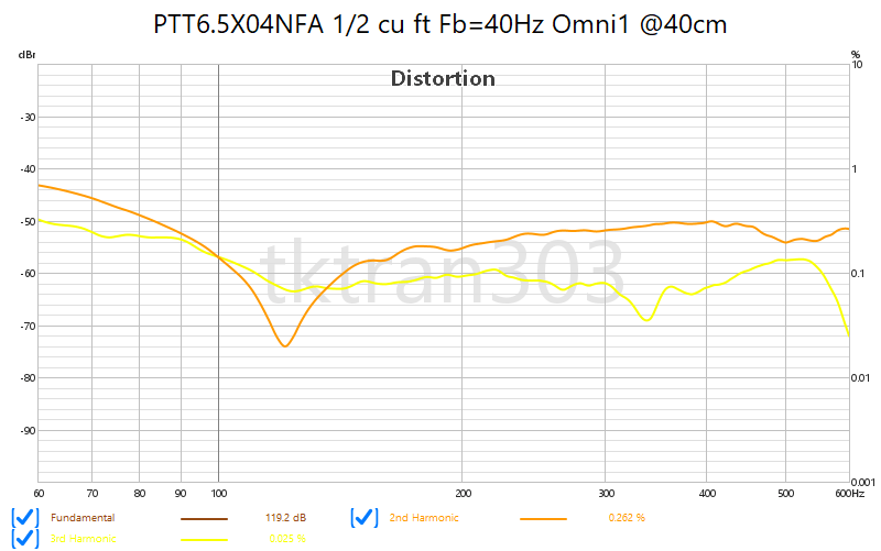

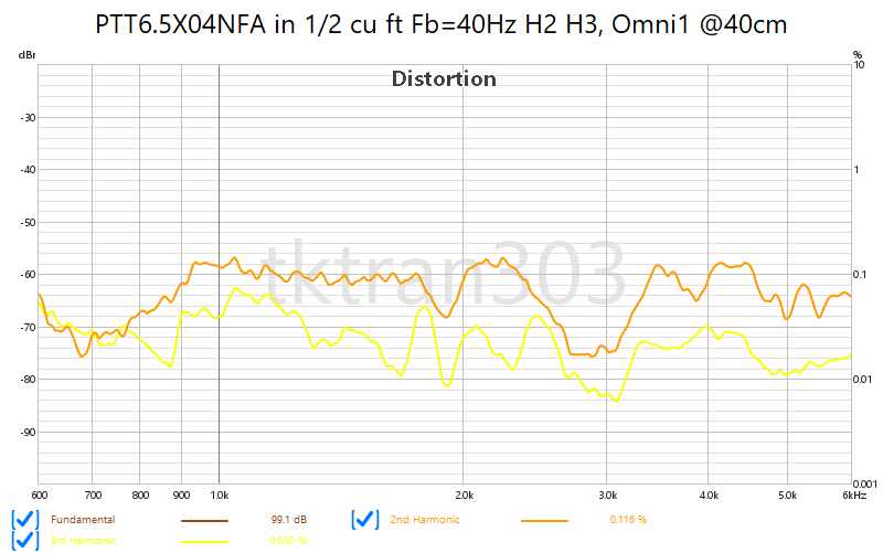

Sennheiser omnidirectional dynamic mic @ 40cm:
Compared to an indoor measurement at 0.4m using the S-mic, above 600Hz there is indeed a similar correlation between the S-mic and Purifi's datasheet.

Let's go back to look at the original graph:
What's the immediate consequence of this? The measurement below 600Hz is affected by room reflections (floor bounce)
(NB. To get a complete frequency response measurement, one option is to merge or blend the two parts together. First we, take near field measurements, a technique just 50 years new, by Don B. Keele . In short, we move the microphone up again the cone and take measurements. This way we know what the woofer or port is doing. This method largely ignores what the room is doing. Later, we can even apply some correction factors later to see what it might look like at 1m, or 3m, or 10m, and then blend the low frequency and high frequency measurements together. Here the late Jeff Bagby explains his near and far field blending process)

About the topic - I'm still wondering about some of the M23 THD, e.g. H2 at 500Hz is higer as with all the other mics. But it's way lower around 300Hz. It does not fit.
Joined 2005
Thanks for continuing with this topic and digging deeper.
You make a good point about the distortion measurement at 500Hz.
Astute readers like yourself are aware of the limitations of taking frequency response (and distortion) measurements in the farfield in a non-anechoic environment.
In fact, the distortion measurements below 800Hz are highly suspect. Furthermore, frequency response below 2KHz, as measured by the (Farina) log sine sweep needs carefully interpretation.
Give me some time to amend the original post to explain why this is the case, in plain language and minimal jargon.

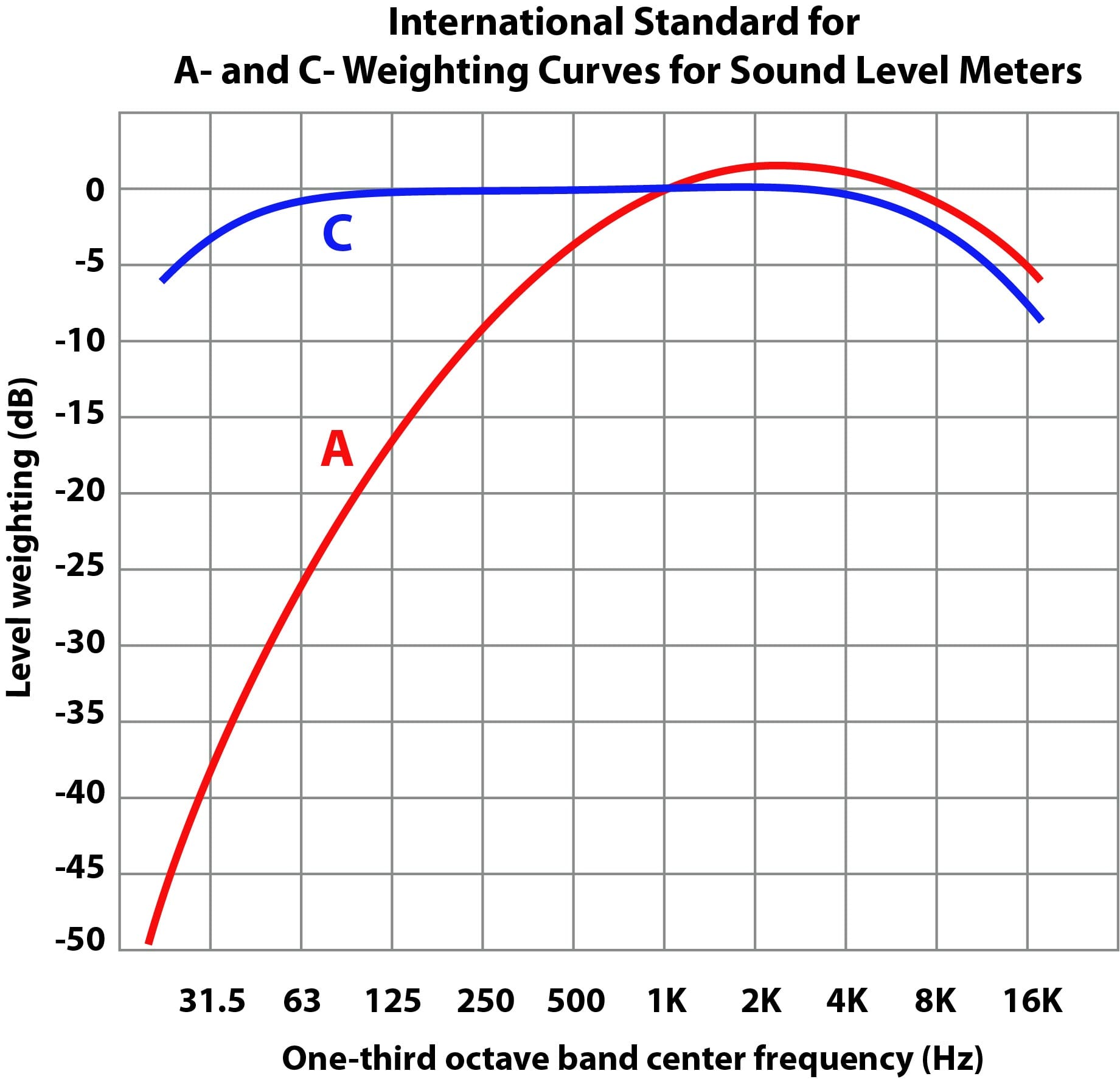

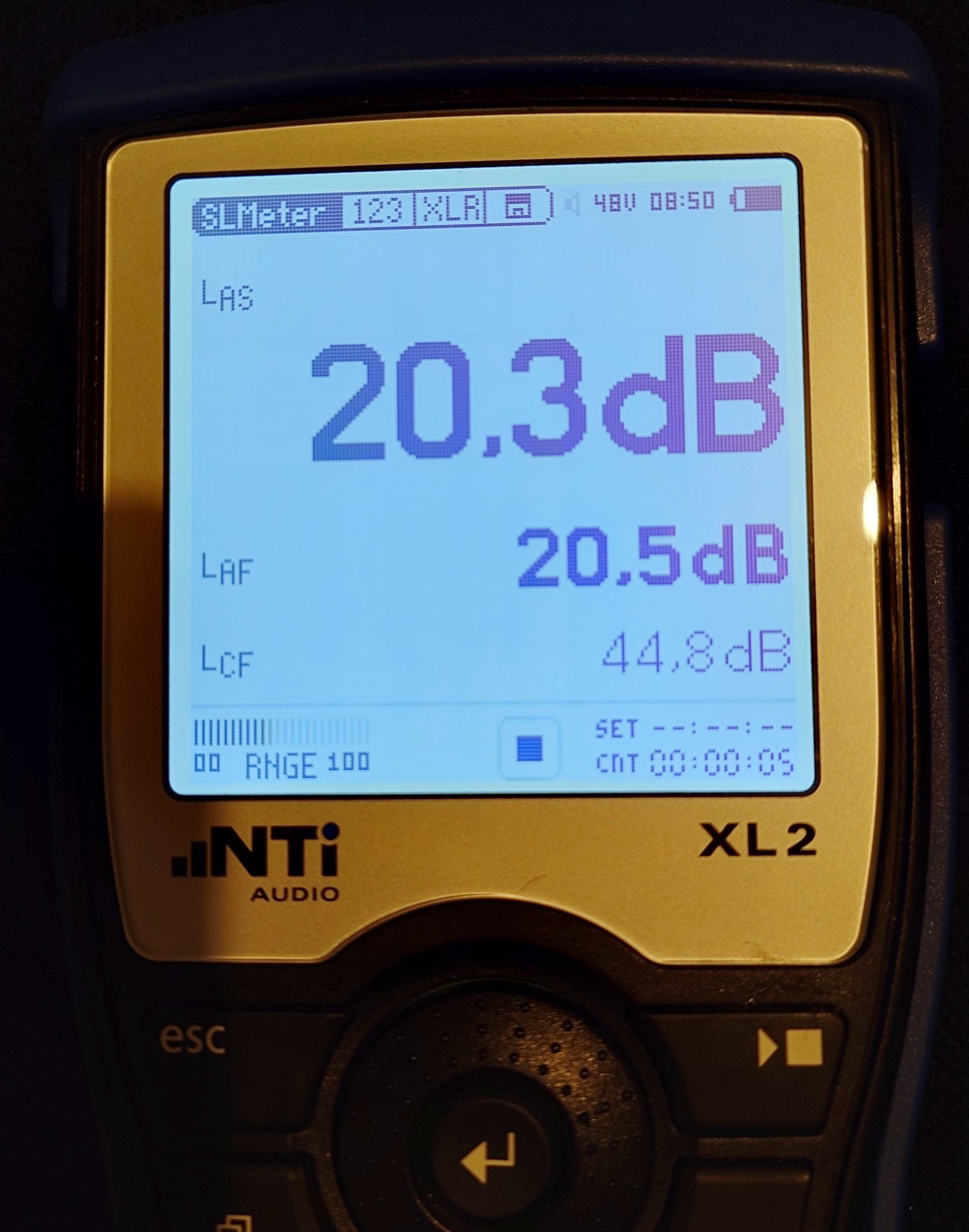

Just quickly about noise. A measurement in my living room during the day but with kids in school. :geek:
I'm living in the countryside but 400m to the motorway. Normal windows, nothing special soundproove. Selfnoise of mic + instrument is 19dBSpl(A) - so there is significant influence!
As you see with the C rating there is low frequency rumble from the road - but you can't hear that! We are not sensitive for lf at low levels. Therefore the A weighting makes sense in this case.
So noise in a quiet room is quickly as low as most measurement microphone noises.
Near field measurements have the advantage of better SNR; ambient noise as well as room reflexions are drowned out by the sound pressure of the DUT. However, as even low far field SPL values are high SPL values in the VNF (very near field), microphone distortion will increasingly become a factor.
In general, realize that not only microphones produce their own distortion and noise, but also your mic preamp, your power amplifier, etc., have their own distortion and noisefloor.
Especially microphone pre-amp noise will become a big issue. You will always want to set the gain of the pre-amp so that it stays just below the clipping threshhold of the pre-amp, as to maximize signal to noise. Afair this can be even done with the Umik, as the Umik has switchable gain settings.
Reactions: 1 user
The A weighting is relevant wrt speaker measurements. 125Hz is more than 15 dB down, so actual SPL isn't 20 but 35dB. Thus you need well over 95dB level to measure -60dB (0,1%) HD at low frequencies. If 0,1% at low frequencies would be relevant that is, I think that anything below 0,5% is quite OK for sub 100Hz. Furthermore the A-curve descends at high frequencies too, so all of those wanting to measure 3d to 7th order HD have to check their background levels too. I think A-weighting is pretty useless for us.
You can't calculate from the 20-20kHz integrated value to the 125Hz narrow band value! The spectrum values are way lower as the 20-20kHz values.
My quick measurement was just referenced to the noise level table and that real numbers can be very different.
Analysing surrounding noise level for S/N calculations is a total different thing - every full band noise level (A, C, Z, Leq, ...) is pretty useless for that.
No I know, did my acoustics and noise courses, be it long ago. Afaik one 3d octave band can be louder than the overall mean level if the rest is hardly contributing. We don’t have to argue about such things, I only wanted to point out the relative uselessness of broadband noise measurements when evaluating conditions for acoustic measurements. Certainly if A weighting is involved.

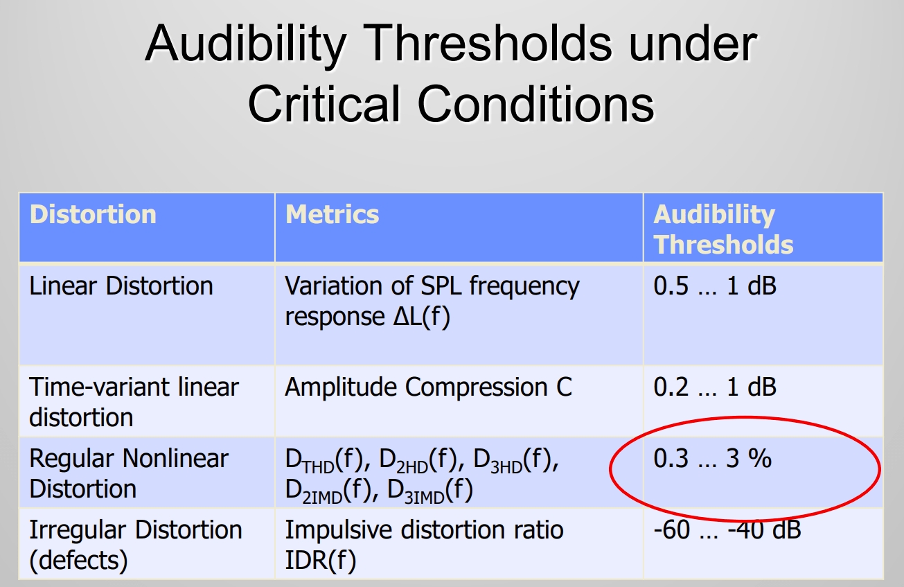

Not that I know of. But do we have to? Loads of research papers show that our ‘hearing chain’ is quite indifferent to nonlinear distortions and measured by the popularity of tube amps, fullrange speakers and studio gear adding harmonic products to the original signal I’d say a lot of us even like them. So is that what we have access to not already more than good enough?

OR does it mean that harmonic distortion, intermodulation distortion (two tone or multi-tone), higher order or non-harmonic distortion measurements, amplitude distortion taken by DIYers to be discarded interpreted with a high degree of caution due to poor less than ideal methodology?
eg. microphone already contributing significant distortion, microphone not sensitive enough, measurement affected by reflections, affected by poor signal to noise ratio
Reference:
https://www.klippel.de/fileadmin/kl...aningful Tolerances for Signal Distortion.pdf

Could this be the Line Audio Omni-1?
Reactions: 1 user
Joined 2005
Omni1 is a leading contender based on my brief survey...
