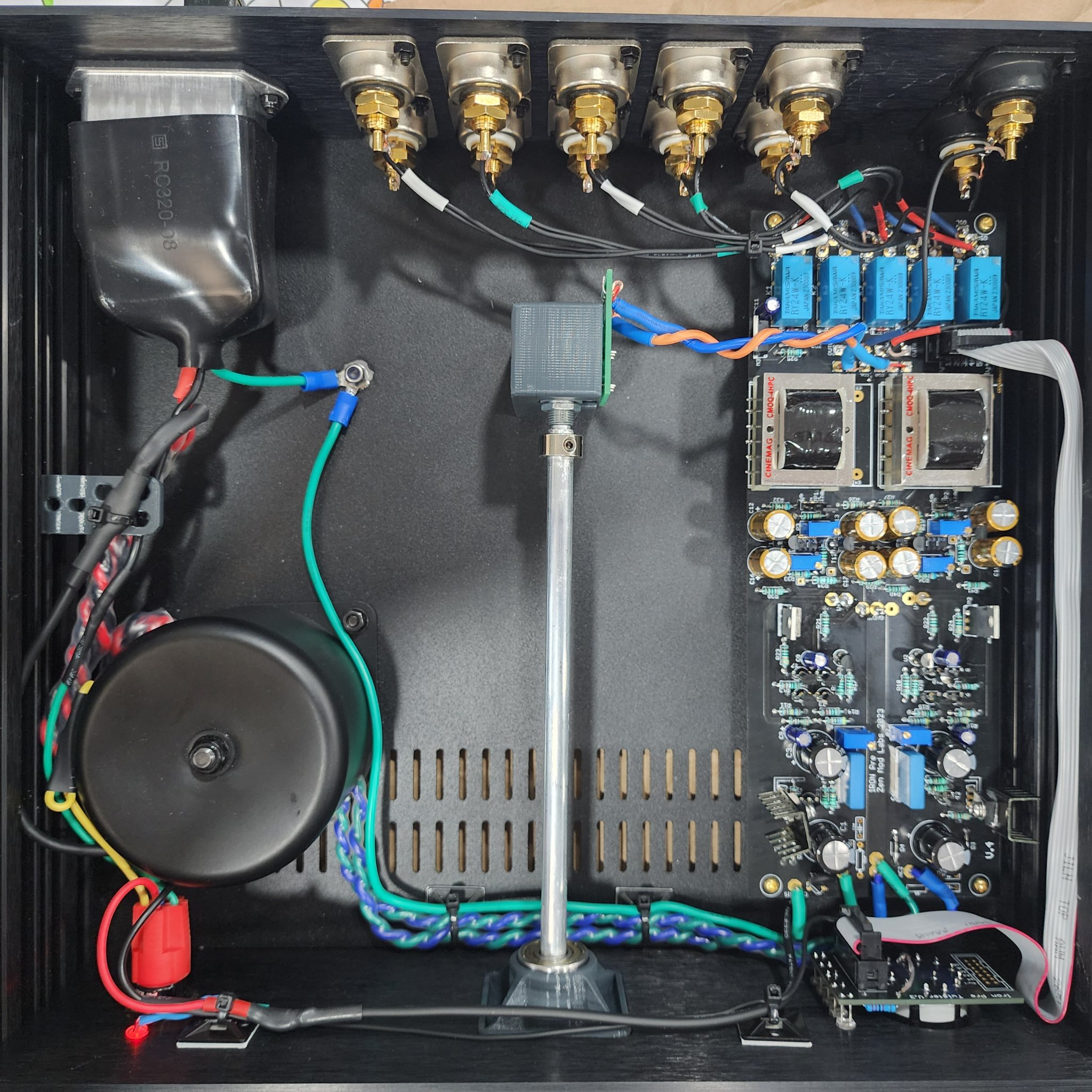

Overhead shot...copy....
Did you shorten your ribbon cable? It looks like the clamps on each end may open somehow, but its lightweight plastic and I sure do not want to break the only one I have. Mine is WAY longer than yours! I guess it doesnt matter, no signal involved, but mine is long enough it isnt very tidy. I will try searching ribbon cable connections and so forth.
Russellc
Joined 2003
I have enough for two. I'm leaving it as is

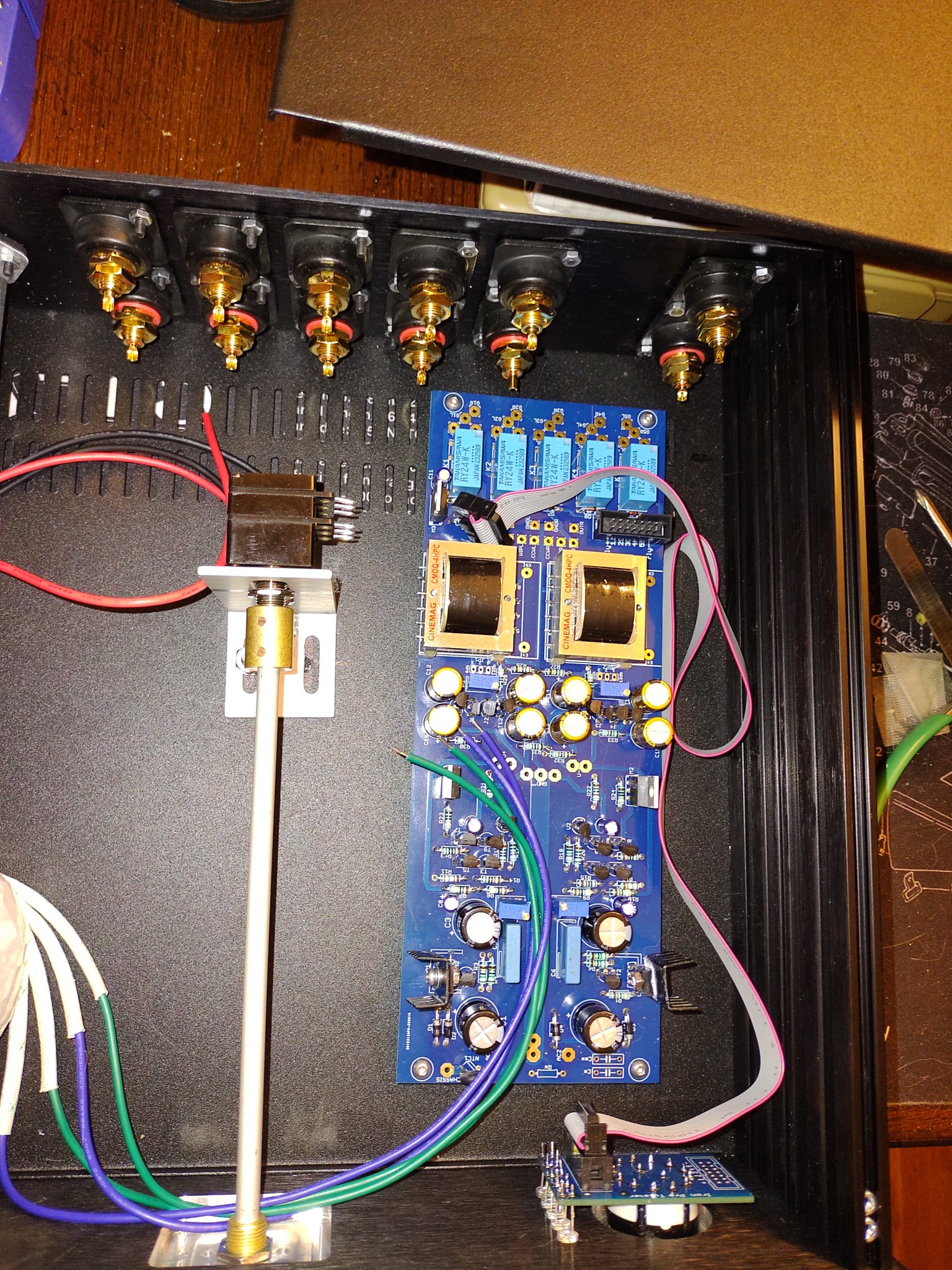

Re reading this thread, I thought I forgot about c11 silkscreen being reversed. However I note it says boards marked 2023. Mine are 2021
so this isnt an issue for these boards marked 2021? I soldered it in according to silkscreen, which note says is reversed for 2023. Am I good to go, or do I need to flip the c11 around?
I ask because my boards silkscreen is just like shown, with the + on the right side of the cap.
Russellc
Official Court Jester
Joined 2003
if 2021 on pcb, neg of cap closer to IRF, so you're good
judging by pic in #3404
you always have "+" marked inside cap circle; additional one outside circle (to allow later check) is, well, additional, additionally placed by Mighty ZM,as addition
:rofl:
so, in most cases addition being proper, in rare cases not so

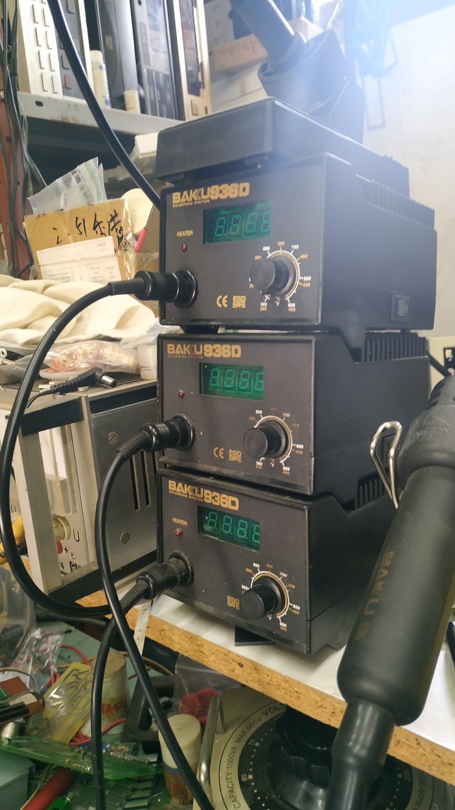

in my neck of wood, Baku 936D is selling for peanuts...... well, comparing to Hakko prices
not Hakko quality, quite normal, but few tricks are already known
- right away supergluing junction of handle with heater, it gets wiggly with time otherwise
- buying bunch of various Quick 936 tips - that's real deal
