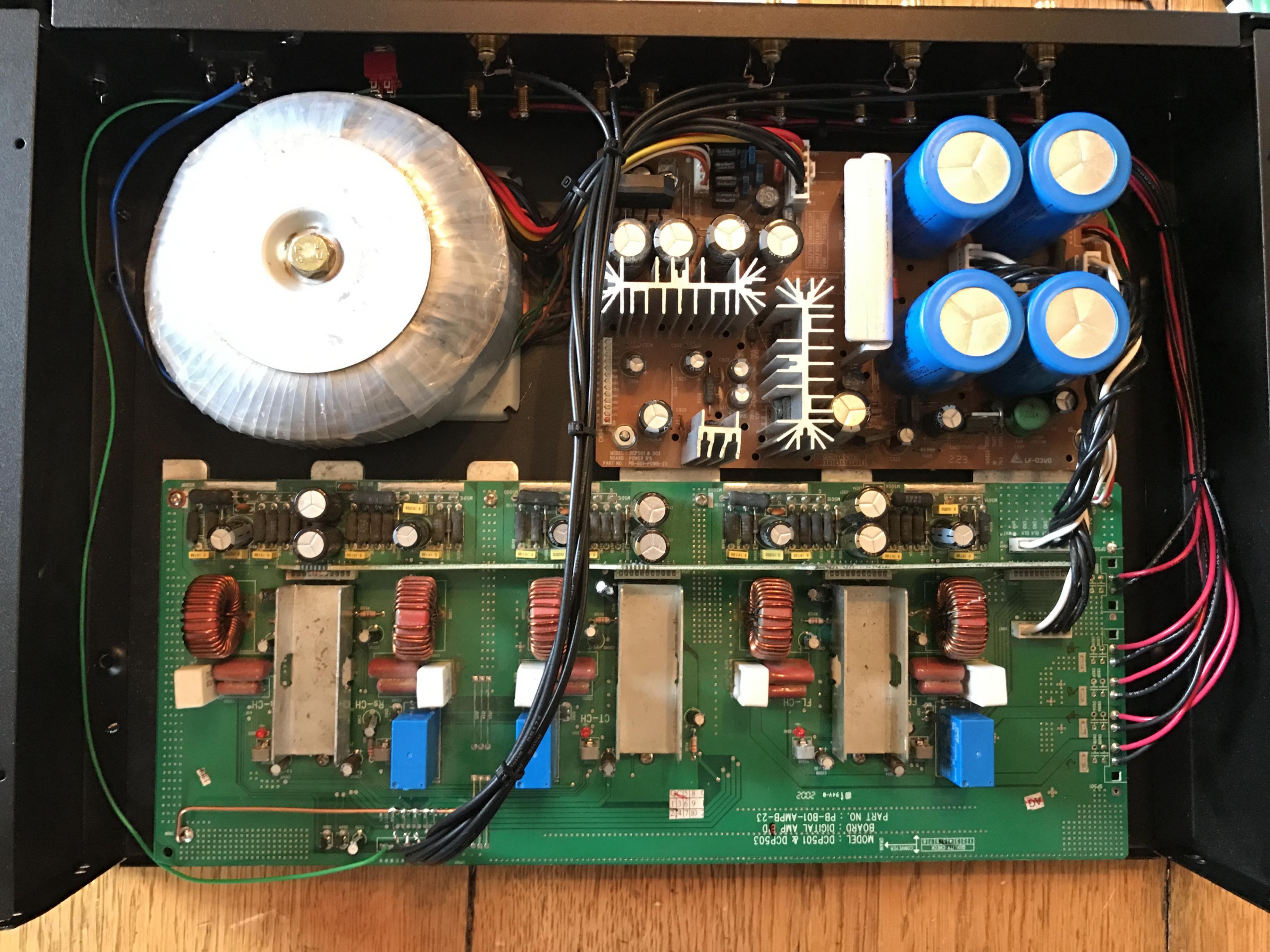

No, one power supply for all 5 channels...looks to be around 500 - 600VA if I remember correctly.
John, thanks for the information on that Motorola HT product! I was ready to buy a Chinese 3020 board and add an analog supply to it. This seems like a much better and easier way. I assume that you once gutted one of these units and made a hi-fi amp from it?
Mind if I ask a few questions?
1) Does each of the 5 channels have it's own separate PCB?
2) If each channel is a separate PCB, I assume that Motorola used the suggested layout that Tripath publishes, or something similar?
3) The power supply seems rather massive...sounds like it's good to go - just reuse it! Is the supply a switch-mode type, or an big analog type with torroidal transformer?
Thank you very much!
Joined 2005
No, all on one PCB
All on one PCB but from what I remember, a good following of the datasheet - it worked great.
Big toroidal transformer. Around 500 - 600VA type...
Joined 2005

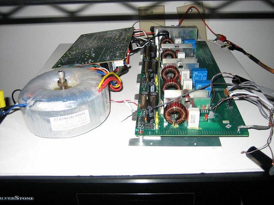

Ha, makes me sad...reading thru this old Motorola DCP thread, I remember when I bought a bazillion more shares of Tripath when it fell to .13 a share...oh well like I said, it all came back to me thru Cirrus Logic...back to the Motorola...see that 33 pages of this thread. Fellow DIY'er Anonymous1 was the one who really figured everything out...
motorola dcp501
Joined 2005
Some pics of what that $50 will get ya..

John, thanks for your response! Are you still using your re-cased 3020? What do you think about it after all these years?
I've been reading through the original 35-page thread regarding the Motorola unit, trying to extract just the essential information I need to strip and re-house in another case - as you did. I am most definitely going to buy one and go this route. It will serve me in two very valuable ways:
1) I always wanted to try a high-power Tripath stereo implementation, since I love my little TA2020 (Amp6) so much. Plus, I have some inefficient, alternate speakers laying around that could benefit from more power.
2) I'm assembling a home theater setup in my music listening room. I've got an EMOTIVA, stand-alone Dolby/DTS processor, but need 3 more power amp channels to run the center and two surrounds. BINGO!...I can either use the full 5 channels of the Moto, or use whatever different "amp of the week club" I have in line for the stereo and use the Moto to add the remaining 3 channels.
I bought a 41Hz AMP9 (4 channels @ 25 W/pc) a long time ago for eventual HT use, but it is still unbuilt. The Moto project will accomplish so much more with that 5th channel onboard!
I might have a couple of questions for you with regards to what gets tossed out and what gets kept when re-housing. But let me first get a unit, test that it works as stock OK...then I'll start tearing into it.
This is one very pleasant surprise! Thanks again.
Joined 2005
Two big things I remembered - from years ago...there is a smd resistor that you need to solder another one top of it to get the OVERLOAD to set to higher power, and there was a trick to get the whole shebang to work by connecting a couple wire connections...all in the crazy thread, and follow Anonymous1's posts...he did all the work...I sold my re-cased 5 channel as I did not need it back then...a few years back to someone on this site...
