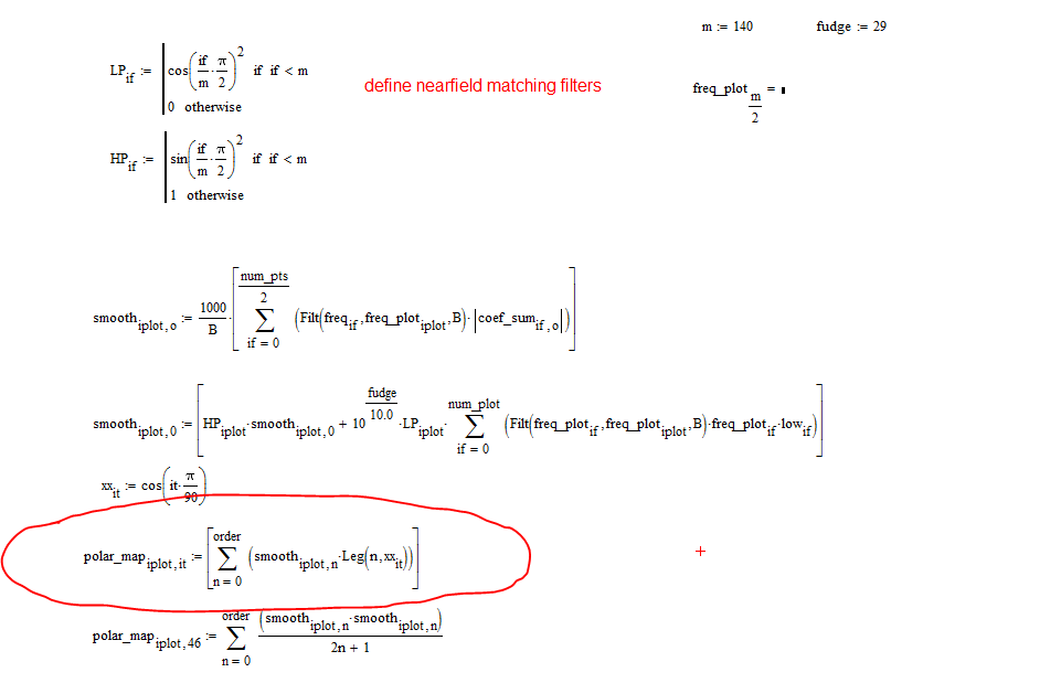

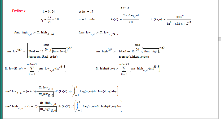

OK, I finally found the Mathcad files. I have attached them (not the full files just pages, the full files are dozens of pages.)
Note:
1)any name with "fft" in it is FFT data.
2) there are two drivers, "high" and "low"
3) the integral at the bottom does all the rest of the work
4) "coef_) is an array of modal coefficients by FFT frequency
5) the function Leg(n,x) is a mathcad function of the legendre polynomials of order "n" in "x"
On the other posting:
1) The circled line contains the reconstruction from modal back to SPL data for plotting in a polar map where "iplot" is the smoothed frequency by "it" the field angle
Remember this was the first step and these pages are simplifications of what I ended up doing, but if you can follow this you will see that the basics are pretty simple
The printout is hard to follow, I can't even remember what it all is doing.
Note:

This page is from a calculation of a two driver system where there is a crossover. Hence high is the tweeter and low is the woofer. This technique allowed me to generate the entire polar map from individual driver measurements which included the crossover. Not a trivial task, but made much easier by the modal expansion.
