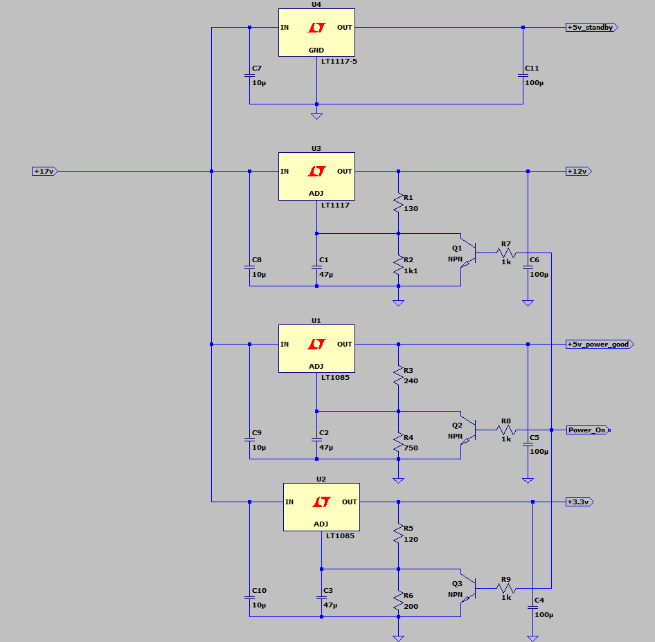

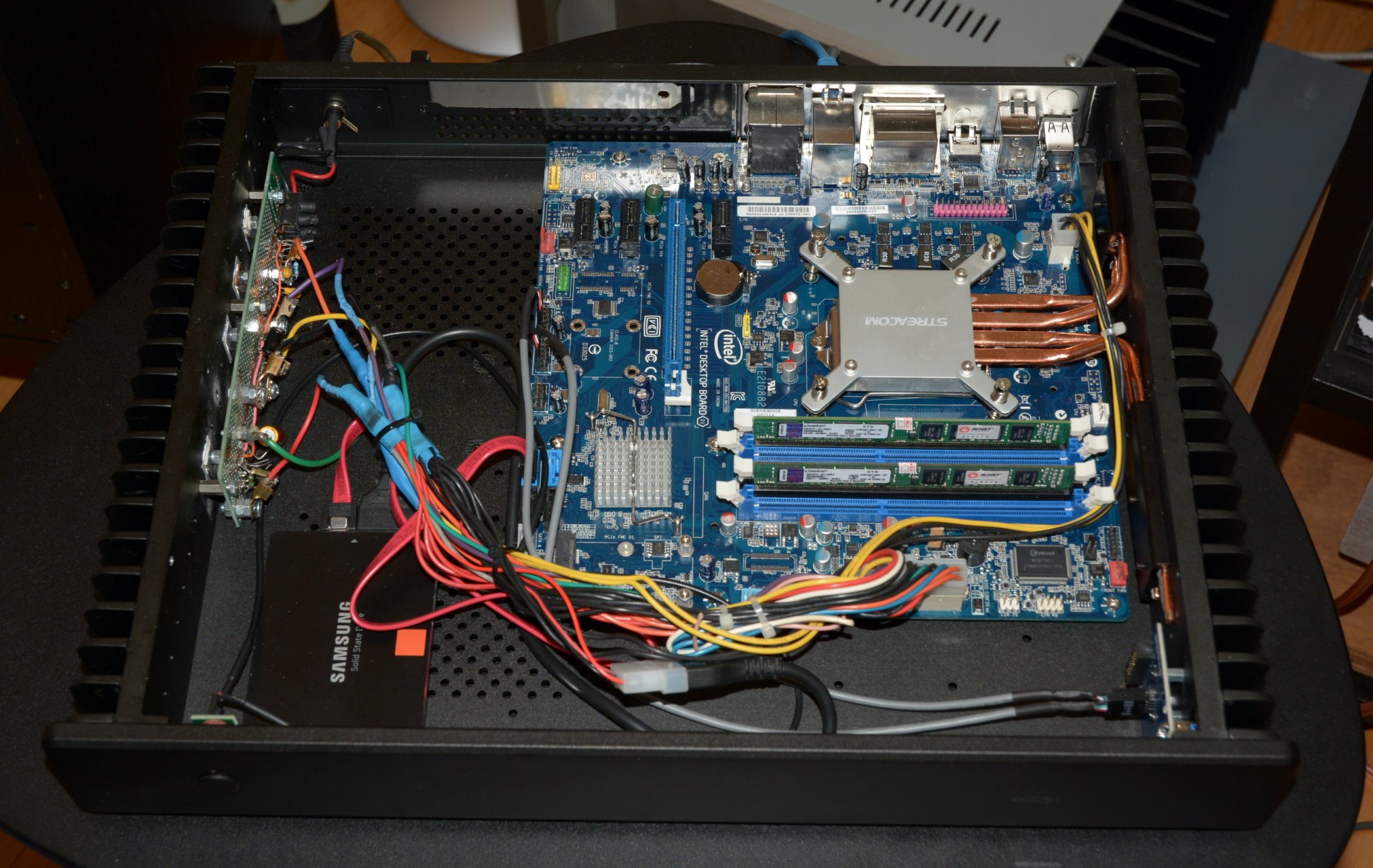

The only PC i use for a direct usb connection to a dac has been using a linear supply for the last 10 yrs. It is a low power i3, so 5A integrated regs were sufficient for the 3.3v and 5v rails. A more powerful cpu will obviously require pass transistors and perhaps separate transformers for the individual rails but not much deep thinking.
Very surprising this has not been done in many diy designs but i keep forgetting diyers generally scoff at audiophilia

I am planning to build my own PSU, thanks for the nice pics...
I mesured the Asus crosshair vii with 5700x...consumption is in total at 35W...
So, i need to figure out a bit what the current distribution is, but i doubt it js more than 2-3A per rail...that js even feasible with some lt3045 boards...and some nice lt4320 upfront...and individual small xformer per rail for isolation of noise...
