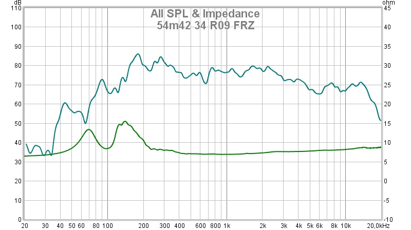

To eliminate the series of impedance peaks I prefer to increase the number of waveguides, the frequency differences between the peaks are reduced and overlap. The result is visible in the project impedance graph 54m42 with 42 wave guides. The use of damping material undoubtedly eliminates the individual peaks but risks attenuating the high frequencies that pass through the waveguides before being diffused in the listening environment. While listening, I am unable to detect the presence of peaks in the impedance and the effect of the geometry of the listening environment is much greater in the course of the FR.
I did a quick search on Hedgeman's work but found only some photos and nothing on the internal structure, if you can indicate some links to deepen it I would facilitate the search. I can't say anything for now.

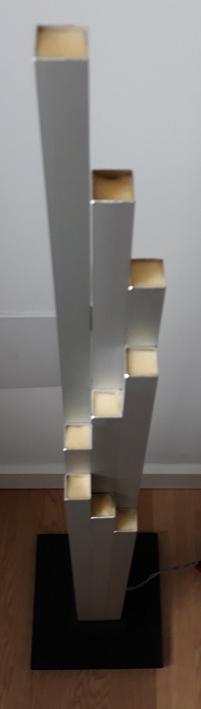

So I had a chance to have a short listen with my workshop amp. In short, very interesting!
I only could listen for like 30 minutes jumping through the tracks I use normally for evaluating speakers. The only direct comparison I had was a pair of Fane 12-250TC in suboptimal boxes (not a fair comparison, but the Fanes sounded inferior - not that they are bad, not at all). Also, I could only listen at low level not to disturb the sleeping family. The picture shows the temporary arrangement, the speakers using the bass horns behind them as holders:)
In the first few seconds, the sound felt strange, very different to anything I've heard so far. The soundstage felt like it was either a half circle extending around the two towers or maybe large as a triangle base extending from the speakers to the front wall.
On Andrew Allen Trio's Star War songs, the drums in the set were very convincingly spaced, like a real (smaller) drum set, I could even hear the stick hitting different places of the cymbals (I think). The instruments were placed where I am used to, but again a bit more "spacious" for the lack of words I have to describe this. I could move left and right a bit, the images were still placed in the same place until I went to a boundary, where objects in the room interfered (the room is far from empty and non symetrical). It is hard to believe that the sound comes from the metal pipes, it looked more like the speakers behind them played the music. There was absolutely no hint of the thing I hate the most - instruments localized at the speakers. A very 2D presentation (in the floor-parallel plane). I am really happy with the project, it is amazing what two small speakers can do with a very simple to build enclosure. The things I do not like are only connected to the limitation of the 3FE22 drivers. I miss some high end - but that might be also due to the very damped conditions around the speakers. Also, as expected, there is no real bass extension. And the last thing is, they are not 100 dB/W sensitive:)
I had a feeling that I could hear a metallic hint in the sound due to the aluminium, but I bet that was just a psychological matter seeing the pipes.
So these call definitely for some subwoofer arrangement and maybe some indirect firing tweeter. I immediately wondered how a Lowther would sound with this style of loading. Or maybe a Fostex or Sonido. Also, when there will be no bass played (crossed over at around 100 Hz) by them, I think I could skip the springy holder and the weight of the tubes should not be a problem.

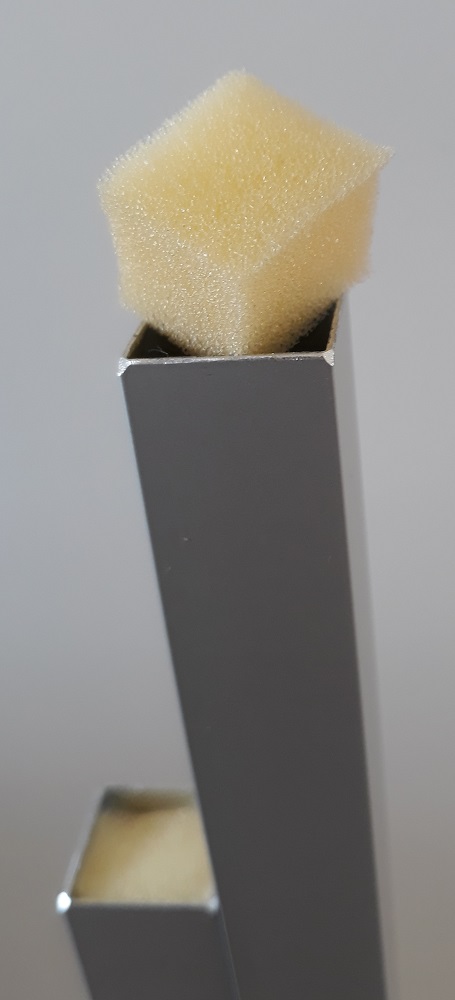

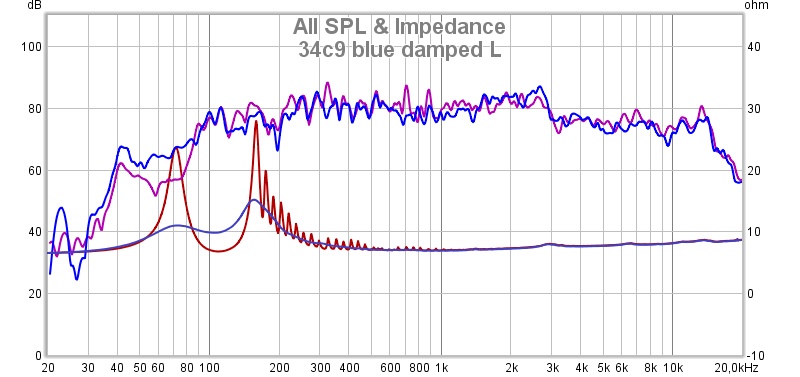

Hello
other people have also asked me what happens when inserting damping material.
I thought of a very simple and quick test, foam cubes. I feared a strong of the highs instead the foam rubber is almost transparent acoustically.
Results. A very slight attenuation on the highs. A greater general equilibrium probably due to the evident reduction of the peaks in the impedance module.
The system is simpler and cheaper than the increase in the number of wave guides and I will adopt it also in the next projects.
link: 34c9
