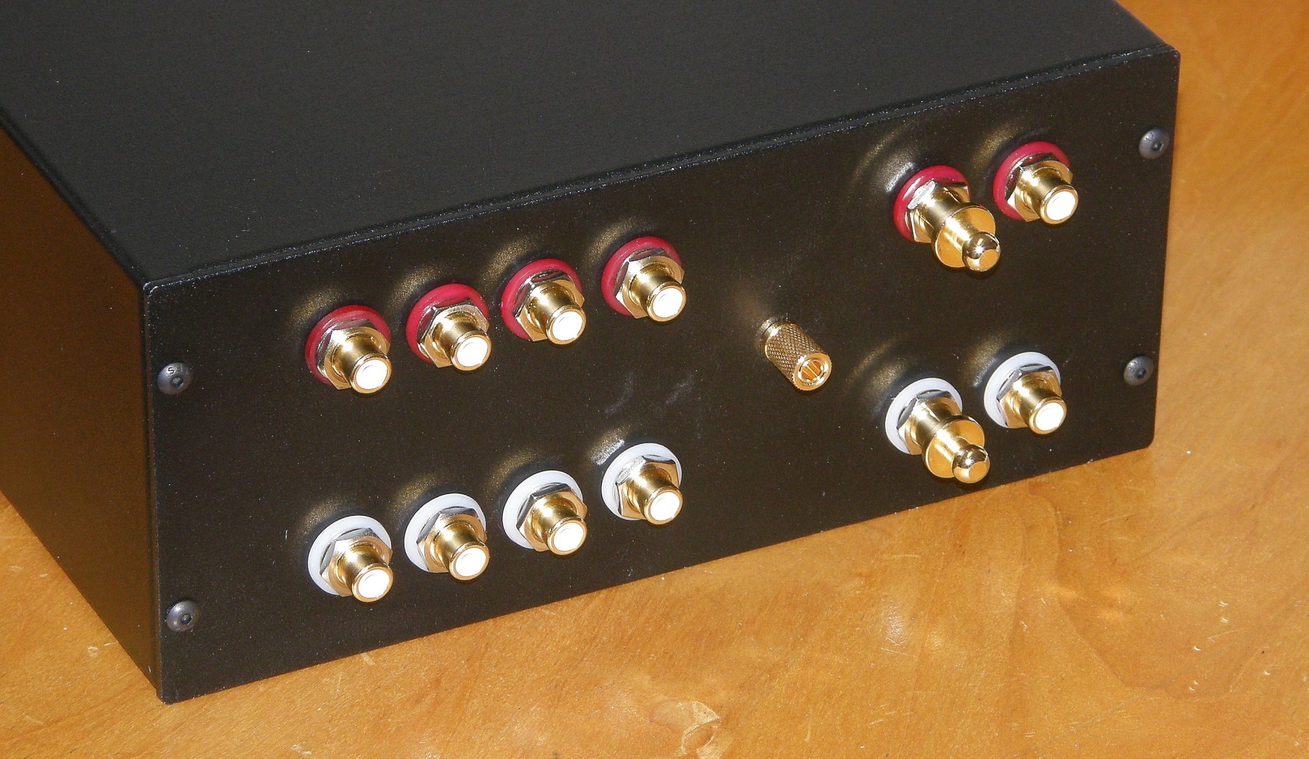

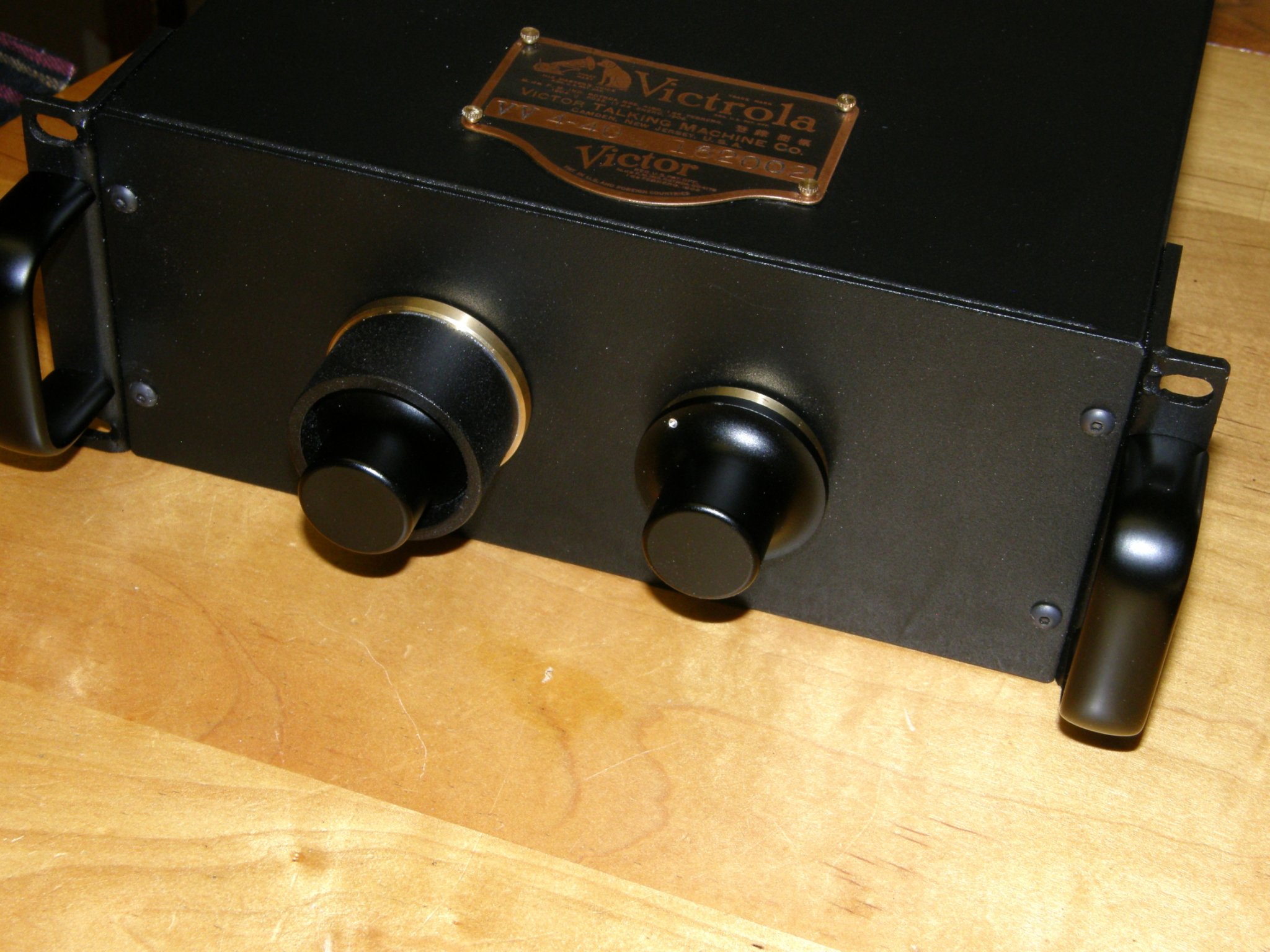

Although the B1 Mesmerize buffer is admirable, all that I am looking to do is build a buffer stage using transistor design. I know this should be simple, but pointing me toward a simple kit would be great. I have a passive preamp that I have built and want to add a buffer stage to.
I should add that Pete Millett's Nutube buffer has come to mind, but I need to test it out first. It uses discreet transistor design so that is a plus. The other side of the coin is finding a power supply that isn't behemoth for this little guy.

Well, JFET is a kind of transistor (junction field effect transistor) so adding Mezmerize also answers the brief. Offers measured 0.001% THD+N at 1VRMS output or 100dB SINAD at 0dBV. In other words objective resolution is good. Subjectively its also a 15 years popular DIY classic. You can't go wrong.
Yes, I agree. I do not need all of the other options of the board such as relay selectors for the inputs, What I am looking for is a board that is much simpler for my needs. No muting either. The Mesmerize is a great product on its own merits, but I just need a buffer stage that is all. In/out/power/done.
